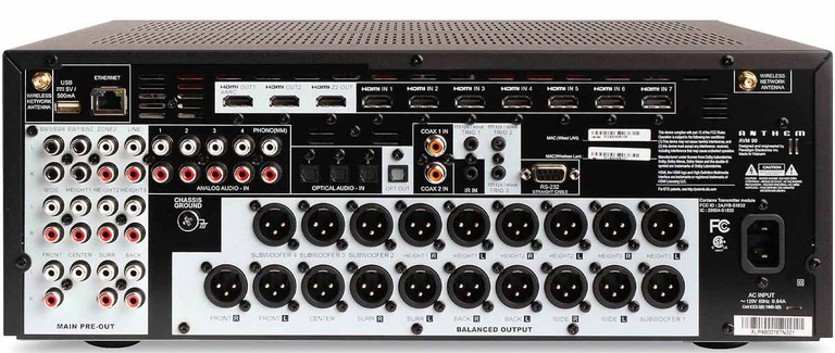

You’ll find traditional digital connectivity, which includes a pair of S/PDIF optical inputs, three Toslink optical inputs, and one Toslink output. There are four pairs of single ended RCA audio inputs and even a dedicated moving magnet phono input. A phono input is a first for an Anthem Pre-Pro. Every digital or analog input can be assigned to any one of 30 virtual input channels.
The AVM 90 (like all Anthem models going back to the AVM 20) has balanced outputs. Simply note that the AVM 90—like all Anthem models going back to the AVM 20—is not a fully balanced unit internally. Many enthusiasts would be surprised how many consumer devices with balanced inputs/outputs are in fact unbalanced in their design.
The AVM 90 lacks any stereo balanced or AES/EBU inputs and foregoes a built-in AM/FM tuner. There is no practical need for stereo balanced or AES/EBU inputs. As I mentioned, the balanced inputs on the prior Anthem models were not fully balanced to the internal circuitry. I would recommend any enthusiast to feed an all-digital signal to the AVM 90 to take advantage of its flagship DACs and ARC Genesis, whose resulting one-two sound combo will be a better solution for musical enjoyment. It also saves you an additional step of ADA conversion, even though Anthem's is at 192kHz.

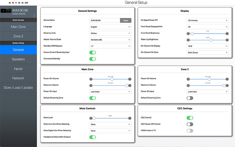

New web-based UI is golden
The AVM 90 sports a new web-accessible interface—and it’s great. The web UI gives you a birds-eye view of the entirety of the AVM 90’s settings and even includes some options not available elsewhere. The web UI is superior to the on-screen and mobile app experience.
The web interface can serve as a remote control to manage power, input selection, and volume, as well as a dashboard for total control over all configuration aspects of the processor.  Request #2: Hey Anthem, may I request a remote-only interface with the web GUI that combines both Main and Zone 2 functionality in a single view like Storm Audio products? I’d love a competent web-based remote to load up on a tablet. I’d also like to see the installer/admin functions password protected. Open configuration interfaces are a bad security practice.
Anthem AVM 90 web GUI
Anthem’s web GUI delivers some settings you won’t find in ARC Genesis—such as inverting sub polarity and routing bass to your mains and subs. When super-subs is enabled you get crossover information to both the subs and the mains, but no LFE routed to the mains. My third request to Anthem: Please implement a true LFE channel routing to both the mains and subs option so you can route LFE to speakers capable of handling it along with the subs. Speakers like my RBH SVTR, Ultima2 Salons, or the Focal Scala Utopia Evo that recently I had in for review can handle LFE in a reference setup.  By comparison, the Marantz AV 10 does provide the option to route LFE to the main channels even with subwoofers present in the speaker configuration.
Note about LFE Routing: The ability to route LFE to large main speakers with the subwoofer channel active is a very rare feature found only in top tier products from Marantz and Denon or specialty processors from Storm Audio and Trinnov. Most users do NOT need this feature and it should only be reserved for when the consumer is using speakers capable of handling the deep dynamic bass from LFE content in music and movie program material. Otherwise, LFE routing should remain solely in the subwoofer channel.

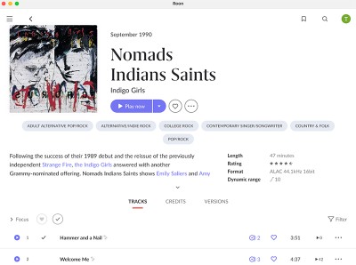

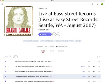

Speaking of Roon, the AVM 90 will function as a full Roon endpoint. Roon Ready is the highest level of integration you can get and will Roon’s native RAAT protocol for lossless streaming and integrated volume control. As of this writing, Roon support looks like it’s on target for early 2024. Anthem has taken a big black eye in the user community for the delayed launch of native Roon support.
I successfully cast and grouped the AVM 90 with both AirPlay and Chromecast devices. The strengths, quirks, and limitations of those streaming technologies are also present.
Chromecast is painfully slow to load music on the Anthem. Volume steps with AirPlay are too far apart if you use the hardware buttons on an iOS device Of course the volume step issue is non-existent when using the Anthem mobile app, the physical volume dial, or third party IP-based control with the streaming input.

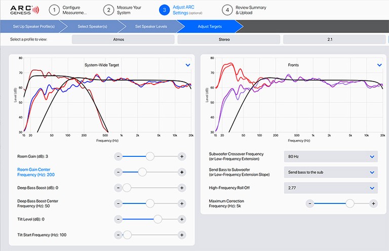

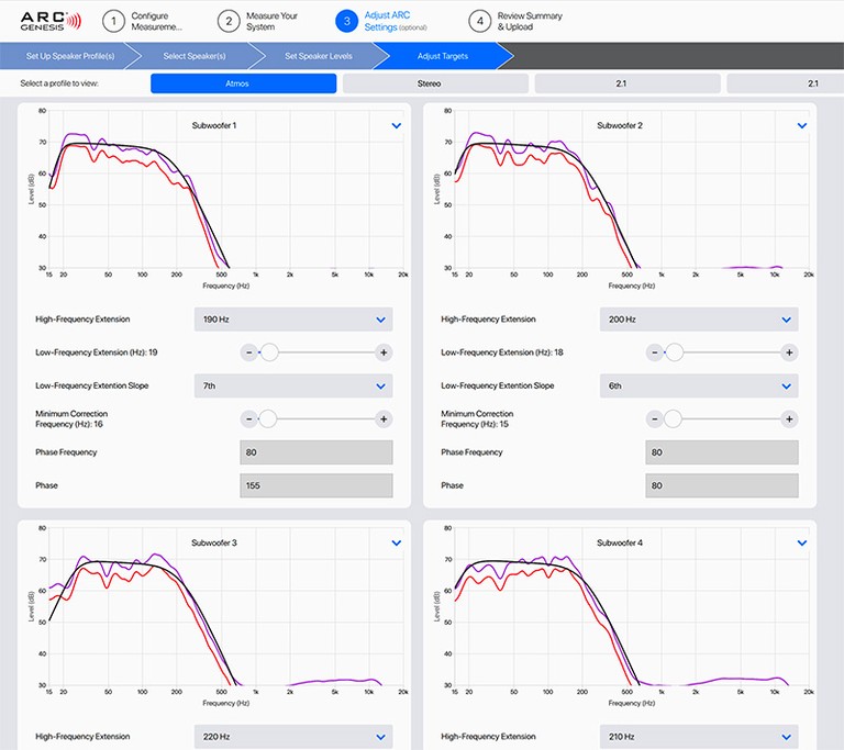

The AVM 90 comes with Anthem’s heralded ARC Genesis room correction system. It is a powerful, easy-to-use, and flexible solution for room correction. ARC Genesis also runs at 192kHz. Some competitors downsample the audio signal to 48kHz or 96kHz for their room correction to work.
Here are keys to need to know about the ARC Genesis upgrades with the AVM 90:
First, the AVM 90 comes with a completely new microphone. A small dot shows you the front orientation. The new microphone measures frequencies above 5kHz more accurately. This upgrade is key if you’re looking to calibrate speakers behind an acoustically transparent screen where you’ll experience some loss or issues above ARC’s default 5kHz cutoff.
ARC Genesis
ARC Genesis now offers new features to fine-tune performance in your room such as deep bass boost and tilt level.
Second there is automated phase adjustment for each subwoofer. Auto phase adjustment is performed after you complete your ARC calibration. Simply put the microphone at the main listening position and let it do its magic.
Third, Quick Measure now shows you the real-time frequency response of each speaker with or without ARC enabled. Quick Measure virtually eliminates the need for REW and gives you keen insight into optimal placement for subs and your mains. You can see an example by clicking here to jump to that part in my AVM 90 video review. QuickMeasure currently lacks the ability to play all subs together and get the summed measurements with and without ARC. That’s a key feature I hope Anthem will add in the future and we made this request.
ARC Genesis Quad Subs
Automatic Phase Adjustment in the new ARC Genesis will automatically phase align each subwoofer to the mains
I’ll have an in-depth primer and review of ARC Genesis with the AVM 90 with measurements of multi-sub calibration in a separate editorial review here and a video version on our Audioholics YouTube channel.

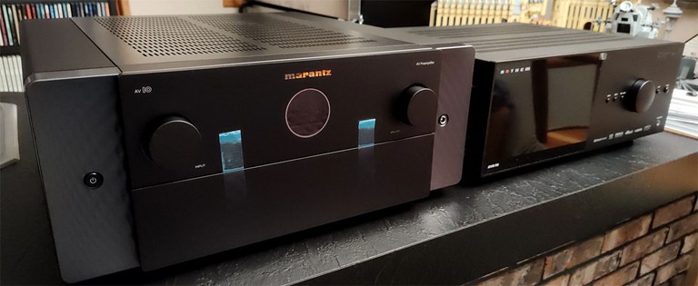

Comparison to the Marantz AV 10
Comparing the AVM 90 to other 15.4 channel processors opens up a whole can of worms. If your preference is Audyssey, Dirac, or Auro-3D, then there’s no real conversation to be had. Let's be honest about that bias. If you’re a custom installer and you want extremely granular control and features, three zones, or other installer-specific elements, then the Marantz AV 10 may be the better fit for you given its rock-solid HDMI switching, custom installer cloud-based control portal, and granular functionality.
Anthem AVM 90 vs Marantz AV 10
Marantz AV 10 vs Anthem AVM 90 - image courtesy of Bonzo17 @ AVS Forum
They key differentiator for me lies in the AVM 90’s upgraded audio circuitry as a starting point for any discussion. I'm not implying the competition sounds bad. I am noting that the AVM 90 sounds spectacular. Look closely at the competition’s DACs, audio circuitry, and measurements and see if they really are comparable to the AVM 90.
That being said, the closest objective competitor is likely the Marantz AV 10. The Marantz has quad independent sub outputs and upgraded audio circuitry, and on paper, the Anthem AVM 90 has the better DACs. However, there is no denying the Marantz AV 10 is a beast just by looking at the sheer size difference of it sitting side by side with the smaller and lighter Anthem AVM 90 as seen in the above photo.
Gene put the Marantz AV 10 on the bench and it measures exceptionally well—very similar to the AVM 90. The Marantz has a low noise floor and great dynamic range. And it sounds really good too (I auditioned the AV 10 briefly at Gene DellaSala’s AH SmartHome paired with the Perlisten S7t and the Marantz AMP 10).  Note that there is a difference in the Marantz AV 10's DAC filter performance. Hint: If you're a Marantz AV 10 owner, switch to DAC filter #2.
Out of the box, the Marantz comes with a limited version of Audyssey MultEQ-XT32. To get peak performance you need to purchase MultEQ-X for PC or the full version of Dirac along with calibrated microphones. That increases your investment by several hundred dollars. Audyssey MultEQ-X and Dirac give you more granular control than ARC Genesis over fine tuning your target curve. They also have a far higher and more complex learning curve than ARC Genesis. And, ARC Genesis works at 192kHz. Best of all? It just works great.
There are user interface intangibles to consider as well. The AV 10 lacks the granular control the AVM 90 gives you on an input-by-input basis. And remember with the AVM 90 you can apply any one of four ARC profiles on an input by input basis.
Other elements like Anthem’s superior display and streamlined interaction will be personal preferences. All in all, the competition between the Anthem AVM 90 and Marantz AV 10 is the closest we’ve ever had here at Audioholics. I strongly advise anyone looking at processors in this price point to audition for yourself. I recommend that the measurements guide you on the products to audition and your ears help you decide on the products to purchase. My intuition leads me to suspect that those who demand the best sonic performance with music and movies may tend to the AVM 90.

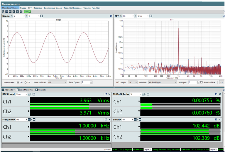

AVM 90 Measurements
If you’ve been eyeing the AVM 90 or lurking on forums, you’ll readily find former AVM 70 users upgrading to the AVM 90 and others who have chosen the AVM 90 after comparing its sonic chops with the competition.
Those anecdotal experiences now find real world validation in the AVM 90 8K’s superb bench measurements.

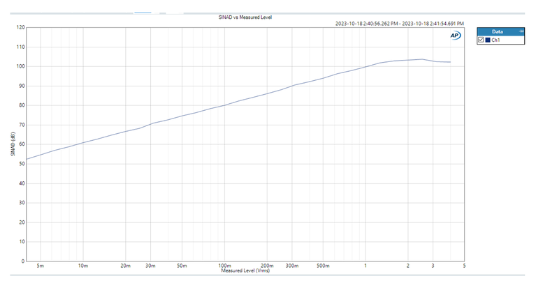

AVM 90 SINAD
The AVM 90 has a SINAD just over 102dB. This is an excellent measurement for a preamp-processor with 0.007% THDk+N.  I should note that the AVM 90's measurements are better through its unbalanced (single-ended RCA ) outputs. They actually measures better —106dB SINAD via unbalanced outputs. For those interested in academic comparisons, you can see Gene DellaSala's in-depth measurements of the Marantz AV 10, whose XLR measured at 106dB or 0.0005% THD+N when Gene ran the full bandwidth (Fs=192kHz) test. Gene got 108dB SINAD when he limited the bandwidth to 22kHz. But without bandwidth limiting, the SINAD results for the AV 10 was 101dB via XLR and 99dB unbal. As Gene DellaSala has noted on several occasions, SINAD is one of many measurement indicators and should not be used as the sole determination of a product's overall performance and sound.
SINAD vs. Measured

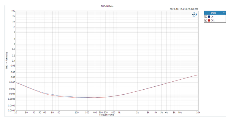

AVM 90 measurements THD and Noise

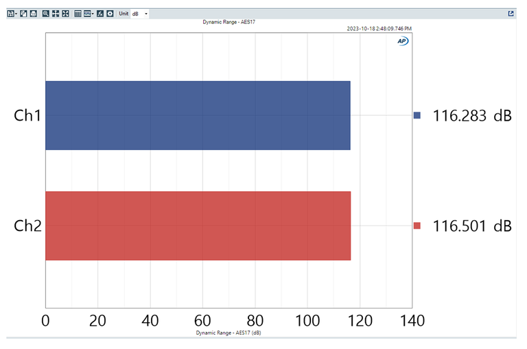

AVM 90 Dynamic range
The Anthem AVM 90 sports a ridiculously low noise floor, over 19-bits of dynamic range, and inaudible levels of distortion. This is a very quiet, noise free processor and you shouldn't hear much hiss even if you're using high-sensitivity speakers in close proximity to the listening area. The Anthem AVM 90 and Marantz AV 10's dynamic range measurements are neck-and-neck at over 116dB. If you want better, measurable (and potentially  audible) performance you’ll need to turn to a dedicated, high end, stand-alone DACs.

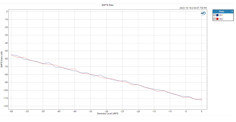

AVM 90 intermodular distortion
The Anthem AVM 90's SMTPE ratio is textbook and excellent. Once again, you'll need to turn to a dedicated, high end DAC to see any measurable improvement in performance.

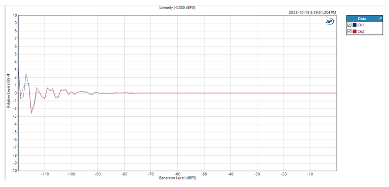

AVM 90 Linearity
The AVM 90's linearity is excellent. The minor blip is in the inaudible spectrum and irrelevant.

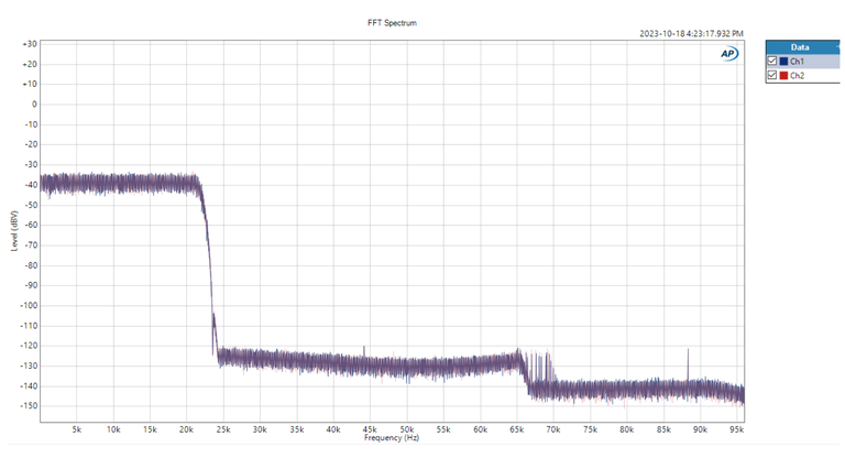

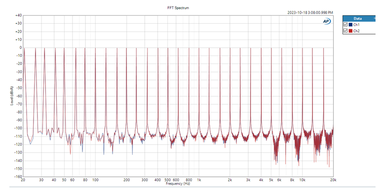

AVM 90 Spectrum Analysis
Given what we've seen so far, it's no surprise that the AVM 90's FFT Spectrum analysis is excellent.
AVM 90-FFT Spectrum analysis
It is such a pleasure to see such a well-measuring multichannel processor. In summary, the Anthem AVM 90 joins the Marantz AVM 10 as the best measuring multi-channel preamp-processors that we have ever had the pleasure of reviewing here at Audioholics and sets a benchmark for the competition to aspire to!

The AVM 90, Ultima2, and D212s combo built a holographic image with Brandi Carlile’s “Turpentine” live at Easy Street Records in Seattle. The AVM 90 etched Ms. Carlile’s vocals lifelike in size, contoured, and refined with uncanny presence.  The AVM 90’s ability to render subtle details and textures is uncanny.

Welcome Me indigo girls
