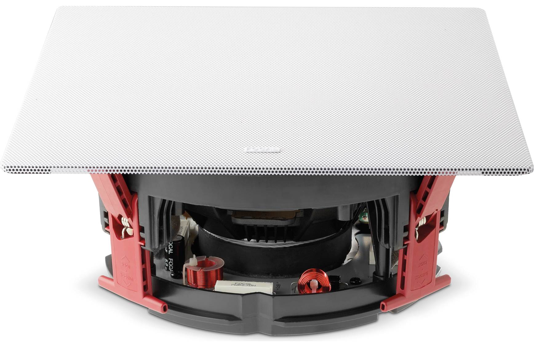

The clamping mechanism differs slightly between the in-wall speakers and in-ceiling speakers. The in-wall models have large, spring-loaded plastic arms that clamp the speaker on the left and right side. The mechanism is super-simple to use. Simply lock the clamps in place and once the speaker goes into the Sheetrock, the spring activates, clamping the speaker in position. If you need to pull it out or adjust the speaker's horizontal or vertical alignment, there are nylon straps on the top and bottom face of the speaker. Simply pull on the top and then the bottom band and bingo, the speaker will come out without any hassle.
The in-ceiling speakers have a two-part mounting mechanism. The first is the mounting frame, that comes with spring-loaded arms similar to the in-wall speakers to clamp the frame to the ceiling. Once you mount the frame, you place and then turn the speaker into its final locking position. Icons on the speaker and mounting frame let you know when you have the speaker locked in place.

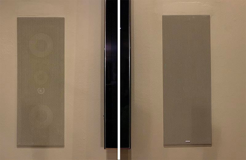

Font Focal 300 series with and without transparent cloth
Here is an example of the Focal IW6 LCR without and with the transparent cloth inserted into the grille.
I found that in the black acoustic cloth darkened the grille shade.
This shot was taken after the magnetic grilles were painted to match the wall color.

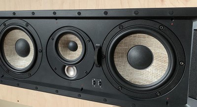

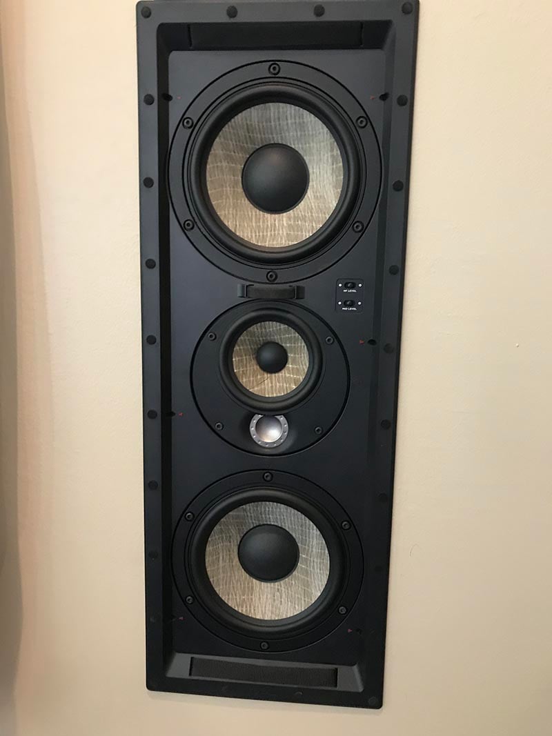

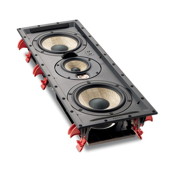

Focal 300 IW6LCRFocal’s 300 series consists of two in-wall and four in-ceiling models. Every model has an impedance of 8 ohms and the sensitivity ranges from 88-92 dB. Every model is very easy to drive—perfect for a zone amp or an AVR-powered home theater. Focal doesn’t make an in-wall subwoofer for the series. As a side note, Audioholics contributor Steve Feinstein, who has an extensive background in speaker design had an exchange about this point. Steve made the comment that if an in-wall sub is not installed correctly, the system is actually worse off than if there was no sub at all. A small sub put in the corner of the room, out of sight with room correction applied generally works well for an in-wall and in-ceiling system without ruining the aesthetics. That being said, I strongly recommend pairing the 300 series with a subwoofer to elevate the system's overall performance. Here's a breakdown:

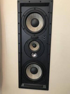

  • 300 IW6 LCR: The IW6 LCR is the flagship of the 300 series speakers. This is a hefty three-way in-wall loudspeaker intended to perform left, center and right channel duties. The IW6 LCR weighs in at a hefty 12.4-pounds. It sports a 1-inch aluminum/magnesium inverted dome tweeter, 4-inch woven flax fiber midrange with rubber surround, and dual 6-1/2-inch woven flax fiber woofers with rubber surrounds. The IW6 LCR features a 3-position high frequency and midrange frequency control to cut or boost those respective frequencies. Moving the control from its neutral position to the left will reduce the frequency response and to the right will increase it.  On the IW6 LCR, the the mid level switch impacts 600hz <-> 2.5khz  +/-1dB and the HF switch effects 2.5kHz <-> 16kHz   +/- 4dB. The rated frequency is 40kHz to 28Hz with a sensitivity of 92dB. The mid-treble and tweeter plate rotates 90 degrees for horizontal installation as a center channel speaker or to accommodate installation challenges requiring horizontal left and right speakers. To rotate the center plate, you remove the hex screws, turn the plate, and then put the screws back in. The process takes only a few minutes and is incredibly simple to do. The speaker's baffle has a small graphic that shows you the proper orientation of the center plate, which is midrange driver above the tweeter as shown in the photo below in my installation.
  • Focal 300 series IW6LCR horizontal arrangement
    The Focal 300 Series IW6LCR 's midrange plate rotates 90 degrees so you can install the speaker horizontally to serve as a center channel speaker.

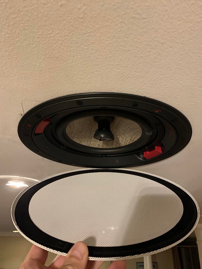

  • Focal 300 series ICW8 with Grille300 ICW8: This 7.1-pound in-ceiling speaker features a pivoting tweeter and 8-inch woofer with a rated frequency of 48Hz to 28kHz (±3 dB) and a sensitivity of 90 dB. A tweeter-level control cuts or boosts the high frequency >3.5kHz  +1.5dB /- 2dB. All in-ceiling speakers in the 300 series feature round and square bezel-free magnetic grilles in the box.

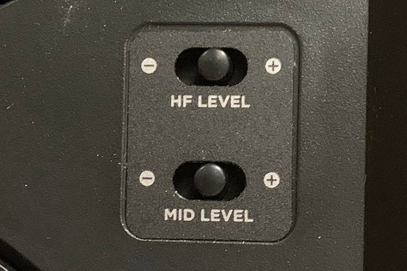

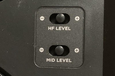

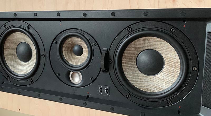

Focal 300 series speakers HF and MF level control
Many of the 300 series speakers have HF and Mid level controls so you can fine-tune the speaker's sound to your environment.

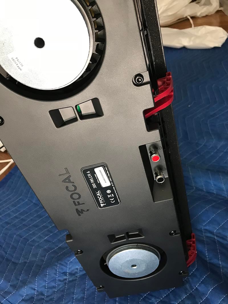

Focal 300 series rear
Rear view of the Focal IW6 LCR speaker

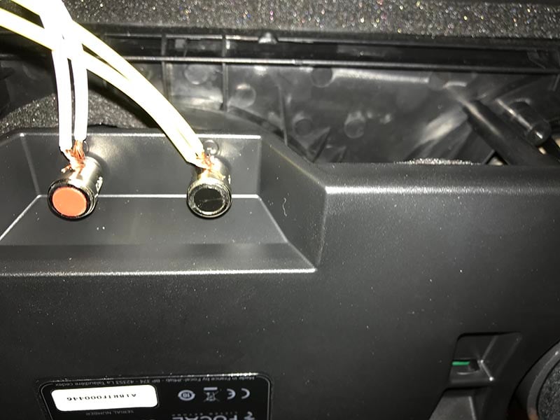

Focal 300 series with Kimber Cable
The Focal's push-spring binding posts accepted heavy-gauge cabling.

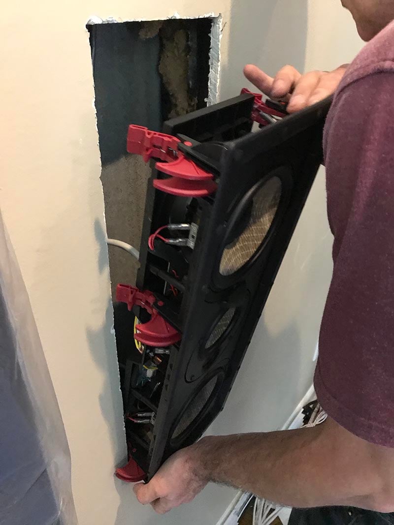

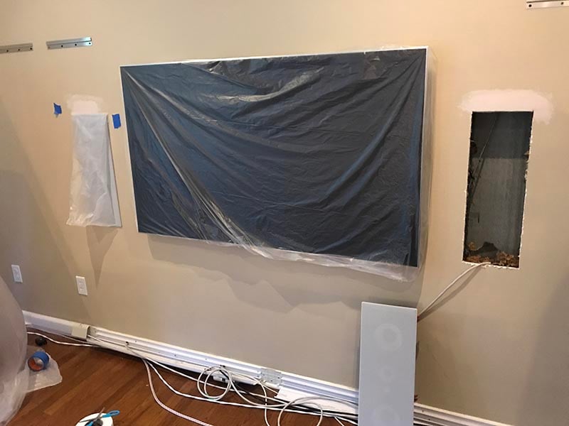

Installing the 300 series in my living room was a breeze. I used Kimbercable KWIK 12 cabling for the front left, center, and right speakers and KWIK 16 for the surround speakers.

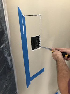

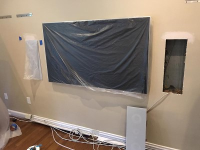

Using Focal's included templates, it was easy to mark and cut out the Sheetrock or plywood (more on that below). Then all that was needed was to activate the clamping mechanism, push the speakers into the cutout and bingo! Snap, snap, and the installation was done in seconds. The instances where I wanted to fine-tune the speaker alignment, I appreciated being able to hold the nylon strap and move the speaker in-wall without any problems whatsoever. At various points, I put the speakers in place and took them out again about a dozen times to see if there was any impact on either the Sheetrock or the speakers. There wasn't.
Now, as with any project involving cutting into your walls or pulling cabling, we always recommend hiring a professional installer if possible to conform to local codes.. I ran into a few logistical challenges that I think are worth relating:
In order to center the IW6LCR under my TV, it would have involved cutting away studs in the wall. Because the wall was load-bearing there would have been additional construction work involved. I didn't want that hassle and opted instead to build out a plywood enclosure for the IW6LCR.
Focal IW6LCR installation
View of the front left and right Focal 300 IW6 LCRs being installed.
The second challenge involved the left surround speaker. Because that wall is an outside wall with insulation, etc., I didn't have enough depth for the IW6. I therefore chose to build a plywood enclosure for that speaker too.
The third item I'll call an "almost" challenge. When we cut out the Sheetrock for the front left speaker, there was an electrical box in the same bay. It didn't come up in our pre-cutout wall scans. Thankfully the box was far above the speaker's cutout. However should there be any electrical box or low voltage box directly behind your cutout, you won't have enough depth to install the speaker. I'll also mention that if you do happen to have a box in the same bay, you'll likely experience some sound bleed through on the box. I suggest you consider using some acoustical putty. I purchased ATS Acoustics Putty Pads for the installation.
The fourth challenge I had was properly mounting the in-ceiling speakers. My ceiling is a double-layer of sheet rock with metal wiring between the two layers. On top of the sheet rock layers there are 1/4-inch wooden strips that run across so that the ceiling is perfectly flat. Aside from the difficulties of just cutting through the sheet rock itself, the wooden strips made it impossible for the mounting mechanism to clamp. Dogears would have had the same issue. We had to cut away portions of the wooden strips to allow the clamps to extend fully and lock into place.
Focal 300 series cutout
For any architectural speaker installation, cut a small hole within the template to see if you have any obstacles or surprises in the wall or ceiling.

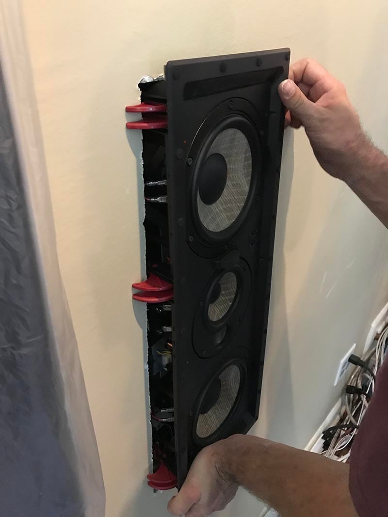

Focal 300 series IW6LCR snap in
With the IW6 LCR's clamping mechanism put into its active position, all we needed to do was push the speaker into the wall, where it "snapped" into place.

I’m sure you’re wondering, “Is there a downside?” Yes, there is a potential downside to be aware of. The clamps are a double-edge sword. While they make installation a breeze, should you break one, you can’t easily replace it like you can a dog ear. Therefore, I cannot recommend in strong enough terms (again) that you should watch Focal’s tutorials and test out the mechanism so you clearly understand how it works. Should you happen to break a clamp, it will likely take some time to get it replaced.
Secondly, if you are installing in-ceiling speakers, make sure you don’t make the in-ceiling cutout too small. If you force the housing mechanism, it will become difficult to lock in the speaker actual speaker.
Focal 300 series prior to sanp in
Push in the bottom and then the top part of the speaker to get it to lock into place.
Focal IW6LCR installed no grille
Once installed, the speaker is solidly in place. To move or pull out the speaker, simply grab and pull on the top and bottom nylon straps.
Third, you do need more additional room to either side of the speakers for the spring-loaded locking arms than your typical dogears.
Finally, if you do get a broken locking mechanism you may have some delay getting a replacement. There’s a big difference between stocking a two-cent dog ear vs. a proprietary locking arm.

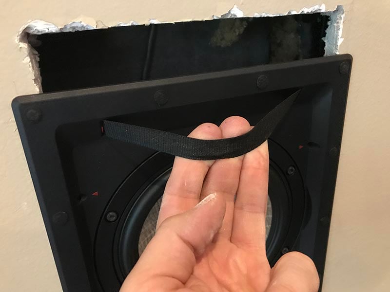

Focal 300 series pull strap
Tug on the pull strap to remove the speakers easily.

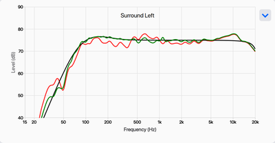

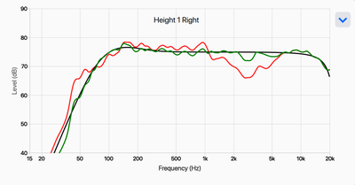

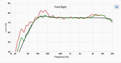

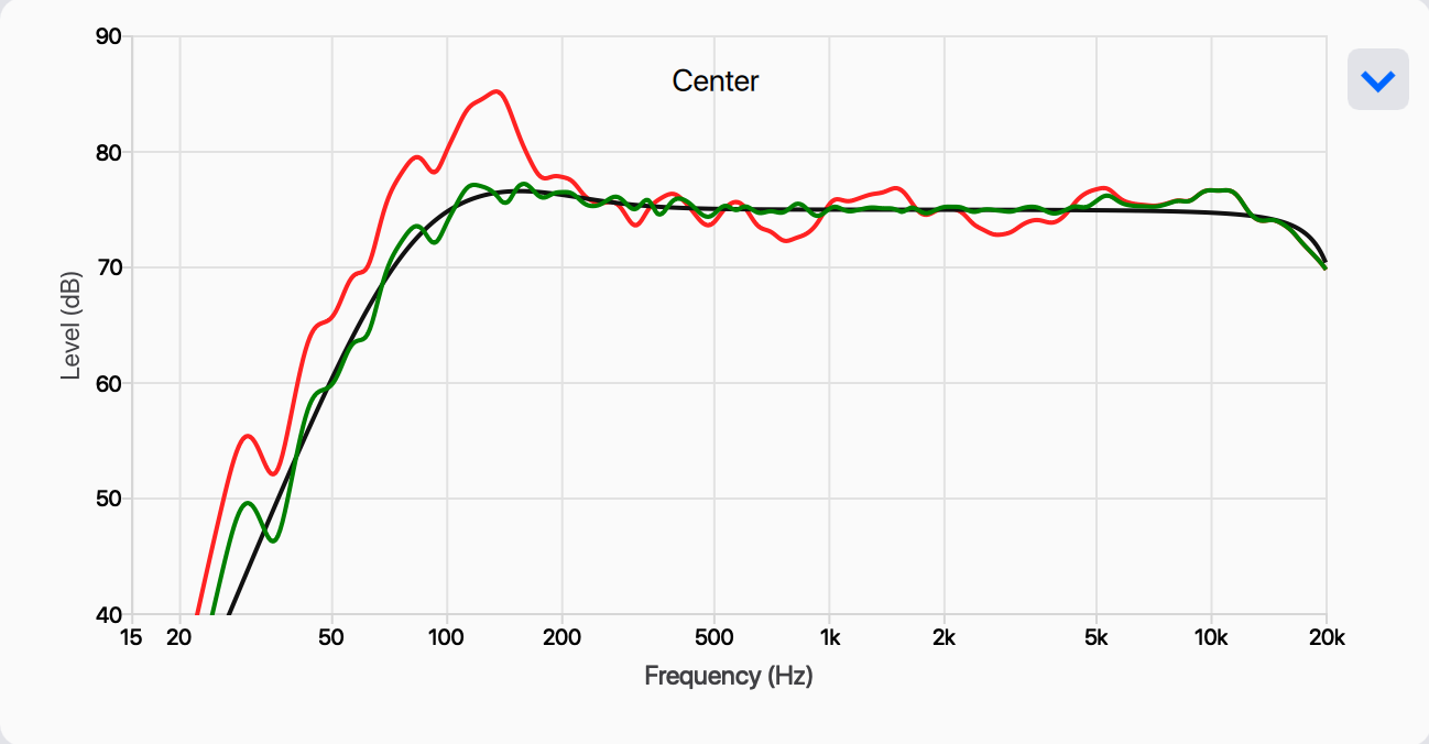

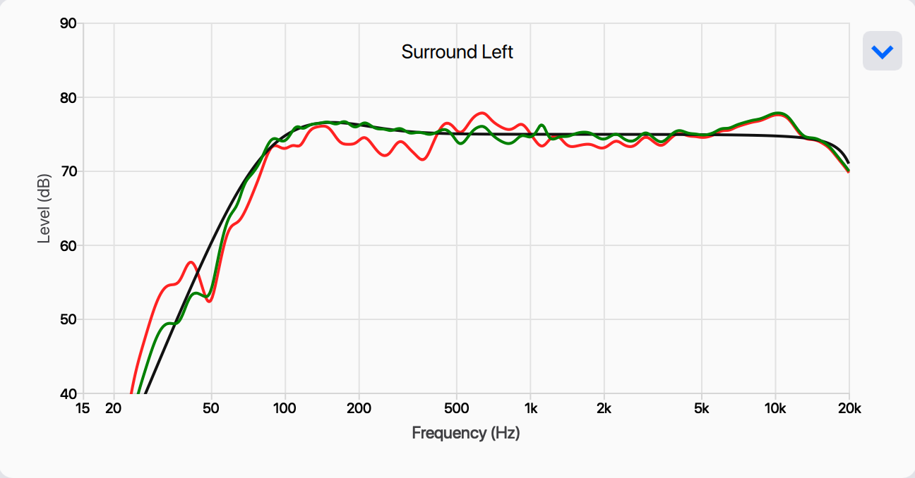

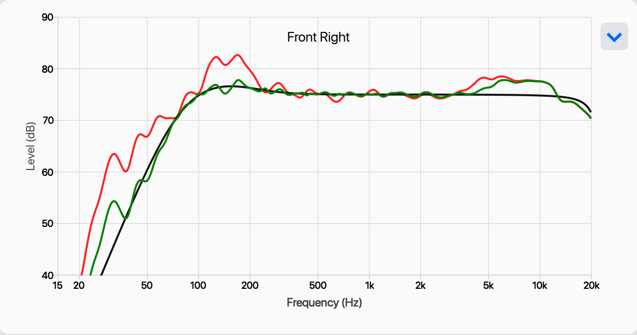

Measurements

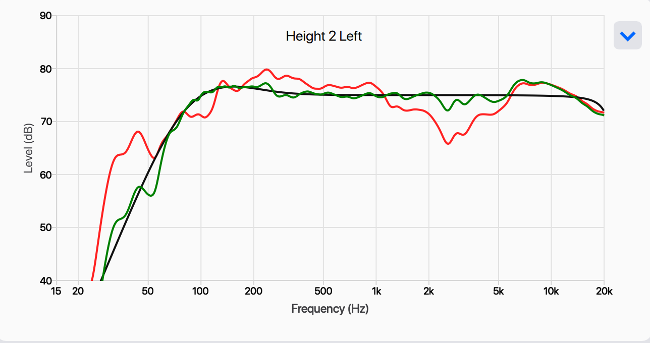

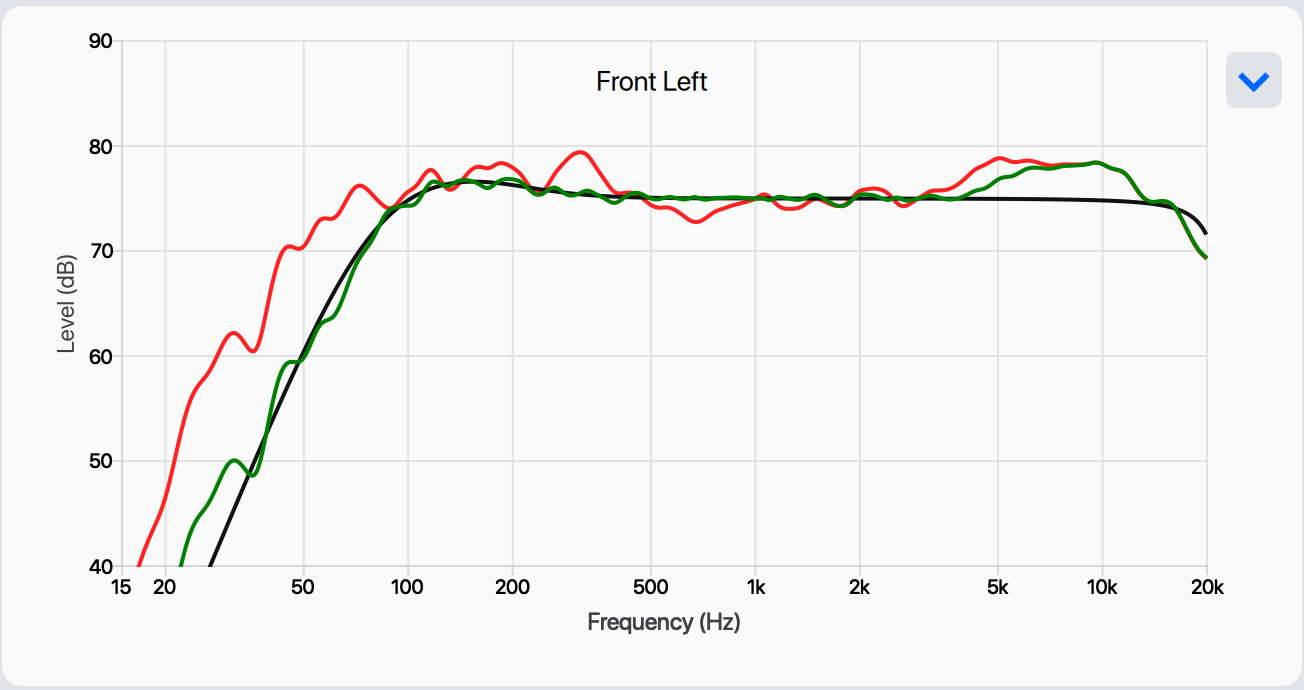

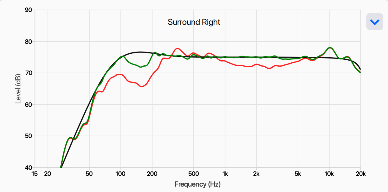

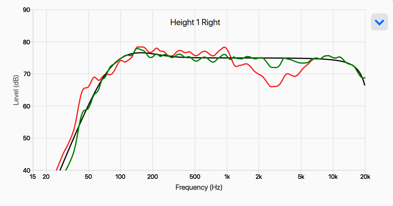

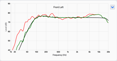

Below are five-position, averaged measurements (red) using Anthem's ARC Genesis along with the corrected curve (green) against the target curve (black) of some of the ear-level and height level speakers. Room gain was set +3dB at 200Hz which is why you'll see that slight hump in the target curve at the lower frequencies. Front LCR were IW6 LCR, side and rear surround were IW6. Height speakers were ICW8. As you can see in the measurements, the room had an impact on the measurement of each individual speaker.
I used ARC Genesis to calibrate the system for home theater but disabled ARC for two-channel music listening. For home theater/multichannel playback ARC was set to correct only up to 5kHz.
Focal front left ARC measurements
Focal 300 Series ARC Center
Focal 300 series ARC right
Focal 300 series ARC surround left

Focal 300 Height Left
Focal 300 Height 1 left

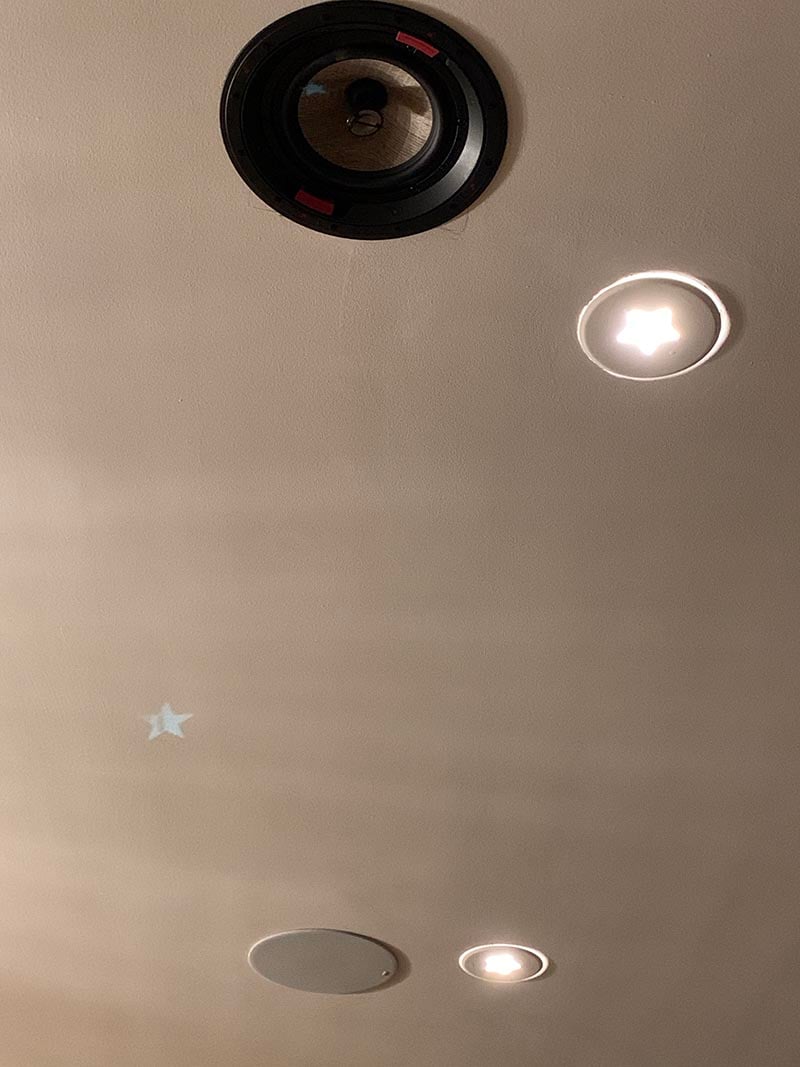

Focal ICW8 in-ceiling installed
The Focal 300 series ICW8 in-ceiling speakers installed. Shown with and without the magnetic grille.
The tweeter pivots 360-degrees and can be positioned towards the listening position.

Focal 300 series ICW8 with magnetic grille
The ICW8 comes with round and square magnetic grilles to match your decor.  The magnetic grilles have a fabric lining to prevent them from sticking to the speaker.

  • Third, if you're using room correction always double-check the results—be very careful where your AVR crosses over your speakers. I had some issues with the crossover being too high for the IW6. I didn't like the results of how the IW6 blended with the subwoofer until I lowered to 80Hz.

Focal's 300 series architectural speakers sport a true tool-less installation. The clamping design makes installation a literal snap. But such a design means nothing if the speakers don't deliver the sonic goods—and rest assured that the Focals deliver in spades.
