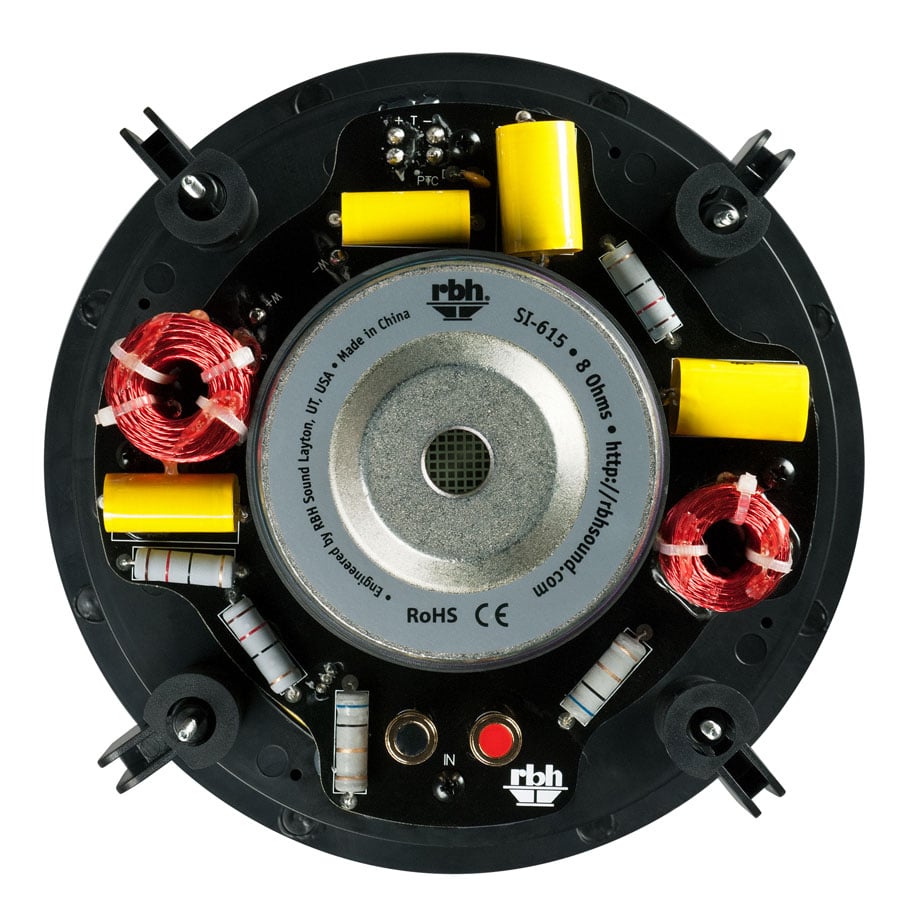

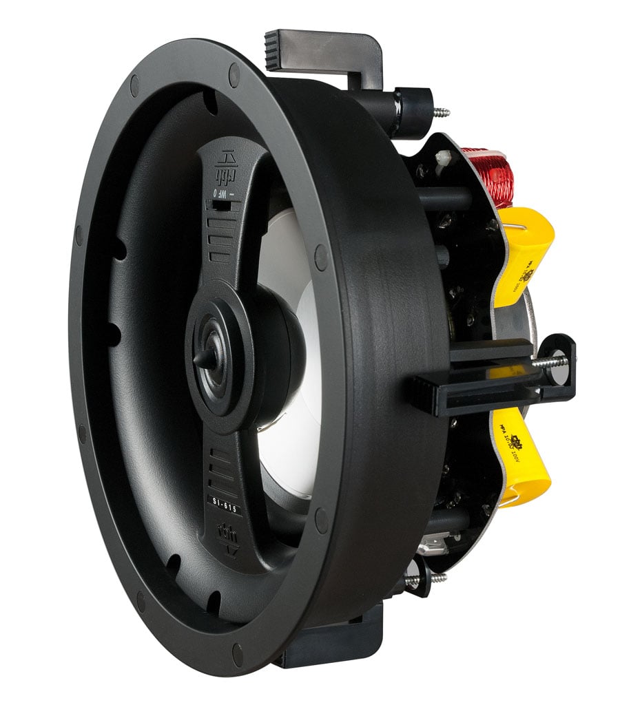

quality level of the rest of their Signature in-wall line. The SI-615 in-ceiling
speakers feature a 6-1/2” aluminum cone
woofer and a ¾-inch pivoting ring-radiator tweeter. The speaker has a great sensitivity rating of
88dB (2.83V @ 1 meter) and the 6 1/2" driver boasts bass extension down to
50Hz (-3dB, free air). There is a o/-
switch on the tweeter mount that allows you boost the treble if desired. RBH
claims the SI-615 is primarily designed to be used for in-ceiling channels of object-based
surround systems, but is also equally adept when used as a pair for high-end
stereo listening or other whole-house audio applications.

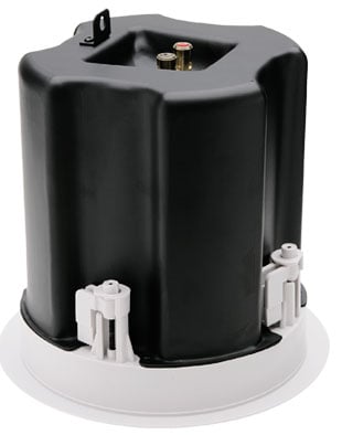

The backcans are made of 15 AWG steel and are stuffed with insulation. They provide a controlled enclosure for the speaker while also minimizing sound leakage to other rooms. RBH also offers a foam backbox called the FB-6C which simply expands into the attic after you push it through the speaker cut out and provides up to -9dB of isolation. I highly recommend using one of these options if you can as opposed to just installing the speaker free-air. A speaker of this caliber deserves to be treated like a high performance box speaker. Give it a controlled acoustical environment to achieve maximum performance.

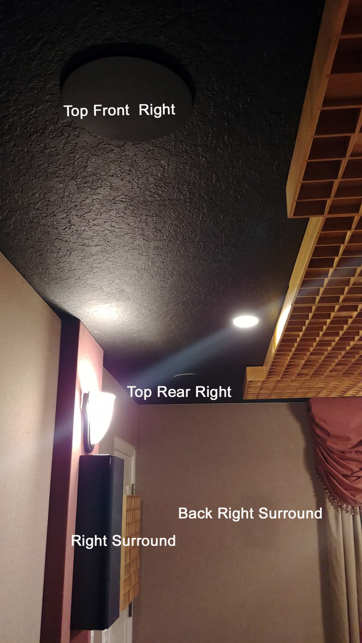

Since I have two rows of seating, I attempted to get the best possible coverage for both by ensuring the front and rear height channels weren't too close or far from either row. Both sets of height channels were positioned about the same distance apart as my front and back channels with the front height about 2-3 feet in front of the front row and the back height channels about 2-3 feet behind the back row of seating. The angles work out closely to what Dolby recommends (30-55 degrees) depending on whether the listener is positioned in my front or back row. The speakers are placed about as far apart as the main and back channels, again per Dolby recommendation. Height of the speakers relative to the listening position is about 2X that of my side and back channels (again within the 2-3X recommendation from Dolby). However, my 8ft ceilings did somewhat restrict how much separation I was able to achieve between ear level and height channels.
See: Dolby Recommended Speaker Placement
Speaker Layout Audioholics Showcase Theater Room (left pic) RBH SI-615 with standard white grill cover
The SI-615's do have a pivoting tweeter but I left it in the default position as I didn't find much use for directing only the tweeter towards the listening area. In fact, I believe height channels work best to provide broader as opposed to focused coverage which is the job of the ear-level "bed" speakers.
For installations where the angles are excessive (i.e. placing the height channels towards the front of the room), it may be prudent to consider a pair of VA-615s which have a 15-degree fixed offset 6½-inch woofer and 1-inch pivoting tweeter which allows the speaker to be pointed more directly at the listening position rather than just the tweeter alone.
I may add an additional pair of height channels towards the front of the room to do a full 7.1.6 Atmos setup when I get my hands on a AV processor that supports it, but right now I will just have to "settle" for 7.1.4. During the time of writing this review, I was using the Yamaha CX-A5100 Atmos processor and MX-A5000 11CH amplifier to power all but my Status 8T front channels. I chose to bass manage the SI-615's crossing them over at 90Hz. I see people on various forums touting the "bass" of the height channels which makes little sense to me since any good home theater uses multi subs and that is where ALL of the bass for small speakers (usually the front channels too) should be routed to. I would suggest using bass management and at least an 80Hz HPF on these speakers if you're using them for height channels. However, if you're running them as a stereo pair, then by all means, go full range.

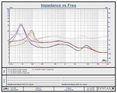

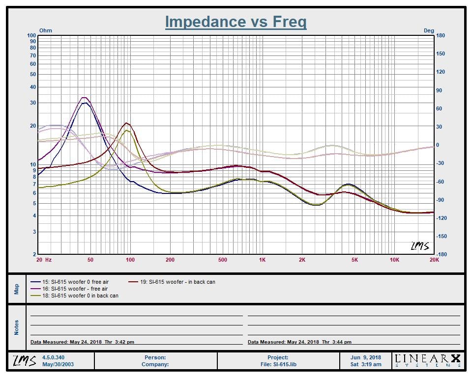

RBH SI-615 Impedance/Phase with and without back can
RBH rates the SI-615 as 8 ohm impedance, but they actually measure a bit lower at very high frequencies. In order to spec a speaker 8 ohms, per IEC, it should not drop more than 20% it's nominal rating (6.4 ohms). It appears RBH is using a 4-ohm tweeter to increase system sensitivity. Stil,l the phase angle is rather benign and given the high sensitivity, these should be an easy load for any receiver to drive without incident. The backcan raises system resonance from around 45Hz to just under 100Hz. You give up some bass adding the backcan but the isolation it provides is well worth it, especially since it will be used bass managed in most installations.

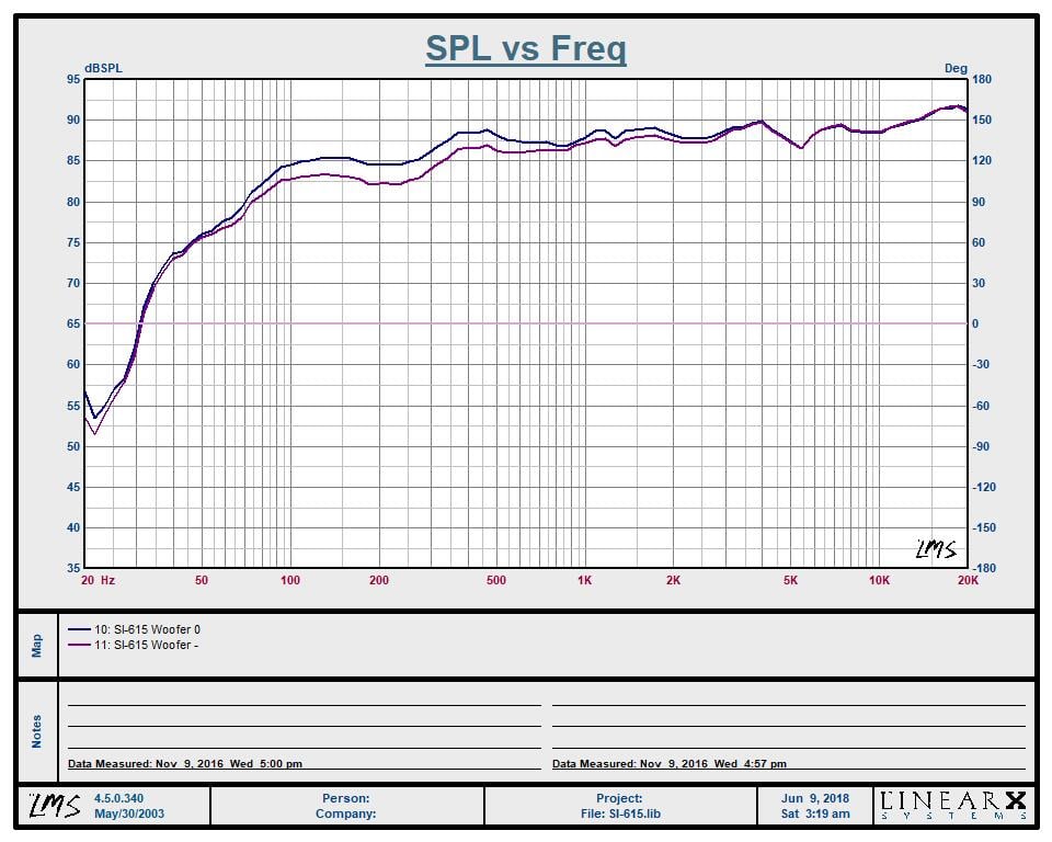

RBH Sound SI-615 2-meter in-room frequency response (smoothed)
This is a smoothed frequency response measurement of the SI-615 installed in the ceiling measured 2 meters away. The switch on the speaker (0 or -) toggles between woofer with or without resistor padding relative to the tweeter. IF you want the speaker to be subjectively brighter sounding, set the switch to “-“. I didn't find this to be necessary in my listening tests and instead preferred to employ the PEQ of my Yamaha CX-A5100 AV processor to do final system tuning.
