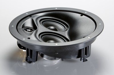

RSL side
Angled profile view of the C34E

The C34E is comprised of dual 4 1/2” polypropylene woofers and a 7/8” silk-dome tweeter.  The tweeter can swivel, making it easy to fine-tune and direct the tweeter’s frequencies post-installation.  A pivoting tweeter likewise makes the C34E’s highly flexible in a number of installation scenarios and allows the C34Es to be used as side and rear surrounds.

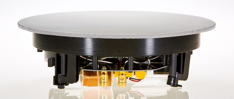

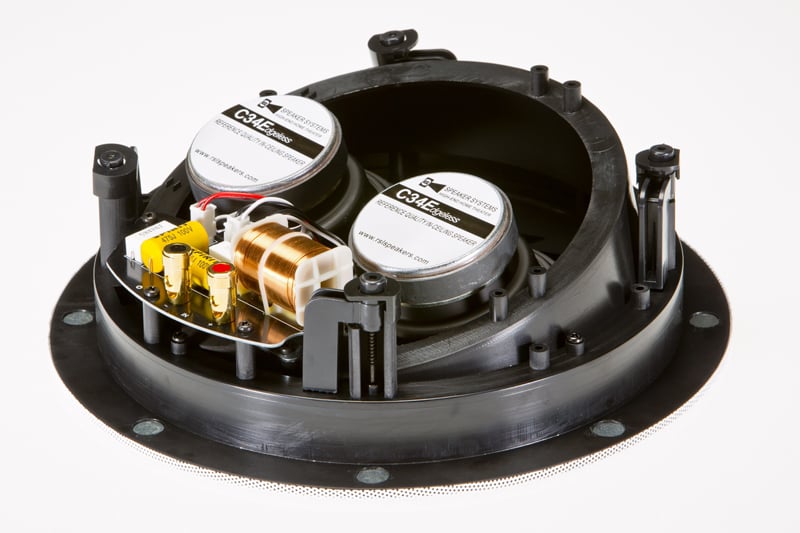

RSL back

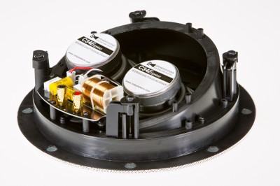

RSL C34E rear
When I spoke with Howard a bit about the design of the C34Es, he told me that the crossover on the speaker is a hybrid.  It is 12db on the woofers and 6db on the tweeter. Howard also told me that the C34E uses a quality air core inductor (no ferrite cores) and only polypropylene caps (no electrolytics). As you’d expect, push terminals are gold-plated.

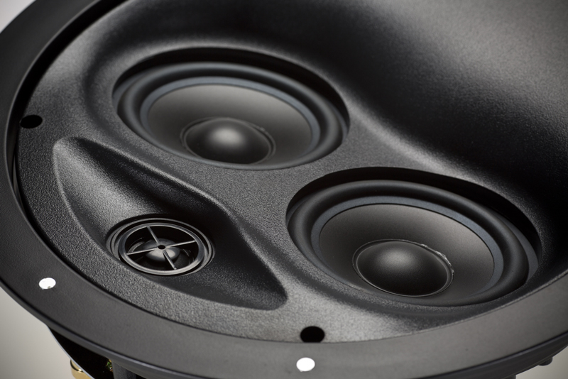

Many in-ceiling speakers mount the tweeter in the middle. To do so, they normally need to mount the tweeter with a bracket in front of the woofer.  For Howard and Joe Rogers, they couldn’t tolerate such a design.  Howard told me, “It causes an erratic frequency response as some of the sound bounces off the back of the tweeter (and in some speakers the bracket it’s mounted on) and reflects back into the woofer causing cancellation at various frequencies.”
Instead, RSL used a lateral alignment in the C34E where the tweeter is alongside the woofers. In addition, Howard told me that the baffle plate is molded so that the speakers are time aligned for phase coherency.  Also, the baffle plate is slightly angled allowing the user to aim the speaker as well as swiveling the tweeter.
 Just like their traditional speaker counterparts, the speaker grille is magnetic.  It also sports an edgeless construction that doesn’t require a trim plate.
RSL C34 Pivoting Tweeter

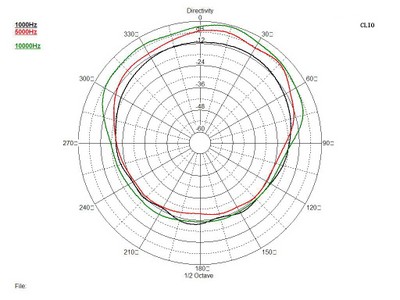

RSL C34 Polar Plot

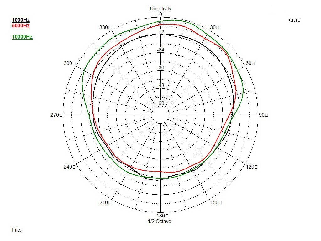

RSL C-34E Polar Frequency Response
RSL doesn't supply detailed frequency response data on their in-wall speakers because they feel it is highly dependent on the space behind the speaker.  However, I did manage to get them to send us a polar response plot which shows this speaker has pretty broad dispersion making it quite suitable to be used for immersive audio formats as a height channel.
