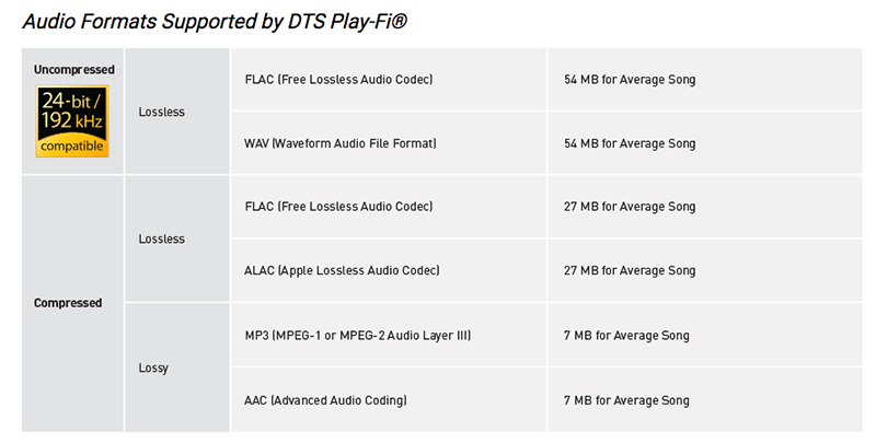

  • DTS Play-Fi allows for hi-res audio streaming

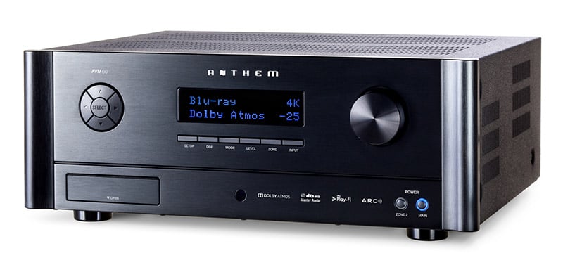

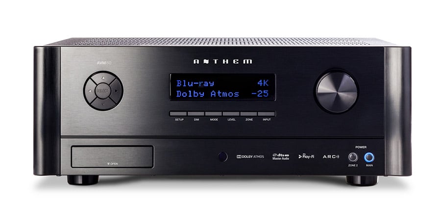

Anthem AVM 60 Introduction & Features
If someone were to write the history of high-end home theater, Anthem’s preamp-processor line would surely merit a spotlight. Anthem’s pre-pros are legendary. Their build quality, sound, upgradability, and of course heralded ARC room correction are just some of the factors that have made Anthem’s product line a huge success over the years.
Anthem AVM60 11.2CH AV Processor YouTube Review
When new technologies have come about, however, high-end boutique brands like Anthem usually aren’t the first ones out the door with new products. So when HDMI 2.0, HDCP 2.2, Dolby Atmos, and DTS:X hit the scene, it wasn’t necessarily a surprise that Anthem was holding fast to its long-in-the-tooth AVM 50v 3D pre-pro. While there were rumors and rumblings about an AVM 60 for years, there was nothing concrete… until now.
Anthem’s AVM 60 is by all accounts the long-awaited successor to the acclaimed AVM 50v 3D pre-pro and it checks off nearly all the essential boxes. On-board HDMI 2.0a with HDCP 2.2, HDR, and BT.2020 are all standard.

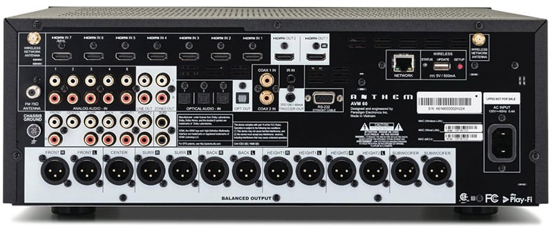

There are seven HDMI inputs on the rear and one on the front. You’ll find MHL support on the front HDMI and HDMI Input 7. There are two parallel HDMI outputs, though only HDMI Output 1 supports an audio return channel. HDMI switching between sources has the accustomed HDMI lag. I would like to see Anthem and other high-end products follow Krell’s lead and implement EDID caching support for each source so that you can have instantaneous HDMI switching.
Anthem AVM 60 Rear View
Rear view of the Anthem AVM 60.
The rear panel layout is identical to the current MRX x20 models. Instead of speaker binding posts, the AVM 60 has balanced outputs. Say bye bye to AM radio, multiple trigger outputs, component video output, and balanced analog inputs.For the first time, the AVM 60 brings standby HDMI bypass. You designate which HDMI input (including last used) functions as the bypass via the unit’s menu. Unlike the AVM 50v models, the AVM 60 eschews any on-board video scaling or processing.

I should note that we’re seeing a format war with on-board streaming to powered zone speakers. Yamaha, for example, is featuring its proprietary MusicCast across its product line; Denon its own HEOS; and companies like Onkyo and Pioneer are adopting Blackfire’s FireConnect. Speaking of zones, the AVM 60 stands as Anthem’s first pre-pro that can play a digital source in Zone 2 without mandating an analog connection or requiring you copy the Main Zone source to Zone 2. That’s a very welcome feature.

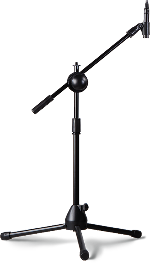

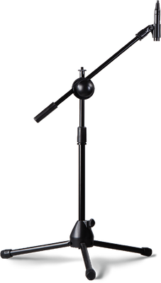

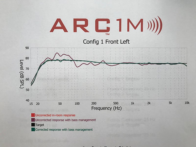

The newest ARC-2 room correction is standard and has several refinements over its predecessor.  I loved it. Unfortunately you cannot use ARC-1 files with ARC-2.  You’ll need to do speaker measurements from scratch.  ARC-2 supports four speaker profiles (up from two in ARC-1); comes with a calibrated microphone; high quality microphone stand; and a unique calibration file specifically for your microphone to compensate for any variances.  The new ARC-2 also allows you to print out a detailed report on your measurements and final configuration—a nice touch for custom installers to provide to their clients.
ARC-2 requires a separate Windows-based computer or a Mac running Windows via Bootcamp (sorry Linux users) to perform its calculations.  Unlike the AVM 50v, however, you don’t need an RS-232 connection. You upload your ARC results and calculations via your network—and boy is it fast.

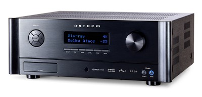

Anthem's AVM 60 supports 4k/UHD and Dolby Atmos
Anthem's AVM 60 supports all the latest HDMI 2.0a standards as well as 4k/UHD, HDCP 2.2, and Dolby Atmos. DTS:X support will be coming in a future firmware release.

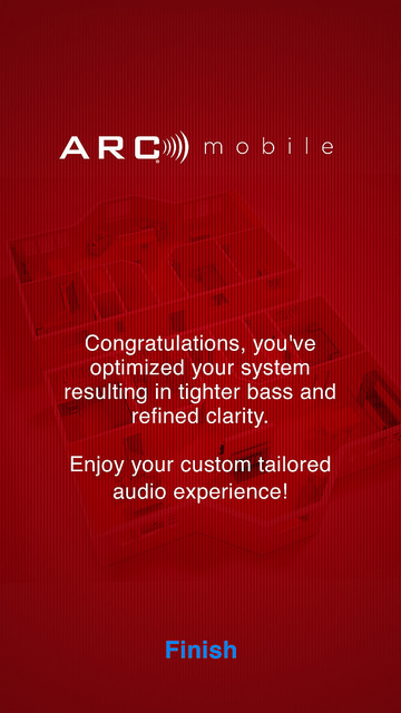

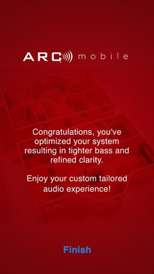

A major notable about the AVM 60 is that you can now conduct ARC measurements from your iOS device.  It’s simple and awesome. I covered ARC Mobile in more detail here. By the time you read this review you should be able to purchase an Anthem calibrated microphone that plugs into your iOS device. This is simply brilliant and clearly the future direction of the product.

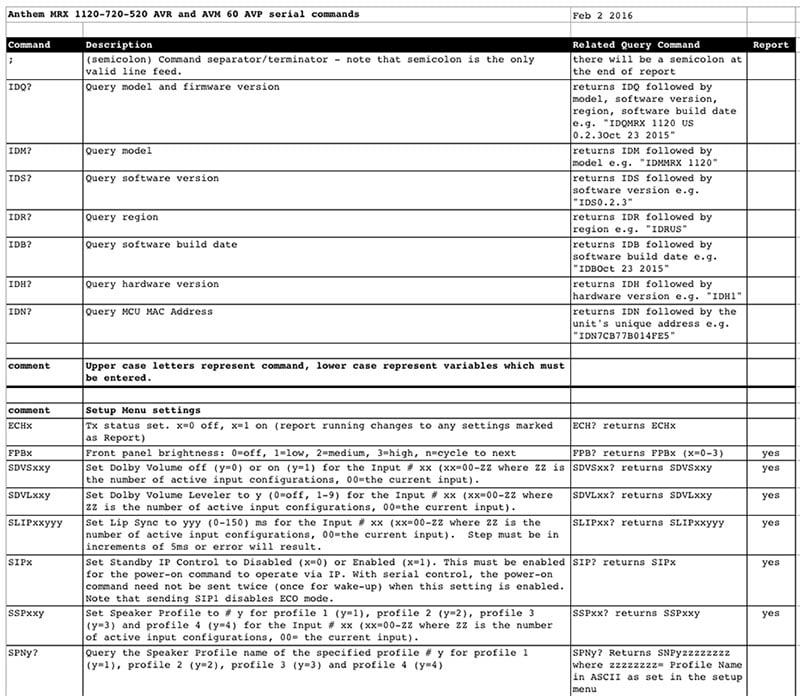

Serial Commands
The AVM 60 has an extensive IP and RS-232 command set that is fully documented in a downloadable Excel file from Anthem's web site.
This reality simply means that with the AVM 60, you’ll need to push some of this functionality over to your home automation system, (assuming you have one). With the AVM 60’s rich IP and RS-232 command set you can accomplish seemingly any task easily. You can download an Excel file from Anthem’s site that that outlines every command you can call on the AVM 60. I’ve written some custom installation scripts using the RS-232 command set on the AVM 50 platform and was very happy to see that I had the same detailed control with the AVM 60.
