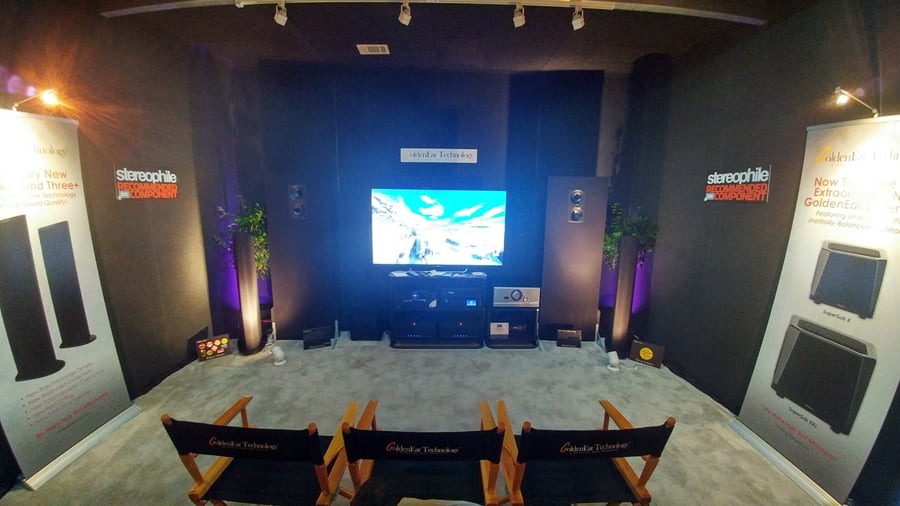

At CEDIA, GoldenEar Technology wanted to demonstrate that you can, in fact, have an all-architectural Atmos installation.  While they called it an “invisible” Atmos system, it was simply a setup consisting of in-wall and in-ceiling speakers with a one of their new ultra-compact subs.

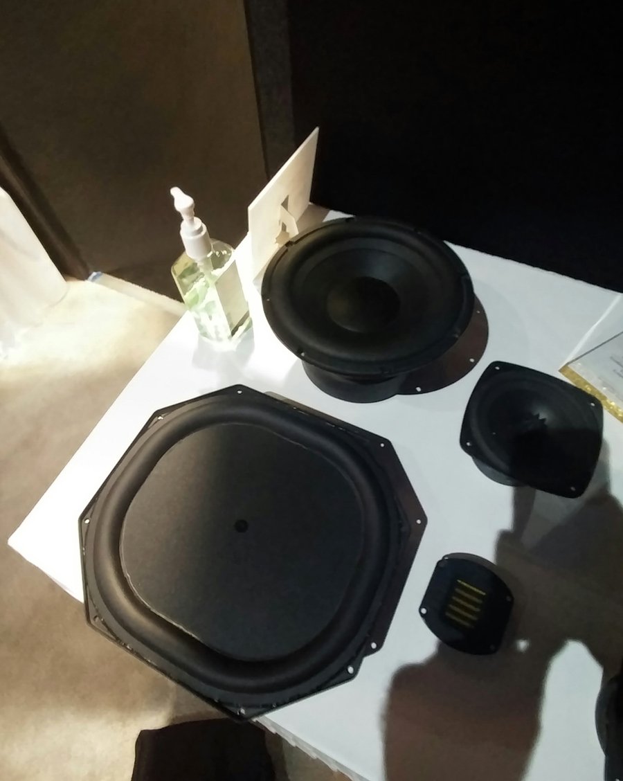

GoldenEar Drivers
GoldenEar Drivers

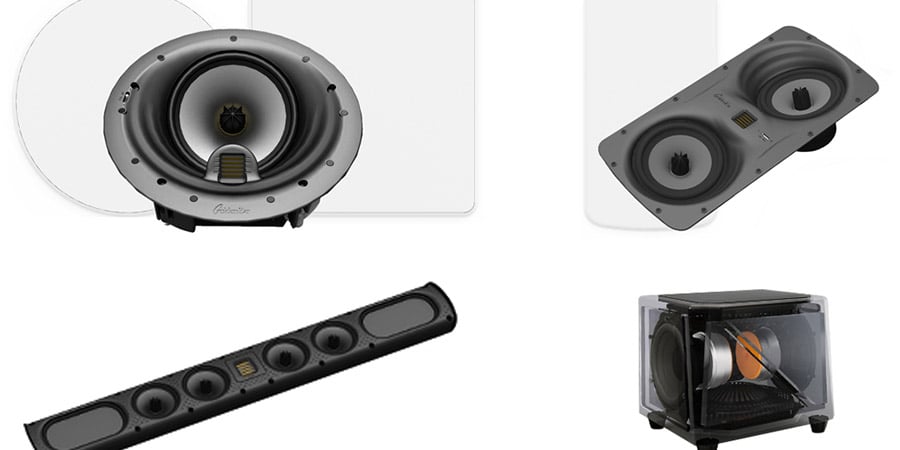

To set up their system at CEDIA, GoldenEar used their Invisa MPX in-wall/in-ceiling loudspeakers for the front and surround channels, which retail for $499/ea. The Invisa has two 5-inchbass/midrange drivers and a High-Velocity Folded Ribbon Tweeter in a woofer-tweeter-woofer arrangement. The same loudspeakers were used for the rear surrounds.
For the center channel, GoldenEar used their SuperSat 60C center wall-mounted speaker above the display arguing that its usually more convenient for people to place a low profile speaker above or below an HDTV display than installing an in-wall speaker. The SuperSat 60C has a frequency response of 50Hz to 35Hz with four 4 1/2-inch cast basket midbass drivers, two 4-inch x 7-inch quadratic planar low frequency radiators and one of GoldenEar’s high velocity folded ribbon tweeters.
For the four height channels, GoldenEar used the Invisa HTR 7000s, which likewise for the same $499/ea.  The HTR 7000 are angled.  You can therefore point the height channels towards the listening position.  When I installed my Dolby Atmos/Auro-3D theater speakers, I similarly used angled speakers for the height channels with spectacular results. The HTR 7000s have a 7-inch cast-basket driver and a HVFR tweeter.
Rounding out the demo was GoldenEar’s just announced ultra-compact subwoofer, the SuperSub X.  All in all, GoldenEar set up this 5.1.4 system taking up pretty much zero floorspace (except for the nearly 12 1/2-inch squared ultra-compact subwoofer) while maintaining the ideal of two levels of speaker placement.  The cost? The total system cost for the speakers was $6,049, not accounting for wiring, installation labor, or electronics. A Marantz AV8802A Atmos/DTS:X Processor powered by dual Parasound Halo A51 5CH amplifiers was utilized to power the speakers and an Oppo BDP-105D Blu-ray was the source device.
First-hand listening impressions
GoldenEar DemoGoldenEar put on quite a great Atmos demo with their 5.1.4  in-wall / in-ceiling speaker system powered by one SuperSub X for bass duties.  During our  listening tests we thought for sure there were at least two of those subs playing but Sandy informed us it was just one.  Impressive, most impressive. GoldenEar demoed an animated movie and Star Wars Battlefront game demo both of which did a nice job showing off the immersive effect the system produced.  Kudos to Goldenear for doing Atmos the right way and not the bouncy house speaker method that we've always found to be far less effective.
