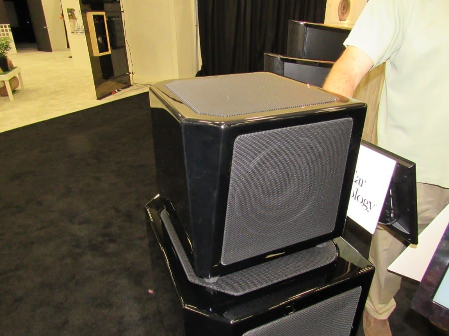

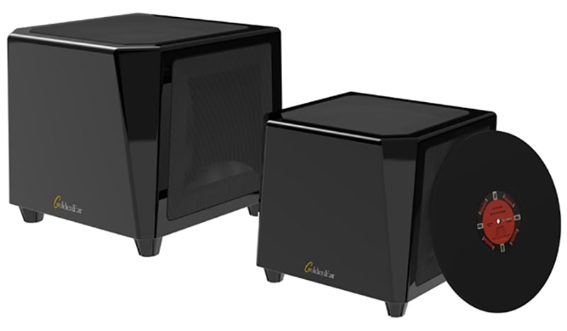

GoldenEar caught our attention At the 2016 CEDIA Expo show, with the announcement of its SuperSub X, and envisions it as sitting atop the ultra-compact subwoofer world. The company says the SuperSub X is a smaller version of its SuperSub XXL. Like the larger XXL, the SuperSub X features GoldenEar’s Dual-Plane Inertially-Balanced Technology, which the company says is patent pending. The SuperSub X has a 360 degree dual-plane inertially-balanced driver and sub-bass radiator topology, combined with a DSP engine.
Golden Ear SuperSub XXL and SuperSub X
GoldenEar says that the SuperSub X (right) is a smaller version of the SuperSub XXL (left)

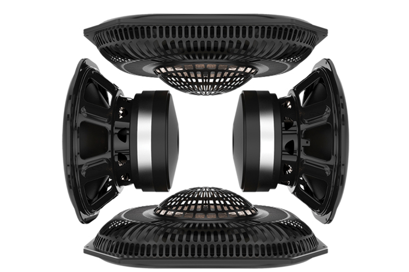

GoldenEar says, “force-cancelling inertial balancing preserves, conserves and focuses all the energy produced by the transducers in order to more effectively move the air in the room (rather than vibrating and shaking the cabinet).” In simple terms, the full impact of the subs drivers go into the room and don’t rattle the sub’s enclosure.

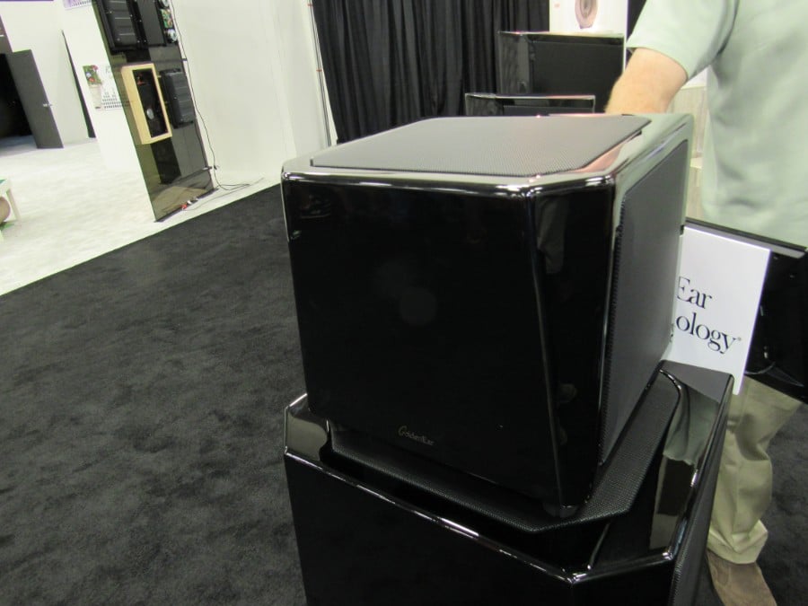

The SuperSub X’s fit-n-finish is a high gloss piano black lacquer cabinet in a spouse-friendly cube that’s almost 12 1/2-inch squared (it’s actually 12-3/4-inch H x 14-inch W x 13-1/4-inch D). The enclosure is made of thick, high-density medite (though GoldenEar didn’t specify the thickness of the enclosure).
There are two 8-inch long throw drivers and two 10 1/2-inch by 9 1/2-inch quadratic planar infrasonic radiators.  The active drivers are powered by a 1400 watt Class D Digital Amplifier, that GoldenEar says was originally developed for the company’s Triton One tower speaker.
GoldenEar SuperSub X four driver configuration
GoldenEar's SuperSub X has two active and two passive drivers
