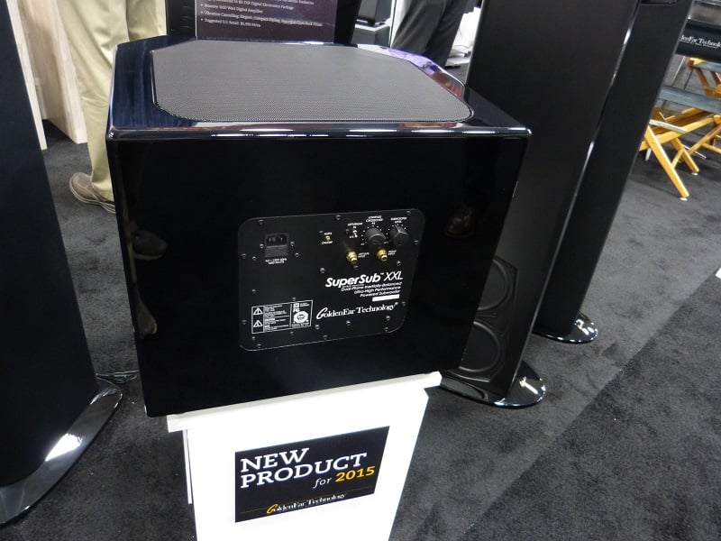

- Inputs: Direct Coupled, unfiltered LFE -input / Low Level Left and Right channel inputs

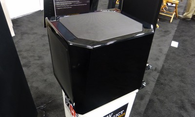

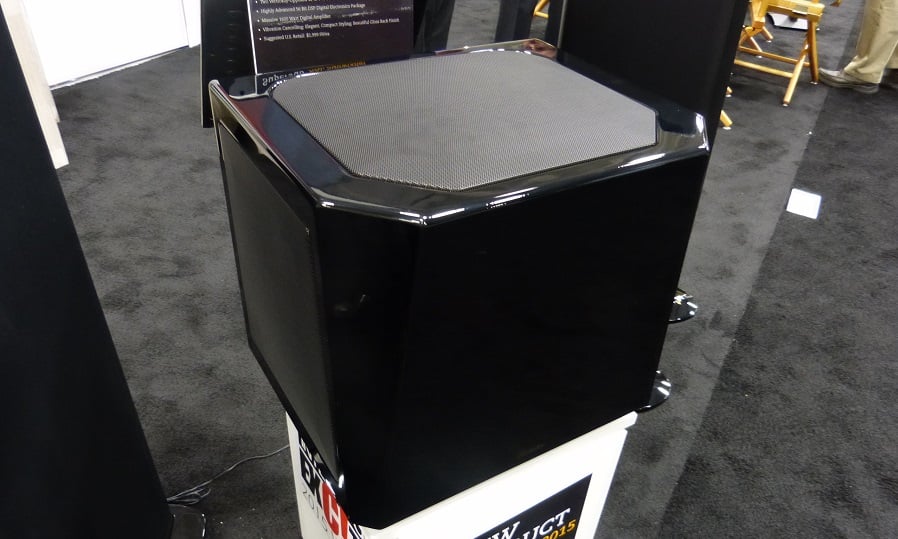

We got a chance to see GoldenEar’s new SuperSub XXL subwoofer last week at CEDIA and were impressed with the performance for its moderately sized form factor. GoldenEar employed what they call a 360 degree dual-plane inertially-balanced driver and sub-bass radiator combination to reduce cabinet resonances and distortion. Sandy Gross claims he could balance a nickle on the cabinet running it at full power and it won't move. We didn't confirm this, but he did shake up the demo room pretty well with this impressive subwoofer.
The enclosure of the XXL is constructed of thick, high density medite, which is finished in high-gloss piano black lacquer. Two 12” long-throw active drivers in the horizontal plane and two 12 ¾”x14 ½” planar infrasonic radiators in the vertical plane drive the sub to effectively move air in the room. GoldenEar Technology says that's because there are two active drivers which are separated horizontally in space, as well as two passive radiators which are separated vertically. GoldenEar claims the driver-to-room coupling is distributed more smoothly as the different driver locations couple to different room standing wave patterns, and work well with the room modes.
The electronics package that drives the driver and radiator arrays is made up of a 1600 watt Class D Digital Amplifier, originally developed for their Triton One floorstanding speaker. It is controlled by a 56 bit DSP device with a 192 kHz sample rate. This Programmable Logic State Machine is reported to have 278ns update time to manage functions including frequency response, soft clipping, DC offset control, output-stage saturation control, discrete multi-band limiting and phase-perfect equalization.
The amplifier also utilizes small, separate power supplies for each circuit section in order to provide isolation, so there is little opportunity for coupling through the power supplies.
GoldenEar utilizes reconstruction filters in order to maximize damping factor. The RCA inputs are provided for both LFE connection, as well as low-level connection from a stereo source.
