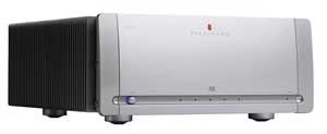

At first look the Parasound Halo A 21 and A 51 are appealing and robust amplifiers accented by brushed metal finish and a "Halo" aqua blue light around the power button. But an amplifier is not just about cosmetics especially when considering that most Audio Enthusiasts seem more interested in sound quality and features. The A 21 and A 51 amplifiers are both loaded with usable features above and beyond most other amplifiers in today's market.
The understated look of the A 21 / A 51s subtle yet empowered front panel implies a need for a space aged protective shell that contains a powerful yet precious cargo. For example the "P" on the top of the front face glows red to indicate that the unit has AC power as does the "Halo" insignia around the power button which accents the power button with its soft blue glow. Once the power is turned on the soft blue changes to a brighter blue after all circuitry has been initialized. In the center bottom of the front face are the two indicators that verify proper functionality of each channel by glowing with a different shade of blue. On the right bottom is another indicator that glows red if the unit overheats with a redundancy portrayal from the "Halo" insignia that also switches to red.

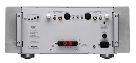

The back of these two amplifiers will meet the highest consumer specifications starting with balanced and unbalanced input connectors for each channel. The designers at Parasound also added pass through connectors for those who have the need to route the signal to another device. These connectors eliminate the need for a Y-adapter dangling off of the back, but they are only provided for the unbalanced (RCA connector).
Parasound cleverly thought to make the input connector larger than the pass through connector so that end users and custom installers wouldn't confuse the two. One of the purposes of the pass through connectors would be to route to another amplifier for bi-amping speakers. Also provided for each channel are gain controls for matching to a variety of different pre-amplifiers or controllers, thereby ensuring that Parasound doesn't limit the usefulness of their amplifiers to only their products.
The speaker connection binding posts are located at the bottom-center of the rear panel. At first I thought it was unusual that the positive connectors were configured on the inside and the negative connectors on the outside but after further investigation this orientation was intentionally designed to enable bridging of the two channels. This atypical placement comes in especially handy for those who desire the more powerful 750 Watts of RMS power into 8 ohms.
There are three dedicated switches for each channel on the back of the amplifier. One can be used to switch between balanced and unbalanced inputs, while the second can be used for switching from stereo to mono or bridged mode. The third and left most is a uniquely implemented grounding switch. The ground switch can be used to help reduce hum or buzz, common with ground noise or ground loops. This hum or buzz comes from the 60 Hz AC or its related harmonics that can intrude the signal when the system ground is not exactly at 0 volts. By changing the position of the switch it separates the signal ground from the chassis ground.
On the left top of the rear panel are two connectors, a three position toggle switch, and a small potentiometer control that can all be used for "power on" options. With the toggle switch in the up position, the audio mode is chosen to bring the potentiometer into play. This mode sets up the A 21/ A 51 to sense an audio signal at the signal inputs which then triggers on the amplifier. The potentiometer is used to set the sensitivity of when the amp turns on which can vary from 50 mV to 200 mV. This is a great feature for users with older equipment that may not have a devoted triggering. The middle position of the switch is a manual trigger which activates the power switch on the front panel. The down position of the toggle enables the 12 volt trigger input common to most new equipment. The clever Engineers at Parasound have also provided a trigger output to carry on to another device. Parasound equipped their amplifiers with a sub-mini connector to match the Halo C 1 / C 2 processors. When connecting other processors such as our reference Integra Research RDC-7 that implements a mini-connector, an adapter is required.
In order to cope with the robust heavy weight of the Halo amplifiers, Parasound provided sturdy handles on the back panel making it easier to install or reposition.

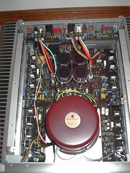

There are many manufacturers of home theater electronics who place a high emphasis on cosmetics in order to make their gear look as though it where of a higher quality from the outside, though most of them never expect anyone to look under the cover. Parasound is not one of those commonly found cosmetic only companies as the build quality of the outside of their amplifiers are transposed to their inside. When removing the cover of the Halo A 21 and A 51 amplifiers, what becomes most apparent at first glance is their massive toroidal transformers with independent secondary windings for each channel. In essence this feature means that each channel has its own devoted power supply. Combining the transformer with four 80 volt 25,000 microfarad capacitors ensures that the Halo amplifiers are capable of providing plenty of reserve power when the source content requires low impedances and maximum current. Such a design reveals how Parasound justifies their specs with sufficient high quality components implemented within a well conceived design. I also noticed that all of the resistors were 1% tolerance parts thereby ensuring excellent stability for the signal path.
As you can see from the above pictures, there is minimal wiring within the Parasound amplifiers. This means that the signals are carried directly from the connectors to the circuit board which can greatly reduce the possibility of noise infiltration. The A 21 and A 51 also sport internal and external gold plated connectors which tend to be an uncommon feature.
The amplification sections of the A 21 and A 51 were equally as impressive as the other portions of Parsound's design. All of the transistors are discrete as opposed to integrated circuits. The input stage uses matched pairs of JFETs and the driver stage uses matched pairs of MOSFETs which tends to give a less harsh and colored resulting sound. These two stages give the amplifier its sonic signature while the output stage gives the amplifier its high current capabilities. Parasound also implement bipolar transistors in the output stage since such a design typically results in very rugged high current capability.

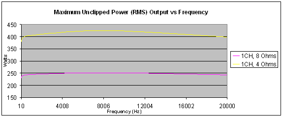

This test shows demonstrates the frequency response linearity of the power amplifier within the audible range at 1 watt and full power. As you can see, the A 51 maintains + 0.2 / -0.36 dB from 20 Hz to 20 kHz which is excellent. Notice that the linearity remains even during maximum unclipped power output into 8 ohm and 4 ohm loads indicting that this amp doesn't suffer from slew induced distortion typical of lesser designs.
Editor's Note: Parasound specs this amp at +/- 3dB from 5Hz to 100kHz at 1 watt.
I was able to measure about 250 watts into an 8 ohm load and about 400 watts into a 4 ohm load across the entire audio bandwidth. Please note that during the 4 ohm load test, my wall voltage sagged from 116VAC to 112VAC. Without having a VARIAC to hold the line voltage constant, it is difficult to accurately measure all channels driven with such a powerful amplifier. However, given the fact that the A 52 is endowed with a 2.2 kVA transformer and 164,000uF power supply, I think it's safe to assume this amp will deliver its rated power into all channels at 8 ohms. It will deliver marginally close to its rated power into 4 ohms. In order to do a true 400 watts/ch into 4 ohms continuously, would require a power transformer about 65% larger than the one in the A 52. Of course this all assumes you hold the line voltage constant and have at least a 20A dedicated line to power it. Since a continuous all channels driven scenario is both unrealistic, impractical, and unlikely this should be of little concern to most users.
We ran 1 kHz, 5 kHz and 10 kHz square wave tests at 1 watt into 8 ohms and found no excessive overshoot or ringing or slew induced distortion. The Parasound A 51 amplifier is more than capable of driving any speaker load in even the most demanding home theater systems. Only folks dealing with sound reinforcement applications may thirst for more power, but usually at the expense of higher noise and distortion. The linearity of this amplifier is excellent at any power level it is operating in, and its freedom from audible noise and distortion makes it a true winner!
