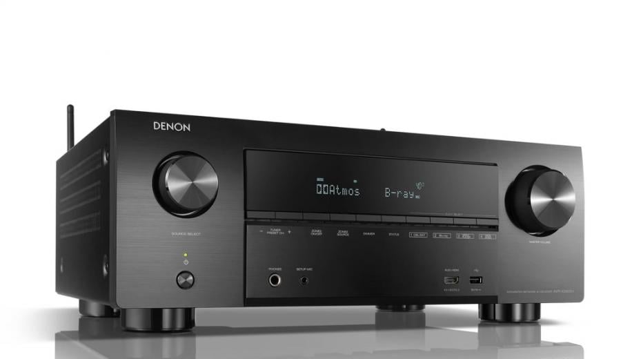

I recently recommended a Denon AVR-X3600H 9.2CH AV receiver to my brother who was looking to upgrade his surround receiver. After he had it all set up and dialed in, he called me to complain that his streaming music from Pandora and Tidal was dumping too much sound to his center channel and it didn't sound right. Alas, I knew the fix. All he had to do was engage "Center Spread" when the DSU was engaged. After instructing him how to do this, I sent him on his way only to get a second call from him the next day saying he couldn't find the feature. Realizing my brother isn't the most technically proficient DellaSala, I facetimed him to show him the menu procedures in my Marantz SR8012 which has a similar GUI to the Denon AVR-X3600H. I was perplexed that I could NOT find that feature on his AVR. I instructed him to email Denon tech support and the next day he got a reply stating that the "Center Spread feature has been eliminated by Dolby in ALL licensed products from 2020 and beyond". I was stunned by this revelation but confirmed it was true. In fact, I also received feedback from a fellow Audioholic that his Pioneer receiver went through a recent firmware update and he noticed the "center spread" feature was eliminated. This reminded me of the Dolby Restricting Non-Native Upmixing on Atmos Based Products revelation that we uncovered two years ago. It seems Dolby is at it again but this time it makes no sense since the "center spread" feature is a useful tool to music enthusiasts wanting to enjoy their 2CH music upmixed with the DSU.
