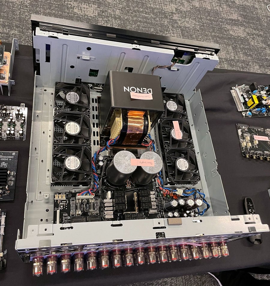

Denon AVR-A1H topless

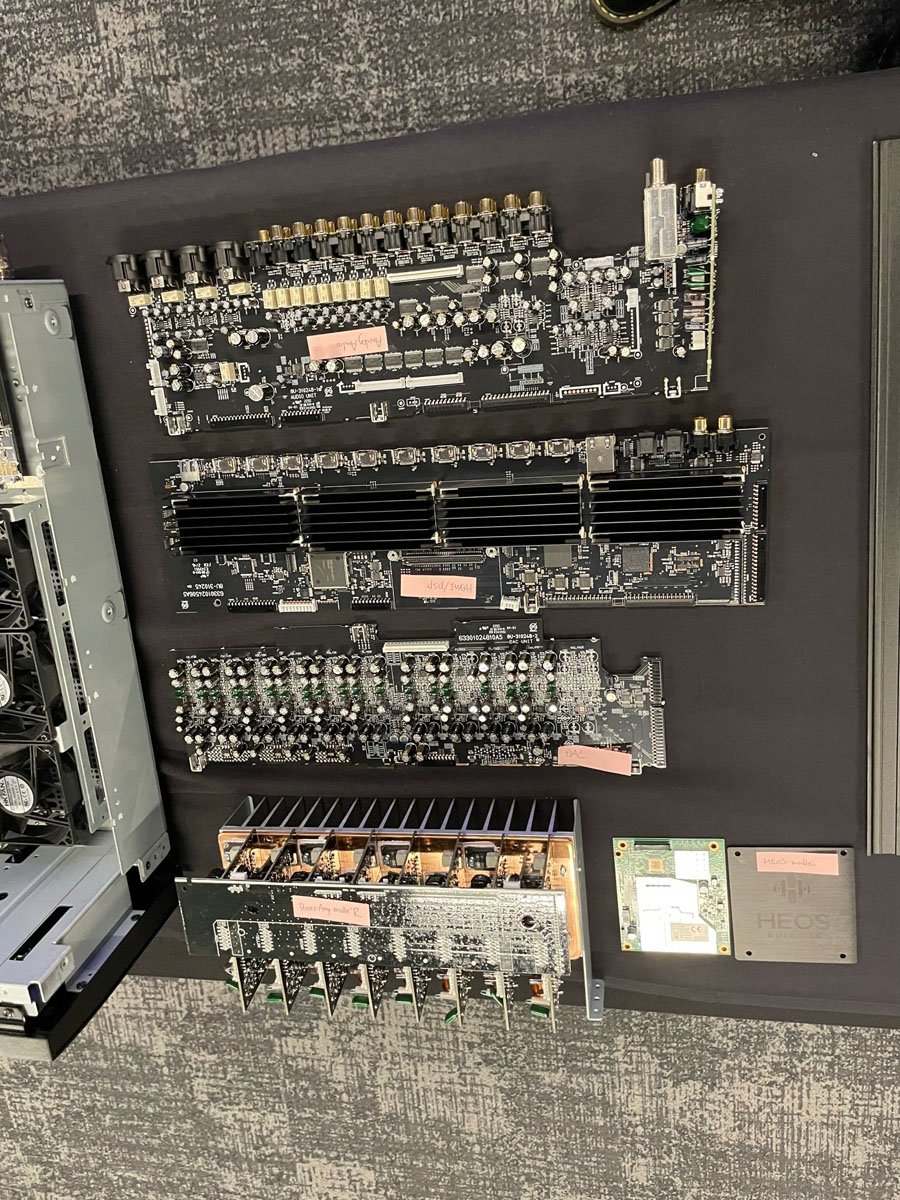

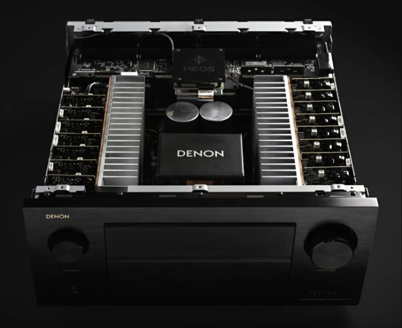

Denon’s press materials promise electrical and mechanical parts that are “Hi-Fi grade,” but thanks to Matthew’s reporting, I can offer more detail. The AVR-A1H uses a new amplifier module (shared with other models in the Denon lineup) that uses a high-current 4-pin transistor. The 4th pin is a thermistor that allows the amplifier to track temperature changes and re-bias itself automatically. Very cool. As you might expect for a 15-channel amplifier, the power supply is enormous —  the E-Core transformer is reportedly the largest ever included in a Denon receiver. Not since the venerable AVR-5805 have we seen such a beefy power supply in an AVR.

The AVR-5805 had a fifth foot at the center of the chassis to support its massive toroidal power transformer (borrowed from the AVR-5803) and two additional E-Core transformers borrowed from the AVR-2805!) The AVR-5805 employed multiple high voltage (80V) capacitors (4 x 33,000uF = 132,000uF, or 66,000uF per rail). According to Denon, the two additional EI core’s for the AVR-5805 were to supply power on both analog and digital circuits individually, not for driving the power amplifier section. Due to advancements in circuit design, the AVR-A1H doesn't need such a huge power transformers any more to power analog or digital circuity.
The block capacitors for the power amplifier are indeed of “unprecedented size” for Denon, rated at 33,000µF each (compared to 22,000µF each in both the AVR-X8500H and the 110th Anniversary AVR-A110). The power supply capacitors are custom-made for Denon by Japan’s Nichicon Corporation. These are 4-pole capacitors — a 4-pole filter is created by the arrangement of the internal capacitor coils, yielding a filter that leads to much lower inductance, according to Matthew Poes. The power transformer, which sits on a 2mm-thick copper plate, is 41% heavier than the one used in the X8500H. In fact, at a whopping 25.4 pounds, the power transformer in the AVR-A1H is nearly 4.5 pounds heavier than an entire AVR-X2800 receiver!

Denon HDMIThe AVR-A1H supports both 8K pass-through and 8K upscaling of 4K content thanks to a brand-new 8K HDMI board. 4K at 120Hz is also supported on all inputs. Next-gen gamers, take note. The brains of the operation lie on a cutting-edge, dual-core, 1GHz digital signal processor (DSP), with enough number-crunching ability to power a smart phone. Denon says this represents a major upgrade over the last-generation chips. Compared to the 2-chip DSP in the AVR-X8500A, the AVR-A1H’s DSP can deliver 25% more MIPS (Million instructions per second) and works at a clock speed that’s over twice as high. All of this processing power is needed in order to support the high channel count and latest HDMI features. It also helps enable the AVR-A1H to offer a great deal of flexibility. For example, all four of the subwoofer outputs can be individually tailored with crossover, level, delay, and so on. If you prefer to use RCA outputs for your subs instead of XLR, those XLR outputs can be reassigned, allowing you to take advantage of a balanced connection between the AVR-A1H’s preamp and an external 3-channel power amp for your front left, right, and center-channel speakers. No, you don’t need a separate amp for your front stage, but why not try a Parasound Halo A31, a McIntosh MC303, an Anthem MCA 325 (Gen 2), or an ATI AT543NC if you're craving more power? Alternatively, if you don’t plan to use all 15 channels of the AVR-A1H’s built-in power for a 9.4.6 setup, you can reallocate unused amp channels to bi-amp the front stage speakers or reassign them to other zones or bypass them entirely for the purest preamp out signal.

All of the expected audio/video formats are present and correct on the spec sheet, including Dolby Atmos, DTS:X Pro, IMAX Enhanced, Auro3D, Dolby Vision, HDR10+, and HLG. The new HDMI board promises ALLM (Auto Low Latency Mode) pass-through and VRR (Variable Refresh Rate) for all you gamers out there. As expected, the AVR-A1H works with Denon’s HEOS streaming platform, but it’s also usable as a Roon endpoint via Apple AirPlay 2. For those choosing to eschew the HEOS app, the AVR-A1H can be controlled by a new back-lit remote control with an aluminum top and a substantial-feeling 7.3-oz weight. As is often the case with flagship Denon receivers, there are really too many features to count, let alone list here. But a couple of small things stood out to me. Unlike the AVR-X8500H, the AVR-A1H has a stereo balanced XLR input, perfect for the analog output of your favorite high-end DAC. It also comes with a 5-year warranty, instead of 3 years on the X8500H.
Denon InsideI’ve no doubt that one of my colleagues at Audioholics will be getting an AVR-A1H in for review, so I don’t feel the need to sum up everything here, but I do have a few thoughts. As I write these words on February 3rd, 2023, the AVR-A1H has officially begun shipping. On paper, it looks fantastic.
