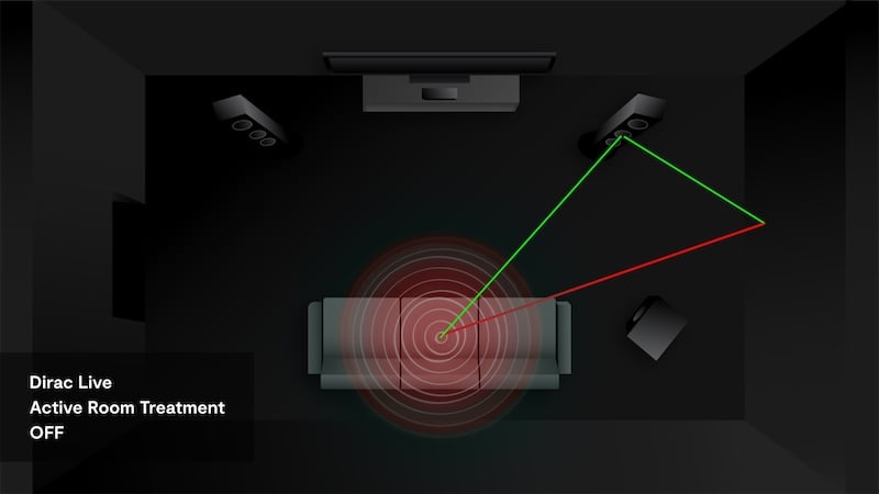

Dirac Live Active Room Treatment will join the company’s established room correction suite consisting of Dirac Live Room Correction and Dirac Live Bass Control. Although we haven't had a chance to test the finished product, this will be a brief rundown of the breakthroughs in optimization that should make Dirac's new technology an important step forward in DSP room correction. The biggest new addition to Dirac Live arrives from the digital audio company's experience with MIMO, mixed-phase impulse response correction technology systems. This is the mammoth step forward from existing room correction systems including previous iterations of Dirac Live that relied on SIMO, a single-input correction system that could only make corrections to one speaker at a time. Employing its new multi-input system means the room calibration microphone is reading sound from all speakers simultaneously. While using multiple microphones in key listening areas throughout the room, Dirac says that for the first time it can achieve true spatial optimization of your home theater’s sound. While Dirac Live Active Room Treatment isn't the first to employ multiple microphones to optimize for multiple listening points, it is the first to allow each microphone to detect and correct sound from all of your system's speakers simultaneously. The ability to read input from all-speakers at once is the force-multiplier for multi-point (multi-mic) room correction analysis that makes it a true spatial optimization of your room's sound. The results promise to extend the acoustic sweet spot to every seat in the room.

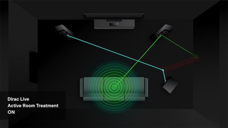

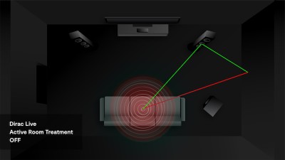

Many of the problems room correction systems attempt to solve are caused by physical interactions of soundwaves from different speakers as their sound reflects around the room. Single-input systems, those that work by monitoring and then filtering sound for one speaker at a time, are inherently limited in their analysis and corrections for these problems, as they can't stop the reflections. Dirac's new room correction paradigm analyzes the sound as each speaker’s output converges around the room on the listening area being monitored, allowing it to correct for the consequences of all those reflected soundwaves at once. The result as Dirac suggests, is at least a diminished need for low frequency passive room treatments for problem-areas around your room. It effectively is actively damping the room modes at the source using the speakers you already have.

The final major point in this overview is what Dirac can do with multiple speakers to acoustically clean up the sound in your audio room. Dirac Live Active Room Treatment uses technology similar to Active Noise Cancelling to filter or nullify over-represented frequencies inside the room due to reflections and interactions between multiple speakers playing back at once. In effect, one hand (or one speaker) washes the other - this capability scales upward no matter how many speakers are in your system. Rather than being a detriment to the systems ability to clean-up errant sound waves due to a high speaker-count in the room, it’s actually a plus to the new Dirac system as it intelligently takes advantage of your speakers to further filter errant sound.
Dr. Lars-Johan Brännmark, Research Fellow and Chief Scientist at Dirac calls it “Loudspeaker Co-Optimization”, the process that allows Dirac Live Active Room Treatment to apply room-correction to each speaker in your multi-channel system simultaneously as they work together to create equal results across the spatial plane. Thus further optimizing sound for your audience at every seat in the room.

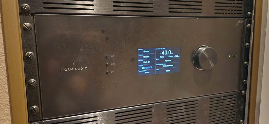

If you purchased a StormAudio Processor or AVR Jan 1st 2023 or later, the Dirac Live Active Room Treatment firmware update will be included at no additional cost. Expect to see Dirac’s new firmware available sometime in spring 2023. You can be sure Gene and Matthew will fully test the new addition to Dirac Live. Gene will test on the StormAudio 24CH processor at the Audioholics SmartHome this spring and will have a full report. StormAudio customers who purchased their product before Jan 2023 can receive the update after spring 2023 for a licensing fee of $299.
