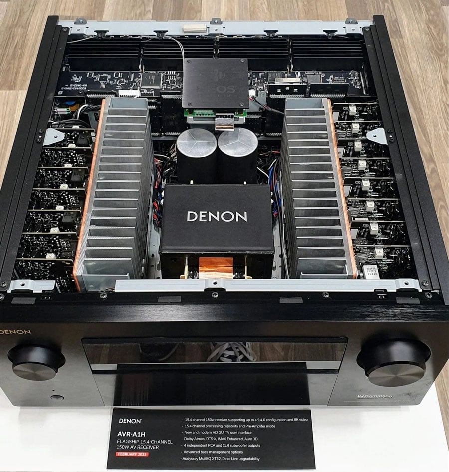

Denon AVR-A1H is a 15.4CH AV receiver that supports 150wpc x 15, & 4 independent subwoofer outputs
