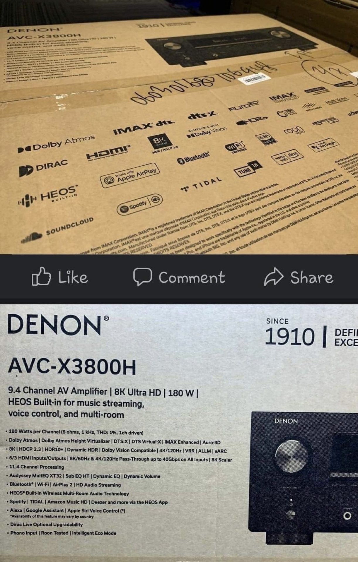

Denon AVR-X3800h boxLast week we saw a leak of new Denon and Marantz AV products on all of the major audio forums. The new Marantz AV 10 and AMP 10 Separates look absolutely killer...IF you could afford their $7k/ea price tag. But what if you want to assemble a separates system on a more down to Earth budget? Most AV processors are upwards of $3k and they typically have only 1 or maybe 2 subwoofer outputs (some dual sub outs are NOT independent). Having two and preferably four independent subwoofer outputs is a must have feature for anyone setting up a home theater that wants perfect bass response. Independent level and delay control is the best way to optimize the response of 4 subwoofers in your room and that type of bass configuration ensures reduced seat to seat variation in bass response making EQ highly effective at eliminating bass bass peaks for ALL seated locations.

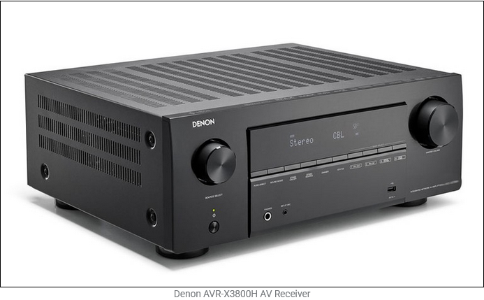

Looking at the specs for the new Denon AVR-X3800H, we see the makings of a great affordable Preamp/Processor:
  • 11.4 processing (9CH of built in amplification)
  • Upgradable for Dirac Live
  • Auro 3D
  • Full set of 6/3 in/out hdmi 2.1 support (40Gbps on every input)
  • Dirac filters working with Dynamic EQ/Volume (not confirmed)
  • Preamp Disconnect Mode
From ASR: The biggest news, according to an insider, is that D&M have worked with Dirac to offer the first ever Dynamic EQ + Dynamic Vol of Audyssey side by side with Dirac Live. Up until now, no AVR/AVP with Dirac has Dynamic EQ capability (Dolby volume is limited to Dolby-only content).
Preamp Mode: Check
Used as strictly an AV receiver, the Denon AVR-X3800H has 9 channels of built in amplification. Denon rates the power at 180 watts/ch (6 ohms, 1kHz, 1%, 1CH driven). So much for Truth in Power. The real world power into 8 ohms, 2CH driven, is closer to 125-130 watts/ch which is still sufficient for most users needs. The fact that this unit has a preamp disconnect mode and the ability to route the amps to specific channels means you can add a high power 2CH amp to power your main speakers. In fact, If you want to use this receiver in full preamp mode, you can bypass ALL of the internal amps and connect external amplification making this a true 11.4 preamp/processor. In our prior bench tests of Denon and Marantz AV receivers, we found clean preamp sections capable of driving 4Vrms which is more than twice the voltage needed to drive most multi-channel amplifiers into clipping. In other words, these are all the good markings of a dedicated preamp/processor.

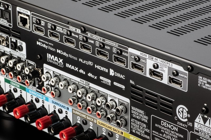

Denon x3800 Back
Denon AVR-X3800h Backpanel View - note the 4 subwoofer outputs

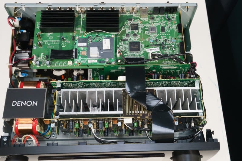

Denon 3800 No Cover
Denon AVR-X3800H Top Cover Removed
The Denon AVR-X3800H has a lot of tech crammed into it's case. You can see the large E-Core transformer in the lower left corner and the dual extruded aluminum heatsinks for the 9CH built in amplifier to the right of the power transformer. The dual heatsinks on the childcard at the back of the unit are likely to keep the HDMI 2.1 chipsets cool to ensure stable and long lived performance.
