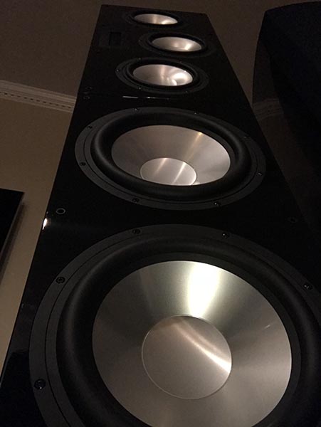

Design and Build

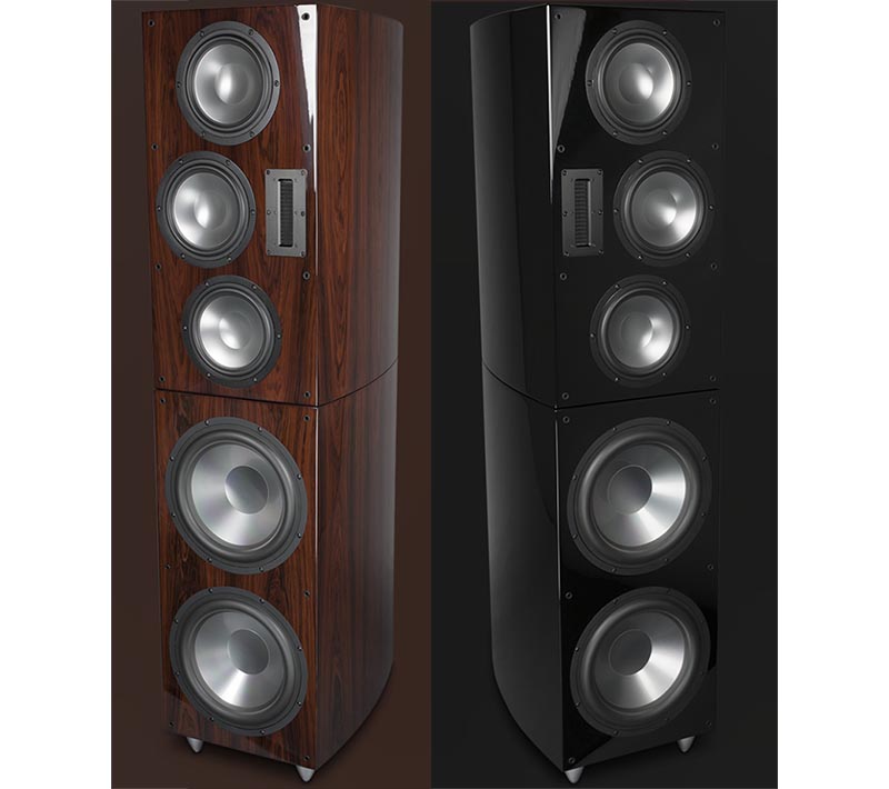

The massive SVTR Tower Reference is a three-way, passive speaker system. The Tower Reference is made up of RBH’s SV-831R monitor and SV-1212NR subwoofer (N stands for non-powered and R for reference), which are sold as a package. The Tower Reference has a passive crossover network built in between the SV-831R monitor and the SV-1212NR subwoofer.
All crossover filters for the mid and tweeter are located in the SV-831 cabinet. Highpass for the midwoofer is on the terminal cup. Low-pass for midwoofer and highpass for the tweeter are on a PCB in the enclosure behind the middle midwoofer. Lowpass for the woofers is located in the Subwoofer enclosure on the bottom of the cabinet. This passive design is specifically engineered for external amplification and comes with a retail price of $20,000/pair.
Build quality of the Signature Reference Tower is simply impeccable. You’d expect that in a $10,999 speaker system. The baffle is 38mm thick; the rest of the cabinet, 24mm.
My review pair's beautiful, mirror-like, piano black finish is the result of a primer coat and eight coats of black polyester paint. Eight coats of clear polyester grace the South American Rosewood finish.  I did not have the opportunity to see the rosewood finish first-hand; but the rosewood finish looked gorgeous in the photos representatives from RBH showed me. And James Larson couldn’t stop gushing over the rosewood finish in his review of the RBH Signature SV-61R bookshelf speakers.
The stated frequency response for a pair of the Reference Tower system is 20Hz-35kHz. As you'll see below, the SVTR's bottom end frequency response is deeper than the subwoofer's rating. That's not a typo.  A representative from RBH told me that the series inductor in the woofer low pass filter affects the vent tuning frequency of the subwoofer. With the inductor in place, the tuning frequency is shifted down a few Hz compared to the subwoofer without the inductor, This accounts for the lower frequency response specification of the SVTR. Speaking of which, let's take a deeper dive into the Signature Reference Tower’s monitor and subwoofer modules.

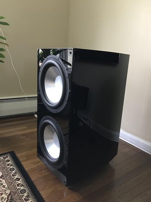

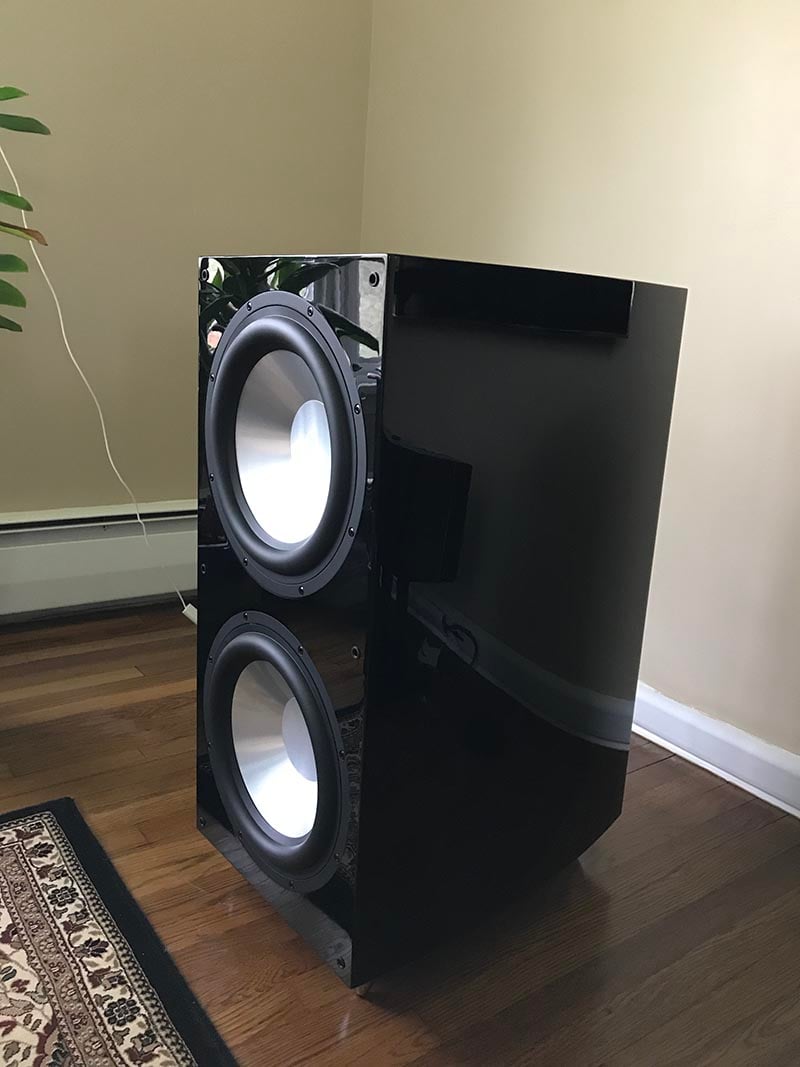

SV-1212NR Reference Signature Subwoofer
Turning to the SV-1212NR Reference Signature subwoofer module, you'll find two of RBH's proprietary 12-inch aluminum cone woofers. You can only truly appreciate the SB1212NR's intimidating presence in person. The woofers sit in a massive 15-3/16-inch wide by 33-inch tall by 22-1/4-inch deep cabinet tipping the scales at 107-pounds!
The SV-1212NR is a passive subwoofer design. The SV1212NR (like all the SV-1212 models) has a 6-inch diameter tuned vent that runs nearly the internal height of the cabinet. By itself, the sub has a rated frequency response of 22Hz-180Hz (±3dB). The SV-1212NR is easy to drive, boasting a sensitivity of 92dB. If you're wondering how the SV-831R and SV-1212NR's integrate, there is a crossover slope of 6dB/octave between the 12-inch subwoofer drivers and mid-woofer. This crossover works because the sensitivity of the two units are so close.

Detail view of the RBH SV-1212NR sub
Detail view of the RBH SV-1212NR subwoofer.

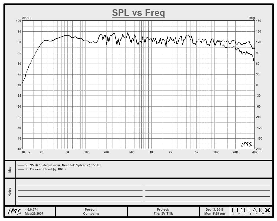

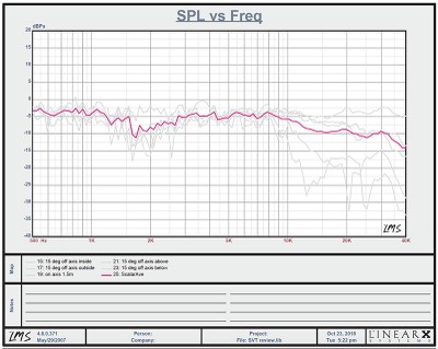

A speaker this large and heavy is impractical to measure outdoors so we did our best to pull in-room measurements to give you an idea of system performance.

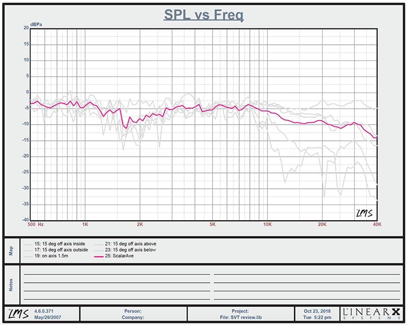

RBH SVTR Frequency Response
RBH SVTR Frequency Response (1.5m normalized to 1m)
The RBH SVTR tower was measured on-axis and 15 degrees horizontally off-axis for best acoustical summation at  1.5m and normalized to 1m SPL. Notice how linear the response is in the critical midrange region from 200Hz to 5 kHz. The bass follows a 4th roll-off below the 20Hz tuning.
RBH SVTR Tower SPL vs. Frequency
RBH SVTR Signature Tower speaker Listening Window
This measurement is an average in-room listening window response comprised of on-axis and +- 15 deg vertical and horizontal off-axis  taken at 1.5 meters.

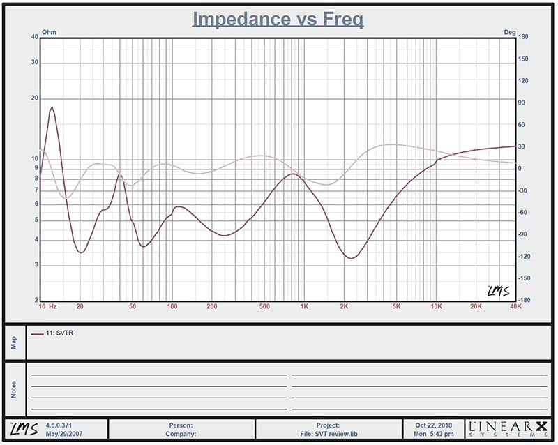

RBH SVTR Tower Speaker Impedance vs. Frequency
RBH SVTR Signature Tower speaker Impedance vs. Frequency response
The SVTR system measures 4 ohms as stated by RBH. It dips down to 3.5 ohms at 20Hz, 60Hz and 2kHz so make sure you use a stout amplifier that is truly rated to deliver power into 4-ohm loads continuously. Tuning appears to be around 20Hz as indicated by the impedance saddle point.

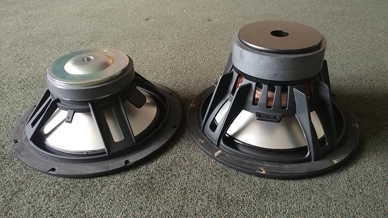

RBH regular vs. reference 12-inch subwoofer driver
You can immediately see the differences in the motor structure differences between RBH's regular 12-inch subwoofer driver (left) and the reference 12-inch aluminum subwoofer driver (right).
The SVTR tower has two of the reference drivers in the SV-1212 module.

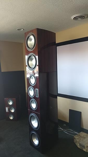

The RBH SVTR have a massive footprint

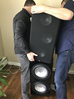

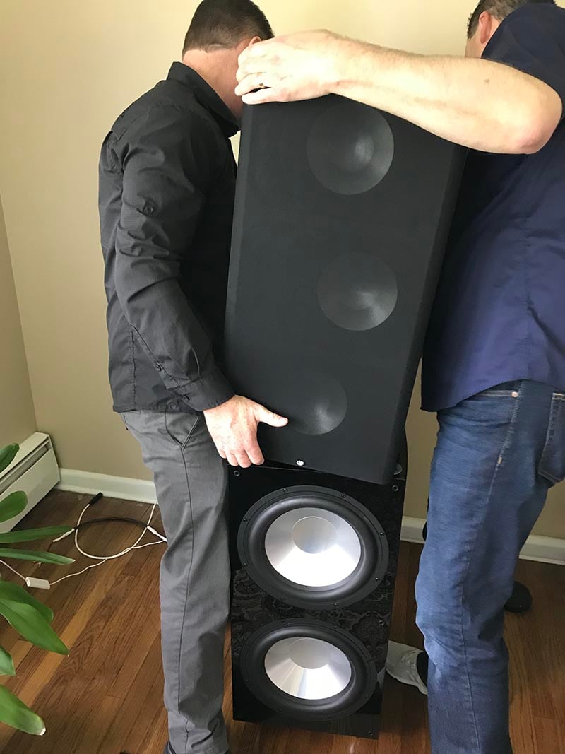

Now comes the obvious question: “What about shipping?” Forget wimpy shipping services. These speakers can only be delivered on a pallet, via freight. I've received several 7.x and 5.x review systems on pallets before, but nothing—and I mean nothing—prepared me for what I was in store for here. The size and weight of this system are massive: equaling the volume of a 5.x channels system and tipping the scales at 410 pounds... unboxed!
Unfortunately, I had severely injured my knee when we began talking about the possibility of reviewing the SVTR Signature Towers. RBH flew out Daren Egan, RBH's Marketing Director, and Shane Rich, RBH's Technical Director to help me with the setup. Daren and Shane did yeoman’s work unpacking the pallet and setting up the speakers.

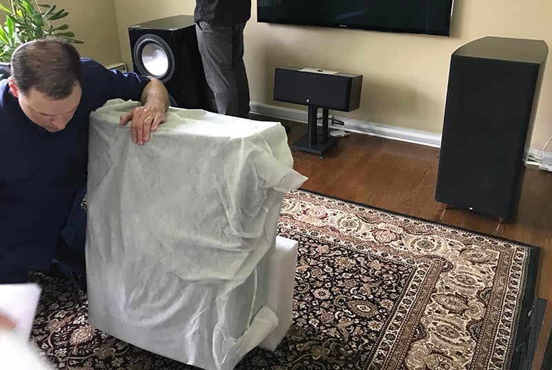

Be warned that setting up the SVT Tower Speaker is a two-to-three person job. And I mean able-bodied persons. Remember, the assembled speakers tip the scales at 205-pounds each. Some of you might test fate by setting up other heavy speakers or subs by yourself. You will injure yourself or damage the RBH speakers should you attempt it here!
I sat there in awe watching Daren and Shane move these massive boxes into my listening room.  Shane and Daren first set up the SV-1212NR subwoofers with the included spiked feet. In the box, you have the option for traditional spikes and spikes made for hardwood floors that have non-marring tips. I had them install the latter.

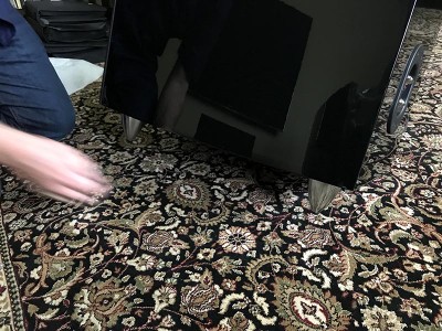

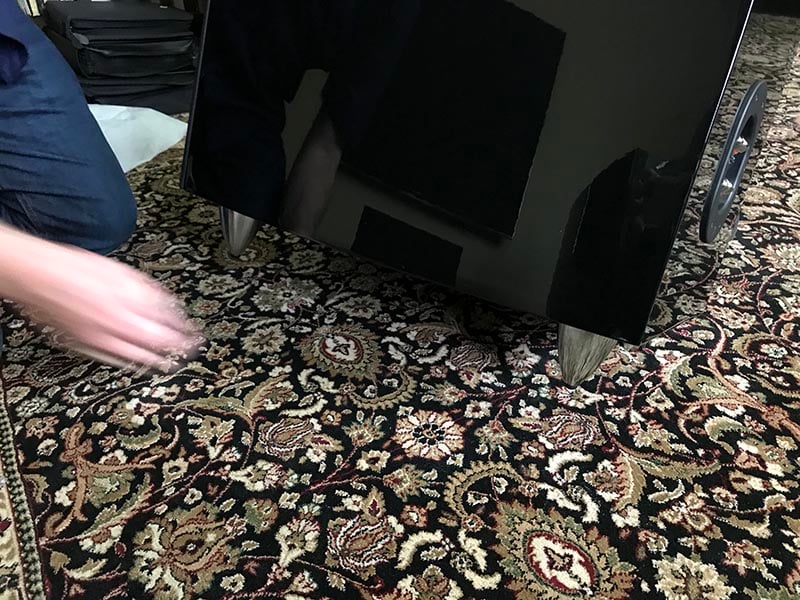

 RBH SVTR Tower speaker spike feet installation
The spiked feet are hefty. We installed the version made tor hardwood floors, that has a non-marring surface beneath the spike.
The hardwood floor spikes made it a breeze to move these 205-pound monsters easily for fine tuning. They never once marred the hardwood floor. What's more, the spikes were an almost perfect balance of ease-of-movement yet cement-like placement. I never had to worry about someone bumping into them and moving them out of place.

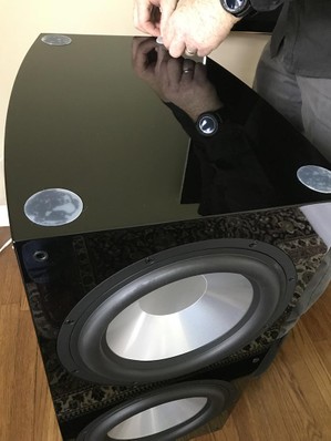

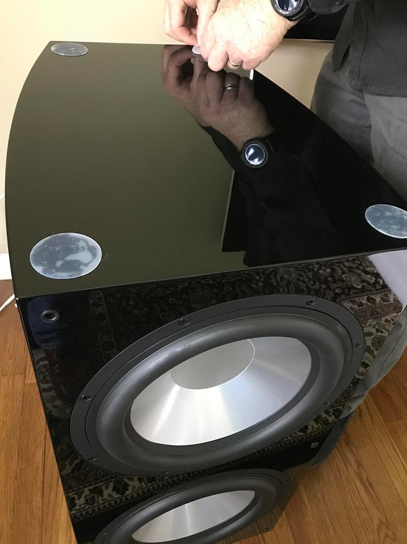

Once the subwoofers were in place, Daren and Shane put six large silicone discs on top of the SV-1212NR modules. There’s no mythical dampening magic in those discs. The purpose of the silicone is to give some grip and prevent scratching the gorgeous finish on the top of the SV-1212NRs.
RBH SVTR Tower Speaker Silicone discs
You place the included silicone discs between the monitor and subwoofer modules.
Take note, the SV-831R modules are not interchangeable. You need to pay attention to how you attach the SV-831R monitor on top of the SR-1212NR. There is a distinct left and right speaker. The tweeter should be facing inward with the three aluminum woofers to the outside.

Forget your inner Hulk. Setting up the SVTR Tower Speaker is a two-person job.
Next, Daren and Shane unboxed the steel joining plates and affixed the monitor to the sub with six screws. At first glance, I thought that the steel plate wouldn't have the stability to hold the two units firmly together. Boy was I wrong. I moved these speakers around countless times to fine tune placement without fearing that the top module was loose or shifting in any way.

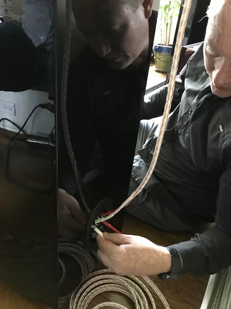

RBH Tower Speaker jumper cable connection
With the Kimber Cable jumper connected, we connected the RBH speakers to the Benchmark AHB2 amplifiers with Kimber Cable 8TC speaker cables.

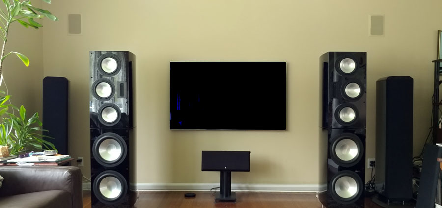

We set up the speakers in the usual place where I have my Revel Ultima2 Salons. We confirmed their placement with a laser measure and fine-tuned the toe-in by listening to some vocal arrangements. When we were satisfied, Shane took some measurements to get a baseline for the speaker's in-room performance. It was finally time to fire up some music tracks to see how things sounded.

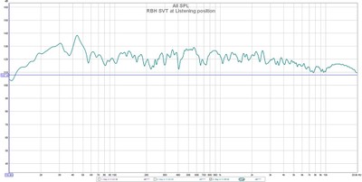

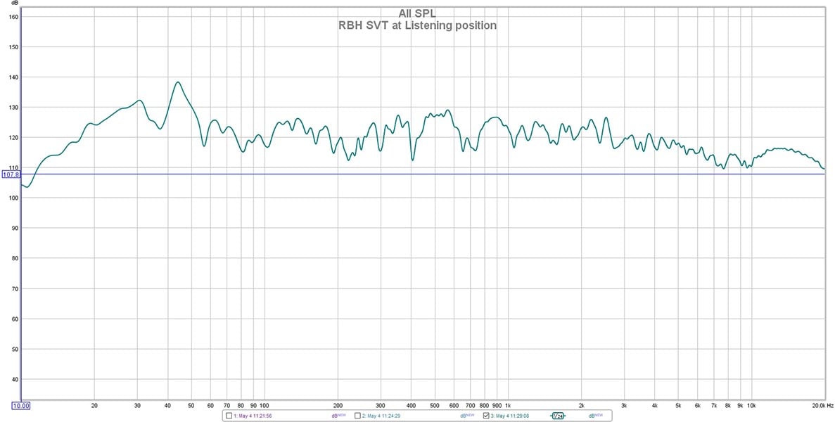

RBH SVTR Tower Speaker measurements at listening seat
We took some measurements at the primary listening position to get a gauge on how the speakers were interacting with the room.
Aside from a room resonance at around 45Hz that could be EQ'ed out, this is a very linear response. Notice the excellent output and extension below 30Hz.

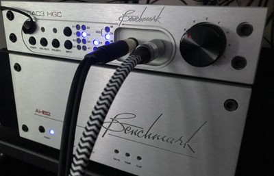

Associated equipment consisted of a Benchmark DAC3 HGC pre-amp/DAC connected to two Benchmark AHB2 power amplifiers. The AHB2 amps were set to bridged mono and used as monoblocks—one amp for each speaker. In that configuration, they deliver 380w into 8 Ohms and 460w into 6 Ohms. I did not bi-amp the Tower Signature speakers during my review period; I treated each tower as a single, passive 3-way speaker, using the SVTR’s internal crossover.
Benchmark DAC3 and AHB2
I used a Benchmark DAC3 and two Benchmark AHB2 power amplifiers configured in bridged mono to have them function at monoblock amplifiers.

RBH SVTR and Salon2
RBH Sound SVTR System Installed (note how much larger they vs. the Revel Ultima2 Salons, which are pushed out to the sides)

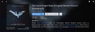

Next, we fired up 24-bit/192kHz version of “Imagine the Fire” from the Dark Knight Rises soundtrack. The intense slam of percussive notes and deep bass glissando literally jolted me upright in my seat. I instinctively yelled out, "Wow!" eyes wide open from the instantaneous, mind-numbing experience. “Can I quote you on that?” Daren asked. You bet.
Dark Knight Rises ALAC
The hi-res 24-bit/192kHz version of the Dark Knight Rises soundtrack, which features a dynamic range of 13db was intense.

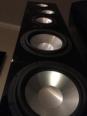

RBH SVTR drivers
View looking up at the RBH SVTR Tower Speaker driver array.
