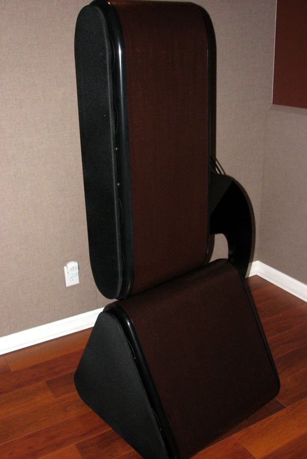

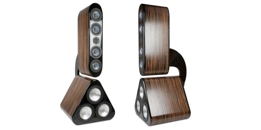

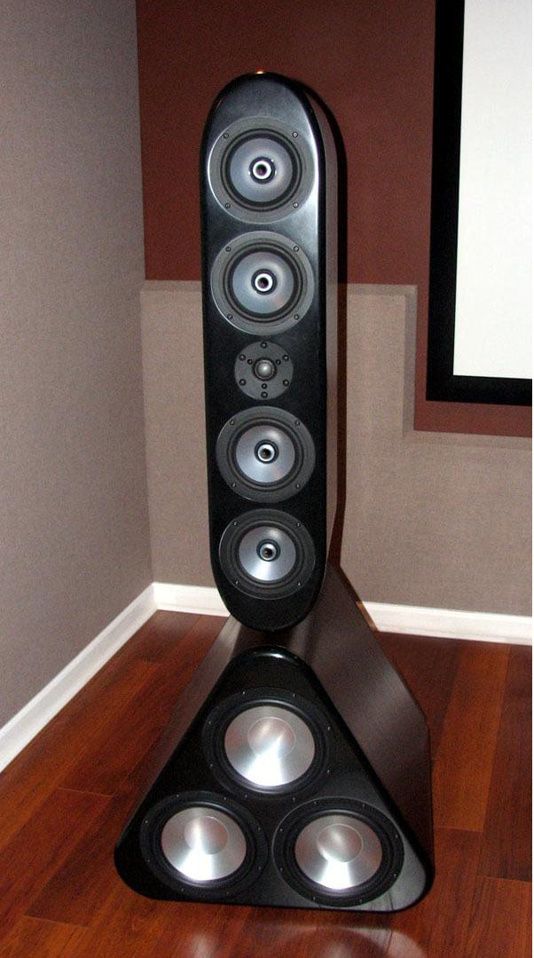

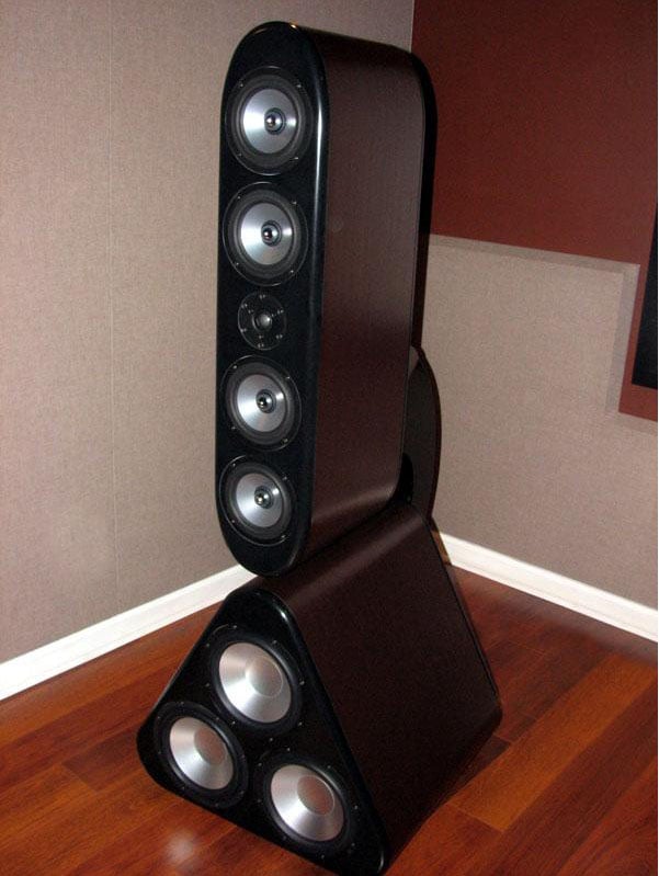

The Status 8T speaker system is a modular design consisting of separate left and right satellite and bass modules connected via a very clever bracketing system. Each bass module houses three (3) high excursion 10” aluminum drivers and each satellite module contains four (4) 6½” Beryllium midrange drivers and a 1” Beryllium dome tweeter. Status Acoustics shipped the 8T's with the bracket that holds the speakers together connected to each bass unit. Status_crates.jpg
Fully assembled, the 8T weighs 345 lbs per speaker. The bass module weighs 175 lbs. and the satellite portion another 135 lbs. The bracket that holds them together weighs 35 lbs. It took four of us to hoist these speakers up my flight of steps to the Audioholics Showcase Theater room. The entire process made me question whether I will attempt to review such a large speaker ever again - reviewers in single-story houses definitely have the advantage here.
The primary design goal of the 8T speaker system, per Status Acoustics, is to produce true-to-life natural sound with realistic imaging characteristics and unrestricted dynamic range, while maintaining a small visual profile that is also aesthetically pleasing. Just what did they do to attempt to make this speaker system live up to such a claim? Let's take a tour of its design to find out.

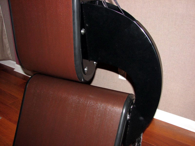

Probably the most important and time-consuming aspect of the design that allows the 8T to work successfully as a modular system is the bracket. The bracket allows the top satellite module housing the midrange and tweeter to be suspended above the bass module in a manner that isolates them from each other acoustically, yet creates a striking visual appearance where the top section appears to “float” above the bass module when viewed from the front. This was no small feat, given the fact that the satellite speaker being suspended weighs 135 lbs.
Project Manager Allen Lewis and loudspeaker Design Engineer Shane Rich spent many hours over the last few years bouncing ideas off each other, and discussing how they could design a modular system which would improve on the one-piece design concept they originally had. A new modular design would help address production issues and, at the same time, make the speaker easier to ship. This was a relief to me as, had Status Acoustics instead proceeded with a one piece design, I would have never been able to review it.
The bracket had to be hollow, rigid, and inert in order to not transfer any mechanical vibrations. It also needed to serve as a conduit for the jumper cable connecting the bass and satellite modules. While this could be accomplished with any cable of your choice, Status Acoustics paired up with Kimber Kable to design a specific 7 foot jumper based on their Monocle speaker cable. This optional accessory will run you a cool $1000, which may be the most expensive jumper cable ever conceived, but it really dresses up the speaker nicely and provides the snuggest lowest resistance connection possible.

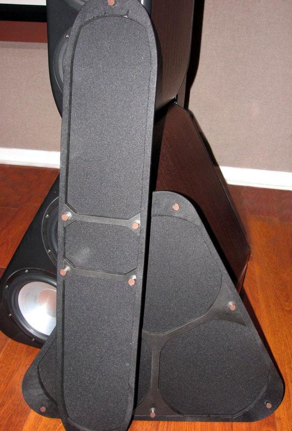

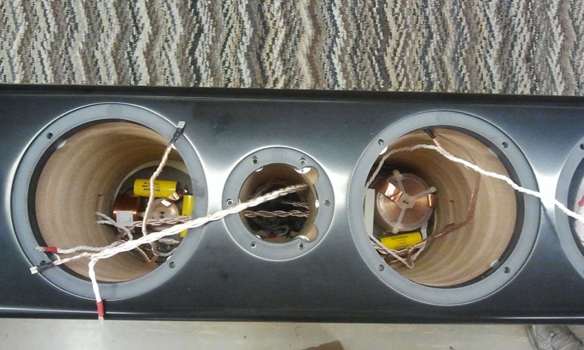

In all my years reviewing loudspeakers, I've never seen more rigidly constructed cabinets. The satellite module is so dense and heavy that you know, just from picking it up, that this is no ordinary speaker. A knock test reveals a deadening thud, almost like you're rapping on a solid slab of granite. Peering inside the satellite speaker, I began to understand why this was the case. Status Acoustics utilized a proprietary method of bonding multiple layers of 1” HDF to effectively make a solid cabinet. This expensive process gives the 8T its unique look while also allowing the cabinet wall thickness to be varied without the limits typically imposed by traditional panel construction, allowing for more extensive internal bracing. The end result of this method is cabinets that are more acoustically inert for optimum sound quality. Cabinet panel resonances are greatly reduced with this design, resulting in superior definition throughout the mid and bass frequency range.
status_bracing.jpgFor the satellite cabinet, each driver is completely isolated inside their own chambers. This isn't done via cheap plastic cups like with lesser designed speakers. These are effectively solid wood chambers bored out from the multiple bonded HDF layers customized for each driver. This is done not only to physically and mechanically separate each driver but to reduce standing waves in the chambers. In addition, there are no parallel walls inside the cavities, which further reduces standing waves. In conjunction with this no holds barred construction method, Status Acoustics employed special damping materials to greatly reduce backwave energy which would ordinarily radiate back through the cone of the driver.

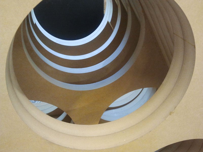

The subwoofer module has a spacious 5.5 ft^3 internal volume shared among the three bass drivers which also has non-parallel walls to reduce standing waves. A special damping compound (which Status says is superior to polyfil and fiberglass due to a higher absorption coefficient at bass frequencies) amply fills the enclosure to absorb acoustic backwave energy and in effect causes the bass drivers to see an even larger enclosure which extends the systems usable frequency response.
The Status 8T bass modules are 4th order rear vented enclosures using large flares on both ends of the 4” diameter ports each about 18” in length. The ports are dimpled similar to the ports of upper end B&W speakers to further reduce turbulence. Having multiple bass drivers and multiple surfaces of radiation allows for increased modal density which produces more uniform bass loading into the room compared to a single driver design with the port on the same face as the driver.
Status 8T Bass Module with Dual 4” Dimpled Ports
The front and back cabinet baffles for both the bass and satellite modules are quite unique. They are made of an acrylic polymer which has superior acoustic damping properties compared to wood baffles. By using the combination of materials (acrylic polymer baffles combined with layered HDF in the cabinets) this virtually eliminates colorations caused by cabinet resonances.

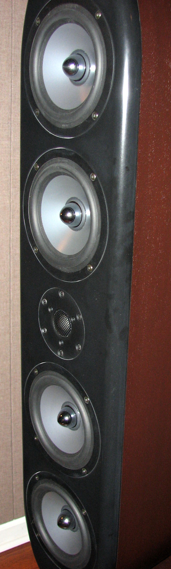

The Driver Topology

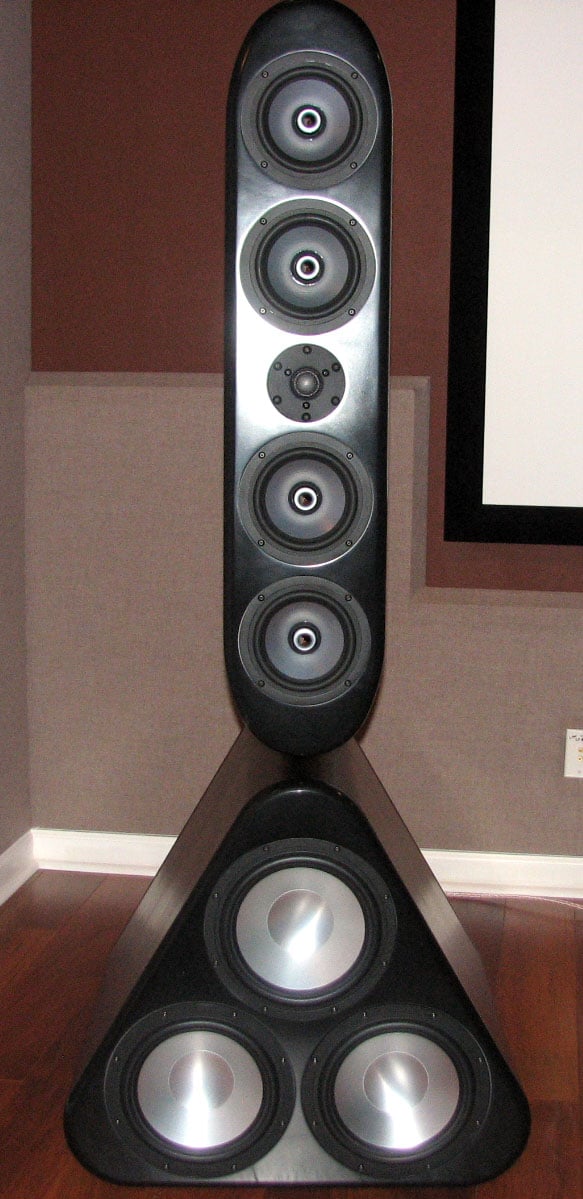

The Status 8T system employs an MMTMM driver arrangement which basically sandwiches a tweeter between the vertically oriented midrange drivers. Status Acoustics takes this traditional design approach up a notch by incorporating an additional top and bottom midrange driver which improves control of vertical dispersion, lowers system distortion and increases dynamic range. All of this can be attributed to how the speaker system produces a more palatable sense of realism which I will discuss further in the listening portion of this review. It's been my experience that a vertical MTM sounds more natural, dynamic and lifelike than a conventional MT driver alignment. This type of driver arrangement allows for more control over floor and ceiling room reflections and provides a higher ratio of direct vs. reflected sound at the listening position. In a very basic sense, multiple vertical oriented drivers operating in the same frequency range behave as if they were a single larger driver of their combined dimensions. Therefore in the vertical plane, the Status 8T has the vertical dispersion characteristic of a huge driver, which is also very narrow. Hence there is very little midrange energy going up to the ceiling or down to the floor and therefore, those destructive, detail-smearing reflections are minimized.
Status Acoustics chose to make the satellite portion of the 8T system a two-way design. They claim it sounds more cohesive with a high quality two-way crossover as opposed to a 2.5-way network. A two-way crossover does not have the additional phase shift between drivers you would get with a comparable 2.5-way network.
                                     Status Acoustics Titus 8T Front View (left pic: no grilles; right pic: with grilles)Status_grilles2.jpg
The left above image shows off the beauty of the drivers of the Status 8T system with the grille covers removed. The acrylic polymer baffle not only aids in performance aspects of the speaker but adds a touch of class to the product commensurate with RBH Sound's “Status” series nomenclature. The right above image shows how equally beautiful the 8T system looks with its magnetic grilles in place. However, any serious audiophile will keep these babies naked for critical listening as well as showcasing the product to visiting friends.

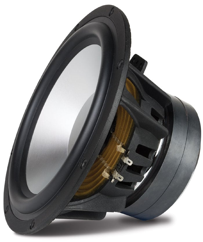

The Bass Drivers
Each Status 8T bass module comes loaded with three (3) 10” high excursion aluminum cone subwoofer drivers. These drivers feature a 2.5” voice coil and 12.5 lbs heavy duty motor structure with a vented pole piece and aluminum former with the leads sewn into the cone to prevent breaking. The aluminum cone serves as a heatsink to increase power handling. The driver employs a 2.5” diameter 1.3” voice coil and has a 1” peak linear travel. The bumped backplate design eliminates the possibility of bottoming out the driver under heavy excursion.
I torture-tested these subs by running them as the left/right main channels fullrange while directing bass to them from the LFE channel and ALL channels (center + surrounds) set to "small".  On bass intense Blu-rays at above reference levels in my large room, I was unable to bottom the drivers or cause any serious audible distress. In fact, I ran out of available amplifier power from my Classe CT-2300 amp (600 watt+ @ 4-ohms) while the Status drivers were still hungry to pump out more SPL's.

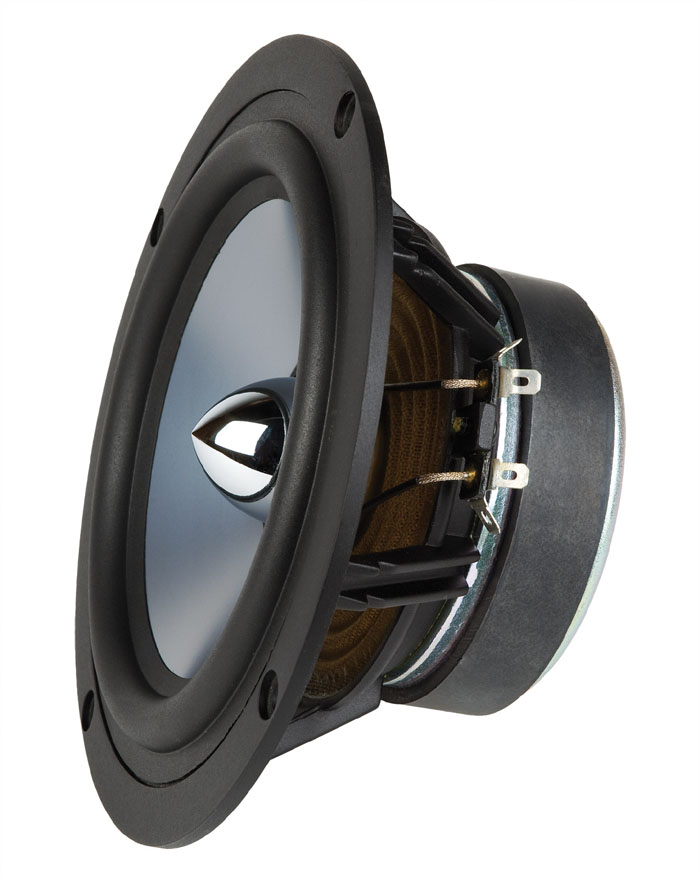

Status 10" Aluminum Woofer (left pic); Status 6.5" Beryllium Midrange (right pic)

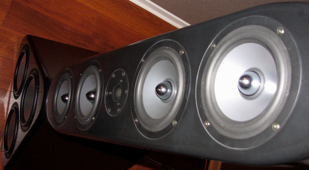

Each Status 8T satellite module features four (4) 6½” Beryllium/Aluminum phase plug drivers. The driver basket is a high quality cast aluminum (no cheap stamped metal parts here). Employing Beryllium in the cone improves on aluminum by offering a stiffer, lighter-weight cone with a less pronounced breakup mode that is shifted further beyond the bandwidth in which the driver is being used. Energy storage retention is also reduced. Youngs modulus (a measure of stiffness) is higher with Beryllium, meaning the cone will flex less under stress. The Beryllium alloy cone also produces a more linear transition in the stopband for smoother integration between the drivers. The phase plug reduces moving mass and on-axis beaming and also serves as a heat sink and, to a smaller extent, offers venting for the voice coil. There is also a rubber stopper affixed to the cone to further reduce air turbulence through the gap. A lot of engineering went into this driver, and it certainly shows in droves in performance (see our measurements later). Employing four of these drivers in the design not only expands the soundstage but also assures effortless dynamics in the midrange at all power levels.
The Tweeter

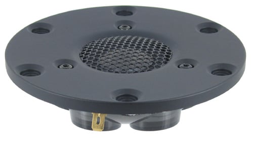

Each Status 8T satellite module features the new Scan-Speak Illuminator Model 6640 tweeter sandwiched in between the midrange drivers. Scan-Speak's unique AirCirc Magnet System optimizes air flow within the chamber by rearranging the traditional magnet structure from a single magnet to an open magnetic circuit comprised of six separate neodymium slugs. This, in combination with the chamber, is said to eliminate the reflections and resonances that compromise the performance of traditional motors.
Scan-Speak 6640 Beryllium Illuminator Tweeter
The 6640 is arguably the finest-sounding dome tweeter on the market, but at a spendy $500 per driver, it's also one of the most expensive. The 6640 has excellent power handling, frequency response and distortion specs compared to the equivalent fabric dome from Scan-Speak. The Beryllium version is said to offer higher resolution, and lower distortion. This is a true Beryllium driver, not a cheap knock off aluminum dome coated in Beryllium for marketing purposes. In my torture tests, I was shocked at just how much power these tweeters could absorb, never losing composure or sounded strained no matter the source or listening level.
There is a 3rd party write up comparing both tweeters (with measurements) here: http://www.audioexcite.com/?p=1953

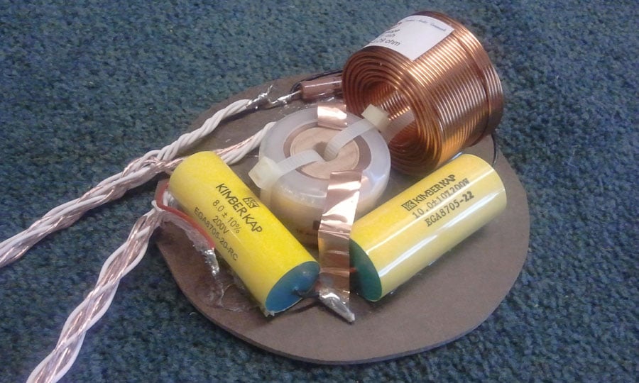

The Crossover Network

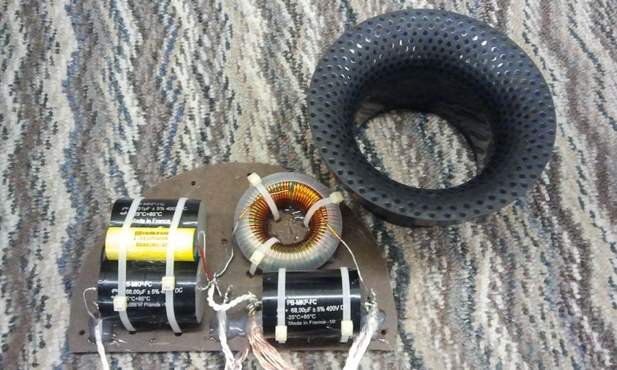

With such a large array of drivers comes a sophisticated crossover network to control it all. Based on my listening tests and measurements, I was actually quite flabbergasted at how well Status Acoustics managed to integrate all of the drivers using passive networks.
The subwoofers in the bass module utilize their natural rolloff for several octaves before employing a 2nd order electrical lowpass filter. This allows for the best possible integration between the bass and satellite modules. The midrange drivers use an asymmetric bandpass filter to effectively filter bass frequencies for increased dynamic range while also seamlessly integrating with the tweeter. The tweeter utilizes a 4th order HPF @ 2500Hz. This ensures increased power handling and better integrates the tweeter with the summed response from the midrange drivers.
Status Acoustics Crossovers: Tweeter HPF Left Pic; Midrange BPF (Right Pic)
LPF Bass Module on a schnazzy background

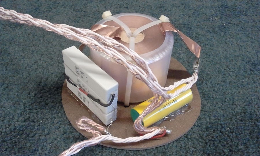

The 8T crossover network employs some of the finest components available, regardless of price. Ultra high quality Jensen foil inductors are used in the network to minimize losses and ensure uncompressed sound at any power level since the coils will NOT saturate within the output capabilities of the loudspeakers. High voltage, tight tolerance Kimber and Solen polypropylene capacitors are used throughout the network. You won't find any electrolytic capacitors in this baby.
The subwoofer inductor is a large 2.5 mH 14AWG toroidal core with very high power handling and extremely low DCR (handles 700 Watts continuous at 500Hz where the speaker is already rolled off). This ensures no saturation at all within bandwidth used at any power level.
Although the midrange crossover pictured above shows a stack of ceramic resistors, the actual product crossover of the Status 8T system uses no resistors in the network at all. Status engineers were able to completely eliminate the need for resistors during the final design phase after upgrading the damping material and doing final testing. Because there are no resistors used in the crossovers that are in series with the drivers, there is no chance of compression caused by overheating of resistive elements at high power levels.
The Status 8T speakers are all internally wired with approximately 50ft of Kimber 4TC high performance speaker cable. Given the number of drivers that are driven in parallel in the speaker system, the net harness size is equivalent to a 5AWG conductor.
The crossover networks are all point-to-point soldered to minimize losses by providing the least resistive path with the fewest connection points between components. All of the crossovers are hand-built by their senior techs and special care is taken to ensure components are properly soldered directly together vs. through a PCB.

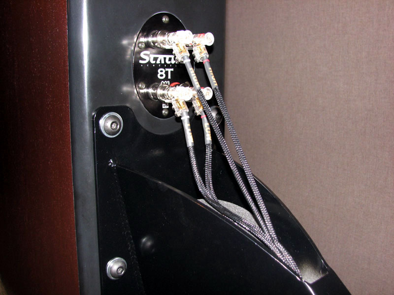

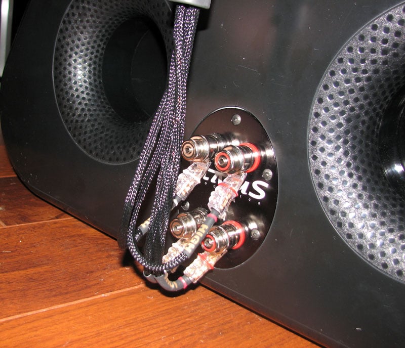

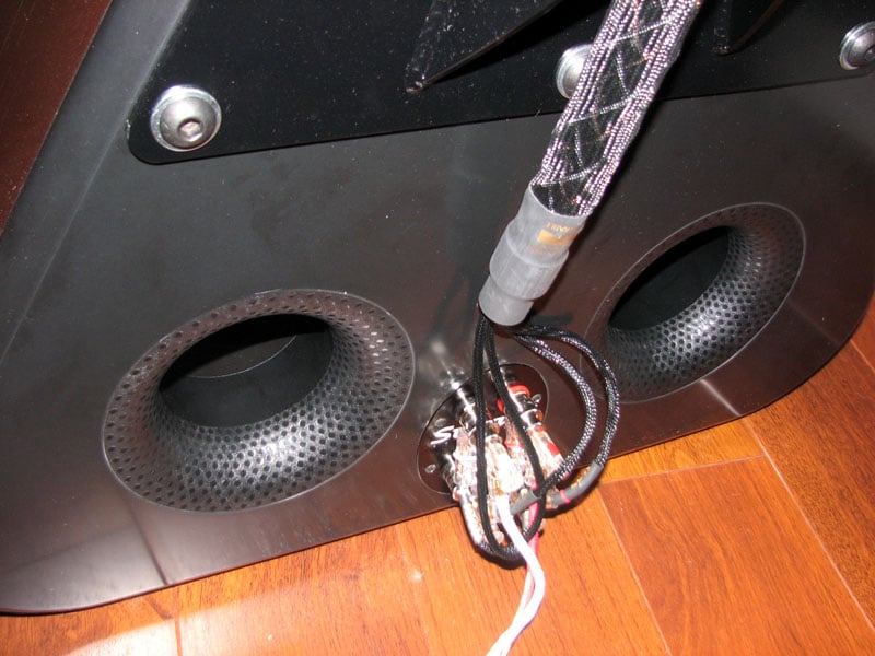

The Speaker Connection Scheme
A total of 16 WBT Platinum binding posts are used for each pair of speakers. Combined with the Kimber Kable 4TC internal wiring, that's over $2,600 worth of cables and terminals for this speaker system alone! The WBT platinum connectors are unlike any other speaker connector we've seen. Crafted like fine jewelry, their function is simple, providing the best possible connection between the speaker and the speaker cable. They allow you to lock down spade-terminated speaker cables and banana plugs simultaneously to each connector by simply twisting the dual independent barrels.
There are two sets of binding posts for the satellite module and two sets for the bass module as well. The bottom terminals of the bass module are used as inputs from the amplifier and the top terminals serve as the HPF to the satellite system... Well, at least in my pair. Status Acoustics later informed me that they decided to move the HPF to the satellite module to offer more connection options for those desiring to use this speaker system for dual two-channel and multi-channel applications. So production units now see the top and bottom terminals of the bass module as completely isolated which can be jumpered via the included WBT straps for a single amp connection or the top terminals of the bass module can be used as a secondary input in conjunction with the custom designed Kimber Monocle jumper cable to the satellite module for bi-amping.
Status Acoustics 8T Satellite Terminals (left pic) Bass Module Terminals (Right pic)
Listed below are some possible connection scenarios the customer may configure their 8T system depending on their application.  You can skip this portion of the review and come back to it as a reference when you get ready to connect your pair into your system :)
Single Amp Mode:
In a single amp configuration, you can simply jumper the top and bottom terminal connections of the satellite speaker with the bottom terminals of the bass module. The amplifier then gets connected to the bottom terminals of the bass module only leaving no connection to the top terminals of the bass module. For an optional $1000, the customer can purchase a custom built Kimber cable jumper (based on the Monocle design) that properly connects the 8T speaker in this fashion.
Bi-Amp Mode:
In Bi-amp mode, the user attaches one amp to the top connections of the bass module and jumpers it to the top/bottom terminals of the satellite speakers while feeding the second amp to the bottom terminals of the bass module. The first amp will power the satellite speaker while the second amp would power the bass module in this connection scheme.
Tri-Amp Mode:
In Tri-amp mode the user attaches one amp to the top connections of the satellite module, a second amp to the bottom connections of the satellite module and the third amp to the bottom portion of the bass module leaving the top portion of the bass module unconnected. The first amp will power the tweeter, the second amp would power the midrange section and the third amp would power the bass module in this connection scheme.
Home Theater Mode:
In a home theater configuration, the user may wish to experiment with running the satellite module full-range as the main channels, and the bass modules as dedicated powered subwoofers. This can be accomplished by connecting an external amp to the bottom connections of each of the Status 8T bass modules fed directly to the A/V processor's subwoofer output/LFE channel. It can be advantageous to connect the Status 8T speaker like this if you want the sub channel and LFE info routed to the bass modules and/or if you are integrating other powered subs into your system, since all subs will now get identical signal and LFE info. The downside is that you can potentially compromise how the system integrates for critical two-channel operation, since it was designed to be played full-range with the internal passive crossover networks.

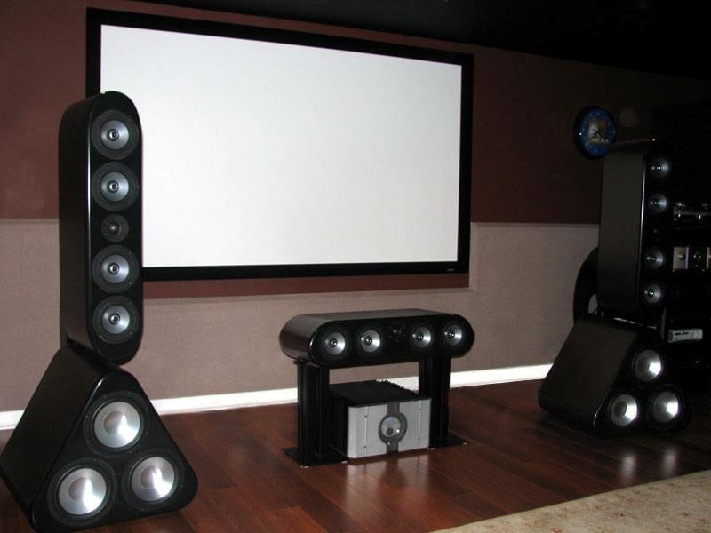

Status CarryLet me reiterate that it took four of us to haul the 8T speaker system up my flight of steps to the Audioholics Showcase Theater Room - and that was moving them as separate pieces with the bracket attached to the bass module. Assembling the 8T system once moved upstairs was pretty easy. By laying the system on the floor, we bolted each satellite speaker to the bracket of its corresponding bass module and then lifted it up from the ground from the top. A speaker this heavy and massive needs no outriggers or feet but we placed 2” vinyl discs under the bass module so it would be fairly easy to move the speaker system into position.
We placed the left/right speakers about 3 1/2ft from the back wall and 10ft apart with the primary seating area about 13ft away. We found only a modest amount of toe-in was needed for these babies to really work their magic in my listening space. In fact, I’d guesstimate it was about 10 degrees of toe-in that did it. From the seated position, this also made the connection bracket disappear giving the illusion that the satellite module was floating above the bass module. Very cool effect!
We tested the Status Acoustics 8T speakers with all of the best gear available to us. We broke this into two separate systems with the dedicated two-channel system consisting of a Marantz PM-11S2 Preamp, Pass Labs X350.5 two-channel amplifier, a Marantz TT-15S1 turntable and analog balanced outputs of the Oppo BDP-95 Universal Blu-ray player as the sources. The second system consisted of the Denon AVP-A1HDCI A/V processor, Denon POA-A1HDCI multi-channel amplifier, Classe CT-2300 two-channel amplifier and the Oppo BDP-95 Universal Blu-ray player via the HDMI output. Speaker cables were all Kimber 8TC and interconnects were Bluejeans Cable 1694 COAX and balanced cables. The listening space is a 6,000 ft3 room that is moderately acoustically treated, courtesy of Auralex Acoustics.

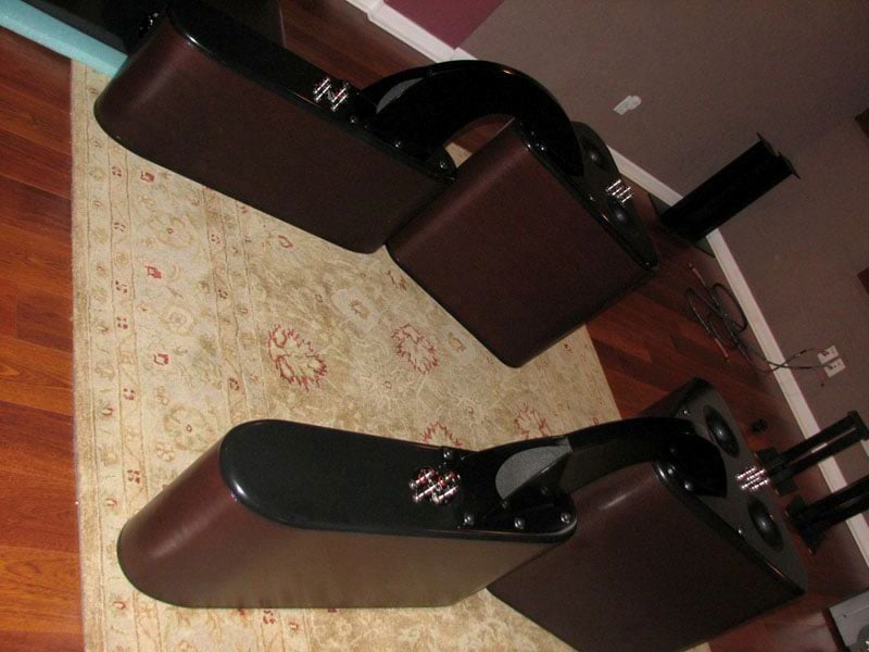

Status Assemble
Assembling the Status 8T System
The Status 8T system had to be assembled face down.  Once the bracket was secured on the bass and satellite modules, we lifted them up from the top and slid them into position.
Status Acoustics 8T & 8C Speaker System installed in Audioholics Showcase Theater Room

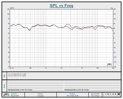

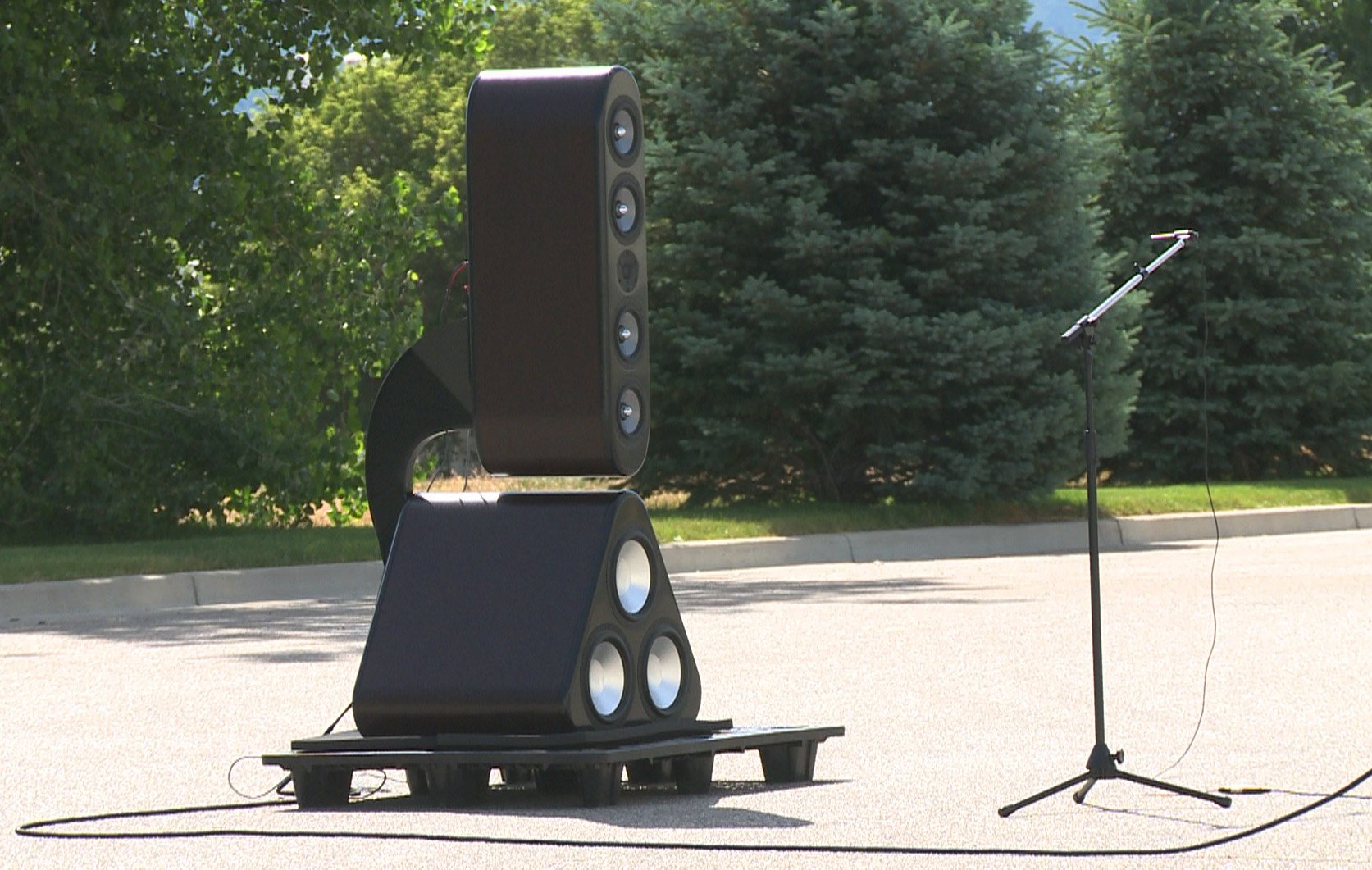

Measuring the Status 8T Outdoors @ 2 meters

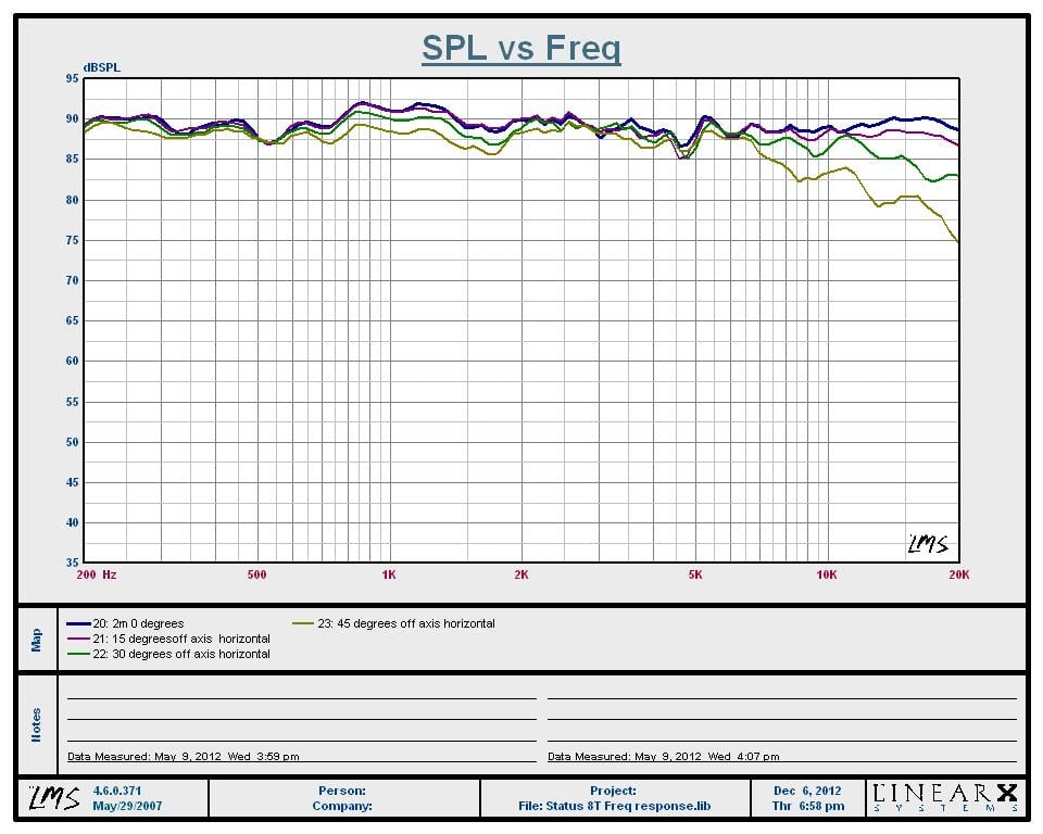

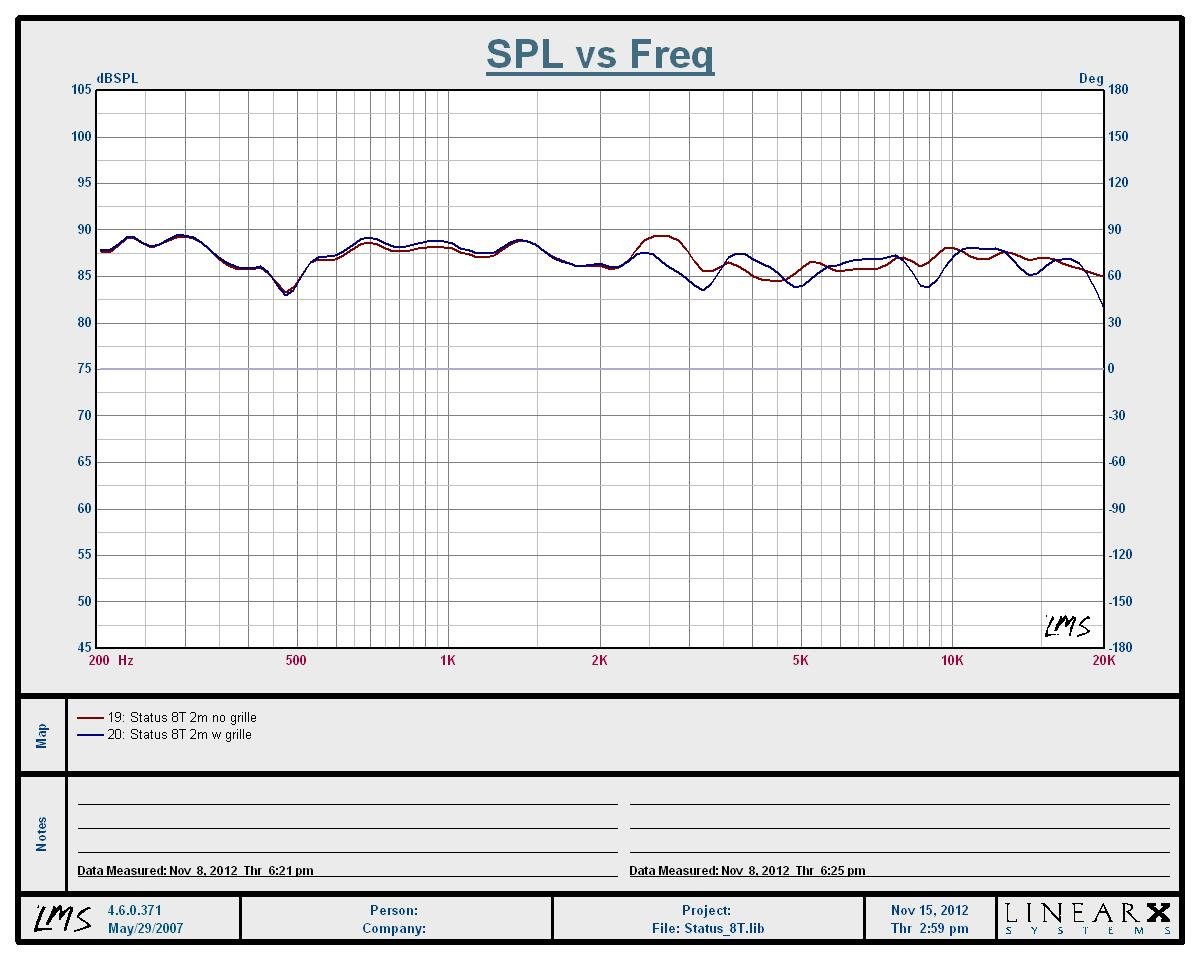

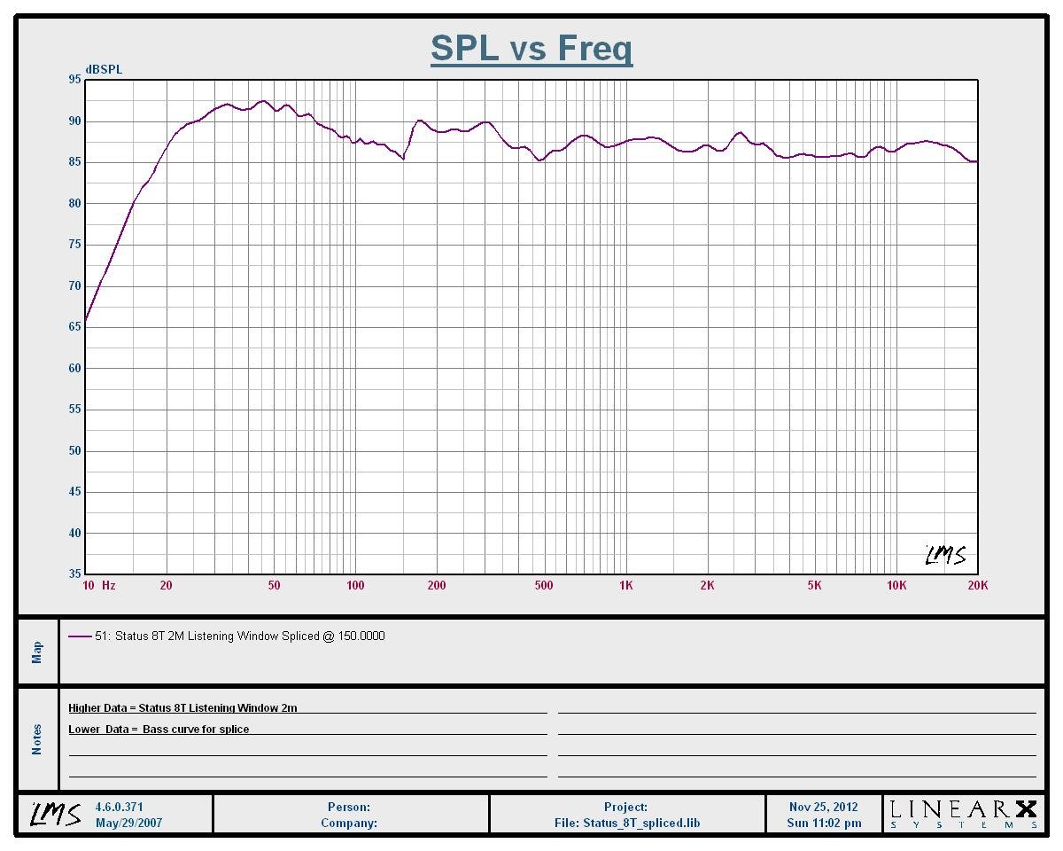

Measurements were conducted both outdoors and indoors using the LMS system from Linear X for frequency response and impedance measurements and the OmniMic system from Dayton Audio for distortion measurements.

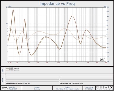

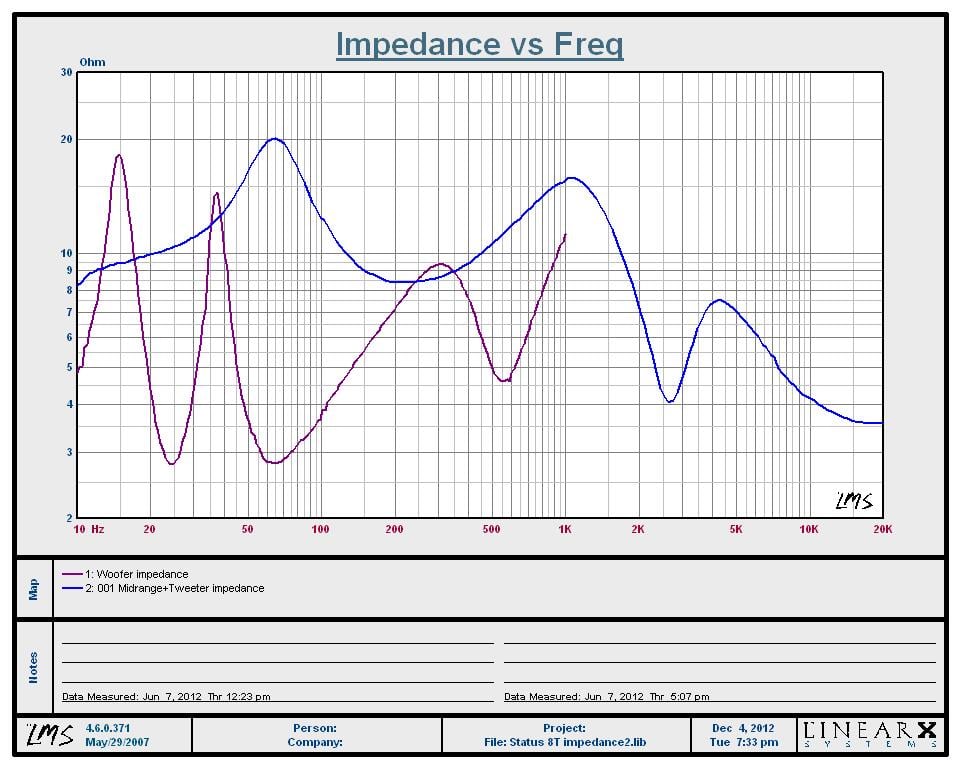

Impedance / Phase Measurements of the Status Acoustics 8T Speaker System
Separated Impedance of the Status Acoustics 8T Speaker System
Purple trace: bass module ; Blue trace: Satellite module
The first impedance/phase sweep was taken on each Status 8T system configured with the satellite and bass module wired together for single amplification mode while the second measurement graph separated the impedance of the bass and satellite modules.  Thanks to tight tolerances in parts and consistency in cabinet stuffing, both speakers measured nearly identical throughout the entire audio bandwidth.  I’ve never seen a pair of speakers track this closely, especially ones with multi drive units like this system.
The Status Acoustics 8T speakers appear to be tuned at around 22Hz, but the peaks are slightly asymmetric indicating the system is tuned a bit higher than the driver's resonance frequency.   This allows for more power handling down to 20Hz region.  Because of the multi-driver array paralleling essentially three 8 ohm bass drive units, the Status 8T system can be a strenuous load for an amplifier, dipping down below 3 ohms in the lower bass regions.  I was puzzled why Status Acoustics didn’t employ 12 ohm drivers to keep the system impedance above 4-ohms so I asked Shane Rich.
Editorial Note about the Low Impedance of the Status 8T System by Shane Rich:
1. Let me answer the question with a question.  Why would anyone design a 4 Ohm speaker vs. an 8 Ohm speaker?  The same logic applies to your question.  Again, this is assuming we are using amplifiers that are capable of putting out the current necessary to extend the dynamics of the system at lower impedance loads.  Case in point, the voltage rails of my ADA amp are about the same as the Boulder amplifier we have used.  Why then does the Boulder sound so much more dynamic?
Answer: It is delivering more power into the load the speaker presents to the amplifier.  Yes the efficiency of the amp may be reduced somewhat, but if the amp can output 600W into a 4 Ohm load and still put out 1200W into a 2 Ohm load, why not utilize the available power?
2.  There would be a reduction of sensitivity of the system in the bass frequencies if all else were equal.  The voltage sensitivity of the system would be reduced by a dB or 2 in the bass frequencies so in effect the balance of the sound would change and speaker would have a "lighter" less bassy bottom end.
That being said, yes, I will admit to briefly considering the option of using a 12 Ohm coil like I did in the in the three paralleled 8" drivers utilized in the RBH 8300 towers,  but I ruled that out after seeing how well balanced system was using the existing 10" drivers and knowing the buyer for these speakers was likely to use a monster amp to power them.
Though the phase varies substantially at low frequencies (10Hz to 20Hz), the swings aren’t of much consequence given the magnitude of the impedance.  Notice that the magnitude of the impedance never drops below 5 ohms at the phase angle extremes in the bottom end.  Magnitude is 6-ohms at 18Hz where the phase angle is -42 deg and 5.2 ohms at 42Hz where the phase angle is -39 deg.  Any good quality high power 4 ohm capable amplifier should be able to drive this speaker without too much difficulty, but again I recommend pairing them with the best amplification you can get your hands on.  Of course in bi-amp mode, the end user should select amplifiers with similar gain structures but with an emphasis on the amp powering the bass modules being stable down to 2 ohm loads.  The satellite module is a relatively easy load for any good quality 4 ohm rated amplifier to drive.
Status Acoustics specifies system sensitivity at 93dB at 2.83V/meter.  I measured about 92dB with a slight bump in the bass so their claim seems to be pretty accurate.
Status Acoustics 8T In-Room 1.75 Meter Listening Window Response (1/12th octave smoothed)
Measuring a speaker like the Status 8T is a difficult task not only because of the complex multi-driver array, but also its sheer size making it hard to move around or measure outdoors.  Having multiple front firing bass drivers and rear ports makes this task even trickier.  With that I took a combination of five measurements (on-axis, +/-15 deg off axis vertically and 15 and 30 deg off axis horizontally) and averaged them to form a listening window response curve.  I then took the outdoor groundplane measurement we made on the bass module and spliced its response to the listening window response at 150Hz.  Overall this gives a fairly accurate representation of what the speaker would look like quasi-anechoic at 2 meters.  As you can see the response is extremely linear above the splice point maintaining a +/- 2.5dB frequency response out to 20kHz and that’s with measurements 30 degrees off-axis averaged into the overall response curve.  The slight dip in the 100Hz to 200Hz frequency is a measurement artifact of measuring this speaker at such a close distance caused by the interference of the first reflection off the ground.
The Status 8T speaker system exhibited extremely linear response at all power levels
There is a bit of a bump (2-3dB) in the 30-60Hz region which is probably responsible for the 8T systems very tactile response that adds a pleasant warmth to the sound.  It’s interesting to note that the groundplane sweeps we ran on the bass module produced the same response curve below 150Hz with no compression out to 115dB where the amplifier we used ran out of power. The 8T bass module didn’t break a sweat and was ready for a kilowatt amp, which sadly we didn’t have on-hand during the time these measurements were conducted.
Status Acoustics 8T Outdoor 2 Meter Off-Axis Response (1/12th octave smoothed)
Blue: on-axis; Purple: 15 deg; Green: 30 deg; Yellow: 45 deg
Taking a closer look at the off-axis response of the Status 8T system really gives a true appreciation of the caliber of performance the Scan Speak 6640 Beryllium offers.  Just look at how smooth the upper frequency response is on-axis and how gradual the roll-off is all the way out to 45 degrees off-axis.  You very rarely see a tweeter with such a smooth, predictable rolloff from 0 to 15 to 30 to 45 degrees off-axis.  Usually there's some resonance somewhere so one of the off-axis curves actually spikes above one of the other curves somewhere in the band. That’s clearly not happening here.  Also, the 0 and 15 degree curves are almost identical, indicating the tweeter has superbly good dispersion and the dome is obviously not mounted in a recess that restricts its off-axis output.  This indicates excellent performance and a well integrated system.  The lack of measurement artifacts also indicates a very well engineered front baffle.
Status Acoustics 8T In-Room 1.75 meter Frequency Response Comparison (1/12th Octave Resolution)
Purple: no grille; blue: with grille
Of course it’s always recommended to listen to your speakers with the grilles off, especially these babies, but it’s also good to know that a properly engineered grille can not only provide protection for the drivers but do minimal harm to the sound.  The Status 8T grilles are pretty transparent, as indicated in the measurement above, but they aren’t perfect.  You can see some loss in the critical 2 kHz midrange and upper 8-10kHz areas.  This may be a result of the ½” standoffs not allowing them to flush mount against the baffle.  Making these grilles magnetic looks great so it’s a small sacrifice to pay in performance and anyone serious about audio will not be using these grilles during critical listening sessions anyways.

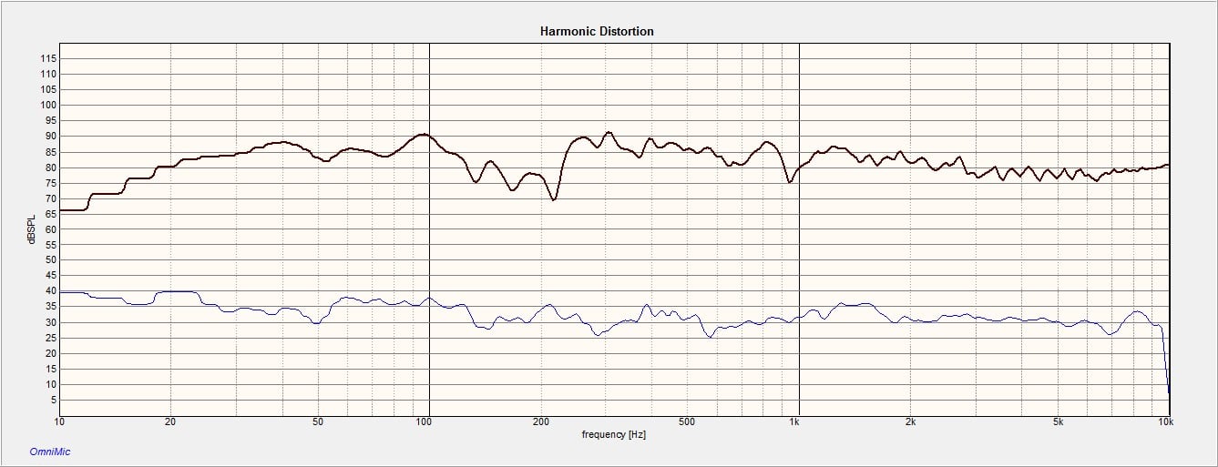

Status Acoustics 8T In-Room THD Distortion Measurement (@ listening position)
Using the OmniMic system, I positioned the mic 1.5 meters away from the 8T’s tweeter to do a frequency vs. distortion sweep.  This is a similar test to how the NRC does distortion.  In my opinion this type of distortion test doesn’t give you the whole picture but it does wring out obvious flaws or problems with the speaker system.  I drove the 8T’s at high output (more than my ears could take for any duration of time) and I noticed as I increased the volume, the output level went up but the distortion curve did not.  This indicated to me that the Status 8T system distortion was below the noise floor of my room.  So, I repositioned the mic to the listening area almost 14ft away from the speakers and ran a full-range sweep from 10Hz to 20kHz with both speakers driven.  Again, the same excellent results were produced.  This was the cleanest system I’ve ever measured.  Most speaker systems distortion goes way up at low frequencies since hardly any so called “full-range” towers are really full-range.  This was not the case with the 8T system as you can see in the graph above.  This is what happens when you mate multiple high quality drivers in a large box with well-executed crossover design.
It’s also particularly interesting that the frequency response with both speakers driven at the listening position was +- 5dB from 20Hz to 10kHz and this graph retained 1/12th octave resolution.  Thanks to the higher proportion of direct sound to the listening area, the response at the primary listening seats is very linear.  This is unachievable in my room with conventional 2-way or 3-way designs without the use of electronic room correction.
If you want to convert the THD to physical numbers, you can subtract the SPL sweep (black) from the distortion sweep (blue) at corresponding frequencies and convert the numerical # to a percentage as follows:
dB Below Test Tone % Distortion
-5 dB 56.2%
-10 dB 31.6%
-15 dB 17.8%
-20 dB 10.0%
-25 dB 5.62%
-30 dB 3.16%
-35 dB 1.78%
-40 dB 1.00%
-45 dB .562%
-50 dB .316%
-55 dB .178%
-60 dB .100%
-65 dB .056%
-70 dB .032%
-75 dB .018%
-80 dB .01%
Distortion Table (dB to % Conversion)
For example at 1kHz, the 8T SPL was roughly 95dB (at 1 meter) while the THD level was 35dB.  95dB – 35dB = 60dB or 0.100% THD.
