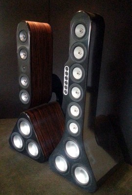

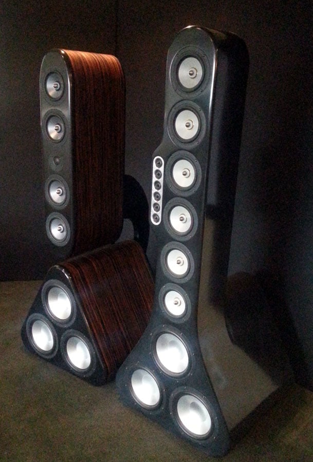

Status Acoustics Titus 8T (left speaker) & Titus 2 (right speaker)

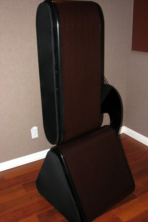

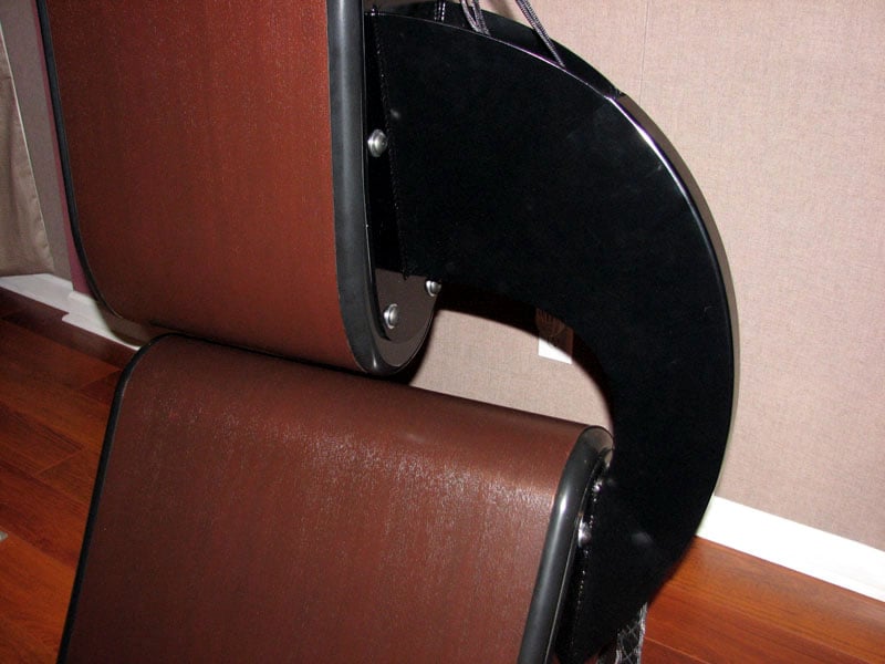

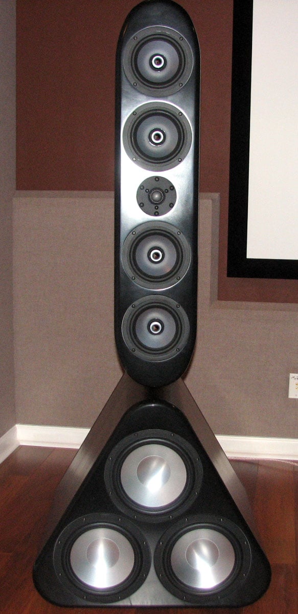

Q: Why did you design the Status 8T as a modular system?
A: Allen Lewis (Project Manager at Status Acoustics) and I spent many hours over the last few years bouncing ideas off each other, and discussed how we could design a modular system which would improve on the one-piece design concept we originally had. A new modular design would help address production issues and, at the same time, make the speaker easier to ship (Gene also commented that he needed a speaker which could be taken up his flight of stairs to his sound room). The end result is what you see now. Probably the most important and time consuming aspect of the design which allows the 8T to work successfully as a modular system is the bracket. The bracket allows the top satellite module housing the midrange and tweeter to be suspended above the bass module in a manner that isolates them from each other acoustically, yet creates a striking visual appearance where the top section appears to “float” above the bass module when viewed from the front. This was no small feat, given the 135 lbs. being suspended.
Tower Aeriel View

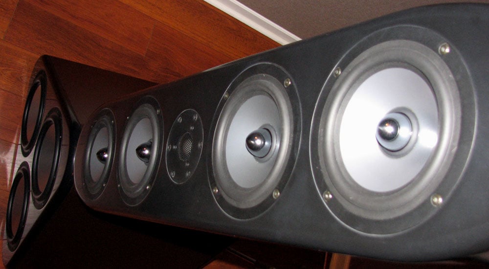

Q: Why did you choose an MTM topology over a conventional driver array?
A: Because, in my opinion, a vertical MTM sounds more natural, dynamic and lifelike than a conventional MT driver alignment. This allows for more control over floor and ceiling room reflections and provides a higher ratio of direct vs reflected sound at the listening position.
Q: Why the extra two mid-woofers?
A: Adding the extra two mid-woofers produced a more palatable sense of realism. It also lowers system distortion while increasing dynamic range, and improves control of vertical dispersion.
Q: Were the top and bottom mid woofers bandwidth limited, and if not, why?
A: No, there was no need to further bandwidth limit the top and bottom mid-woofers as we found the sound to be superior running all four mid-woofers with identical bandwidth. This essentially increases the size of the midrange driver alignment from a conventional MTM. We found the satellite portion of this system sounds more cohesive with a high quality two-way crossover as opposed to a 2.5 way network, given a 2-way crossover does not have the additional phase shift between drivers you would get with a comparable 2.5 way network.

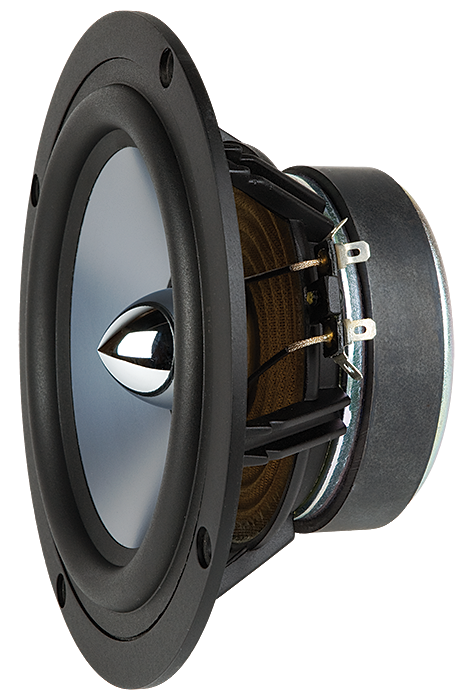

Q: Why use Beryllium Alloy over Aluminum cone in the midrange?
A: Employing Beryllium in the cone improves on aluminum by offering a stiffer, lighter-weight cone with a less pronounced breakup mode that is shifted further beyond the bandwidth the driver is being used in. Energy storage retention is reduced. Youngs modulus (a measure of stiffness) is higher with Beryllium, meaning the cone will flex less under stress. The Beryllium alloy cone also produces a more linear transition in the stopband for smoother integration between the drivers.

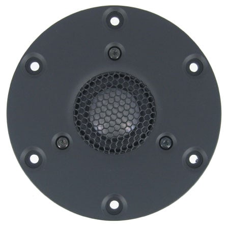

Q: What is special about the Beryllium tweeter?
A: The tweeter used in the Status 8T is the Scan Speak Model 6640, and is arguably the finest sounding tweeter on the market. It has excellent power handling, frequency response and distortion. Compared to the equivalent fabric dome from Scan Speak, the Beryllium version offers higher resolution, and lower distortion.
Editor's Note: There is a 3rd party write up comparing both tweeters (with measurements) here: http://www.audioexcite.com/?p=1953

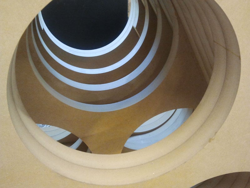

Q: Are each of the midwoofers in their own isolated chamber, and why?
A: Yes. Using a proprietary method, each of the midrange drivers is separately isolated to eliminate standing waves in the chambers. This, along with special damping materials, greatly reduces backwave energy which can radiate back through the cone of the driver. In addition, there are no parallel walls inside the cavities which further reduces standing waves.

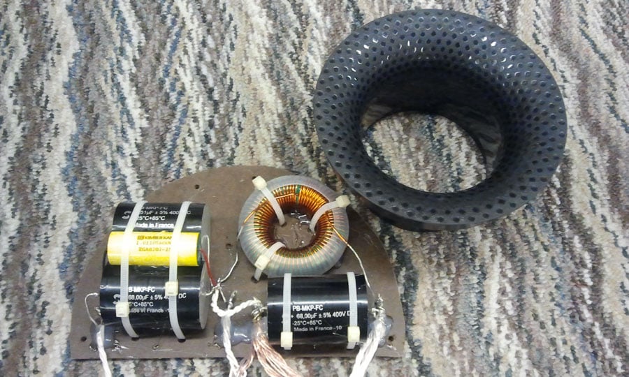

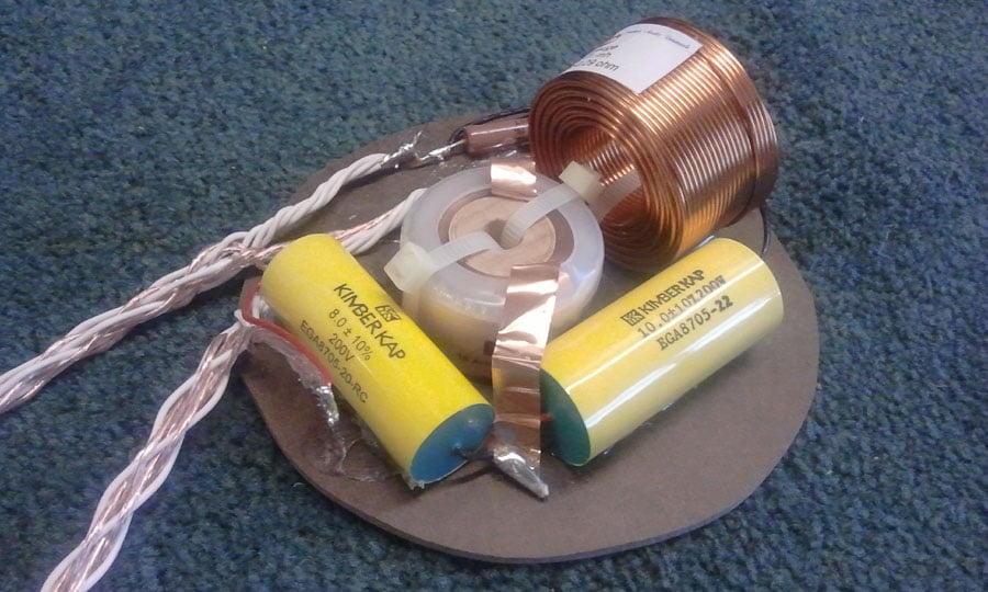

Q: Can you tell us about the Crossover Networks?
A: The woofers utilize their natural roll-off for several octaves before employing a 2nd order electrical Lowpass filter. This allows for the best possible integration between the bass and satellite modules. The midrange drivers use an asymmetric Bandpass filter to effectively filter bass frequencies for increased dynamic range while also seamlessly integrating with the tweeter. The Tweeter utilizes a 4th order HPF @ 2500Hz. This ensures increased power handling and better integrates the tweeter with the summed response from the midrange drivers.
Status Acoustics 8T Crossovers: Tweeter HPF (Left
Pic); Midrange BPF (Right Pic)

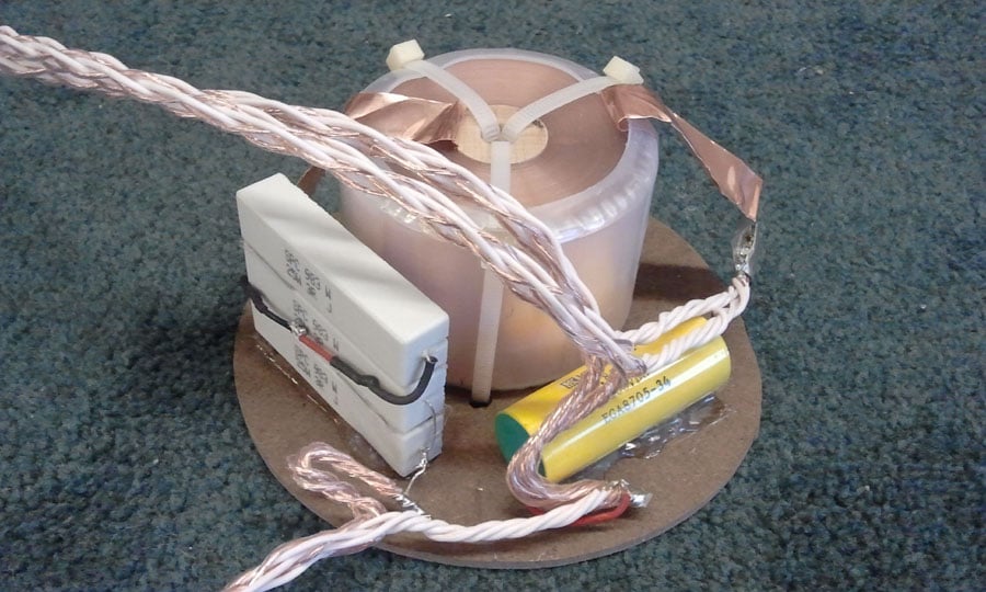

Status Acoustics 8T LPF Bass Module
Q: Are there any special parts in the crossover and why?
A: Yes, the crossover network for the Status 8T system employs some of the finest components available, regardless of price. Ultra high quality Jensen foil inductors are used in the network to minimize losses and ensure uncompressed sound at any power level since the coils will NOT saturate within the output capabilities of the loudspeakers. High voltage, tight tolerance Kimber and Solen polypropylene capacitors are used throughout the network. You won’t find any electrolytics.
The subwoofer inductor is a large, 14AWG torrodial core with very high power handling and extremely low DCR (handles 700 Watts continuous at 500Hz where the speaker is already rolled off). This ensures no saturation at all within bandwidth used at any power level.
Because there are no resistors used in the crossovers that are in series with the drivers, there is no chance of compression caused by overheating of resistive elements at high power levels.
The Status 8T speakers are all internally wired with approximately 50ft of Kimber 4TC high performance speaker cable. Given the number of drivers that are driven in parallel in the speaker system, the net harness size is equivalent to a 5AWG conductor.
Q: Why are the crossovers point to point hand soldered as opposed to being mounted on a PCB?
A: Our goal was to minimize losses by providing the least resistive path with the fewest connection points between components in the crossover. The best way to do this is through point-to-point soldering. All of our crossovers are hand built by our senior techs and special care is taken to ensure components are properly soldered directly together vs. through a PCB.

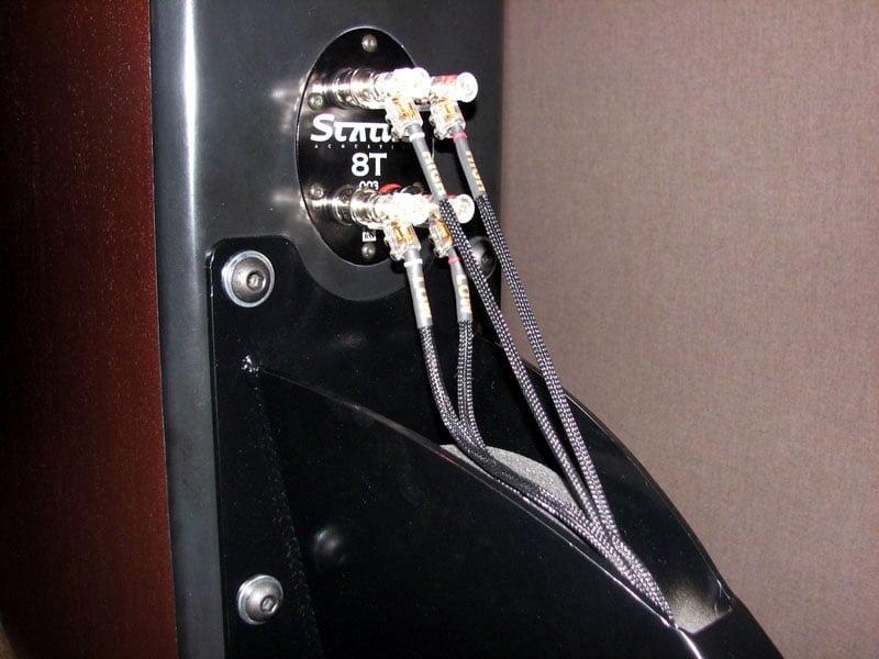

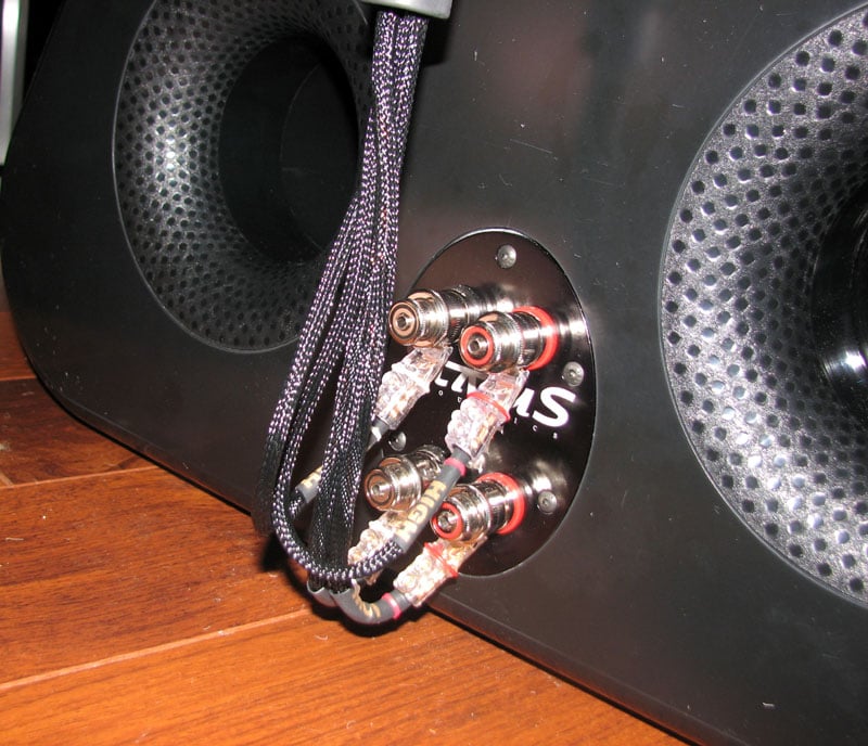

Q: Please explain the connection scheme for the Status 8T Speaker System?
A: There are two sets of terminals for both the satellite and bass modules.
Status Acoustics 8T Satellite Terminals (left pic) Bass Module Terminals (Right pic)
Bass Module:
- Both sets of terminals on the bass module are paralleled together. The recommended configuration is to use the bottom set of terminals as the input from the amplifier and the top set of terminals as the output to the satellite midrange/tweeter module.
Satellite Module:
- Top terminals connect to HPF crossover network for the tweeter.
- Bottom terminals connect to the BPF crossover network for the midrange drivers.
Editorial Note about Status Acoustics 8T Terminal Connections:
The Audioholics review samples were custom configured with the HP for the midrange section in the bass module so the midrange drivers in the satellite section can be easily connected without the HPF. When bi-amping the system in this configuration, one may choose to use bass management to employ an active high pass filter for the midrange drivers.
The Status Acoustics Titus 8T can be single, bi and tri wired and amplified which opens up a wide diversity of connection options to suit the particular customers needs.
