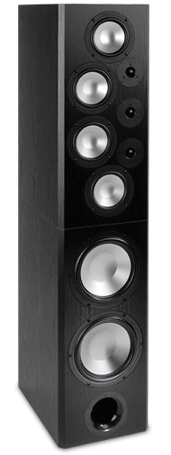

In preparation for our visit from RBH Sound on November 7th , we have prepared a short FAQ article to better understand their new flagship Signature Series speaker system know as the T-2 (not to be confused with Terminator 2?). Technical Director and Chief Designer Shane Rich of the RBH Sound T-2 System has responded herein to our questions. Given the sheer size and weight of this system, we believe it is properly named and may be the Arnold Schwarzenegger speaker of choice.
System Type: Modular Tower |
Frequency Response: 20Hz - 20kHz±3dB |
Sensitivity: 90dB (2.83V @ 1 Meter) |
Power Handling: 500 Watts |
Drive Units: (2) 10" Aluminum Woofer |
(4) 6 1/2" Aluminum Woofer |
(3) 1" Silk Dome Tweeter |
Tweeter Protection: No |
Crossover Frequency: 2500Hz |
Crossover: 24dB/Octave |
Impedance: 4 Ohms |
Cabinet Material: Medium Density Fiberboard (MDF) |
Cabinet Finish: Black Oak Woodgrain with NevamarT tops and bases |
Dimensions: 61 1/4""H x 13 1/4"W x 18"D |
Weight: 190 lbs. |
