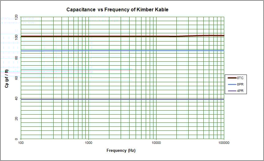

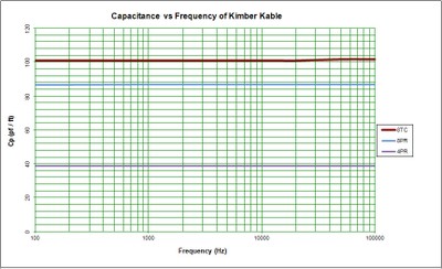

  • (Cp) parallel capacitance:     821.0 pF @ 20 kHz

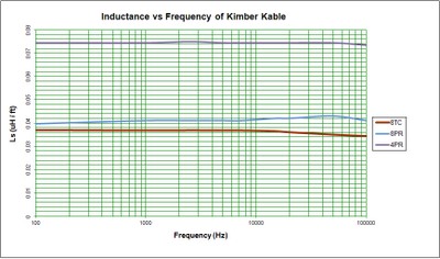

  • (Ls) series inductance:     0.345 µH @ 20 kHz

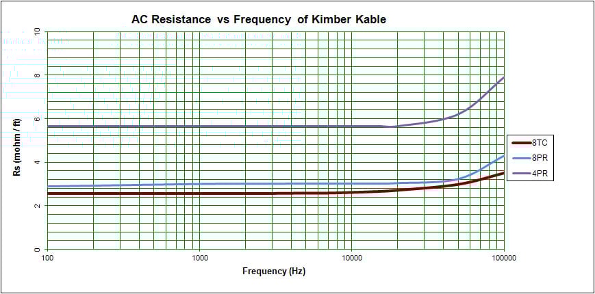

  • (Rdc) dc loop resistance:     0.018 Ω
  • (Xt) total reactance:     0.044 Ω @ 20 kHz
  • Frequency response ± 0.5 dB: dc - 300 kHz

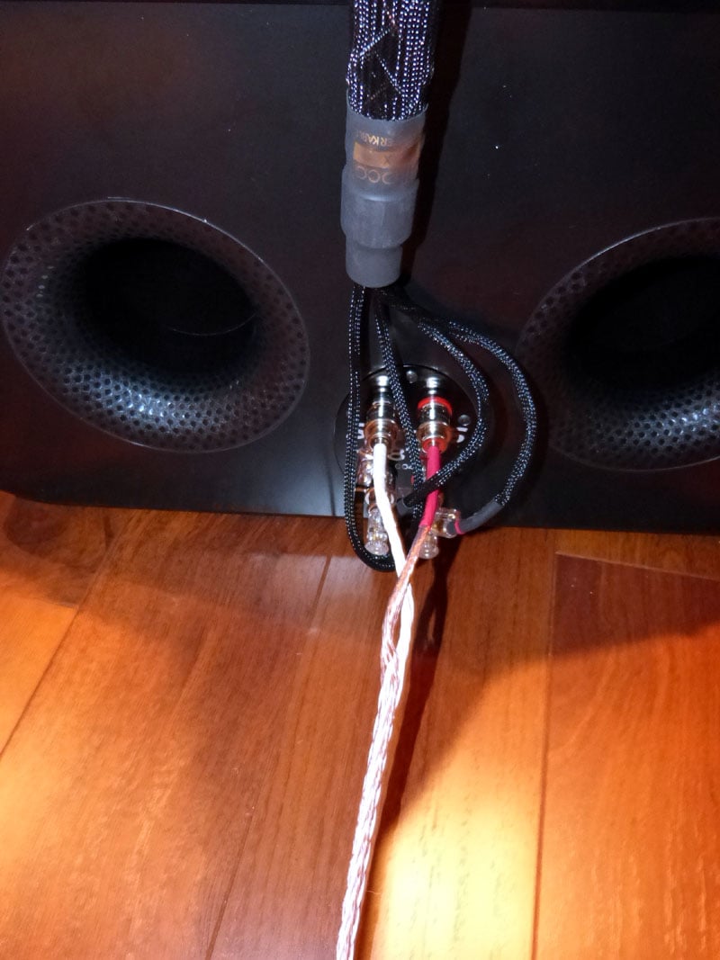

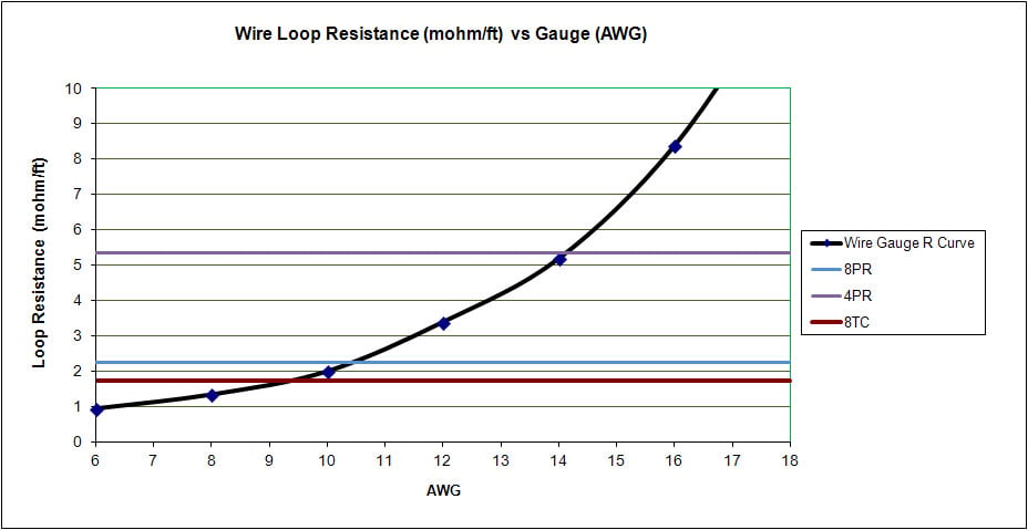

wbt.0610.pngAccording to their website, the Kimber 8TC speaker cables consist of sixteen individual TCSS conductors; eight clear and eight white, arranged in a large format braid. They go on to describe the wire as “hyper-pure copper utilizing their proven VariStrand conductor geometry.” I can’t really confirm or deny this statement and most exotic cable vendors try to sell the consumers on the purity of their copper. That being said, I’ve never seen a Kimber product oxidize (turn green) or corrode like you see ordinary 12AWG lamp cord do. Kimber claims their insulated dielectric is a high-pressure, low-temperature extruded fluorocarbon. That sounds fancy and important but what they are really telling you is they managed to efficiently pack a lot of wire density into a small area.

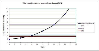

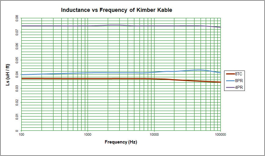

As with all Kimber products, you won’t find any voodoo—such as batteries slapped onto their cables. Instead they utilize proven braiding techniques by interweaving wires to reduce cable inductance while at the same time using generous amounts of copper to keep the most important metric in speaker cables at a minimum – resistance. The aggregate wire size is two 9AWG conductors. I measured an effective gauge of just under 11AWG but more on that later.

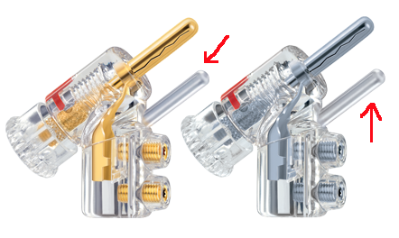

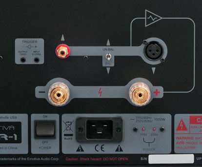

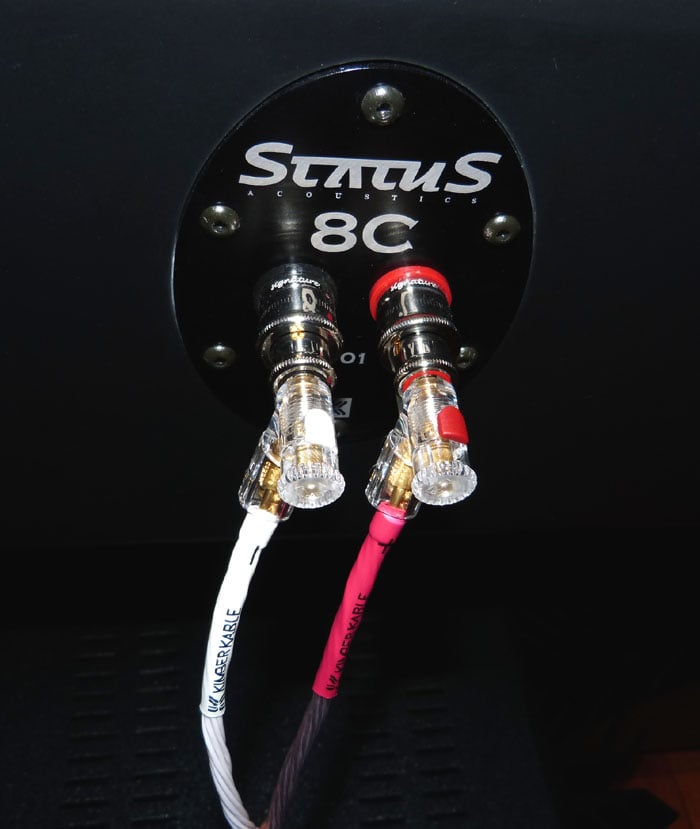

I love the terminations Kimber employs on their cables. From their standard banana to their compression WBT, they look wonderful and perform great as well. The only gripe I found was when using their WBT compression connector, the little plastic post was preventing me from connecting to the Emotiva XPR-1 amplifier I had under review at the time. I quite honestly don’t understand why Kimber even has this piece of plastic which seems pretty unnecessary to me. I had to cut them off with a pair of wire cutters so that I could connect the 8TC cables to the Emotiva amplifiers. Be prepared to do this if you chose this termination for an amplifier with a speaker binding post like the one pictured below.
Emotiva XPR-1 Amplifier Back Panel View
Kimber’s standard banana plug fit perfectly snug on all of my amplifiers and loudspeakers in my reference system. It’s a less costly connector and you can avoid any potential compatibility issues if you just decide to go that route.
