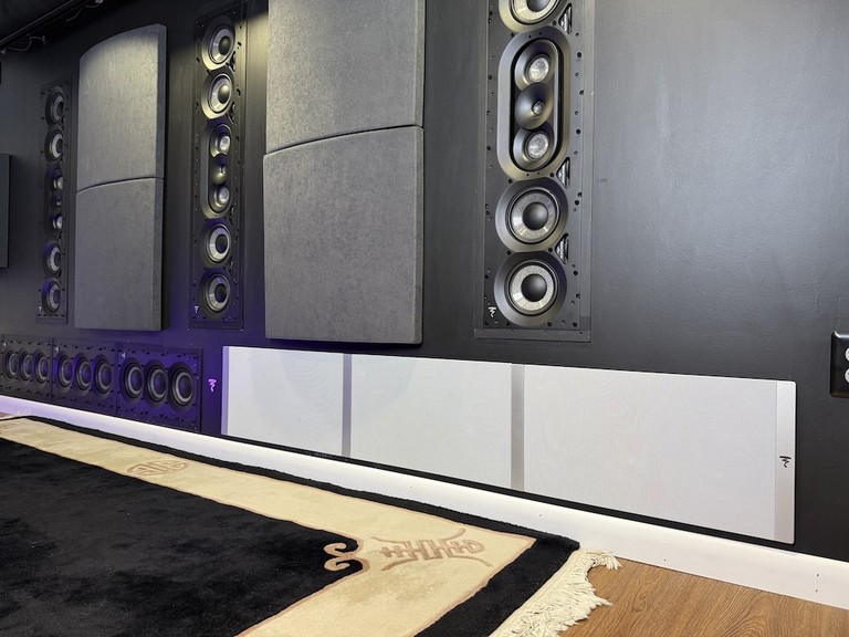

Focal 1000 Utopia Subs below screen
The Focal 1000 Utopia with Stewart Filmscreen StudioTek 130 G4 2.4 AT screen.

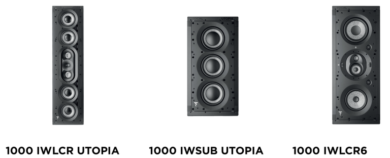

Let's take a look at Focal's 1000 series architectural line. There are seven distinct models—all made in France.
  • Three in-wall speakers: The IWLCR Utopia ($7,999), IWLCR6 ($2,999), and IW6 ($1,999)
  • Three in-ceiling speakers: (ICW-6 ($1,199), ICA-6 ($1,299), and ICLCR5 ($2,499)
  • An in-wall subwoofer: The IWSUB Utopia ($2,999)
Only the IWLCR Utopia and IWSUB Utopia bear the “Utopia” name. When Focal designates a speaker “Utopia,” it represents the highest expression of Focal’s engineering and design.

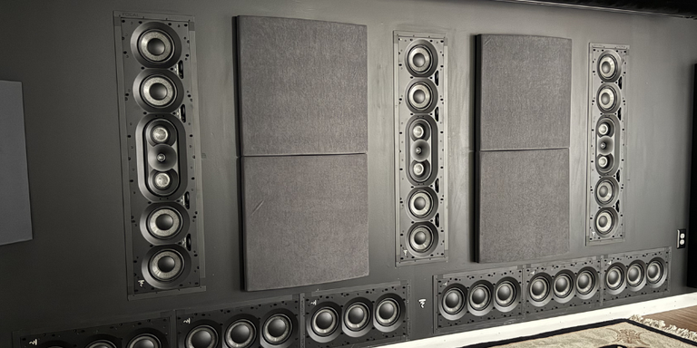

I spent a considerable amount of time consulting with Focal’s Product Specialist, Chris Shaw about my objectives and installed the following 16 speakers to achieve my reference home theater and two-channel music demands.

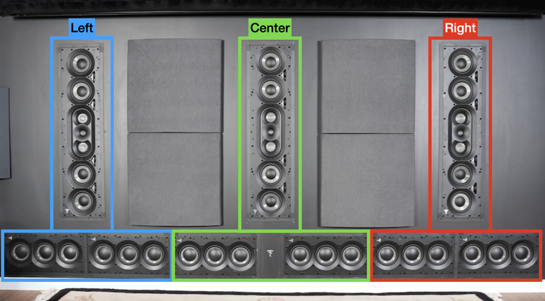

    • Front LCR speakers: 3x Focal 1000 IWLCR Utopia
    • Subwoofer Modules: 6x Focal 1000 IWSUB Utopia. Two IWSUB modules were mated to each left, center, and right channels
    • Double Side Surround and Rear Speakers: 6xFocal 1000 IWLCR6. Four for side surrounds to cover two theater rows and two to serve as rear surrounds.
    • In-ceiling speakers: 4x Focal 1000 ICW6.

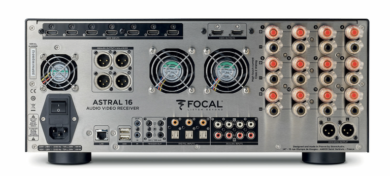

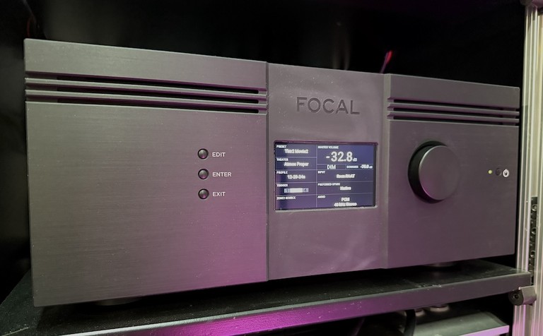

    • AVR: Focal Astral 16, based on Storm Audio’s platform (200 WPC x 12 ALL CHANNELS DRIVEN!).

           Focal Utopia Subs

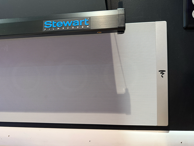

          The Focal IWSUB Utopias are visible below the Stewart Filmscreen StudioTek 130 G4 creating a stunning aesthetic.

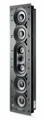

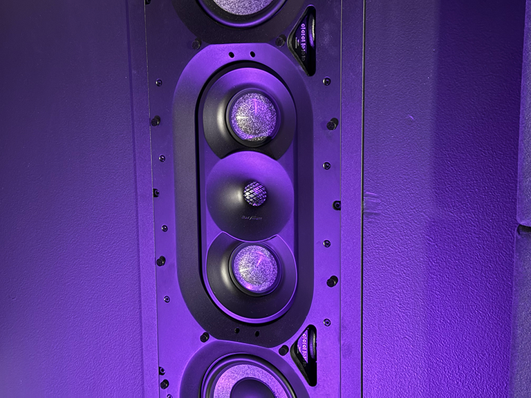

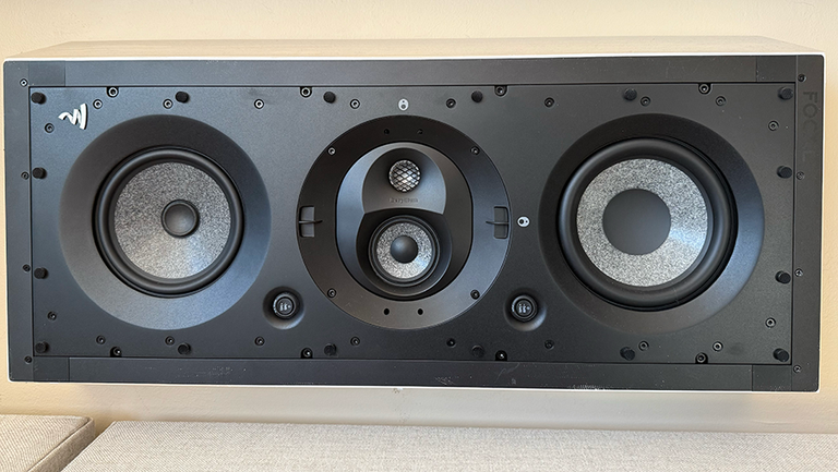

          Focal's 1000 IWLCR Utopia is an 8 Ohm, 92dB, three-way, closed back speaker. It features 1-inch inverted dome Beryllium Tweeter housed in an acoustic waveguide. The IWLCR Utopia tweeter is unique. Focal says it’s an optimized, higher-end version of the tweeter found in the other 1000 series speakers with improved damping and other enhancements.
          The Beryllium tweeter is flanked by two 3.12-inch “W” Cone “M”-shaped midrange drivers. The MTM tweeter-midrange assembly pivots ±15-degrees side to side to adjust the tweeter-midrange to the listening position like a freestanding speaker. The combination of the MTM configuration, waveguide, and pivoting midrange-treble plate are all intended to optimize dispersion and directivity. If you’ve been bothered by the inability to fine tune speaker imaging with an in-wall speaker, Focal has you covered.
          There are no markings on the Focal's tweeter-midrange assembly, therefore there's no way to tell the amount of "toe in" other than using your ears.  I wish Focal would provide markings on the assembly for more precise angling of a stereo pair.
          The speaker has four 6 1/2 inch “W” Cone Drivers flanked in pairs at the top and bottom handling the bass frequencies. The IWLCR Utopia weights in at a beefy 42.7-pounds and towers at an imposing 45 3/4-inches tall. This is a reference speaker in an in-wall design.
          The drivers are housed in an aluminum frame and voiced to an MDF back box for consistent performance regardless of the wall environment.  The 1000 IWLCR Utopia needs a 3.87-inch mount depth, allowing it to fit in a standard 2x4 wall or 2x6 studs.
          The IWLCR Utopia can bi-amped, horizontally installed for center channel duties, or surface mounted with Focal's optional on-wall frame.  If you are considering the IWLCR Utopia as a center channel installed horizontally, you may recall that here at Audioholics we advocate for W(M/T)W center channel designs. The IWLCR Utopia is an exception to the rule. It’s just a monster speaker—far larger than most center channels. Its off-axis performance out about 20-30 degrees solid. We therefore have no issues recommending its MTM design for horizontal center channel duty for most installs but you'd ideally want to orient all 3 LCR speakers vertically for the most consistent sound across ALL of your seats.
          1000 Utopia angled tweeter
          Pictured here is the front left speaker. Notice that the tweeter-midrange drivers is angled towards the RSP.

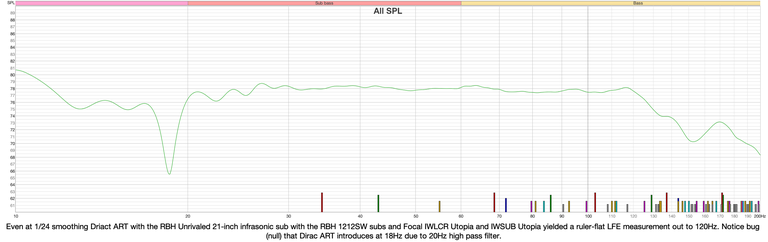

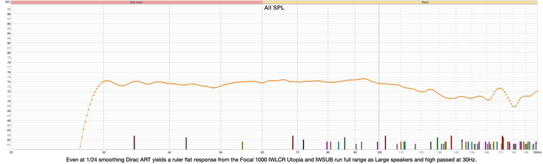

          As a testament to the IWLCR Utopia’s performance and build quality, you can send LFE signals to the IWLCR Utopia when used in conjunction with the IWSUB-Utopia. You can cross the IWLCR Utopia to the IWSUB Utopia at 120Hz, 100Hz, or 80Hz via the jumpers.  Focal says that the 80Hz setting is best for sound quality and 120Hz for maximum SPL.  I did prefer the 80Hz crossover as it sounded more natural. In case you’re wondering, the speaker connectors are hefty and can accept 12-gauge speaker cabling with little issue.

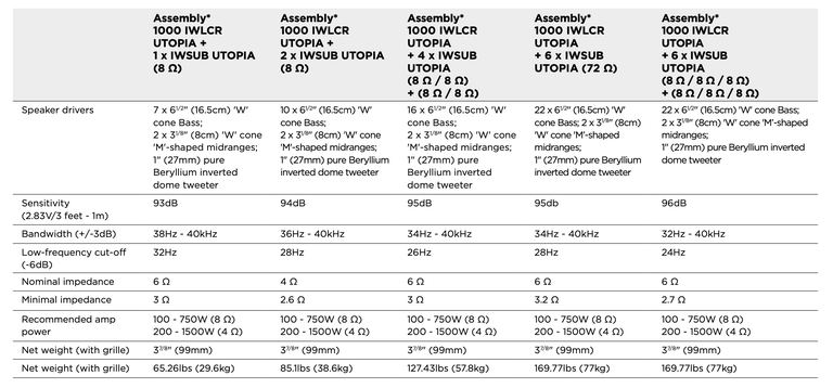

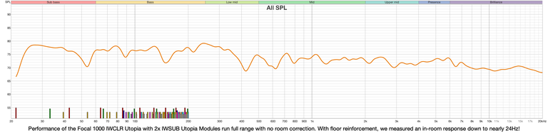

          IWSUB Utopia performance when daisy chained
          Focal provides the above table outlining the performance of the IWLCR Utopia when paired with 1, 2, 4, or 6 IWSUB Utopia modules.

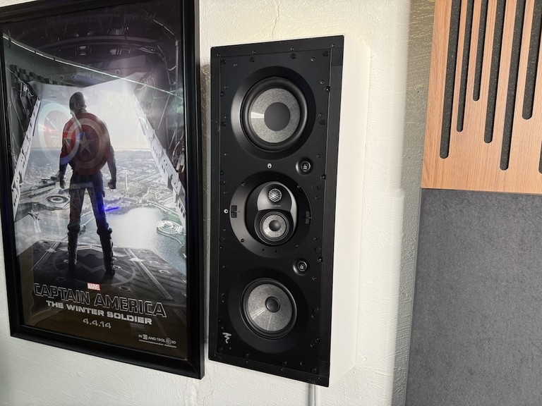

          Focal 1000 IWLCR6The Focal IWLCR6 is the “little” cousin of the IWLCR Utopia. While the IWLCR6 lacks the “Utopia” designation and Utopia performance, there are some clear similarities. Weighing in at 24-pounds and 29 3/4 inches tall the IWLCR6 is no tiny speaker.  The IWLCR6 features a 1-inch, pure Beryllium, inverted dome tweeter and a 3 1/8 “W” Cone midrange.
          The midrange and tweeter drivers sit in a waveguide and the entire midrange assembly pivots 15-degrees left and right. If you remove the locking screws, you can rotate the midrange-treble plate 90-degrees for horizontal applications so that you have an MMTM configuration for center channel duties.  The midrange-tweeter plate is flanked by a 6 1/2-inch “W” Cone driver and a 7 1/8-inch passive radiator.  Using a passive radiator is a reasonable design choice when you have a non-ported, high output system in a smaller enclosure.
          This is an 8 Ohm nominal rated speaker with 91dB sensitivity and a frequency response of 48Hz to 40kHz ±3dB. The minimal impedance does dip down to 2.9 Ohms so in reality, it's really a 4 ohm speaker and you should plan for that when pairing amplification. The mounting depth is 3 7/8 so the 1000 IWLCR6 fits in a standard 2x4 bay, 2x6 studs, or can surface mounted using Focal's on-wall frames.
          IWLCR6 Horizontal
          Detail of the Focal 1000 IWLCR6's tweeter-midrange plate rotated 90 degrees for horizontal installation as a center channel speaker to yield an MMTM configuration.

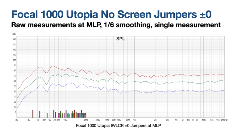

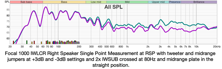

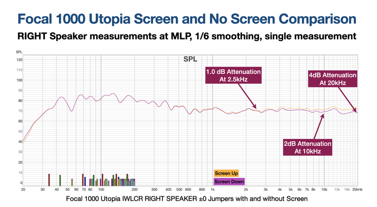

          Customizable Frequency Response with Jumpers

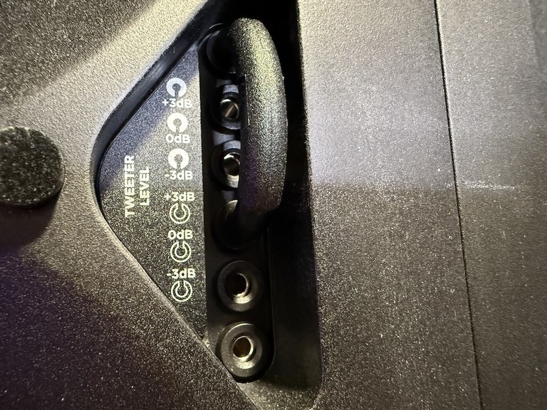

          All 1000 series models feature driver and tweeter attenuation options. The IWLCR Utopia jumpers fine-tune the frequency response across the tweeter, midrange, woofers. The jumpers on the IWSUB Utopia set the impedance depending on how many IWSUB Utopias you have daisy chained together, if you’re designating the IWSUB as a subwoofer. The IWLCR6 and ICW6 speakers each have HF and midrange compensation switches.
          Remember that a speaker cannot create more power or output. Therefore, Focal recommends opening up all jumpers to their maximum position if you are using room correction software with any model in the 1000 series. Since I would imagine the overwhelming majority of customers would be using the IWLCR Utopia with a processor, the jumpers are in some ways a superfluous feature.
          Focal Jumper Detail for 1000 Series
           The IWLCR Utopia adds high quality jumpers that can attenuate the frequency of the tweeter, midrange, and low frequency response of the speaker as well as set the crossover to any connected IWSUB Utopia modules.

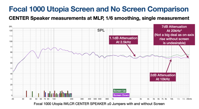

          In case you're wondering what the impact of the jumpers is on the speaker's frequency response, here's a single point measurement of the right speaker at the RSP with the individual tweeter and the midrange jumpers set to +3dB (green trace) and -3dB (purple trace) to demonstrate their real-world impact in-room. The measurement below is without any Dirac or EQ applied with the exception of the 30Hz HPF. Measurements with the jumpers at the ±0 position are further down.

          Take note that the system's impedance varies depending on the modular configuration. A single IWLCR Utopia has a nominal impedance of 8 Ohms and 4.2 Ohm minimal impedance. Adding IWSUB Utopia modules to the IWLCR Utopia drops the nominal impedance to 4 Ohms and the minimal impedance to 2.6 Ohms! Even with the speaker’s sensitivity at 94dB,  you need amplifiers beefy enough to handle loads that dip into the 2 Ohm range.
          The Focal Astral 16 is one of the few AVRs on the planet that didn’t break a sweat driving the three IWCLRs and six IWSUB Utopia pairings. Driven with the Astral 16, the 1000 Series Utopia and RBH system was never short on SPL. I hit 107dB peaks from the system measured from the second row of my theater playing the spice harvester scene in Dune Part 1 and the desert run scene from Tom Gun Maverick

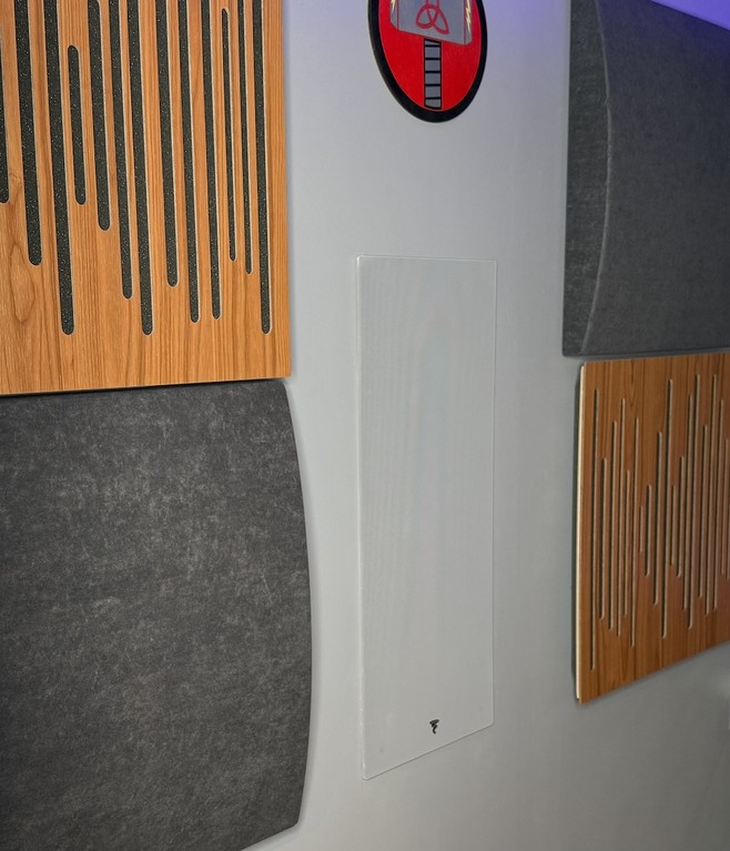

          Unboxing and Expandable Magnetic Grilles
          Appreciating the build quality of these speakers is best done first-hand. Each speaker’s aluminum enclosure and MDF back box let you know that you’re dealing with a whole different level of speaker. In the box, you’ll find a paintable, magnetic grille, plastic paint cover, cutout template, white and black grille cloths (for optimizing color matching), custom installer catalog, and QuickStart guide with QR scan codes for a full user manual and installation video tutorials.
          The Utopia models include brushed silver end caps and joining plates. The end caps come with both plain and Focal-branded versions to optionally showcase your Focal fandom.
          Focal 1000 Utopia Endcap
          Detail of the brushed aluminum end-cap with Focal logo.
          They adhere to the grilles with some robust 3M tape. I found the tape’s backing challenging to remove at times. The drawback of this modular design is that the end caps and joint straps do require some massaging to sit “flat” and you may not get a perfectly flat result in all instances.
          Expandable Focal 1000 Grilles
          Here, I have daisy-chained three grilles for the IWSUB Utopia models with the two brushed silver endplates and two joining plates to show the slick expandability of the paintable grilles.
          As of this writing, I’ve spray-painted the majority of my in-ceiling and surround speaker grilles with a Wagner spray gun. When viewed from an angle, the grilles are almost invisible, rarely calling attention to themselves. The 1000 ICW6 are the easiest speakers to install. I inserted the Quick Install frame into my ceiling, activated the tensioned locking spring, and then simply inserted and twist-locked the speaker.  Done.
          Focal 1000 Painted Grille
          Angled view of the Focal 1000 IWLCR6 side surround with painted grille flanked by Vicoustic acoustic panels.
          The 1000 IWLCR Utopia, IWSUB Utopia, and IWLCR6 all have dog ears, which are finicky.  The manual says to hand tighten the dog ears with a hex key.  Good luck. You can’t get enough speed to keep the dog ears elevated without a drill.  Even with the drill, there were some occasions where I had to back out the dog ear and then redo the process.
          I used CL2-rated, 4-conductor, 12-gauge speaker cabling from Monoprice to each speaker. While using two conductors for each positive and negative speaker terminal was a bit of a challenge, I was pleasantly surprised to see the 1000 Series accept such heavy gauge cabling.
          If you’re installing a Focal 1000 series yourself, be warned that the cut out template shows the center of the template not the location of the tweeter. I cannot emphasize how important it is to install the speakers with tweeters at ear hight and get this right.  For my installation, we used a self-balancing laser level across the front wall to eliminate any variation from the floor to ensure that all three LCR speaker tweeters were perfectly aligned to each other and to ear height. Getting speakers installed at ear level is especially true for any speaker model that has narrow vertical directivity. Measure twice and cut once.

          L-C-R Focal 1000 Utopia Configuration
          Each pair of IWSUB Utopias was connected via SpeakON cable to the IWLCR Utopia to create a logical, full range speaker.
          This setup not only enhanced bass response (I measured close to 24Hz in-room!) but also created an eye-catching driver array underneath the Stewart Filmscreen StudioTek 130 G4 that everyone who comes into my space raves about. I learned to really appreciate the installation flexibility afforded by the Utopia’s modular design. If you're looking for a music-only in-wall solution without subs, the Focal 1000 Utopia delivers.
          Full range performance of 1000 IWSUB Utopia
          The Focal 1000 IWLCR Utopia paired with 2x IWSUB Utopia modules produced an in-room response close to 24Hz when set to "Large" and run full range with no EQ applied. Single point measurement at the RSP.

          To realize the full potential of the 1000 Series, I paired the speakers with Focal’s Astral 16 AVR, based on the Storm Audio platform. The Astral 16 supports Dolby Atmos, DTS:X, and Auro-3D.
          Focal Astral 16
          Focal Astral 16 AVR in my rack
          The processor's stability into low-impedance loads and ability to power complex speaker configurations made it a perfect complement to the Focal 1000 Series. This 16-channel processor delivers 200W into 8 Ohms, 400W into 4 Ohms, and 650W into 2.7 Ohms with three channels driven. It will deliver 200W into 8 Ohms and 300W into 4 Ohms with all channels driven
          Focal Astral 16 Back Panel
          The flexibility and performance I had available through the Astral 16 was lightyears ahead of any other AVR or pre-pro I’ve reviewed.
          Now step back and think about these numbers: This raw power is from an 7.5-inch tall, 44-pound AVR.  Gene DellaSala did an extensive review of the Storm Audio ISP MK2 AV Processor (a sister processor to the Astral 16 AVR). I’ll refer you to click here for Gene’s in-depth review for technical details and measurements.
          The flexibility and performance I had available through the Astral 16 was lightyears ahead of any other AVR or pre-pro I’ve reviewed. I also unlocked and upgraded the Astral 16, which added Dirac ART to my arsenal. More info here.

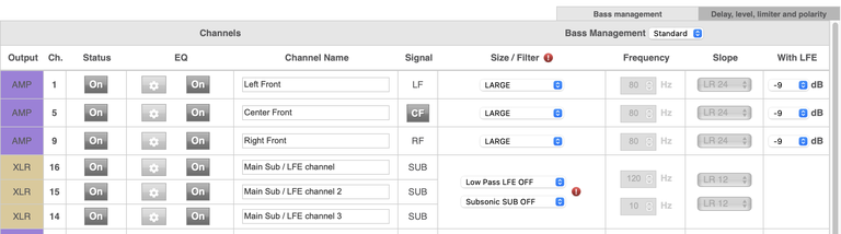

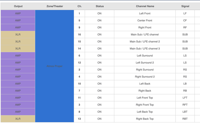

          There were some specific configuration settings Chris Shaw had me perform in the Astral 16 to optimize the 1000 Utopia's performance:
          First, Chris had me configure the Utopia left, center, and right channels to full range ("Large") in the Astral 16.
          Focal 1000 Utopia Full range in Astral 16
          Focal's Chris Shaw had me run the IWLCR Utopias full range by setting them to "Large" and run LFE to the mains.
          Secondly, Chris had me send LFE to those LCR channels.  That Focal advocates sending LFE to the mains is a testament to the Utopia’s design and performance.  It is not recommended to send LFE to any other 1000 series model.  With this configuration, you get steerable bass throughout the space. Obviously the optimal configuration would be an all 1000 Utopia bed layer.
          Third, Chris had me apply a 48db/Octave Linkwitz-Riley high pass filter at 30Hz on the main LCR channels to implement driver protection on the 6 1/2-inch drivers running the LFE channel.
          30 Hz High Pass filter on Focal Utopia
          The Astral 16 has powerful, granular, manual EQ filters that allow you to fine-tune your speaker installation with real-time effects on-screen. You have nearly infinite control over your speaker environment.
          Fourth, the Astral 16 has three independent power supplies. I reconfigured the LCR channels to run each channel on its own power supply. I staggered the remaining channels across the three power supplies to optimize power delivery. I then ran Dirac Live on this configuration without any subwoofers and saved as a profile.
          I subsequently performed an additional Dirac calibration and added the RBH Unrivaled 21-inch infrasonic sub and RBH 1212SW Subs to round out the configuration and saved to a different profile.  Suffice to say, I was exceedingly pleased—no, dumbfounded—by the bass articulation from an all-in-wall configuration running full range!
          Astral 16 power supply allocation
          The Astral 16 features three independent power supplies across its 12 amplification channels allowing you to stagger the LCR channels across each power supply channel group 1-4, 5-8, and  9-12. Hence Left = Channel 1, Center = Channel 5, and Right = Channel 9.

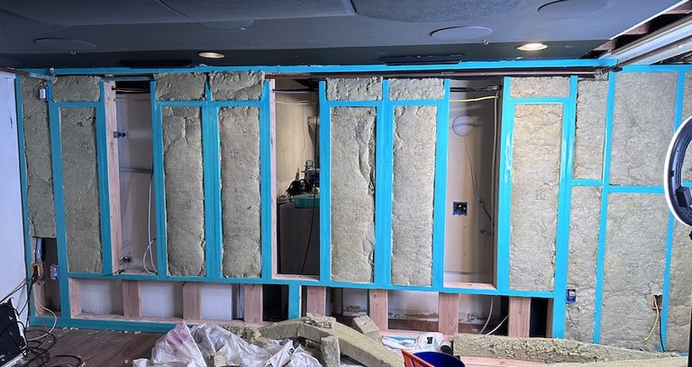

          Unexpected Challenges: Tear Down the Wall!

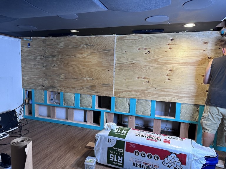

          I ran into an unexpected issue with the Focal IWLCR Utopia and IWSUB Utopia speakers in the front wall. Despite the baffle wall being 2x6 studs and 5/8-inch Sheetrock Type-X, the wall exhibited physical and audible vibrations when listening to certain tracks.
          I ran several frequency sweeps through the Astral 16’s built-in capabilities (another advantage of the processor) to isolate either a damaged driver or resonant frequencies exciting the Sheetrock. It was frequency-specific.
          I consulted with both Matt Poes and Don Dunn on the conundrum. I didn't want to EQ those frequencies or perform band aids. I chose to bite the bullet and rebuild the baffle wall. (Please share your baffle wall or theater build stories in the forum!) The rebuilding process derailed this review for months.
          Both Matt and Don gave me some invaluable guidance on the rebuild. Needless to say, the new baffle wall did the trick. Don simply calls it “The Bunker.”
          Rebuilt Wall Frame View
          The new baffle wall with Green Glue Joint Gasket damping tape and bays being filled with R23 mineral wool.  I also ran conduit, extra CL2 12-gauge speaker cable, and shielded CAT6 cabling for future expansion.
          In case you're interested, the new wall consists of double 2x6-inch studs; Green Glue Joint Gasket Damping Tape on all studs (front and back); a new facing of 1/2-inch plywood sheets and 5/8 Sheetrock Type-X sandwiched with Green Glue vibration damping compound; R23 mineral wool in each bay with R15 behind the Utopia speakers sub modules. I further anchored the stud rears to the concrete foundation with GenieClip L brackets for additional rigidity and dampening. Finally, I added 3/4-inch plywood to the back of the baffle wall. Now you know why Don calls it "The Bunker."
          Rebuilt Theater Wall
          Installation of the 1/2-inch plywood on top of the doubled 2x6 studs. On top of the 1/2-inch plywood, we installed 5/8 sheetrock with Green Glue damping compound in between and sealed seams with acoustical caulking.

          Here are some measurements of the Focal 1000 IWLCR Utopia and IWSUB Utopia run full range and high passed at 30Hz.  This measurement is a ruler flat response at 1/24 smoothing in room!
          Dirac ART on Focal 1000 IWLCR Utopia High Passed at 30Hz
          Impressive! Even at 1/24 smoothing Dirac ART yields a nearly "ruler flat" response from the Focal 1000 IWLCR Utopia and 2x IWSUB run full range as "Large" speakers and high passed at 30Hz.
          Integration between the RBH Unrivaled infrasonic sub, RBH 1212SW, and the Focal 1000 Utopia L&R channels as speaker support groups for the LFE channel is completely seamless. With the RBH Unrivaled added, the overall system response was measurable down to 6Hz! Check out the ruler flat frequency response at 1/24 smoothing and extension way down below 10Hz
          Editorial Note: Don't be too concerned about that 18Hz null. That's from a known bug caused by Dirac ART because it high-passes all non-infrasonic subs and speakers at 20Hz. The high pass filter cannot be defeated. The null is not present with the native or summed response of the subs. Dirac is working on a fix to address it which Gene plans on testing in his system which utilizes fullrange RBH Sound SVTRS Active system with powered subs and LFE routing.
          Dirac ART with RBH Infrasonic performance
          Even at 1/24 smoothing Dirac ART with the RBH Unrivaled 21-inch infrasonic sub, dual RBH 1212SW subs, and Focal IWLCR Utopia and 2x IWSUB Utopia yielded a ruler-flat LFE measurement from almost 20 Hz out to 120Hz.

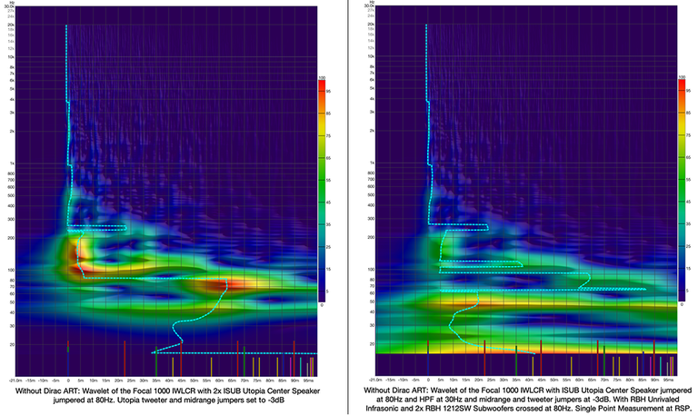

          Phase and time coherence is another critical aspect of getting bass perfected in your room.  Here at Audioholics, we like to use wavelets to show that in-room performance. Ideally we should be seeing a straight line with minimal flair at the lowest bass frequencies. What you typically get is a jagged line like a road going up a mountain slope with the most glaring issues at the crossover frequency.
          To illustrate the point, the following measurements are:
          1. Without any room correction applied to the Utopia center channel speaker.
          2. With and without the 3x RBH subs.
          3. With the IWLCR Utopia tweeter and midrange is jumpered at -3dB and the 2x IWSUB Utopia is jumpered at 80Hz with 30Hz HPF applied (configured for LFE to the mains)
          4. With StudioTek 130 G4 retracted.
          No Dirac ART Focal Utopia and RBH
          These measurements are typical of what happens when you drop a speaker and subs into a room in the real world. Wavelets give you a visual representation of the challenges we enthusiasts and pro installers faces when integrating subs. Each LCR speaker exhibits the severity of these issues to varying degrees based on its in-room location.
          Now let's look at the magic Dirac ART performs. I'm getting incredible phase linearity and time coherence from the Focal 1000 Utopias measured at the RSP played with or without the StudioTek 130 G4. As you saw in the measurements above, using wavelets in REW lays bear the severity of your integration issues.
          Now look at the performance that an advanced processor like the Astral 16 and Dirac ART can deliver. This wavelet below of the center channel with the RBH subs measured at the RSP is almost textbook! Compare it to the above measurements. In fact, notice that at 50Hz there is only a 1.1ms delay and a 10ms delay doesn't hit until a ridiculously low 30Hz. This is outstanding, seamless performance of the Focal 1000 IWLCR Utopia in-room with IWSUB Utopia modules plus the RBH Unrivaled Infrasonic sub and 2x RBH 1212SW subs.

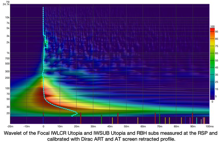

          Focal 1000 and RBH subs wavelet with Dirac ART
          The peak delay in these measurements is inaudible.  In reference systems you can see delays 2.5x greater versus what I'm seeing in these bass frequencies. Here's a look at the left speaker measured at the RSP. The minor spikes above 200Hz on the left speaker are likely caused by in-room reflections.
          LEFT Focal IWLCR 1000 Utopia with Dirac ART

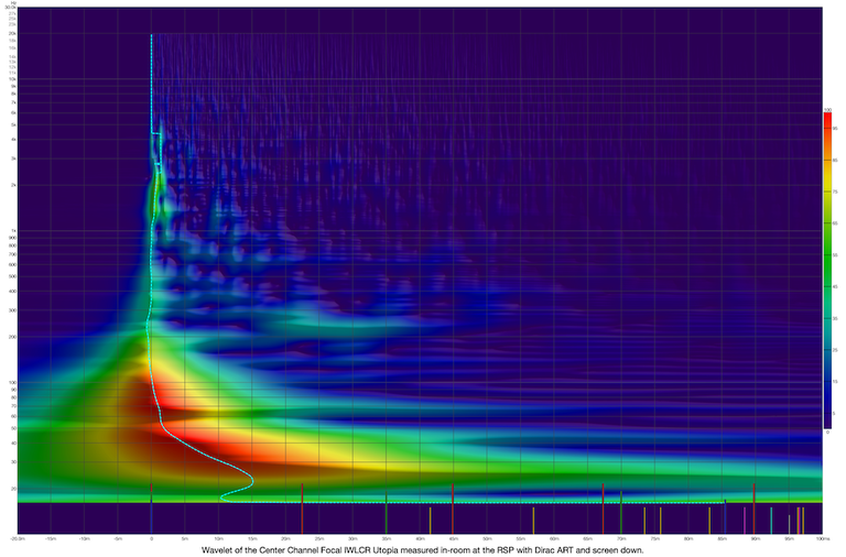

          Here is how the center Utopia speaker measured at the RSP with the StudioTek 130 G4 screen fully down with a separate calibration profile.  In all these measurements, Dirac ART delivered almost textbook in-room performance akin to the phase linearity and time coherence Gene DellaSala is getting from his RBH Sound SVTRS active speakers.
          Center Channel Wavelet Focal 1000 Utopia
          Wavelet of the Center Channel Focal IWLCR Utopia measured at the RSP with Dirac ART and AT screen down

          Let's look at the impact of an acoustically transparent screen on the 1000 Utopia's performance. All acoustically transparent screens start to show attenuation impact above 2kHz. The degree of attenuation varies on the quality of the screen.
          I happen to be finishing my measurements of the Stewart Filmscreen StudioTek 130 G4 with the company's new Ultraperf acoustically transparent perforation for a forthcoming review on the StudioTek 130 G4, so you get a sneak peek. Ultraperf is a new perforation option with smaller holes that reduces minimum viewing distance to the screen to as close as 9 feet!
          Stewart Filmscreen Ultraperf
          Zoomed and detailed view of the Ultraperf acoustically transparent perforation. I wanted perforation through the masking area of the StudioTek 130 G4 for optimal sound transfer.
          I spoke with Don Stewart who touted the capabilities of the screen and the Ultraperf.  Here are my preliminary measurements with the screen 6 7/8-inches from the speakers at the front wall. Note that you want at least 6-inches to 12-inches of space between the speakers and screen to give the sound enough area to pass through the AT screen without significant impact.
          These measurements are without Dirac engaged to simplify visualizing the impact of an acoustically transparent screen on the Focal's performance. The results are impressive and there's nothing dramatic in these measurements that you can't address with some minor EQ.
          Focal 1000 LCR at RSP
          Focal IWLCR Utopia left, center, and right speakers with jumpers set to the "0" position.
           Focal 1000 Utopia Left Speaker Measurement
          Measurements of the Left IWLCR Utopia and jumpers set to the 0 position with and without the screen at the RSP.
          The StudioTek 130 G4's performance is outstanding with minimal attenuation above 2.5kHz. The 4dB attenuation at 20kHz is inaudible.
           Focal 1000 Utopia Center Speaker Measurement
          The StudioTek 130 G4's performance is outstanding with minimal attenuation above 2.5kHz and it actually softens the HF rise on-axis.
           Focal 1000 Utopia Right Speaker Measurement
          These measurements are a testament to the performance of the 1000 Utopia and the Stewart Filmscreen StudioTek 130 G4, which I should note is a vinyl—not woven—screen. The measurements point to the fact that the Focal 1000 Utopia are minimally impacted when placed behind a high quality acoustically transparent screen like the StudioTek 130 G4 with Ultraperf. The bottom line: Yes, you can get exceptional sound with reference in-wall speakers placed behind an AT screen.
