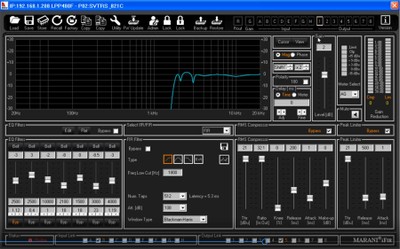

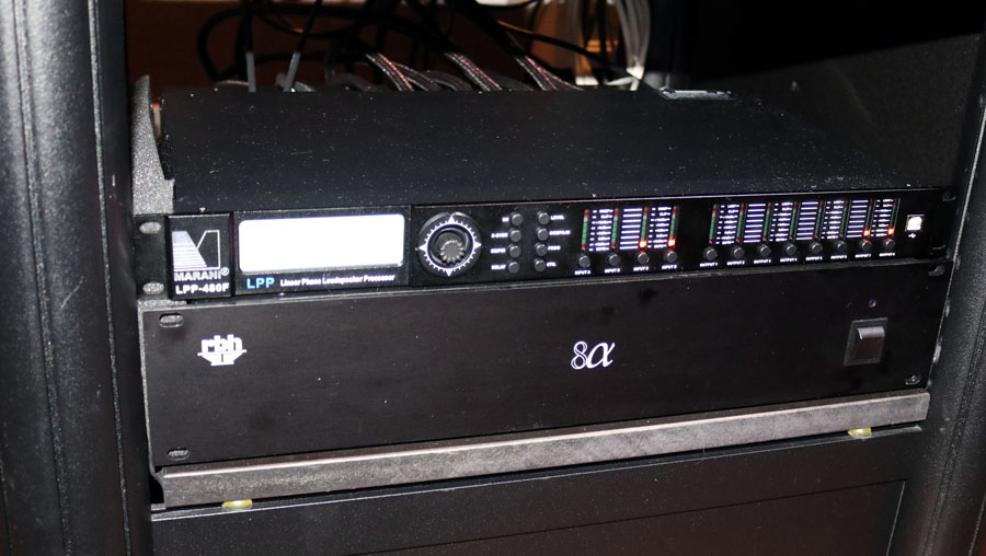

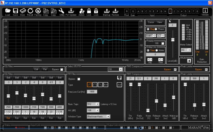

Marani DSP & Active Crossovers
MaraniThese speakers have no passive crossovers. This means the drivers are directly coupled to the amplifier for less losses and superior transient response and driver integration thanks to active crossovers. RBH Sound takes the active approach to the next level by employing Finite Impulse Response (FIR) filters instead of IIR filters like most active speakers currently use. FIR advantages are two-fold. Unlike IIR filters whose phase response is inherently linked with the magnitude response, FIR offers the ability to manipulate magnitude and phase independently. The end result is not only perfect driver integration, but also a time and phase aligned speaker without the trade offs of power handling or off-axis aberrations when attempted in the analog domain with complex first-order crossovers or angled baffles to align drivers on the same plane. The reason why you don't see many active speakers employing FIR filters is the amount of processing power needed to accomplish this effectively. It's not cheap and hence that’s why RBH Sound is using the Marani LPP-480F flagship DSP speaker management processor, typically used for commercial applications, at the heart of this system. The Marani does it's processing at 96kHz/24 bit and has a whopping 8 x 1024 taps up to 2 x 4096 taps if combining 4 channels for each FIR. It takes a lot of taps to do proper FIR filtering and this type of processing power wasn't available a few decades ago. So before some buckaroo jumps on the forum boasting of a vintage active speaker system they used in the 80s that supposedly did the same thing, realize the 8-bit 1 MHZ Commodore 64 processor back in the day just couldn't cut it.

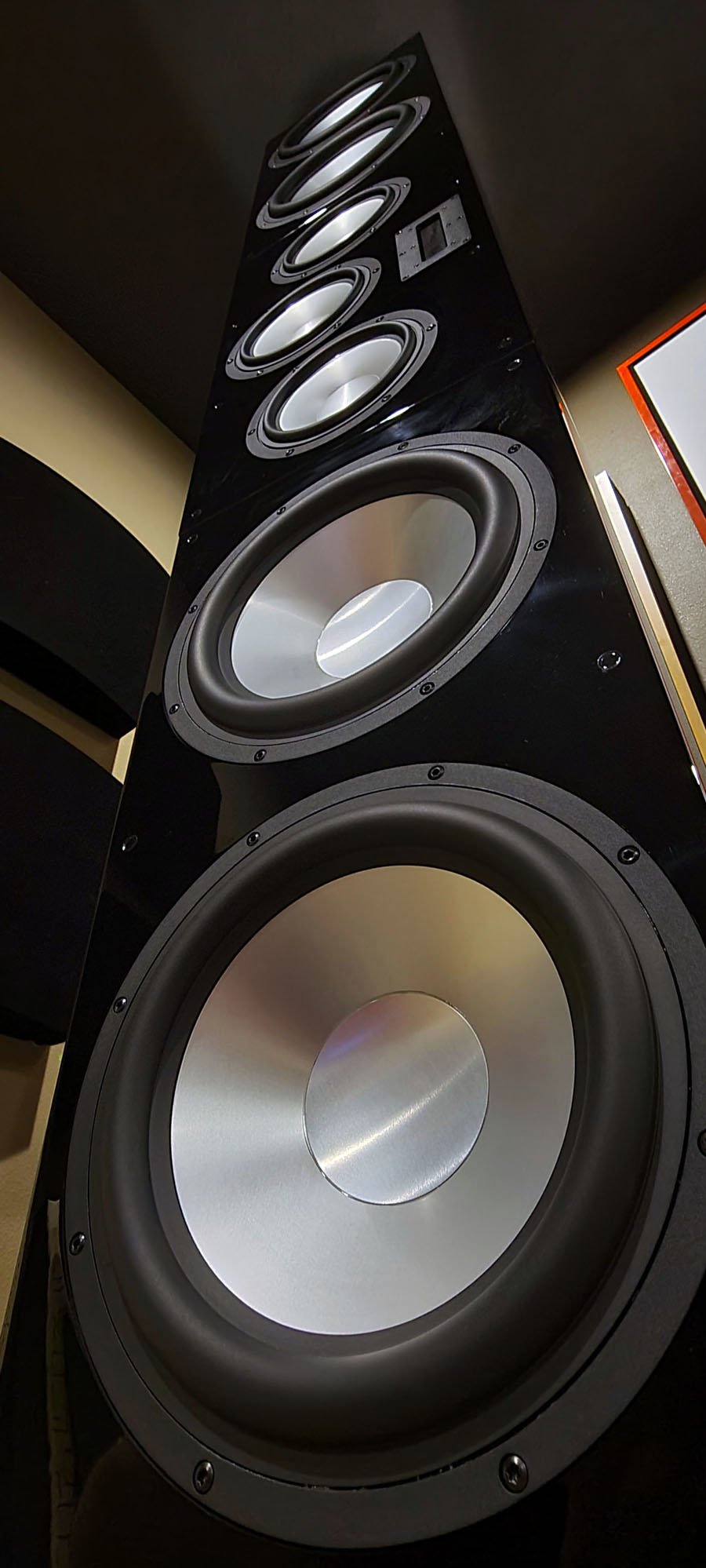

The Drivers
We've covered the wonderful RBH aluminum cone drivers ad nauseam in prior reviews. Suffice it to say, imagine the incredible 10" bass driver from the Status 8T and make it 12". Now multiply that by 4 for each speaker. That's right, each SVTRS houses dual SV-1212 subwoofers for a total of eight 12" bass drivers to round out the bass of the system. One SV-1212 subwoofer easily exceeds our Extreme Bassaholic room size rating. Having four of these subs increases they system output +12dB while also helping to control vertical room modes by loading into the room in two locations (floor and ceiling) per speaker. These subs have the largest ports I've ever seen. The port diameter is a whopping 6 inches and the combined port volume for the system is 50 liters! What does this mean? Lots of low frequency output without chuffing or compression.

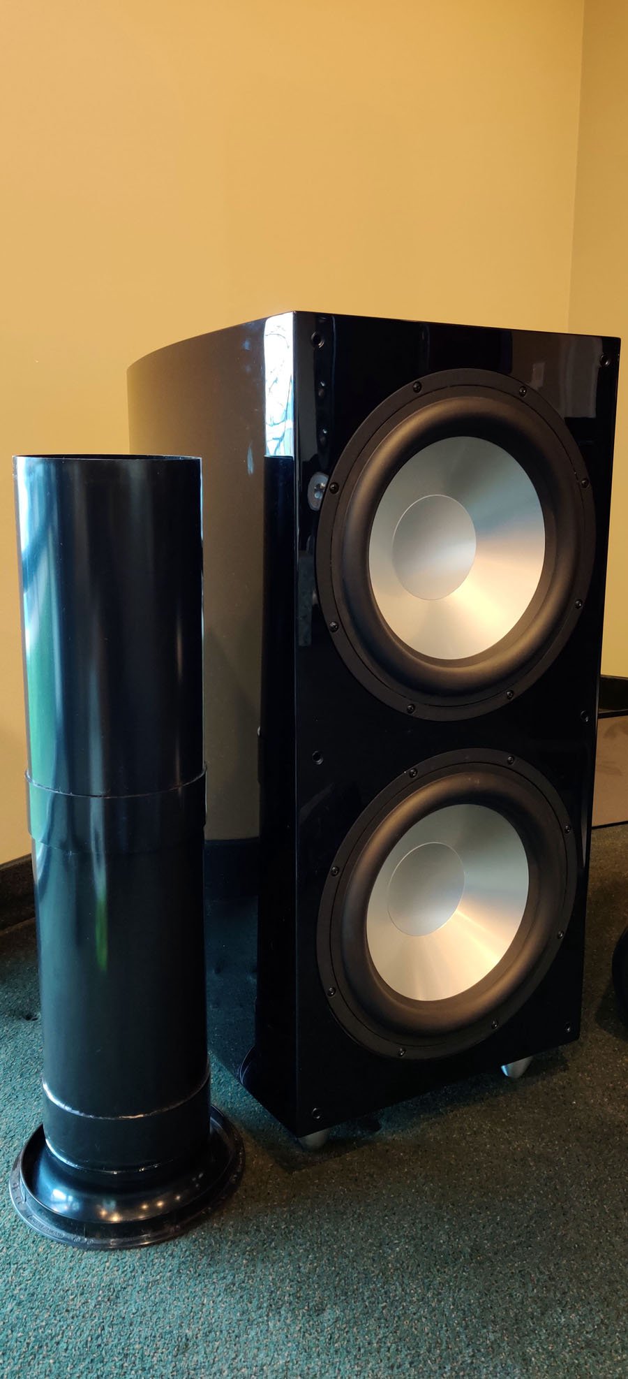

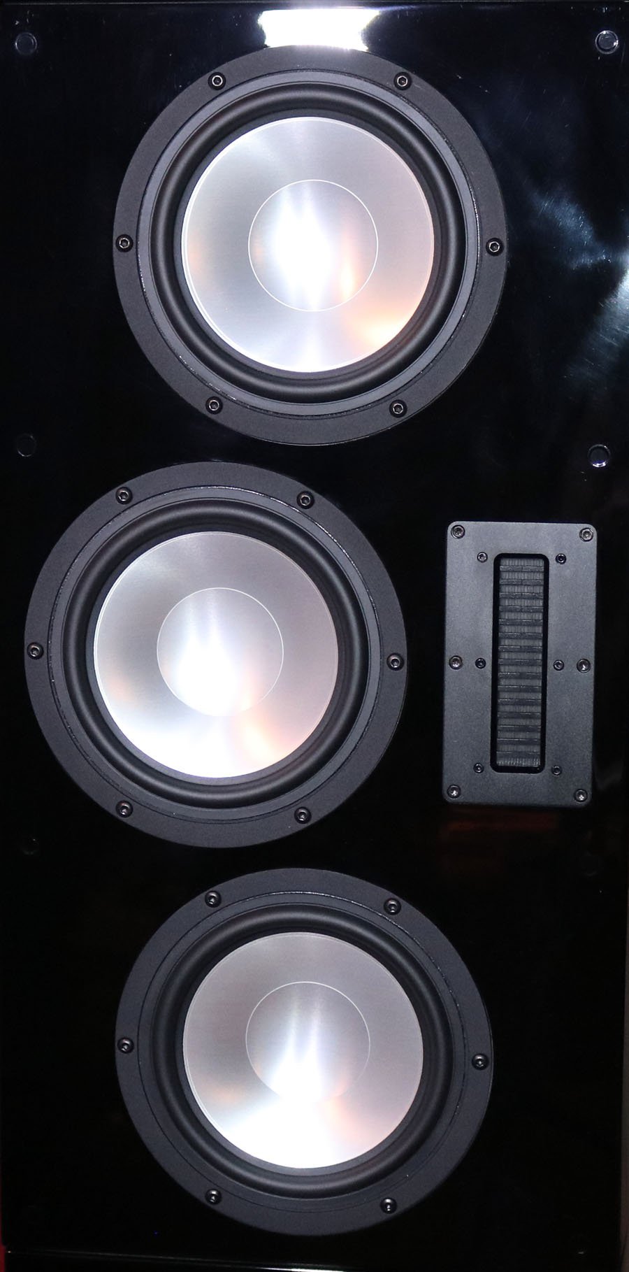

SVTR port  SVTR Mid/Tweet
RBH Sound SV-1212 sub + port (left pic) ; SV-831 Mid/Tweet Module (right pic)
The SVTRS system boasts three 8" mid-bass drivers. That's almost as much surface area as a single 15" driver! They are arranged in a modified MTM vertical arrangement, which RBH Sound calls a dispersion averaging array that keeps each mid-bass driver at a similar distance from the tweeter in order to reduce lobing effects in the vertical plane. This arrangement limits horizontal dispersion by focusing the energy more toward the listener. As a result, RBH Sound claims less side wall absorption is required than would ordinarily be used with conventional driver alignments.
The tweeter separates the men from the boys by employing a large 4.7”x1” Aurum Cantus AMT, which has a dynamic range equivalent to some of the best horns but with the smoothness known and revered by lovers of AMT / ribbon designs.

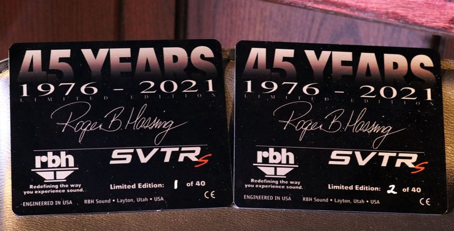

RBH Plaque
RBH Sound 45th Anniversary Plaque with Insignia

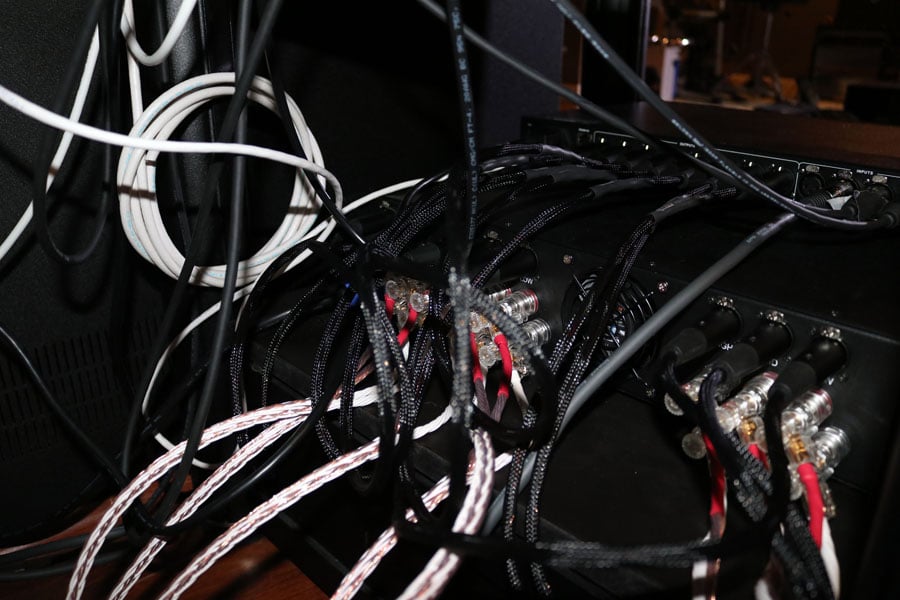

RBH Connections
RBH Sound UNRIVALED UA-8 Amplifier & Marani DSP wired in Kimber Kables
I used Kimber 8TC speaker cables and Hero XLR to wire the system up. The Marani DSP takes two channel XLR inputs from your preamp/processor and breaks out the signal for tri-amplification into the RBH Sound UNRIVALED UA-8 amplifier. After you connect the three XLR cables for each channel between the Marani and the UNRIVALED UA-8 amplifier, you're ready to do the speaker cable connections. You start with an 8-ft long jumper cable that connects the top and bottom bass modules together followed by three additional speaker cables that connect the bass section to the 1500-watt amp, the mid section to the 500-watt amp and the tweeter section to the 250-watt amp.

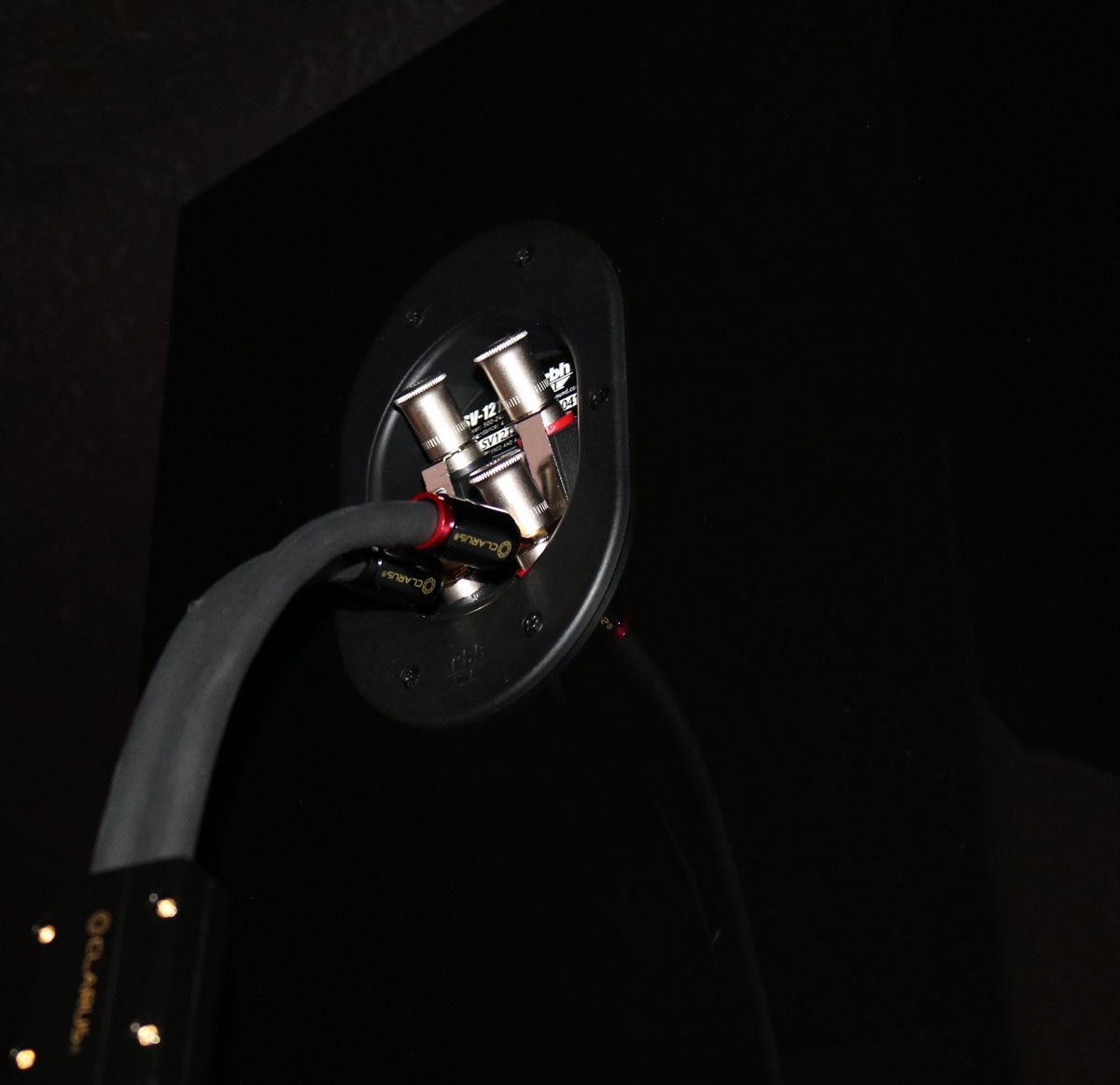

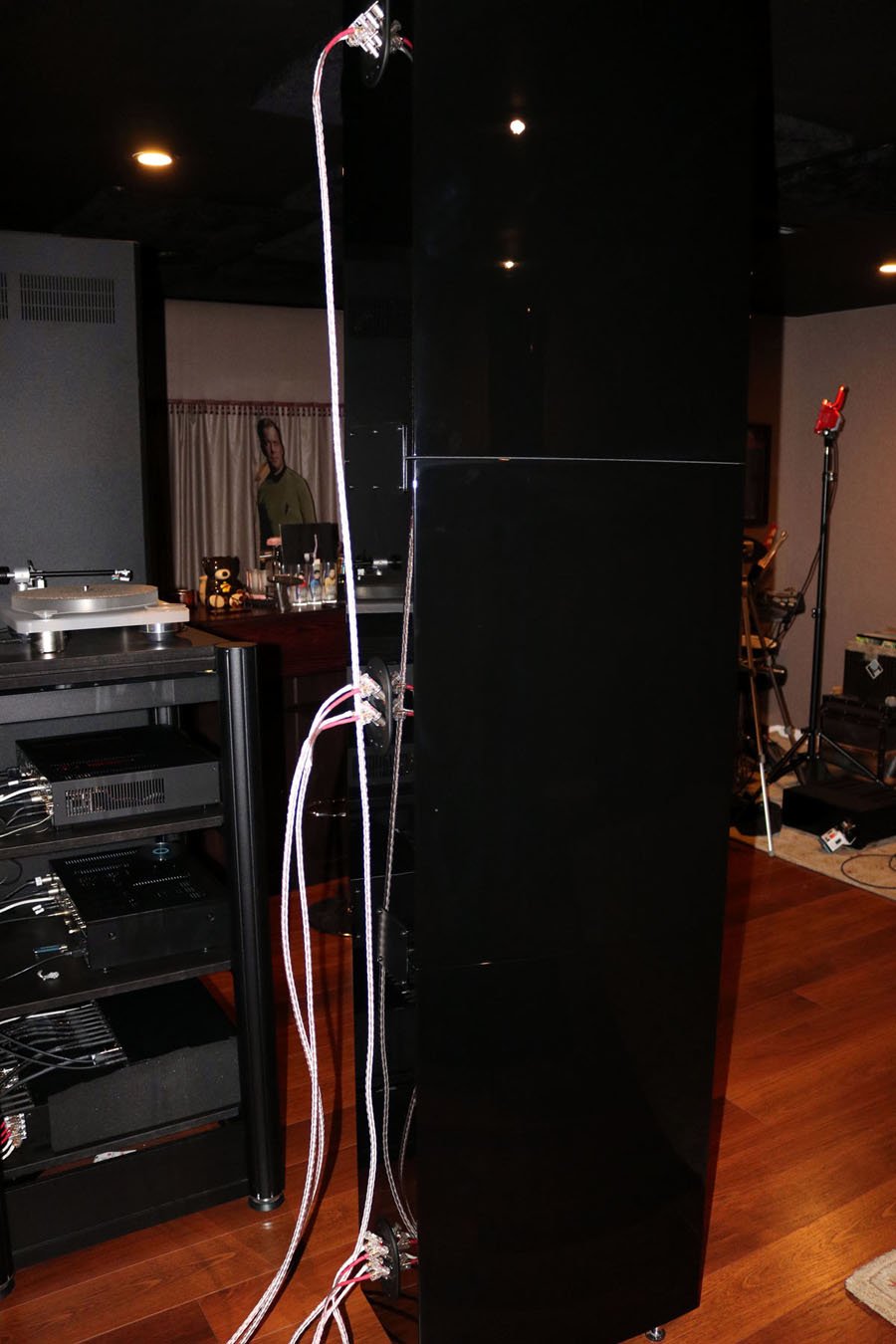

RBH Connections  RBH Binding
RBH Sound SVTRS Backview & Speaker Connectors
Wiring up the RBH Sound SVTRS system is quite a chore. You need a total of four speaker cables per speaker or eight for the pair. An 8-ft jumper cable is required to connect the top bass and bottom bass modules putting them in parallel connection to the 1500-watt amplifier channel. The two other sets of cables connect to the center module to wire the midrange array to the 500-watt amplifier channel and the tweeter to the 250-watt amplifier channel. The nickel plated speaker connectors are very high quality 5-way binding posts and add a nice touch of class to the product.

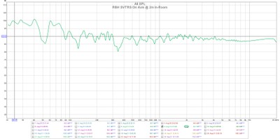

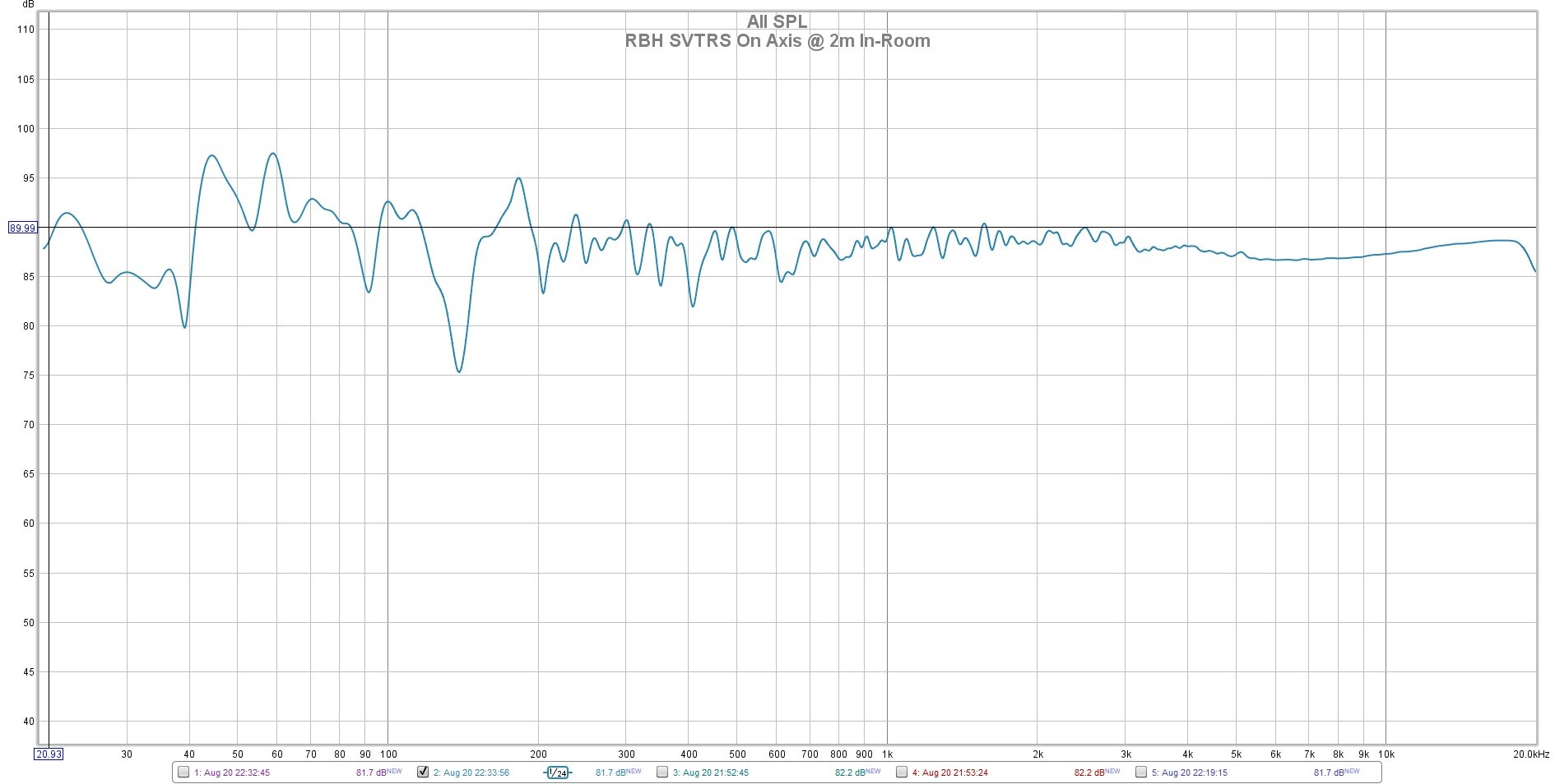

Once you have the system all connected, the magic happens. Shane Rich, Technical Director of RBH Sound, programs the basic filter crossover targets and begins taking nearfield measurements of the speaker response. We spent hours dialing in the system response and achieved the best results by calibrating everything above 200Hz nearfield and everything below at the listening position.

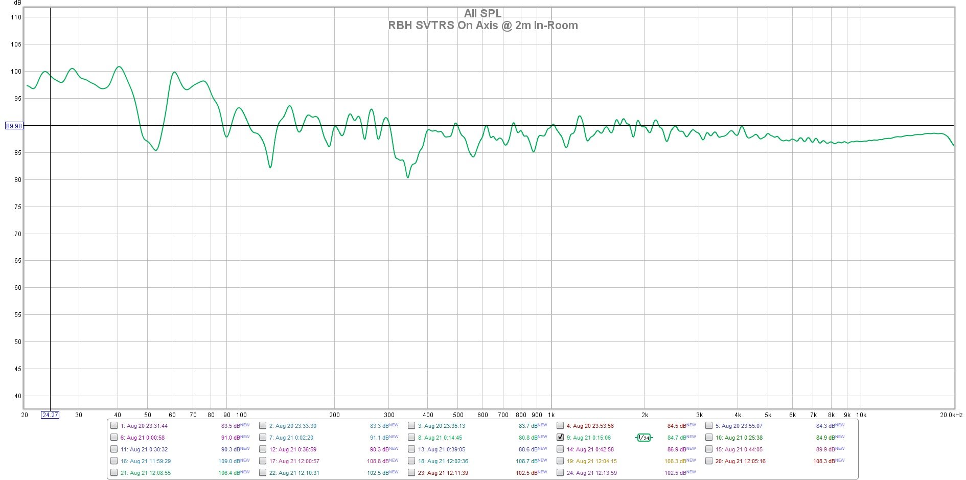

   RBH on-axis left  RBH on-axis right
RBH Sound SVTRS Frequency Response - 2 meter (1/12th Octave, in-room)
(left pic - left speaker; right pic - right speaker)

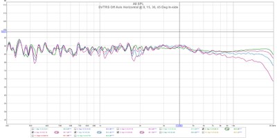

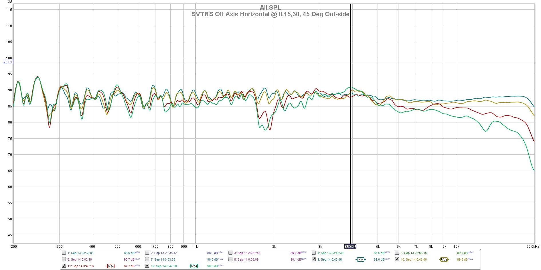

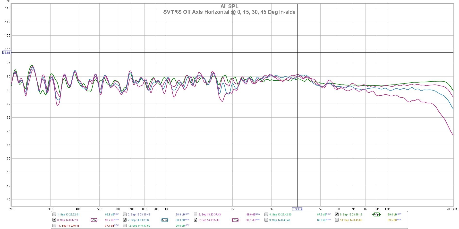

RBH inside curves  RBH outside curves
RBH Sound SVTRS Frequency Response - 2 meters (1/12th Octave, in-room)
(left pic - inside tweeter axis; right pic - outside tweeter axis)
The horizontal frequency response from 0 to 45 degrees from the inside of the speaker with respect to the tweeter is flat and very uniform. I was expecting higher high-frequency rolloff of the tweeter when measuring horizontal dispersion outside the tweeter but was pleasantly surprised how similar the response was. This is a fairly wide dispersion speaker and you won't hear much tonal shift moving your head side to side between the speakers. The vertical dispersion was more tapered off when > 30 degrees off-axis but this isn't an issue from the seated ear level position and the narrow vertical dispersion is an intended design trait by the manufacturer. This should make treating ceiling reflections less critical then more conventional 3-way speaker designs. The physical tweeter height was a bit higher than seated ear level position of my theater seats. I felt it shifted the image a bit higher as a result. Simply adjusting the feet to make the speaker have a slightly downward tilt fixed this issue in my room.

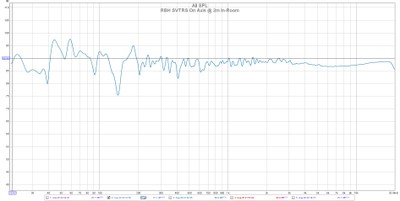

After admiring the incredibly linear summed response of the system, it was time to do final tweaks to flatten out the bass response. This system has so much cone area that it needed very little boost to easily hit the target room curve.

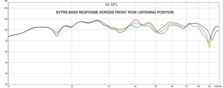

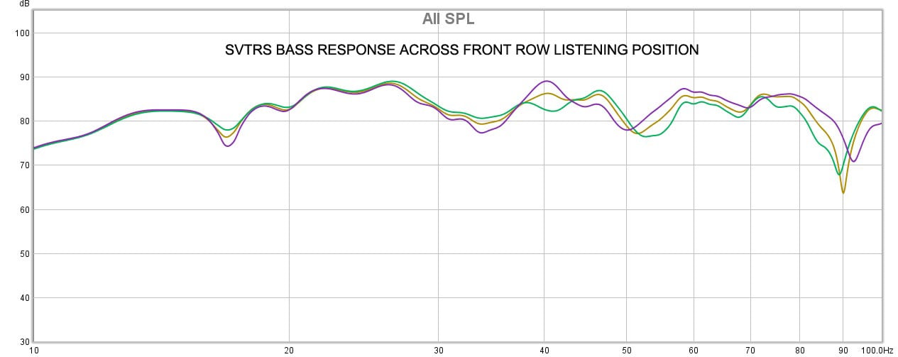

 RBH bass
RBH Sound SVTRS Bass Response @ Listening Position (no smoothing)
It is quite incredible to see single digit bass extension with meaningful output. Running some very low tones, we could feel the rafters in the floor shaking. It's quite a visceral experience that very few subwoofers, let alone full-range speaker systems, can deliver.

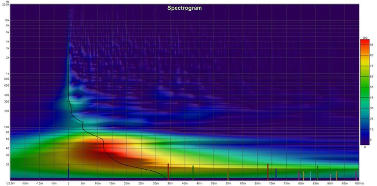

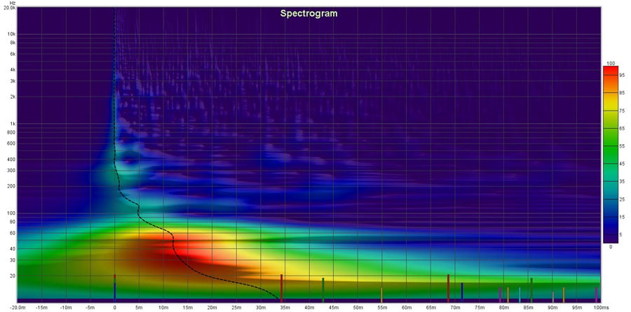

RBH Wavelett
RBH Sound SVTRS Spectrogram Wavelet Response
Because of the active FIR correction and lack of analog crossover components in this RBH Sound speaker system, I've been able to achieve a perfect impulse response yielding incredible phase linearity and time coherence you just can't get from a passive speaker system. As you can see in the Wavelet graph above, with both speakers playing and measured at the MLP, the response is perfectly linear (black vertical dotted line) from 20kHz all the way down to 150Hz where the delay slightly rises as low bass frequencies. Even at 20Hz, we only see 20ms of delay which is inaudible at these frequencies. The end result is coherent full range response that sounds superbly integrated and fluidic.

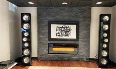

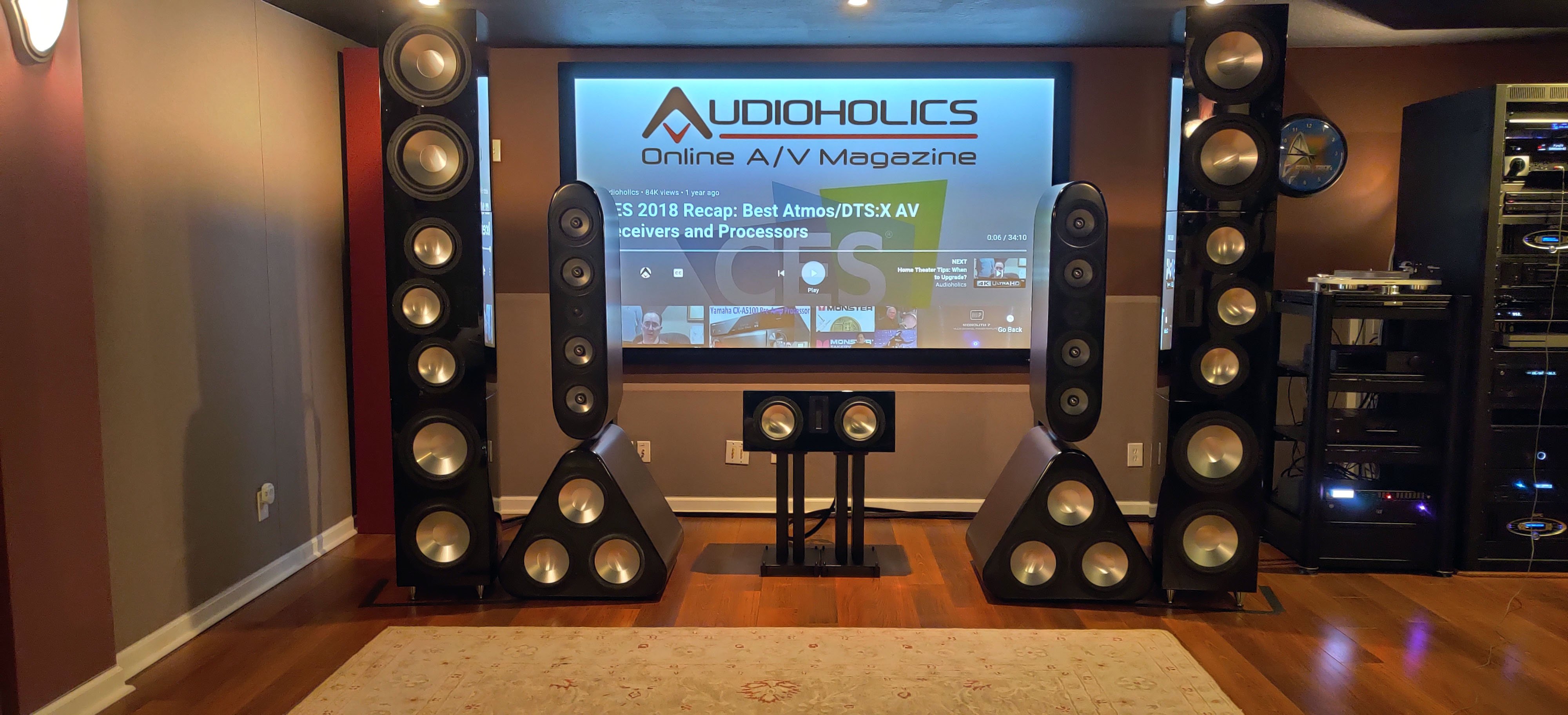

SVTRS Setup

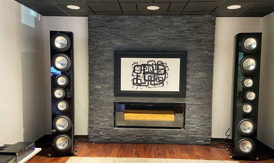

RBH Sound SVTRS Speaker System installed in the Old Audioholics Showcase Theater Room

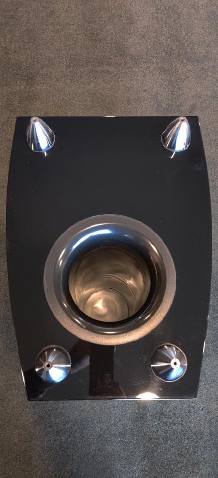

RBH portWith all of this incredible performance, there are some considerations. For one, the RBH Sound SVTRS is a very large and heavy speaker system. I barely fit them in my prior theater room with 8ft ceilings. If you want BIG sound like this and have it be effortless at and beyond reference levels, there simply is no replacement for displacement. This is NOT a speaker system you're going to want to put in a family room. Instead, it's meant for a dedicated theater or music room. The black gloss finish is very reflective which can be distracting when watching a movie. It's a shame RBH Sound doesn't offer non-glossy finish options. However, RBH Sound informed me they are transitioning on making Signature series cabinets locally which will allow for non-glossy finish options on future units. With its endless configuration options, this is NOT an easy system to set up so it's a good thing RBH Sound sends their designer to install and calibrate this system for you. I don't know of any other manufacturer with this much dedication to their product and customer satisfaction.

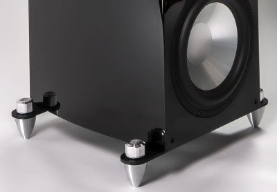

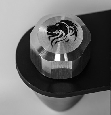

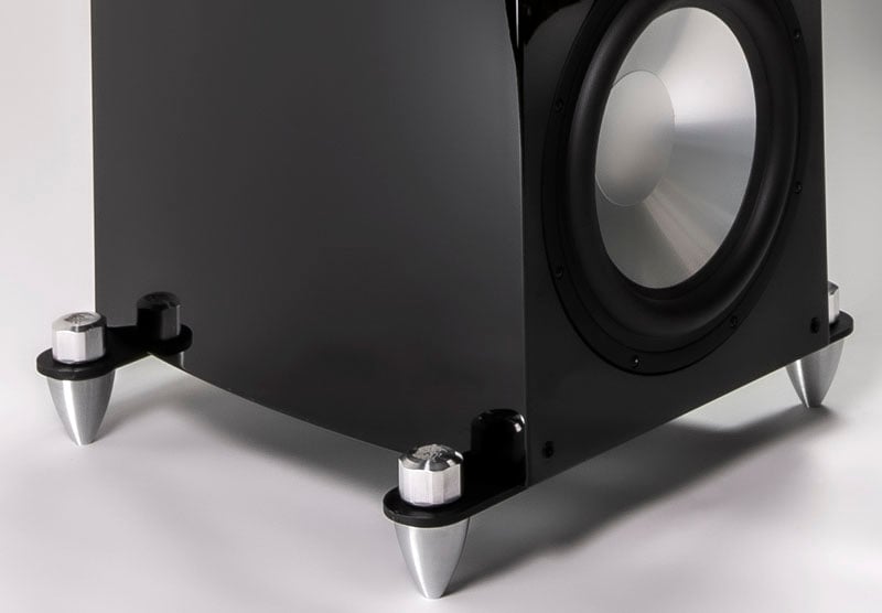

Outrigger  UNRIVALED Knob
RBH Sound employed large metal cones for the feet on my review system that look cool but don't provide the best stability for such a large speaker system susceptible to being tipped over. I was not thrilled with this and suggested that they add an outrigger system and they obliged my request. In addition, RBH Sound informed me that they recently partnered with IsoAcoustics. I recently installed the SVTRS system with the outriggers in my new theater room of the AH Smarthome. Not only do they make the speakers look more impressive, but they provide the necessary lateral stability I was looking for. Their new UNRIVALED brushed aluminum knobs that secure the outrigger system give an extra touch of class and elegance. UNRIVALED indeed.

Integrating a speaker system as massive and complex as the RBH Sound SVTRS will take a commitment for an audiophile to have the proper room (minimum 3,000 ft^3) to make them shine. A dedicated listening room is a must and preferably one that has some sound isolation from the rest of the house. This speaker has ungodly low frequency output that will be felt and heard NOT just in the room they are located but in the rest of your home and nearby neighbors. If you want to throw a party(or piss off your neighbors), this is the speaker that can do it. Patience is required to getting this system dialed in and it will require at least two people so it's handy that RBH Sound sends their designer Shane Rich to help you set them up. Just make sure you feed him dark chocolate and have Coke Zero on hand since it will keep him productively working all night tuning your system while you can comfortably go to sleep knowing tomorrow will bring you audio bliss.

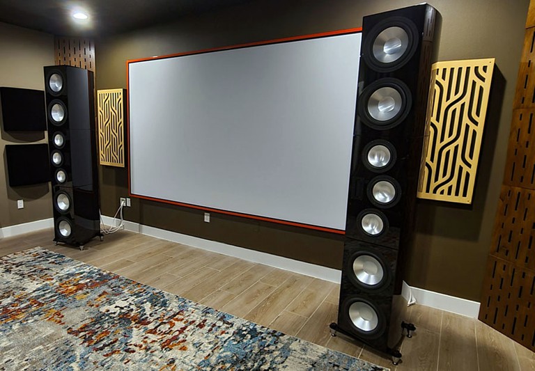

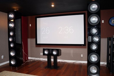

SVTRS AH Theater
RBH Sound SVTRS System Installed in new AH Smart Home Theater Room
In the high-end, $50k/pair is a steal for a loudspeaker system of this caliber. Considering that this speaker system comes with ALL amplification and DSP, and the Master Speaker Designer himself to tune it to your room, this is quite a bargain with respect to the cost-no-object audiophile market. More budget minded audiophiles should strongly consider a pair of the RBH Sound SVTRs which will soon be available in an active version. More space minded audiophiles should look into a pair of PM-8s, which incorporate the same driver and DSP technologies in a much smaller and more affordable footprint pre-tuned for easy setup. You will be surprised just how much sound that system can produce for its size. In addition, RBH Sound told me they will soon be offering the an active version of the regular SVTR speaker system too.
Spending the last year with the SVTRS active speaker system has been an eye opening experience for me on the reality that properly done active speakers are not only the future, but they offer superior performance today. I found it interesting how this speaker has once again transformed the way I listen to music just like the Status 8T system did prior. I often find myself seeking out high energy, bass intense music just to see and feel how it will sound. I am always in amazement how little travel those 12" subwoofer drivers have to move to get my room shaking with deep, tight, clean bass. In the same breath, it sometimes freaks me out how anchored the phantom center image projects on vocal music as if I have the center channel engaged. Flip on the Dolby Upmixer or play a discrete Atmos source material, the SVTRS system integrates superbly for multi-channel applications. I like the exclusivity this speaker offers as well. With only 20 pairs being made, and mine being pair one, to own this configuration makes us sort of an secret society of Audioholics. Now all we need is a symbol or secret handshake.

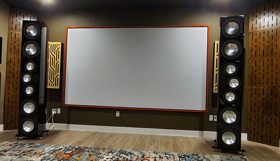

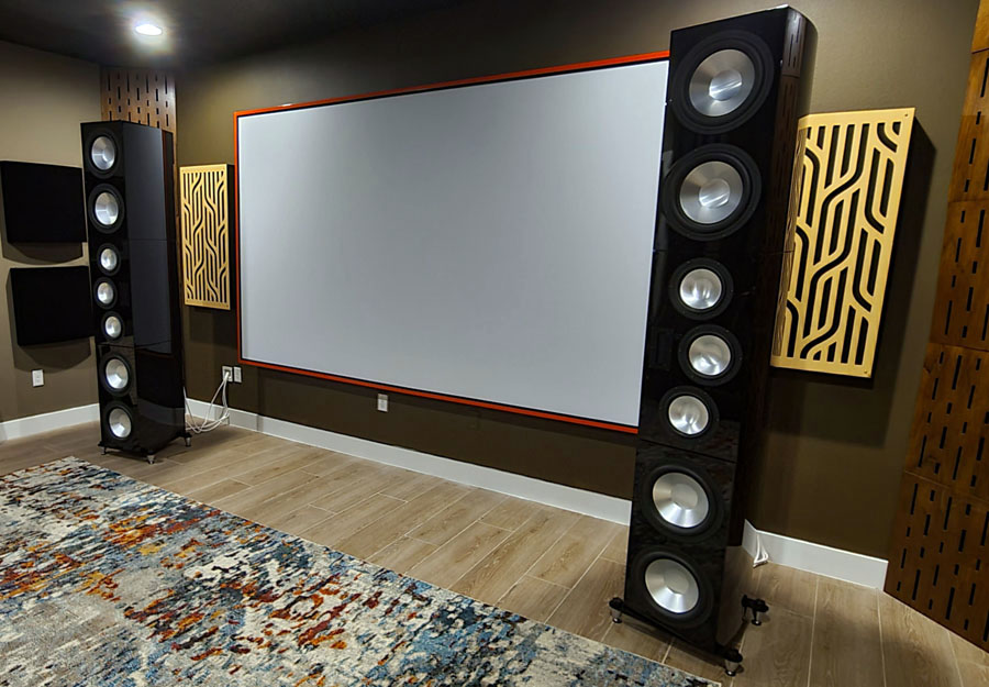

 AH fronts
RBH Sound SVTRS System with Sonitus & Gik Acoustic Treatments
The RBH SI-831R matching center channel is behind the Screen Innovation Acoustically Transparent Screen
