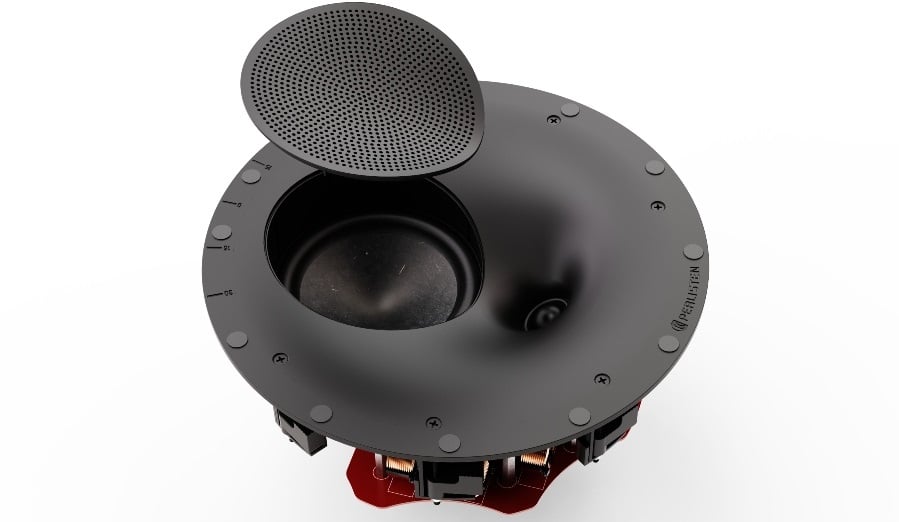

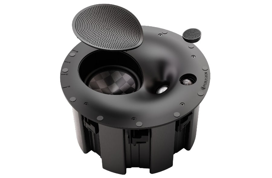

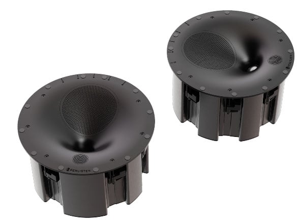

Perlisten S3ic ($3,495 each)
The flagship S3ic is a three-way acoustic suspension design. The new DPC array designed for this speaker includes a 1.1-inch Beryllium dome tweeter and a 1.1-inch Textreme TPCD (thin-ply carbon diaphragm) ultra-lightweight dome midrange driver, helping it to match the timbre of other S-Series speakers. The woofer is a 6.5-inch Textreme TPCD cone with an aluminum frame. (If you need a refresher on TPCD, it’s a broad weave of carbon fibers that has the strength of metal diaphragms but without the total material uniformity at every point in the construction. This is an advantage in that it doesn’t bend as sharply at higher frequencies.) Below are some key specs for the S3ic.
- Frequency Response: 57 - 30kHz (-6dB)
- Typical In-Room Bass Extension: 48Hz (-6dB)
- Response Linearity: 100 Hz - 20 kHz (± 1.5 dB)
- Sensitivity: 89.7dB / 2.83v / 1.0m
- Impedance: 4 Ω nominal / 3.2 Ω min

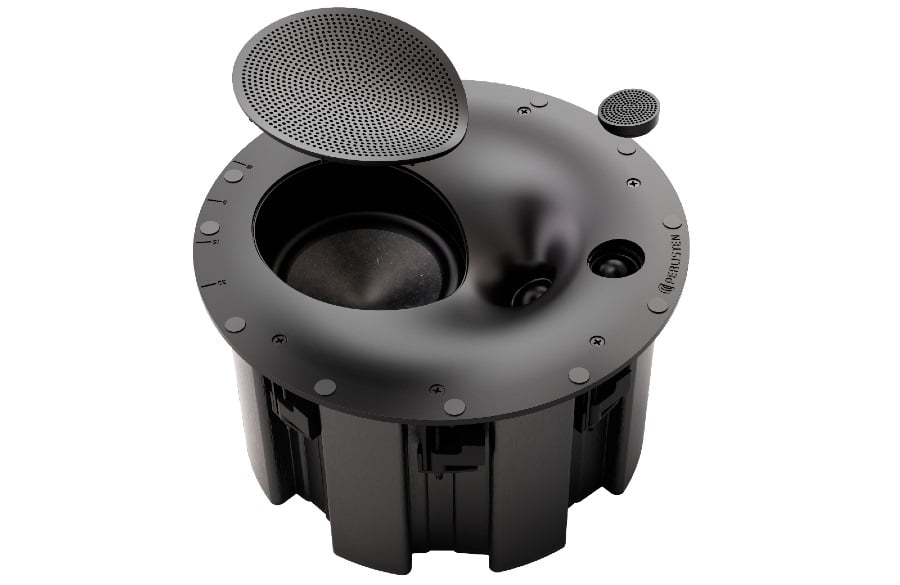

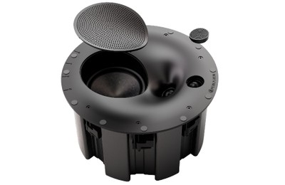

Perlisten R3ic ($2,195 each)
The R3ic a 3-way acoustic suspension design similar to the S3ic, but using R-Series driver materials, which sound slightly different and are somewhat less expensive. The new DPC array in the R3ic includes a 1.1-inch silk dome tweeter and a 1.1-inch silk dome midrange driver. The 6.5-inch woofer has an aluminum frame and a cone made of HPF pulp. (HPF stands for Hybrid Pulp Formulation. This is a mixture of long and short fibers as well as bamboo, for a stiffener, and wool, for damping. HPF is a light and stiff cone composition that can hold a response out to a very high frequency.) The specs for the R3ic are as follows:
- Frequency Response 59 - 30kHz (-6dB)
- Typical In-Room Bass Extension 51 Hz (-6dB)
- Response Linearity 100 Hz - 20 kHz (± 1.5 dB)
- Sensitivity 88.8dB / 2.83v / 1.0m
- Impedance 4Ω nominal / 3.0Ω min

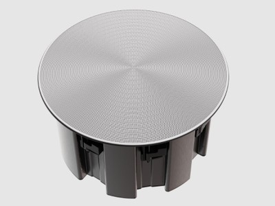

Perlisten R2ic ($1,295 each)
Finally, the R2ic is a simplified, two-way infinite baffle version of the R3ic. An optional rear enclosure is available. The DPC Array is centered by Perlisten’s 1.1-inch silk dome tweeter. Here again, the woofer is a 6.5-inch HPF pulp cone with an aluminum frame.
- Frequency Response 44 - 27kHz (-6dB)
- Typical In-Room Bass Extension 32 Hz (-6dB)
- Response Linearity 100 Hz - 10 kHz (± 1.5 dB)
- Sensitivity 86.0dB / 2.83v/1.0m
- Impedance 6Ω nominal / 3.6Ω min

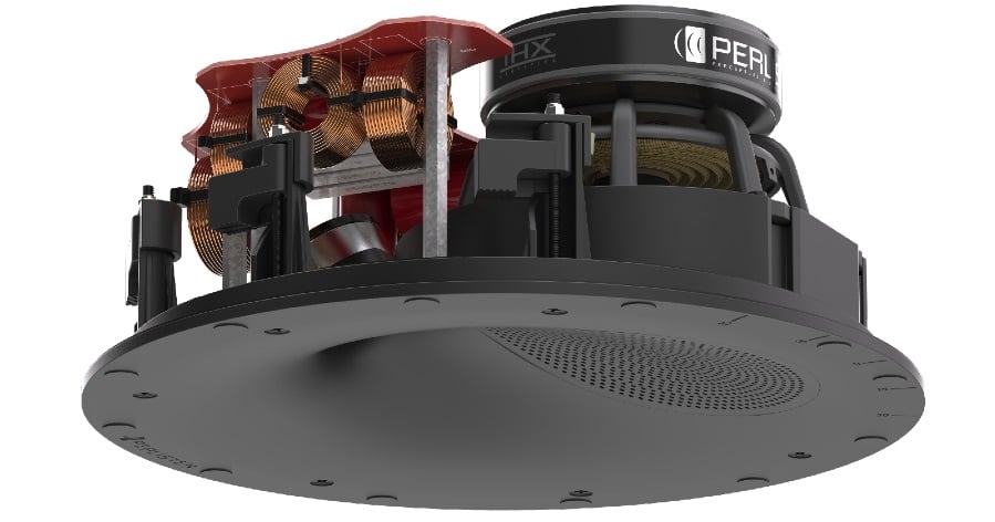

The S3ic and R3ic have a back box — it's four millimeters thick. And it’s bituminously damped. It’s got damping so it doesn't vibrate. The shape is uniquely strong because it is round, and an extruded aluminum piece. There's a lot of advantages of not sending sound into other environments. Upstairs could be a bedroom, a living room, a neighbor's apartment. It could be whatever.
--Erik Wiederholtz, Chief Technical Officer, Perlisten Audio
The
back enclosure not only helps reduce sound leakage into neighboring
environments, it also helps ensure predictable frequency response regardless of
the (often varying) space and materials located behind the speakers inside the
ceiling. And of course, it also makes the whole structure of the loudspeaker
itself more stable. The R2ic
doesn’t have a back box as standard, and that allows it to be installed in
ceilings with shallower depths, and/or in situations where sound isolation
isn’t as important as total cost.

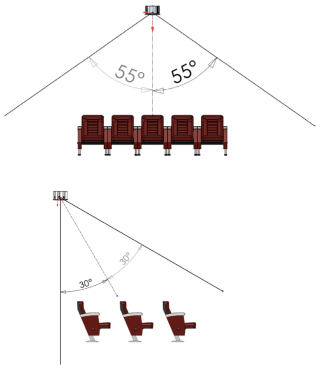

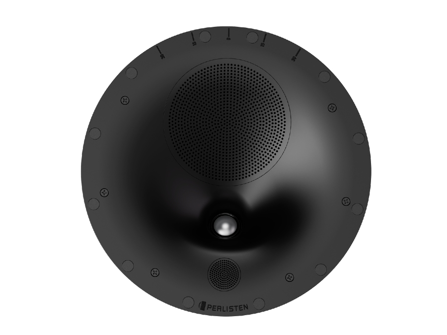

By far the coolest thing about Perlisten’s in-ceiling speakers is the next-generation Directivity Pattern Control (DPC) waveguide, which is what enables these speakers to achieve such extraordinary performance both in terms of frequency response, and in terms of providing a broader listening area.
We designed the whole front baffle as a waveguide, so it's truly integrated. A lot of the stuff I learned when I was designing hearing aids about acoustic impedance (came into play). And a lot of characteristics about having the woofer… hidden behind a grille. Actually, the midrange driver is also hidden behind a grille. And those grille designs are all acoustically impedance-matched. So the tweeter doesn't ‘see’ the environment that it’s in. Normally, let’s say you took the grille off the woofer. There’s a giant chamber behind there, and if we took that grille off, the tweeter would ‘see’ it, and it would cause diffraction, and it would make the frequency response more jagged because we’d have cancellation and summation at certain frequencies. (We designed) the grille on there with an acoustic impedance — because it's got thickness and depth. The woofer actually sees it as low impedance, so it has perfect transmission out of that cavity. And the tweeter, from the other direction, sees it as a high impedance, and it just looks like a smooth waveguide surface to the tweeter. And it’s the same with the grille on the 28mm midrange driver as well. That grille is specifically designed for its high impedance for the main tweeter. It looks like a perfectly smooth waveguide to the tweeter. But the midrange driver sees it as a very low impedance, and it’s got perfect acoustic transmission in the band that we need. So those are some really intelligent things that we put in to help the tweeter benefit as much as possible, to make sure it has a smooth response. Like I said, in-ceilings are a difficult situation and so it took a lot of development and time to make sure we got the best response we could.
— Erik Wiederholtz -Chief Technical Officer, Perlisten Audio
Jacob Green (Audioholics): What is the importance of THX Dominus certification for an in-ceiling speaker?
The SPL output capabilities aren’t always needed, but again it’s really about overhead. It’s the ability to maybe be used in larger systems in larger rooms as well, but it’s also about having that clean, clear dynamic range. When you reach a peak and it’s low distortion, there’s something more that’s really added to the system, and that’s really critical. Many listeners have never heard a complete system with such low distortion, and when you do for the first time, it really transforms your experience.
