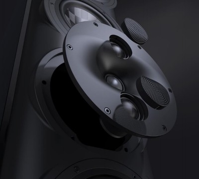

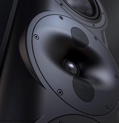

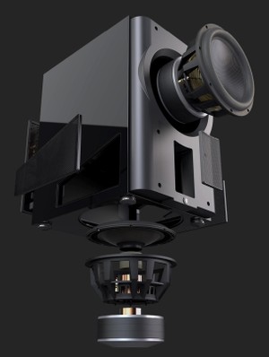

It takes some serious speakers to break the THX Certified Dominus barrier, so how did Perlisten accomplish this feat? The answer is cutting-edge loudspeaker design combined with brute force air displacement. An example of the leading edge technology employed by Perlisten is their ‘DPC’ array that uses three 1.1” drivers across a waveguide that is used on all of Perlisten’s speakers. The ‘tweeter’ is the dome mounted in the middle of the waveguide while two upper midrange drivers are mounted above and below the mouth of the waveguide. These upper midrange drivers are not tasked with playing lower midrange which greatly alleviates their displacement requirements nor are they tasked with playing treble which greatly alleviates their requirements for low mass. Giving the drivers a more focused frequency band enables the engineers to optimize them much more than wide-band drivers. It also allows the engineers to optimize the tweeter for a higher treble range which enables it to perform that much better within its allocated range.
The
waveguide also has a major role to play here, as optimal waveguide geometries
are not easy to conjure. Perlisten’s waveguide keeps the tweeter’s horizontal
dispersion wide and the vertical dispersion narrow at a consistent directivity
up to the high-frequency limits of human hearing. It’s the perfect shape for a
directivity match with the midrange drivers. The really cool thing about the
DPC array is that the three drivers are used to reduce each other’s vertical
dispersion and also strengthen the axial response by means of phase summation
and cancellation. Separate drivers that play the same frequency will inevitably
start interfering with each other at high enough frequencies, and often times
this can be a problem, but for Perlisten, it’s a solution to reduce acoustic
reflections off of the floor and ceiling. This is a part of what is called
beamforming, and it is a similar technique to how 5G transmitters precisely
deliver a strong signal to a receiver in a specific direction instead of
spraying it inefficiently over a broad angle. Likewise, the woofers flanking
the DPC array do the same thing at lower frequencies, so vertical dispersion is
restricted by design for all the deepest bass frequencies. While a restricted
vertical dispersion can be a desirable feature, a wide horizontal dispersion
can also be desirable, and Perlisten’s design looks to encourage a wide
dispersion while discouraging vertical dispersion in a very clever approach to
directivity control.

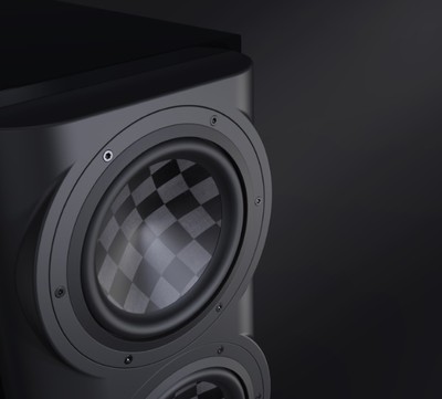

Along with clever approaches in directivity control, Perlisten also tackles THX Certified Dominus in allocating raw displacement only where it is needed instead of having it in frequency ranges where it isn’t necessary. The reason is that the quantity of air that needs to be moved to maintain the same SPL rises exponentially as frequencies fall. For example, Perlisten’s S7 series uses four 7” bass drivers to move air below 1kHz where things get tougher, especially below 100Hz. 1kHz, on the other hand, would be tough for a dome tweeter but is not much of a challenge for a couple of midrange domes in addition to the tweeter. The midrange drivers get filtered out at 4.4kHz leaving the tweeter alone to reproduce that range for which it is far more suited. Perlisten’s driver layout ensures that the speakers will be able to play at high levels with very low distortion which is, of course, mandated by THX to achieve a Dominus rating. It’s worth pointing out that Perlisten’s R5t floor-standing speaker, a very substantial three-way tower, is only Dominus certified for a surround role. Only Perlisten’s S series is THX Certified Dominus for front LCR roles and are presently the only speakers in the world officially certified for that function. As was said before, it is asking a lot to achieve THX Reference levels at a 20-foot viewing distance. Indeed, it requires the S series to have a relatively high 92dB sensitivity, and that is extremely high for a speaker with a -10dB frequency of 22Hz. This is a speaker that has high sensitivity as well as deep bass extension, all while maintaining a reasonable size; so much for Hoffman’s iron law!

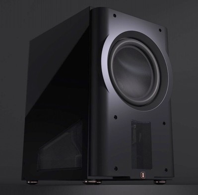

The THX Certified Dominus also extends to Perlisten’s subwoofers. Needless to say, it takes one heck of a sub to hit Certified Dominus since subs have an additional 10dB level of output needed beyond the main loudspeakers, but Perlisten’s subs look like they have the chops to do it. First of all, the drivers boast 30mm of one-way linear excursion which signifies a tremendous level of controlled displacement. We should emphasize the word ‘control’ here since there are subwoofer drivers that can move further than that, however, they don’t do so in a controlled manner, whereas the Perlisten subwoofer driver cones can move over two inches both ways with near-absolute control over the cone position. Linear excursion means the cone tracks the signal accurately, so the driver can move that distance only while only producing the sounds that it is supposed to without adding distortion products. Perlisten is able to achieve this level of linear excursion by employing all of the tricks of modern driver engineering including using a carbon-fiber composite cone, multiple shorting rings, massive magnet motors, and multi-layered spiders for suspension that doesn’t inhibit the driver’s travel until absolutely necessary. For an even greater degree of control, Perlisten’s flagship subwoofers, the D215s and D212s, uses a push-pull driver arrangement where another driver is added to counteract asymmetric distortion that results in far lower even-order harmonic distortion products. I would say that is overkill to achieve low distortion, but these are the lengths you can go to for no-holds-barred, state-of-the-art performance, especially if you don’t want the subwoofer to be the size of a refrigerator.
Of course, all of that linear excursion isn’t useful without adequate power to take advantage of it, but the Perlisten subwoofers have a very serious power plant in a 3kW short-term RMS class-D amplifier. What is more, that amplification is very tightly controlled by a lightning-fast 32-bit ARM processor that monitors temperature, current, voltage, fault detection, and performance diagnostics in realtime. This is complemented by a powerful DSP that enables users to fine-tune the subwoofers’ behavior to an extraordinary degree using app control supported by iOS and Andriod devices. Users can switch between different inputs (the Perlisten has both balanced and unbalanced inputs) as well as adjust input gain, phase, low-pass filter behavior, different performance modes, and users can even configure a 10-band parametric equalizer. There are three different presets that all of these settings can be saved on. Smartphone apps are nifty, but what if your phone isn’t handy at the moment? Perlisten has a 2.4” LCD touchscreen display mounted at the top front of their subs for easy access to many of these functions.

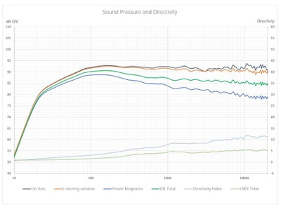

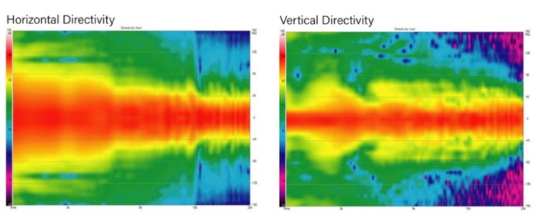

All of Perlisten’s technology sounds cool and all, but a lot of audio companies make hyperbolic marketing claims about the advanced technology in their products, and a lot of times, it turns out not to be the greatest thing since sliced bread. Since Perlisten is a new company, they decided to set themselves apart by offering proof of their technology’s effectiveness which is something many other companies rarely do. Not only do they attain the highest possible THX certification, but they also publish detailed data on the performance of their products. Every single one of their loudspeakers has the associated CTA-2034 graph and polar map of both vertical and horizontal dispersion. This is ideally how every loudspeaker company should function, but very few actually do. Many loudspeaker manufacturers don’t do this because it invites unnecessary scrutiny, but Perlisten is a company with something to prove, and their measurements indicate a loudspeaker with absolutely top-notch performance. In fact, the lengths in which they go to control vertical dispersion yield some of the very best vertical directivity control measurements I have ever seen. The horizontal dispersion pattern is also beautifully uniform. This adds up to excellent directivity indexes which means that these speakers place the sound exactly where the designer intends for it to go and nowhere else, and all of it bearing an accurate response at every angle. These are an acoustician’s dream speaker.
PerListen S7t CTA-2034 Measurements
PerListen Future Tech Speakers Today
