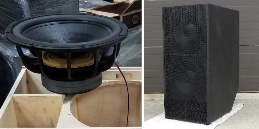

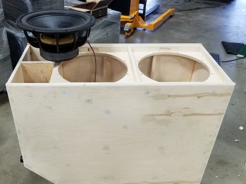

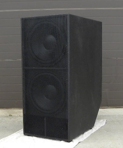

The Captivator 215PRO uses two high-sensitivity 15” drivers that have a one-way linear travel of 19mm which is a pretty substantial amount of throw for a 15” in the pro-audio world. The drivers are mounted in a large, slot-ported cabinet that has built-in handles and a rugged Line-X coating. Casters are built-in at a cabinet angle for easy transportation. The 215PRO can be had in either a passive or active version. The active version comes with a 2,400 watt RMS amp. Obviously these drivers can handle a ton of power.

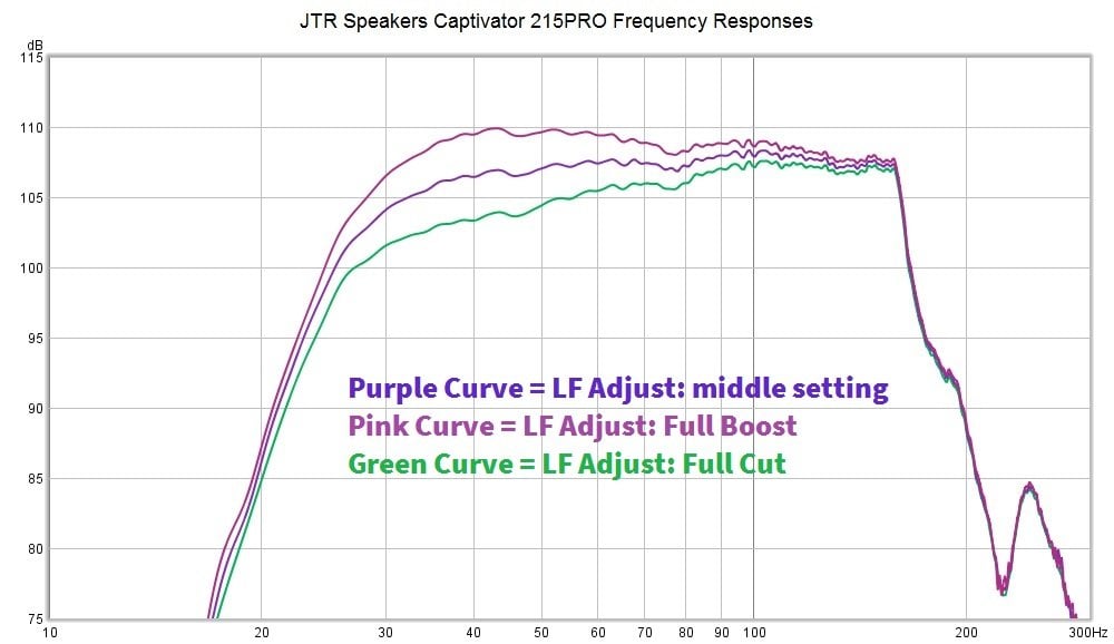

On a crisp May morning (weather recorded at 50 degrees Fahrenheit and 63% Relative Humidity), we set our mic up at a 2-meter distance from the sub and calibrated it with a 20dB attenuator since our regular measurements system didn’t have enough dynamic range to accurately record the full force of the Captivator 215PRO.
The above graph shows the measured frequency responses for the Captivator 215PRO subwoofer with changes to the response that can be made with the LF Adjust knob. We see a nicely flat response that can be made to emphasize or deemphasize deep bass depending on the LF Adjust setting. What is advantageous here is that many pro-audio subs intended for PA-type systems do not normally dig this deep. Many of them rapidly roll-off below 40 Hz whereas the 215PRO has a strong response to below 30 Hz. That makes the 215PRO a good choice for music genres that can have deep bass such as electronic music subgenres like dubstep or drum’n’bass.

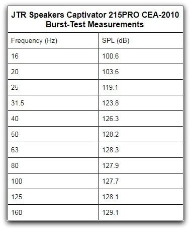

The above CEA-2010 measurements are short-term bursts that show the subwoofer’s clean peak SPL before heavy distortion sets in. Our measurements have been referenced to 2-meter RMS, which is 9 dB down from the standard requirement for the measurements to be shown at 1-meter peak. However most publicly available CEA-2010 measurements are shown at 2-meter RMS, so we followed that convention. From these measurements, we can see massive output from 25 Hz and above, averaging a staggering 127 dB above 40 Hz. That is just huge output, and it was nearly concussive to test since I wasn’t that far from the sub when running these test tones. This is well into the ‘chest-punch’ territory of SPL, and if you are close enough to the sub at those output levels, this is ‘ribcage-bruising’ territory. This easily breaks all records for mid-bass output for any subwoofer tested by Audioholics. If we are to give it a bassaholic room size rating, this easily secures an ‘Extreme’ room rating (meaning the sub is suitable for 5,000 cubic foot rooms); in fact, you could half the headroom of the Captivator 215PRO and it would still easily secure an ‘Extreme’ room rating, but that isn’t surprising since it was designed to pressurize much larger spaces than is found in a home. Brutal!

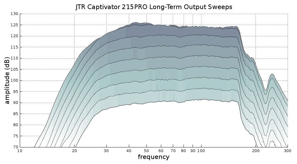

Testing for long-term output compression was done by first conducting a 20-second sweep tone where 50 Hz hit 90 dB with the subwoofer 2 meters from the microphone. We then conduct further 20-second sweeps by raising the gain by 5 dB until no more output could be wrung out of the subwoofer. These tests show us the long-term continuous headroom that the subwoofer is capable of. We can see that the Captivator 215PRO is capable of a continuous 125 dB from 40 Hz to 160 Hz. That is very good for live sound subs with such a deep tuning frequency and absolutely monstrous output relative to the subs that we normally deal with here at Audioholics. If I tried to run any sub at these loudness levels in a residential neighborhood I would earn a noise citation from police within 5 minutes. Compression behavior is quite good with not much of a response shape change from nominal output levels to maximum output levels.

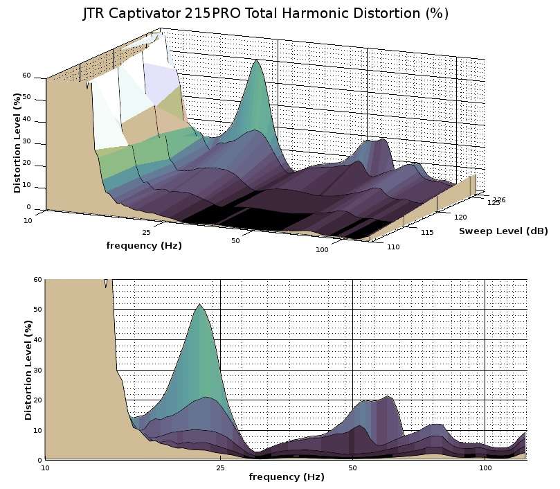

The above graphs show the corresponding total harmonic distortion to the long-term output graphs. Essentially, they depict how linear the subwoofer remains for the corresponding drive level seen in the long-term sweeps. The quantity being measured is how much of the subwoofer’s output is distortion and is shown here as a percentage. Again, a solid showing here and indicative of good engineering. Harmonic distortion pretty much stays below 10 percent within the sub’s intended range above 25 Hz until the last couple dB. Keep in mind that the lowest sweep here is the 110 dB tone. If you try to drive this sub past 125 dB distortion does spike to 20% from 50 Hz to 60 Hz, but that is the very edge of the 215PRO’s performance envelope. The highlight here for pro-audio shoppers is just how clean and unchallenged this sub is from 30 to 40 Hz, where many other common pro-audio subs would coughing up blood if attempts were made to drive them that loudly in such deep frequencies
