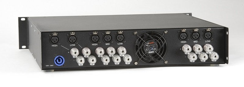

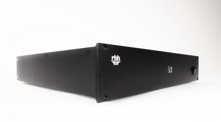

As was mentioned, thRBH_8a_front_left-45.jpge SVTRS set comes with its own amplification, and what an amplifier it has: the 6α from RBH, which is a 6-channel amp that tri-amplifies the SVTRS speakers with 1,500 continuous watts/ch going to the subwoofer section, 500 continuous watts/ch going to the midrange drivers, and 250 continuous watts/ch going to the tweeter. That adds up to 2,250 continuous watts going to each speaker, and what's more, they are being powered by Pascal amp module, which is an extremely low noise, low distortion, and highly efficient class-D amplifier technology that ensures most of the current being pulled from your outlet is being fed to the speaker, rather than lost as electronics heat output. Further increasing efficiency is the use of an active crossover which avoids the losses of a passive crossover so that much more power is converted into sound. The crossover is being handled by Marani’s top-of-the-line LPP-480F processor with an advanced FIR filter system that keeps all drivers in phase at crossover points so there is no phase rotation as is seen in passive crossovers. This allows for time-alignment and crossover slopes between drivers that isn’t possible with passive crossovers.

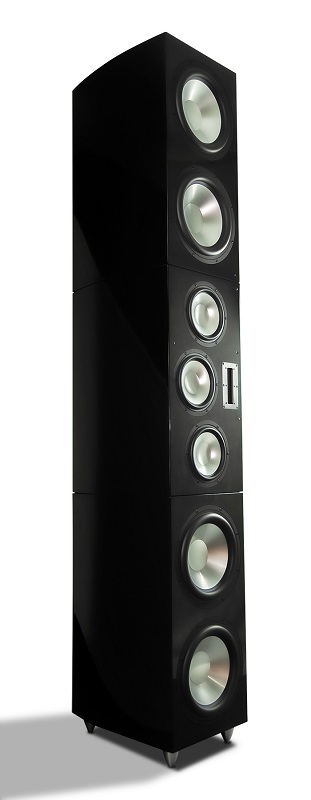

The top-shelf amplification and processing of the SVTRS are matched by the firepower of its driver array. The SVTRS is a modular RBH_SVTRS_ng.jpgspeaker meaning that it has three sections per speaker that are assembled on site. Two sections are for the subwoofers and the other section is for the midrange drivers and tweeter. The midrange/tweeter section is sandwiched between the subwoofer section for a kind of gigantic MTM array. The sub sections are both ported with a giant 6" flared port and have two high-excursion aluminum 12”s; they are essentially a version of the SX-1212P/R subwoofer that we ran a review of some years ago, and that sub managed to achieve our ‘extreme’ bassaholic room rating, meaning that we felt it was able to handle rooms sizes of 5,000 cubic feet or more.  The SVTRS come with four subs that each on their own would garner our highest dynamic range rating. That is an enormous amount of low-frequency potential that digs solidly below 20 Hz. In fact, Gene recently measured an in-room response down to 10Hz (-3dB). These are true full-range speakers, but that is expected at this price point.
The massive dynamic range of the subwoofer sections is matched by the midrange/tweeter section. For the mids, the SVTRS uses three 8” aluminum midrange drivers (nearly combined surface area of a 15" driver) which should supply near-unlimited headroom in this critical frequency band. By comparison, most tower speakers use one or two 5” midrange drivers for this frequency range. We see three of them stacked vertically for reduced off-axis lobing on the vertical plane and a wider vertical listening axis. RBH refers to this driver arrangement as a dispersion averaging array. The tweeter is a large 4.7”x1” Aurum Cantus AMT which should have a major dynamic range advantage itself. As opposed to conventional dome tweeters that oscillate pistonically, AMT tweeters contract and expand the folds of a pleated membrane to produce sound. A major advantage of AMT tweeters is that the folds of the diaphragm are much deeper than they are wide. With this design, the air is ejected out at a much faster speed than the vibration of the diaphragm itself- as much as five times faster. This means that small oscillations in surface area translate in big sound. A 4.7” AMT should be able to stay very clean and distortion-free even at extraordinarily loud levels.

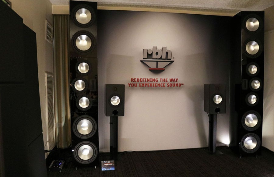

SVTRS-con1c.jpgAudioholic’s owner and senior Florida Audio Expo correspondent Gene DellaSala reports that exhibitors three rooms down were complaining that the bass from the SVTRS speakers was rumbling their rooms so badly they thought it might cause damage. They were quite literally rocking the place. Gene reports that the SVTRS speakers boasted effortless dynamics, clean deep bass down to infrasonic frequencies, and a huge soundstage. Audioholics will be doing a shoot out between the SVTRS speakers and RBH’s previous flagship Status 8T speakers, and RBH Sound is convinced that the new SVTRS speakers will come out on top. Stay tuned to Audioholics to see the results of our super-speaker showdown, as the winner will become our new reference system. The SVTRS active speaker system can be purchased through RBH’s dealer and distributor network and will soon be also available for order from RBH’s website. Do make haste in auditioning a pair of these speakers if you're on the market. RBH Sound will only be producing a 21 pairs to commemorate 45 years of being in the speaker business. Gene having the first set means there are only 20 more select pairs available to the public. If you become a proud owner of the SVTRS system, RBH will fly down to your place to personally tune them to your room at no additional cost.
