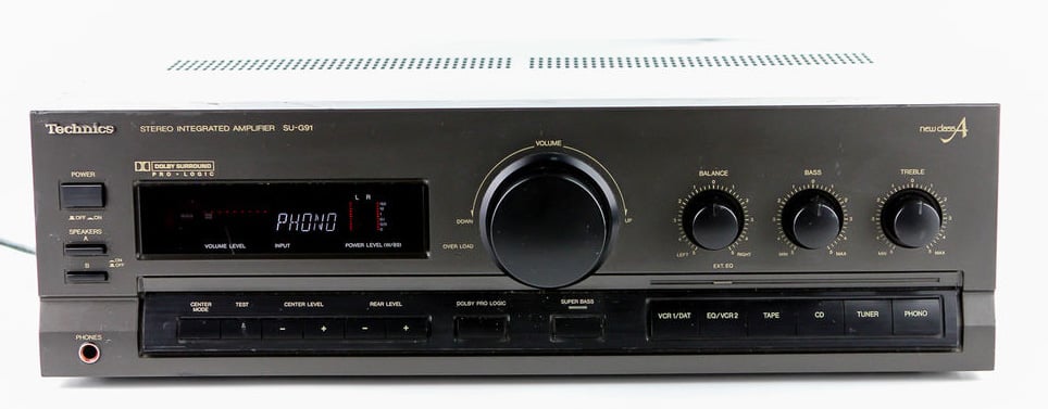

Technics Prologic Receiver
If you're still running a mediocre 80s Prologic AV receiver like this, it's time to upgrade.

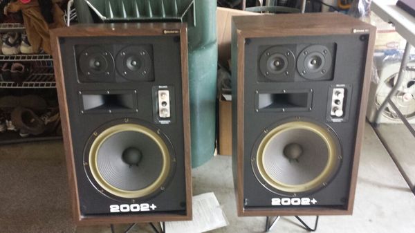

Criterion Speakers
If you're still running "Vintage" 70s speakers that randomly place drivers on the front baffle, it's time for an upgrade.

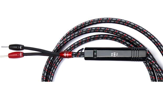

Battery biased cables
Cables requiring a battery bias are a snake oil gimmick.
Unless you just want audio jewelry that doesn't make a lick of provable difference in sound quality, spend your money elsewhere.

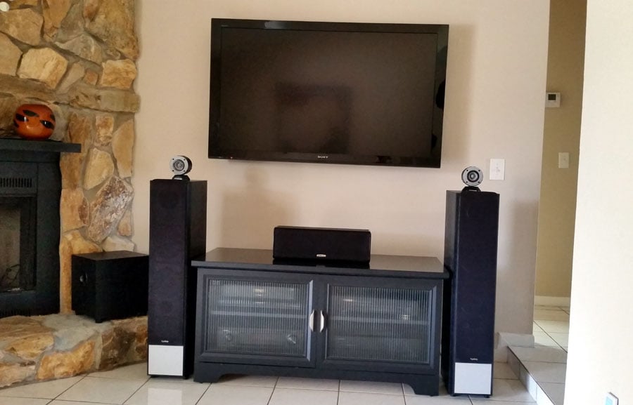

Bad System Placement
Notice the tile floor, hard surfaces, bad speaker placement (and don't get me started on the super tweeters).
The equipment (sans the super tweeters) isn't that bad. But, the room and placement is.
Getting your speaker placement and room acoustics sorted out will usually have a bigger impact on sound quality than changing AV gear, speakers, and especially cables.  If you've already got a good modern 5.1 home theater system that decodes lossless audio, and handles all of your HD audio and video sources, make sure you optimize the setup before changing out components or adding more. If you can't get a basic 5.1 system working optimally, it's just going to get even messier when you try to upgrade to immersive surround sound by adding more speakers in the room.
