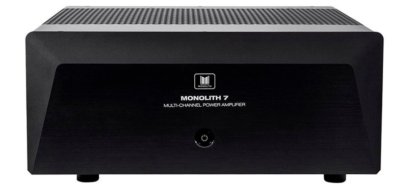

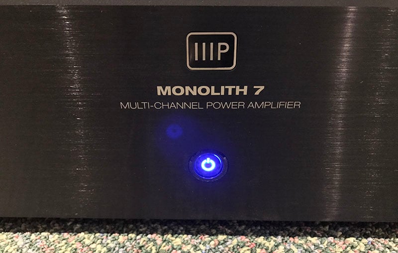

Front view of the Monolith 7. When the Monolith 7 reaches full power, the front power button glows blue.
There is no way to turn off the blue LED while the amp is activated.

The Monolith 7 front power button has a blue LED that illuminates once the amp is fully powered up.
The light does not light up for the first 25 or so seconds while the amp is powering up, which can lead users to conclude incorrectly that the amp has malfunctioned.

If Monoprice can’t make an adjustment to the LED, they would do well to include a tag on the amp or make a note in the user manual that the LED won’t light up until the amp has reached full power. You can, however, play any source during that power up period without issue.
Editorial Note about Power LED
We didn't experience the delay in LED illumination for the Monolith-2 that we bench tested so this issue may only be limited to the 5 and 7 channel versions.

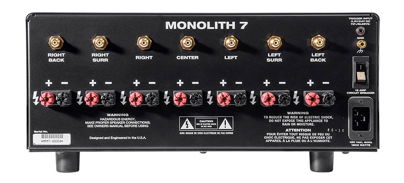

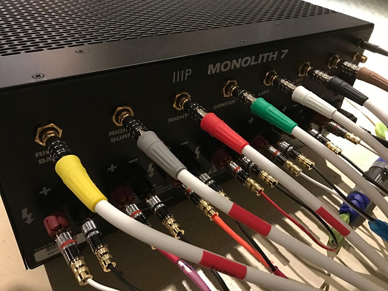

The five-way binding posts and RCA jacks aren’t fancy but they are incredibly rugged. The RCA jacks are mounted directly to the chassis instead of a separate circuit board. You can tell the difference immediately. Plugging an RCA interconnect feels solid and stable. If you have stiff speaker cables, they also won’t start to bend the binding posts.
The Monolith 7 features unbalanced inputs and sturdy, high quality five way binding posts and a ground lug. Channels are not bridgeable.
The only thing missing from this amp are unbalanced connections.

Rear view of the Monoprice Monolith 7.
I used all unbalanced connections with BlueJeans unbalanced cables to connect the Monolith 7 to my Denon X7200WA receiver.

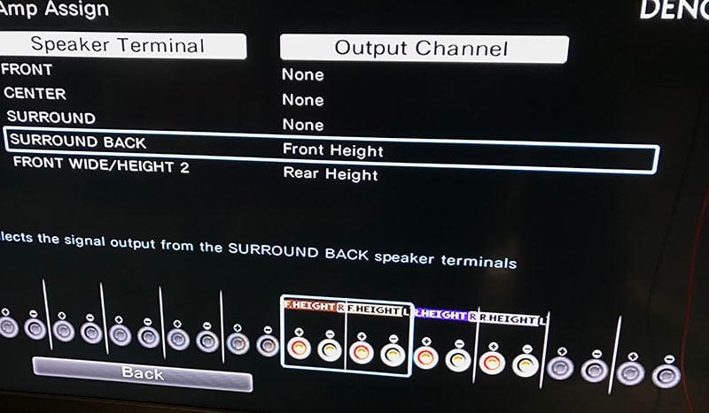

I selected Denon's "unified" immersive audio layout to be able to play Dolby Atmos, DTS:X and Auro-3D content natively. I selected Monolith 7 to power the seven primary floor-standing channels via the Denon's pre-outs.
Patricia Barber’s “A Taste of Honey” from Cafe Blue followed suite. Driven by the Monolith, the SVS Ultra towers exhibited beautifully controlled bass lines. Turning to Norah Jones’ “Don’t Know Why” from her album Come Away with Me, her intimate, breathy vocals were in full swing. And when I spun her duet, “Here We Go Again” with Ray Charles I continually noted the ability for the Monolith and SVS combo to produce a layered soundstage with precise imaging and good depth.
Using the Denon X7200WA's flexible speaker assignment option, I assigned the Denon's internal amplification to power my front and rear height channels.

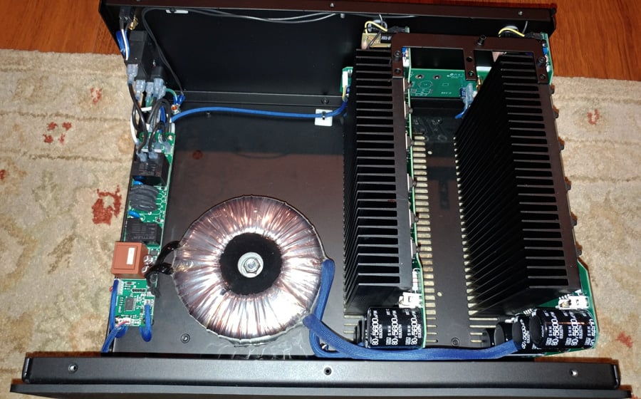

Inside the Monolith 2 you will find a lot of empty space. This is NOT a bad thing mind you as there is plenty of space for ventilation. The power modules are constructed as monoblocks; each having 6 output devices per channel and 4x 5,600uF, 80V capacitors in parallel to yield a total of 22,400uF of capacitance per channel.
Interior view of the Monolith-2 two-channel amplifier.
The power modules are constructed as monoblocks; each having 12 output devices per channel (6 visible, 6 under the PCB) and 4x 5,600uF, 80V capacitors in parallel to yield a total of 22,400uF of capacitance per channel. The parts are rated at 85 deg C which,is pretty standard fair for a product of this caliber. The entire amp is fed off one large 800VA transformer. This amp has all the right hardware to deliver its rated power honestly, and then some. The same principles remain as you move up the model line-up with their Monolith7 boasting dual torrodial power transformers (1,230VA and 1,025VA) to maintain rated power with all channels driven.

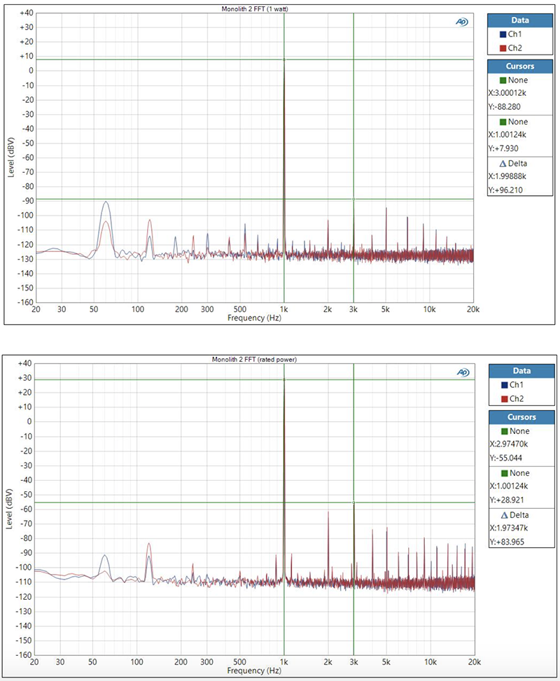

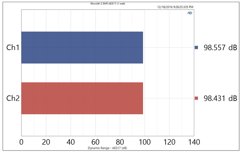

Signal to Noise Ratio
Monolith-2 SNR (A-wt) @ 1 watt
The Monolith-2 exhibited an incredibly low noise floor which isn't surprising given the quality of the guts inside and the expert design of the folks at ATI behind it. At full rated power (200 watts), the noise floor was around 121dB. If there is noise in your system, rest assured it's not caused by this amplifier.

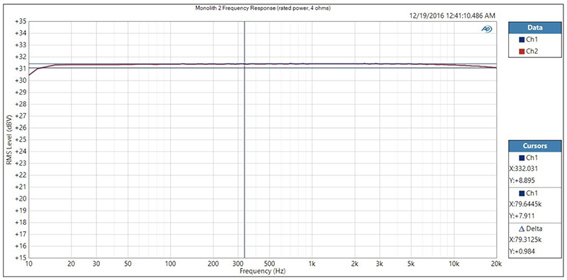

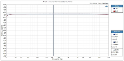

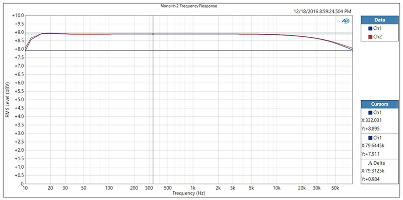

Frequency Response
Monolith-2 Frequency Response @ 1 watt
The frequency response of the Monolith-2 was ruler flat at virtually every power level within the audio band and down only -1dB at 10Hz and the limit of my measurement system (80kHz).

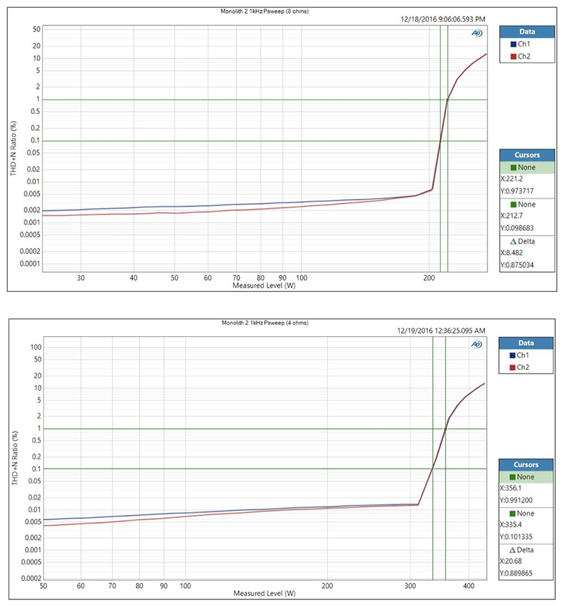

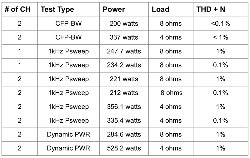

Power Measurements
Using our Audio Precision APx585 8-channel HDMI analyzer, I
conducted a full barrage of power tests on the Monolith-2 using a
dedicated 120V / 20A line.

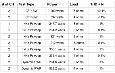

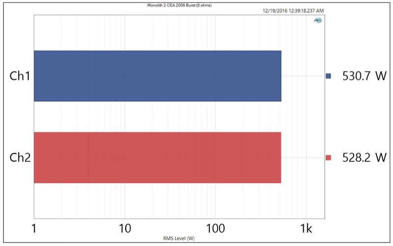

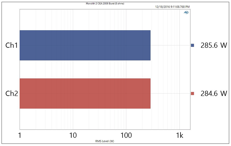

We tested power using three methods all of which were taken at < 0.1% THD + N:
- Continuous Full Power Bandwidth (CFP-BW) from 20Hz to 20Khz into 8 and 4-ohm loads
- 1kHz Power Sweep vs Distortion (1kHz PSweep) - popularized by the print magazines, this is an instantaneous power vs. distortion test at 1kHz. The problem with this test is it often masks slew related and or frequency response problems some amplifiers exhibit at the frequency extremes, and thus inflates the measured power results. It does provide instant gratification # for consumers to argue over on the forums, so we are now incorporating this test to please the masses.

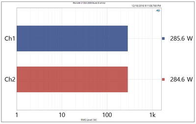

- Dynamic PWR - 1kHz CEA-2006 Burst Method testing. This is a dynamic power measurement adopted from the car industry similar to IHF method, only a bit more difficult for an amplifier and more representative of real musical content.
Keep in mind most review publications don't do continuous
power measurements and they usually publish power measurements into
clipping at 1% THD + N. Our measurements are very conservative as we use
a dedicated 20A line with no Variac to regulate line voltage. We
constantly monitor the line to ensure it never drops more than 2Vrms
from nominal which in our case was 120Vrms.
For more info on amplifier measurements, see: The All Channels Driven (ACD) Test.
Monoprice Monolith Full Power Bandwidth Continuous Sweep (335 watts, 4 ohms)

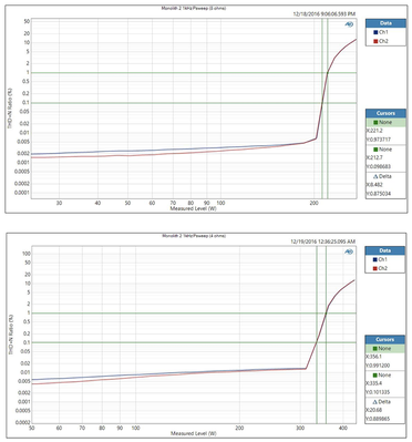

The Monolith-2 delivered a whopping 335 watts/CH full bandwidth with both channels driven at less than 1% THD+N. It's nice to see a manufacturers product deliver more than rated power as its uncommon today in the AV receiver market.
Monolith-2 1kHz Power Test
Top Pic: 8 ohm load; Bottom Pic: 4 ohm load
The power sweep tests revealed the Monolith-2 to be a powerhouse comfortably delivering more than its rated output power with both channels driven. We measured 221 watts/ch at 1% into 8 ohms and 356 watts/ch at 1% into 4 ohms, both channels driven.
Monolith-2 Dynamic Power Test (1kHz)
The CEA-2006 burst tests simulate musical program material. The Monolith-2 proved have incredible dynamic headroom partly due to its very beefy power supply. Into 8 ohms, the Monolith-2 produced over 1.5 dB of dynamic headroom for 8 ohm loads and 2.5 dB for 4 ohm loads.
Monolith-2 Power Measurement Table
Monoprice rates the Monolith-2 as follows:
- 200 watts: 20Hz - 20kHz < 0.03% ; 8 ohm load
- 300 watts: 20Hz - 20kHz < 0.03% ; 4 ohm load
The Monolith-2 easily delivered rated power and then some. It's refreshing to see an amplifier manufacturer conservatively rating its products.
FFT Distortion Analysis
Monolith-2 FFT Distortion Analysis
(Top pic: @ 1 watt ; Bottom pic: @ full power)
I
ran FFT distortion plots at 1 watt (top pic) and full rated power
(bottom pic) to determine how clean this amplifier really is.
There
was a slight ground loop that developed between the Monolith-2 and my
test equipment I was unable to fully resolve which did have a negative
effect on the distortion results. That said, the noise floor was
exceedingly low while the odd-order harmonics dominated the distortion
profile. The 3rd harmonic was still 96dB below the fundamental. At
full power, the distortion products rose as expected but the 3rd
harmonic was still 83dB below the fundamental which was good.

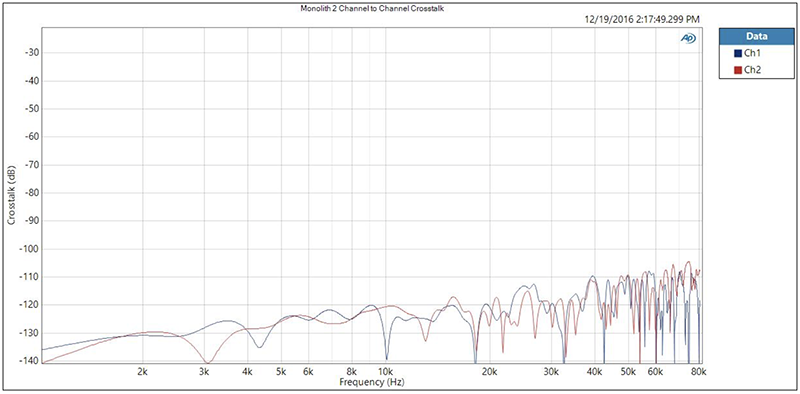

Crosstalk
Monolith-2 Crosstalk (Channel to Channel Isolation)
The channel to channel isolation of the Monolith-2 is simply superb exhibiting -120dB at 20kHz with a very slow rise up to 80kHz. This is about as good as it can get and allows you to get the monoblock type of isolation from a multi-channel amplifier.
