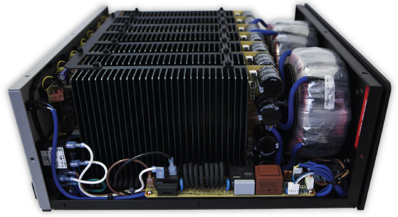

monolith transformer
Inside the Monolith each amplifier channel has its own set of transformer windings, and also its own storage capacitor. Essentially, each channel has its own power supply – meaning if one channel gets maxed out, the other channels are not affected.

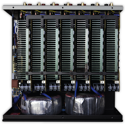

monolith7 circuit boards
The Monolith also comes with optically coupled circuits which are designed to detect electrical shorts from either the speakers, speaker wire, or electrical outlet. If triggered, the circuit will disengage the output, protecting the amplifier. It will then sample the affected circuit every 10 seconds and will restore output when it is safe to do so. Unlike other designs where there is a fuse or relay in series with the output, which can raise the damping factor or modify the sound depending on the impedance variations in the loudspeaker, their protection circuitry monitors the signal actively, but does so optically from outside the circuit path. This ensures no performance degradation regardless of the loudspeaker load.

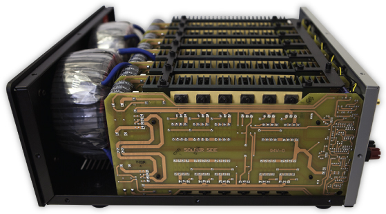

monolith 7 heat sinks
Oversized heat sinks, instead of fans, are used to cool the amplifier and keep it as silent as possible. We also really liked the powder coated finish designed to resist scratches and prevent corrosion.

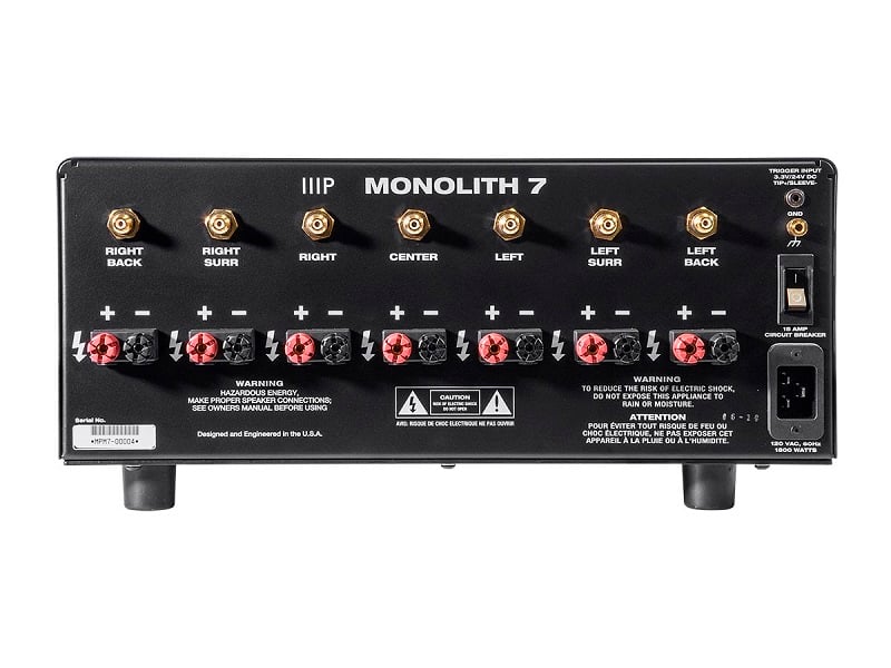

monolith7rear2
Looking at the back of the unit you can see the gold plated RCA jacks that are mounted directly on the chassis, not on a separate internal circuit board. This allows for a firmer connection that shouldn’t loosen over time or break. The only omission is balanced inputs which is too bad but perhaps Monoprice will offer a balanced version in the near future for upscale installs that demand nothing less than fully differential circuit paths throughout the entire audio chain.
The Monolith is engineered with a soft start circuit (to reduce inrush current caused by the large filter banks) that gradually powers up the unit, preventing the dreaded speaker thump, while also easing the load on household circuitry. Once fully powered, the circuit is removed from the signal chain to ensure sonic clarity.
