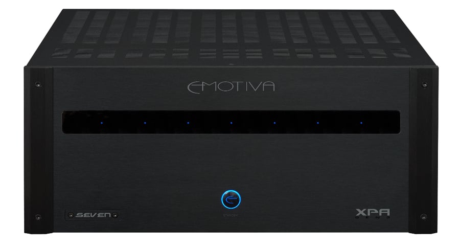

While the XPA Gen 2 amplifier models were an evolution, the XPA Gen 3 update is a full-out revolution.  Emotiva’s XPA Gen 3 Amplifiers are not simply a redesign, but rather an entirely new paradigm in form, customizability, and design.
Unlike previous incarnations, the entire XPA Gen 3 lineup shares exactly the same chassis and power supply that is completely customizable to your individual system.  In other words, the XPA Gen 3 is a complete line of highly flexible, modular amps.

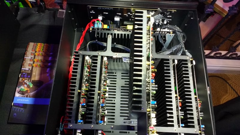

You can choose to configure the Gen 3 amplifier to accommodate anywhere from 1 to 7 channels in a single chassis and choose multiple power levels per channel.  For example, let’s say you have a two channel system today, you can order a stereo configured XPA Gen 3.  If you upgrade to 5.1 later, you can upgrade that two channel amplifier to 5 channels—all the way up to 7 channels by simply adding an amp module per channel at a time.  The minimum recommended module load, according to Emotiva is two channels with the standard modules.

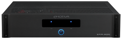

Emotiva XPA Gen 2 Amplifier
Emotiva's XPA Gen 2 Series, such as the XPA-200 above, was an evolutionary step over the Gen 1 models.  The new Gen 3 series is a revolution

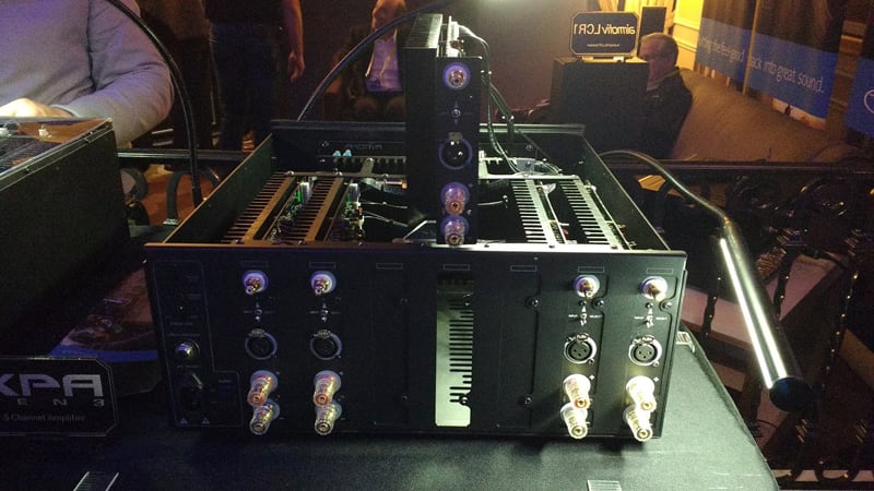

But what if you want a monoblock design like Emotiva’s Gen 2 XPA-1?  Well, for audiophiles who want the purity of monoblocks, Emotiva will be releasing a high power, “double-wide” balanced mono-block module.  The XPA Gen 3 chassis will be able to accommodate up to three double-wide modules.   Each high power module will allow for an incredible +500 watts at 8 ohms. As you’ve come to expect from Emotiva both the double-wide and standard modules are stable into 2 ohm loads.
Because the entire architecture is modular, you can upgrade any XPA Gen 3 amplifier at any time to grow as your needs grow.  Upgrading your amp, however, won’t be user-installable.  You’ll need to ship the amp back to Emotiva or have one of Emotiva’s qualified international distribution partners do the installation.
Emotiva says that each channel combines differential input, fully complementary, short signal path Class A/B amplifier circuitry, and an optimized Class H power topology to deliver both audiophile-grade sound and high efficiency.
Emotiva Gen3 XPA Amplifier
Emotiva XPA Gen3 Amplifier- note the removable modules

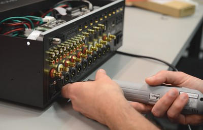

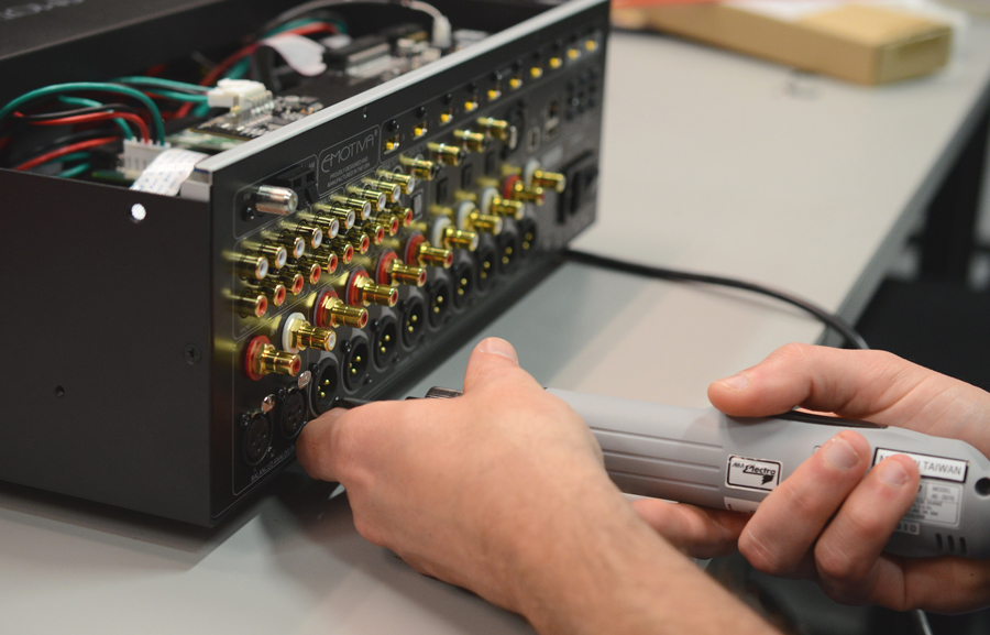

Another major piece of news about the Gen 3 amplifiers is their place of assembly.  Unlike previous Emotiva incarnations, which were both manufactured and assembled in China, the XPA Gen 3 models assembled right here in the USA at their state-of-the-art manufacturing facility in Nashville.  The major subassemblies are still built in China but this heralds a significant shift for Emotiva.  In fact, the XMC-1, Emersa, and Ego products are made in the USA including the PCB assemblies.  These lines are primarily sourced and assembled in the USA down to the board level.  We're seeing a decided shift here.  Emotiva is making a concerted effort to bring more manufacturing in-house.
Emotiva assembled in the USA
Emotiva's new XPA Gen 3 amplifiers are all assembled in the USA.  Emotiva is moving more and more of its assembly and manufacturing to its Nashville, TN plant.  The XMC-1 processor (shown above) is now made in the USA.
