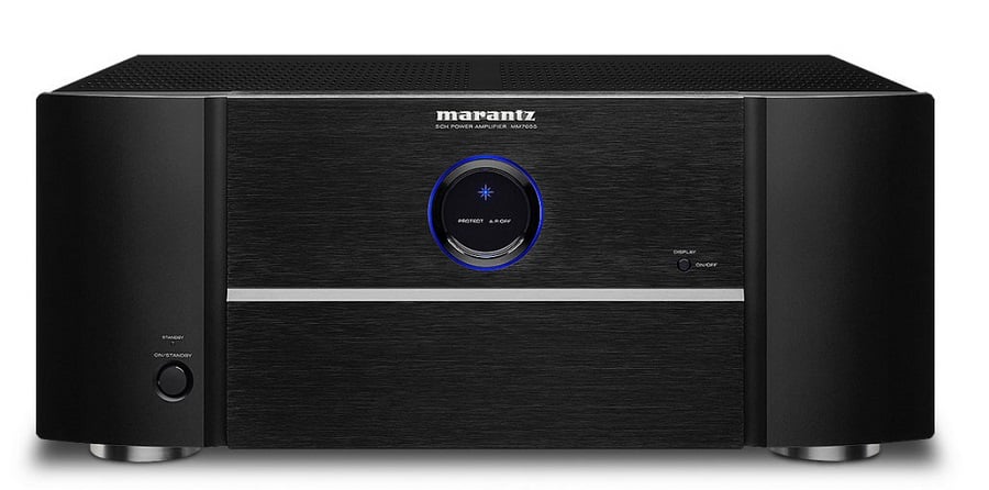

At first blush, the Marantz MM7055 may not seem like a terribly interesting product. Its $1,199 price tag doesn’t appear terribly competitive with Internet-direct products from companies like Emotiva and Outlaw. Moreover, in the age of immersive audio (i.e. Atmos, DTS-X, and Auro-3D), a 5-channel power amplifier seems just a tad quaint. On the other hand, one has to wonder just how far A/V receiver manufacturers can push the envelope. With some models boasting as many as 11 channels of amplification, in addition to the extra processing power required by these formats, it stands to reason that something has to give. Usually, that means they skimp on the power sections of the receiver’s amplifier. A separate amplifier like the MM7055 can give such receivers a healthy boost of power on the main ear level channels where it’s needed most. So what about the question of value? Keep reading to see my thoughts…

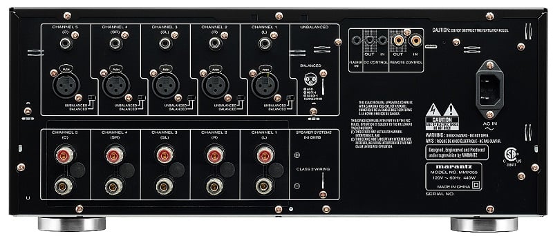

On the front face, the MM7055 features an On/Standby button, the iconic Marantz porthole, a protect mode indicator, and a button to turn off the display. The rear panel boasts both RCA and balanced XLR inputs, which is switchable on a per-channel basis. In addition, the MM7055 features a DC trigger input / output, and RC-5 remote control jacks.

Upon unboxing the Marantz MM7055, I gave it a visual and hands-on inspection. The chassis feels quite solid, as one should expect from an amplifier in this price range. The unit itself weighs in at roughly 35 pounds, so it’s quite a bit heftier than your average “100W x 7” A/V receiver, but it’s not a back-breaker either. The input jacks feel reasonably secure, so you’re unlikely to pull one out with a tight gripping interconnect. However, one nit-pick I have is that the binding posts, while looking nice, are a bit chintzy for a product in this class. They’re essentially dressed up versions of what you’d find on an inexpensive A/V receiver: wobbly, and not well suited for accepting large gauge bare wire (I’d recommend banana plugs for anything larger than 14AWG cable). On the up side, the posts are well spaced, and the chassis itself has a layer of plastic around the binding posts to prevent a stray strand of wire from contacting the metal chassis. Aesthetically speaking, the unit is unabashedly a Marantz. In my humble opinion, the MM7055 is quite a bit easier on the eyes than the comparably priced, plain-Jane Outlaw 7125 I have on hand, but as they say, your mileage may vary.

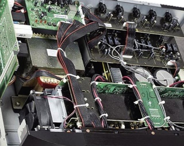

Glancing through the top cover to check out the guts of the MM7055, a few things stick out. First and foremost, the unit boasts a relatively large EI transformer, which undoubtedly contributes a great deal to the unit’s weight. The other thing that’s immediately eye-catching is the pair of massive capacitors gracing this amplifier. Each capacitor is rated at 33,000uF / 71V, which ensures plenty of reserve capacity for dynamic peaks. To see how this compares to a high quality receiver, one can look to the Audioholics review of the Marantz SR6004. That unit boasted a pair of 10,000uF / 63V capacitors, which offer less than a quarter of the energy storage of the MM7055’s caps.
Guts of the Marantz MM7055 Amplifier
The final item of note in my inspection is Marantz’s “thermal tunnel,” upon which the amplifier’s output devices are affixed. It consists of an aluminum tube with a fan on one end, and an exhaust to the exterior of the chassis on the other. The practical effect of this is to reduce the weight of the amplifier, since active cooling reduces the need for large, heavy heat sinks. My back thanks Marantz for going this route, versus adding another 5-10 pounds’ worth of aluminum to the mix.  It is likely that Marantz didn't certify this as a 4-ohm product because it would have required even further heat reducing measures to do so which adds cost and weight.
