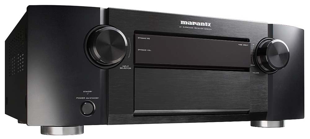

Marantz SR6004 Introduction
Marantz has been going at it for over 50 years producing audio equipment. Like any company that's been bought and sold over the years, they've had their share of up and down cycles. Lately it seems Marantz is back on the up cycle, releasing a series of high performance receivers that have the critical features everyone wants while packing the punch necessary to drive a full surround system to theatrical levels. I was interested in checking out their middle-of-the-road product, the SR6004, which retails for $1,249. At this price manufacturers must choose the right balance of performance and features. My job was to see how well Marantz executed this delicate balance while holding true to their strong audio-focused heritage.
Design Overview
The SR6004 is what I call a midsized receiver. It doesn't take a forklift to move, yet it has a solid feel to it which implies a decent sized power supply to amply drive a full 5.1 or 7.1 speaker configuration. The SR6004 employs a class A/B power amplifier design and is rated for 110wpc x 7. I always pop the top off of any receiver I review prior to hooking it up as I like to know what's under the hood. The EI core transformer appeared to be quite sizable for a receiver of this price class, but those power capacitors I saw near the transformer looked puny. They were 20,000uF but only rated for 16V. The minimum voltage caps that should be used to produce the rated 110wpc should be at least 50V. At first glance I thought I found a major design error in this receiver until Marantz engineering pointed out that the actual power supply caps were hidden underneath the HDMI board and were in fact 10,000uf, 63V rated.

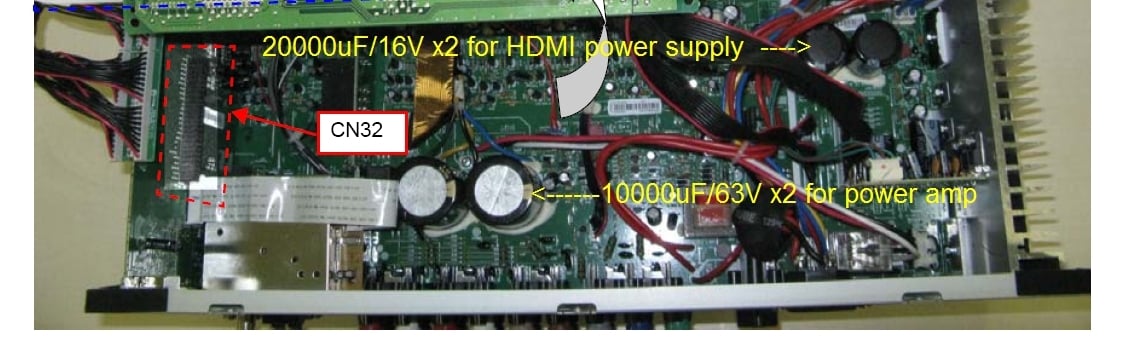

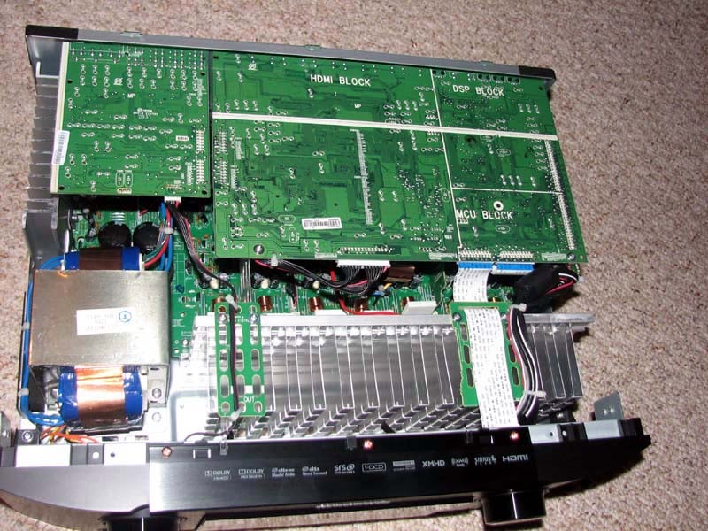

Marantz SR6004 No Cover
Marantz engineering also informed me that all of their SR series receivers (including the SR6004) were designed to maintain 70% (77wpc) power output under a 5 channel load and 50% (55wpc) power output under 7 channels driven against its two-channel driven spec. Of course I planned on validating this claim which you will see in the measurements portion of this review.
Marantz SR6004 Power Supply Capacitors

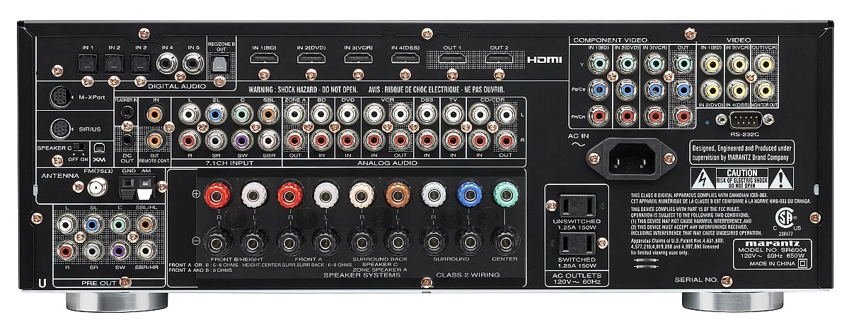

Marantz SR6004 Back panel View
The SR6004 back panel is laid out quite nicely. It's not a cluster of connections like you find on many other receivers these days partly due to the absence of S-video connections. There are binding post connections on all 9 pairs of speaker terminals, 4 HDMI inputs and dual HDMI outputs. The SR6004 has a two-prong detachable power cord, one switched and one unswitched outlet and 7.1 preamp inputs and outputs to allow for future format expansion and external amplifier, respectively.

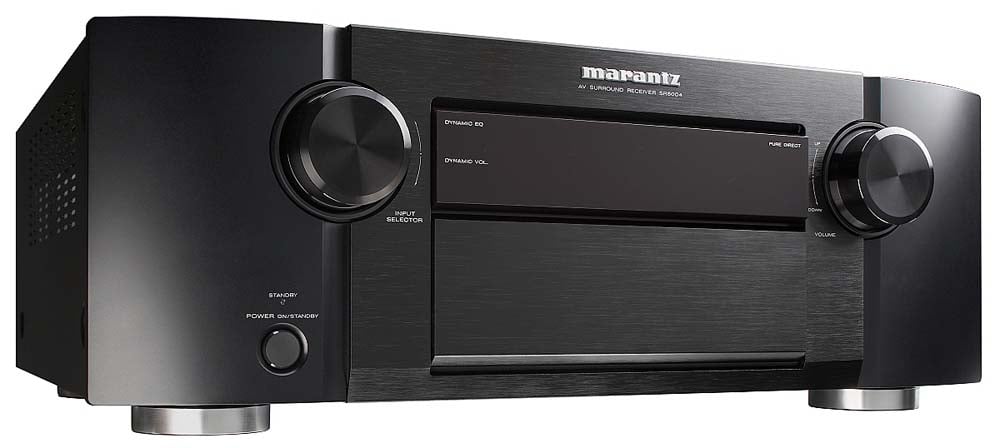

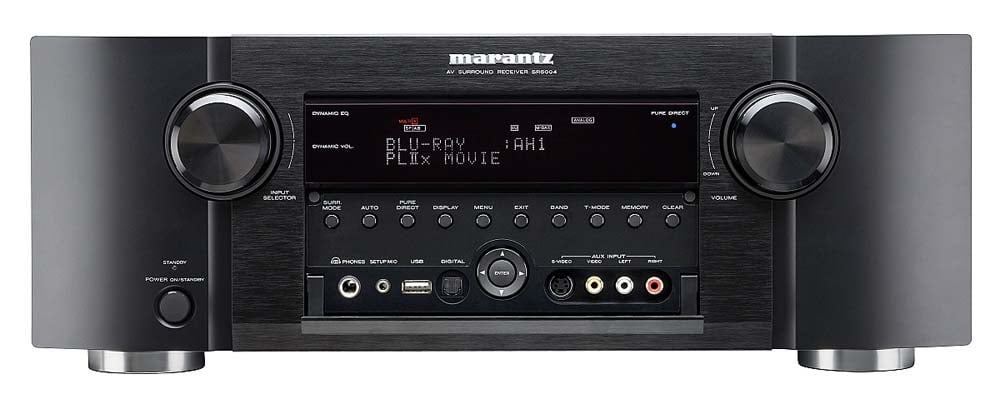

Marantz SR6004 Front panel View
The
SR6004 doesn't have the typical boxy feel you get with most receivers. Instead it sports some sexy curves given it
the feeling of a high end gear not dissimilar to their beautifully crafted
two-channel reference gear. The front
panel has an array of buttons and inputs.
Oddly, there is an S-video connection which in my opinion would have been
better to be an HDMI connector instead.
The front panel also includes a phono input, USB connector for use with
flash drives, or music streaming devices such as an iPod, analog audio and
composite video and Toslink for digital music sources.

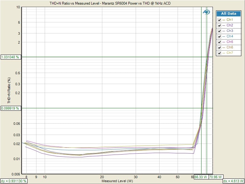

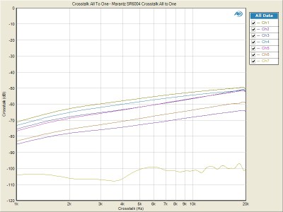

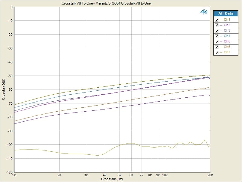

It's also important to note that the SR6004 is equipped with only seven internal power amplifiers. Thus, during speaker setup if you enable "Front Presence" and "Surround Back" speakers, the SR6004 will send signal to only one of those respective speaker groups depending on the post processing being selected (ei.e. PLIIz will enable the front height speakers, while PLIIx or Dolby EX will enable the surround back speakers).

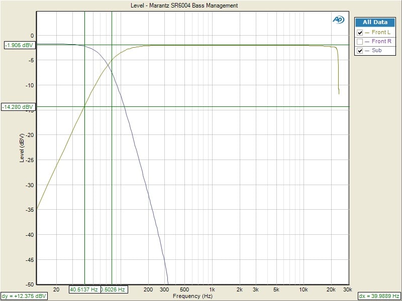

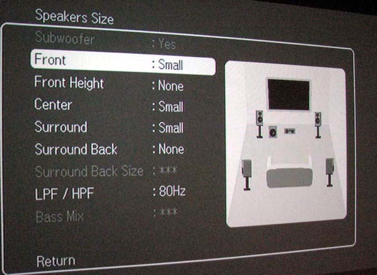

Bass
Management
The Marantz SR6004 has very good bass management facilities. By very good, I mean it has the following provisions we've come to expect quality components to exhibit:
- 0.1ft speaker size adjustment resolution
- 0.5dB channel trim adjustments
- variable crossover (40-180Hz in 20Hz step sizes)
- 12 dB/Oct HPF for all speakers set to "small" and 24dB/oct LPF for the sub out
- ability to simultaneously produce main channel bass from main speakers + sub
About the only option missing was
independent crossover settings per speaker groups but we've usually found
that option to be a mixed bag if not properly configured by the end user. The "Bass Mix" option was a bit
confusing. In order to get simultaneous
bass via the main channels (when set large) and the subwoofer, you have to
select "both". The
"Mix" setting only sends main channel bass to the main channels. Personally I would have preferred this option
to be called "mains" as to me "mix" implies bass output to
the main channels and sub.

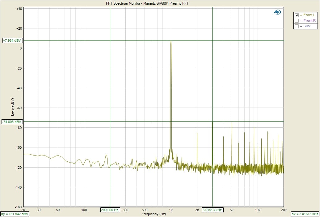

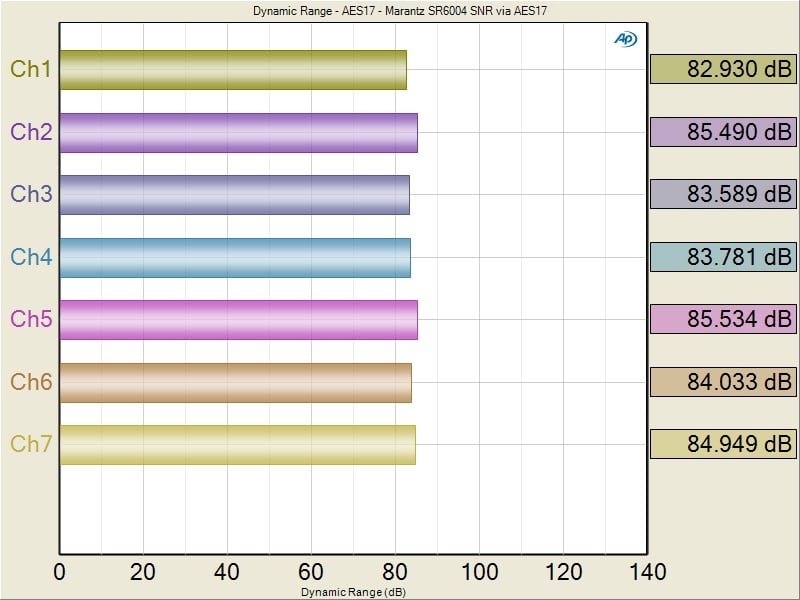

Using our Audio Precision APx585 HDMI audio analyzer, we measured the bass management circuitry to confirm the crossovers worked as expected for a THX Ultra2 certified receiver as indicated by the 12dB/oct High Pass Filter (HPF) slopes on speakers set small and 24dB/oct Low Pass Filter (LPF) slopes on the subwoofer output.

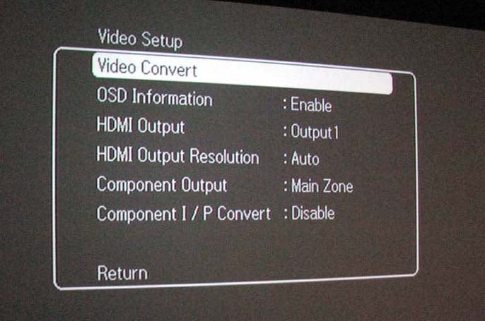

Video Set-Up & Test Results
The
Marantz SR6004 offers analog i/p and component to HDMI upconversion but no
ability to adjust picture settings or noise reduction as some of its more
expensive competitors. While it's nice
to have a full set of calibration options built into the A/V receiver/processor
for each of its inputs to simplify the display hookup and switching to a single
HDMI input, the workaround utilizing a few more inputs and macros on your
remote to do the video switching isn’t all that bad either.
I tested the i/p conversion via component video which returned nearly a perfect score on our HQV tests (no noise reduction) but the analog to HDMI upconversion was a different story. All of the cadences and jaggies #2 failed. If you're dealing with a high quality analog source you're likely better off bypassing the upconvert features of the SR6004, or running it directly to your display.
For
more information about proper display calibration, read our article on HDMI
Enhanced Black Levels.
I disabled video convert for all of my sources and found the SR6004 passed native HDMI resolution just fine. I was also running 720p component video from my BD player to my bedroom system with over 50ft of coax and had no performance issues at all.

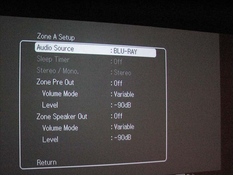

The SR6004 is equipped with 3 zones of audio. The main zone provisions for 5.1 or 7.1 which can be assigned for front height or surround back channels, zone A for secondary analog audio and A/V switching (no HDMI) and Zone B for digital audio output only. There is a single DC trigger output that is assignment to turn on for each input.
The surround back channel amplifiers are assignable as shown below:
- Zone A
- Flip
switch on back of receiver, enable SPK C to allow for biamping
Honestly, this whole Zone A/B/SPK C nomenclature is very confusing to us. It would have been more intuitive if Marantz stuck with Main/Zone2/Zone3 and used “Biamp” word on back of the receiver instead of SPK C.
Another issue of confusion to us was the "Z.spk" button on the remote. Even if the user enables Zone A audio, they will NOT get sound to their speakers if using the internal SR6004 amplifiers unless they engage the "Z.spk" button on the remote. We think it's cool that Marantz is giving the user independent level control of the Zone A preamp out and the speaker level for that zone but we suspect this won't be very intuitive for most users.

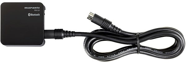

RX101 Bluetooth Wireless Receiver
Plugging
in the RX101 was a bit trickier than I initially figured. I carelessly attempted to plug in the 9-pin
connector in the back panel without precisely lining up the arrows causing 3 of
the pins to bend. After using a paper
clip to straighten them, I proceeded more carefully and made the
connection. The RX101 LED illuminated
red and I was ready to pair it with my 32Gig Apple iTouch G2.
Here is how you pair
the RX101 to an iTouch / iPad device:
- Select M-Xport input on the SR6004.
- Simply hold down the "mode" button on the back of the RX101 for about 5 seconds then depress it. At this point the RX101 should flash blue / red in 0.5 second intervals.
- Now go into the "General" setting of your iTouch, select "Bluetooth".
- Enter the code "0000" into your iTouch to pair it with the RX101.
- After the connection is established, select the RX101 output option on your iTouch. This should enable audio transmission to the SR6004.
I've never been a fan of Bluetooth audio quality but I found the audio quality in this case was acceptable for casual listening. The problem I found however was that audio dropouts were far too frequent to not draw attention to themselves. I tried experimenting with positioning of the RX101 with respect to my iTouch but I found no resolve to this issue. Mileage may vary from user to user but after this experience I shelved the RX101 and decided to connect my iTouch via analog instead.

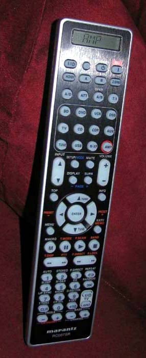

The RC007SR remote control is fully backlit by simply pressing pressing the right side button. Ergonomics are good as the remote can be controlled an operated using a single hand. There is a central circle pad of buttons allowing for easy navigation through the menus of the OSD. The source buttons are actually used to select function of the remote instead of switching inputs on the SR6004. Personally I can't stand when manufacturers do this. It took me a few minutes to realize I had to hit the "amp" button just so the remote would operate the receiver. If you want to switch inputs, your going to have to use the up/down input keys on the remote or use the front panel dial on the receiver. Personally I feel Marantz could take a lesson from Yamaha on how to do a push button remote the right way as I've found the remote from their RX-Z7 to be one of the most user friendly and intuitive fully push button remotes found on an A/V receiver.

Preamp Section
Marantz SR6004 Preamp FFT Distortion Analysis
With 0dBFS in, the SR6004 was able to output a whopping 7Vpp unclipped (<.1%THD +N) or 2.49Vrms. The 3rd order harmonic component was over 80dBv below the fundamental which was very good. Adjacent channel to channel crosstalk produced 81dB @ 1kHz, 65dB @ 10kHz which again is excellent.

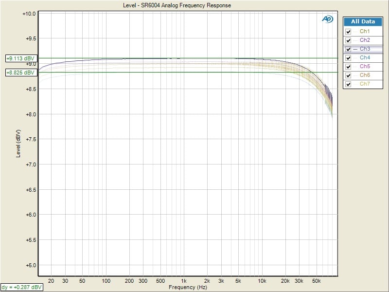

Marantz SR6004 Frequency Response
Using the HDMI input, measured frequency response was within +/- 0.25dB from 20Hz to 20kHz with -3dB of 43kHz (limit of Nyquist, 1/2 sampling rate of 96kHz). Channel to channel variation was within .5dB within the entire audio bandwidth.
Using the analog inputs produced a ruler flat frequency response beyond the bandwidth of my Audio Analyzer (80kHz). With plenty of clean output drive and excellent distortion and crosstalk figures, the Marantz SR6004 is more than capable of serving as a dedicated A/V processor in the event you wish to bypass its amplifiers for more powerful external amplification.

Power vs. Distortion
Using our Audio Precision APx585 8-channel HDMI analyzer, we conducted a full barrage of multi-channel amplifier tests on the Marantz SR6004. We tested power using three methods all of which were taken at < 0.1% THD + N:
- Continuous Full Power Bandwidth (CFP-BW) from 20Hz to 20Khz into 8 and 4 ohm loads (up to two-channels)
- 1kHz Power Sweep vs Distortion (1kHz PSweep) - popularized by the print magazines, this is an instantaneous power vs distortion test at 1kHz. The problem with this test is it often masks slew related and or frequency response problems some amplifiers exhibit at the frequency extremes, and thus inflates the measured power results. It does provide an instant gratification # for consumers to argue over on the forums so we are now incorporating this test to please the masses.
- Dynamic PWR - 1kHz CEA-2006 Burst Method testing. This is a dynamic power measurement adopted from the car industry similar to IHF method only a bit more difficult for an amplifier and more representative of real musical content.
Keep in mind most review publications don't do continuous power measurements and they usually publish power measurements into clipping at 1% THD + N. Our measurements are very conservative and it is clear that the 110wpc power rating is conservatively stated as you will see in the measured output below.
For more info on amplifier measurements, see: The All Channels Driven (ACD) Test
Marantz SR6004 Power vs Distortion
| # of CH | Test Type | Power | Load | THD + N |
| 1 | CFP-BW | 135 watts | 8 ohms | 0.1% |
| 1 | CFP-BW | 208 watts | 4 ohms | 0.1% |
| 2 | 1kHz Psweep | 112 watts | 8 ohms | 0.1% |
| 2 | 1kHz Psweep | 120 watts | 8 ohms | 1% |
| 7 | 1kHz Psweep | 66 watts | 8 ohms | 0.1% |
| 7 | 1kHz Psweep | 71 watts | 8 ohms | 1% |
| 1 | Dynamic PWR | 155 watts | 8 ohms | 1% |
| 1 | Dynamic PWR | 266 watts | 4 ohms | 1% |
| 7 | Dynamic PWR | 100watts | 8 ohms | 1% |
Marantz SR6004 Tabulated Power Measurements
The Marantz SR6004 power reserves were quite impressive for a receiver of its price and size. Not only did they exceed their 110wpc rating for up to two channels driven but they also exceeded their engineering spec of 50% power under 7 channels driven by outputting 66wpc at 0.1% THD +N and 71wpc at 1% THD +N.
Crosstalk
Marantz SR6004 Crosstalk Measurement at Full Rated Power vs Frequency
Running a full range frequency sweep from the preamp all the way through the power amp at full rated power (110wpc @ 8 ohms), I measured all-to-one crosstalk where all but the channel under test acted as the noise source or disturbers. This is the worst possible crosstalk test scenario. The other was the DUT. The Audio Precision plotted crosstalk for each channel under these circumstances and showed that the worst channel exhibited around 61dB at 20hz, 70dB at 1kHz with a gradual increase with frequency (50dB @ 20kHz) due to capacitive coupling. These were good measurements.

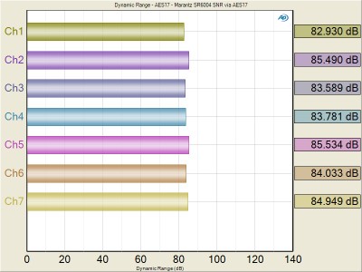

Signal to Noise Ratio (SNR)
Marantz SR6004 SNR per AES17
We measured the SNR at 1 watt power using no weighting for the worst possible measurement. It's important to know how quite a product is at low power levels to ensure the noise floor of the product isn't masking sonic detail. A number greater than 60dB at 1 watt is acceptable while a measured response above 80dB is considered excellent or very quiet. The SR6004 yielded 82.9dB for the worst channel which is an excellent measurement. It's no wonder why the SR6004 sounds so clean and detailed at low power levels.
