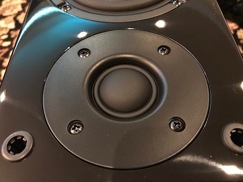

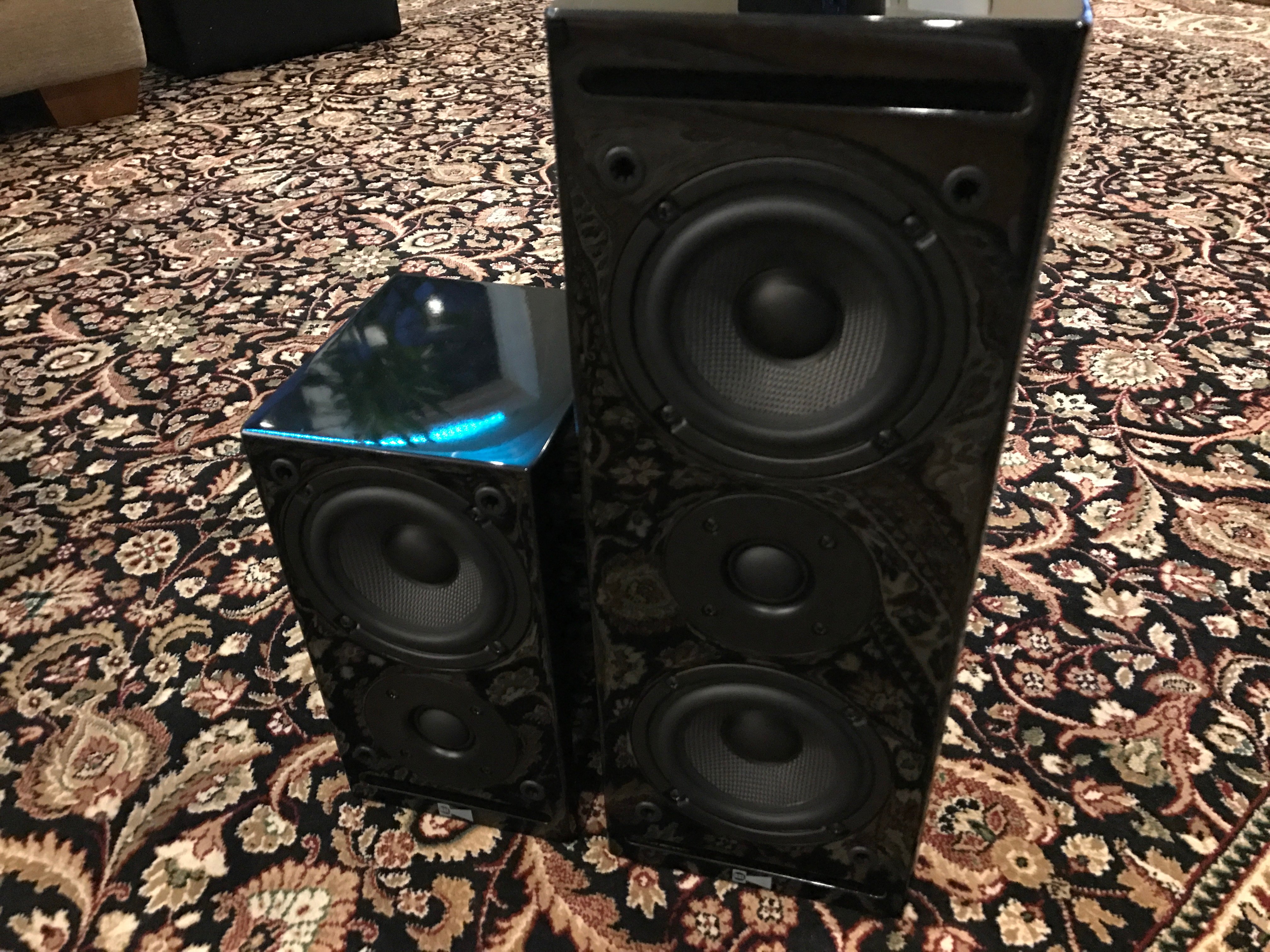

The CG3 is a two-way design with a 1-inch silk dome tweeter and 4-inch Kevlar® cone with a crossover frequency at 2500Hz and a second order crossover slope at 12db/octave. The CG3 is rated to play down to 100Hz.
The CG23 is an MTM (midrange-tweeter-midrange) design. The CG23 adds an additional 4-inch Kevlar cone and can be oriented vertically (as a main speaker) or horizontally (as a center channel). The crossover slope and frequency is identical to the CG3. The CG23 will play down a bit deeper to 85Hz ± 3db.  As you can tell, these monitors are specifically designed to be used with the companion Speedwoofer 10S. If you are planning on setting up a pure two-channel system, my suggestion would be to go with the CG23 if you can afford it because you can have a lower crossover to the subwoofer and get a bit wider soundstage (I’ll get into more about that further down).

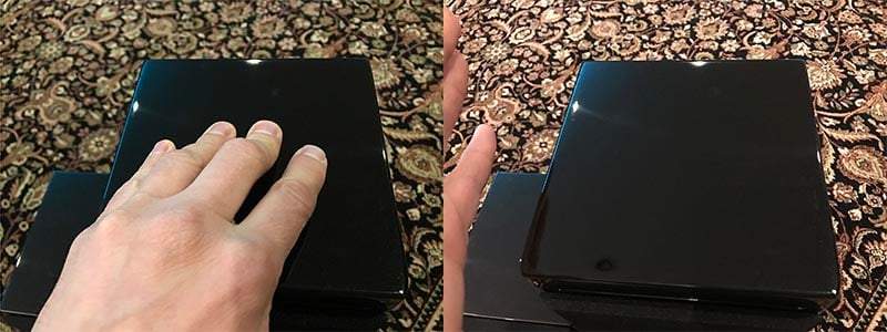

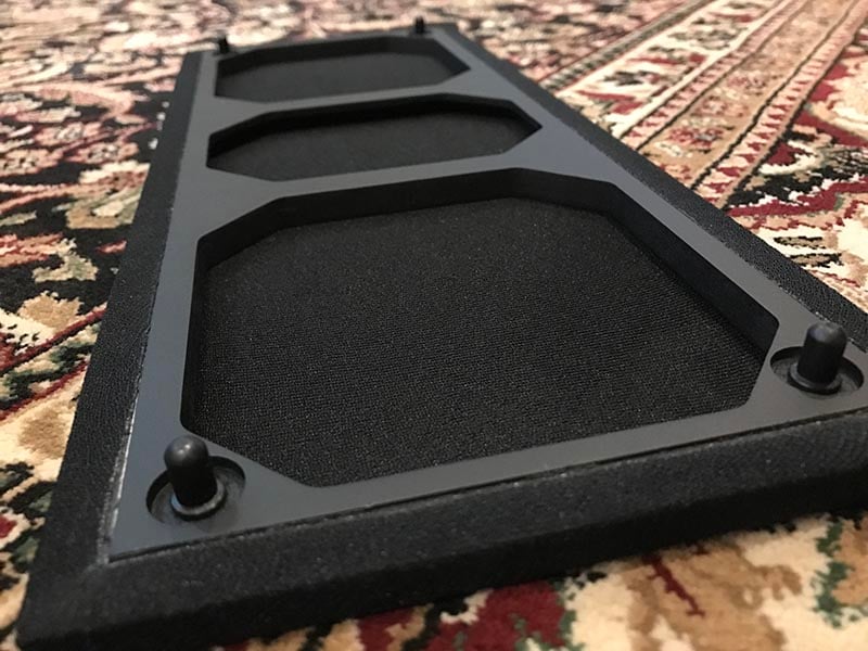

RSL CG3 models have a fingerprint-resistant finish that works
The RSL CG3 and CG23 have a fingerprint-resistant finish. I tested it and it works as advertised.
Unboxing the CG3s and CG23s was eerily similar to the CG4 and CG24. Just picking them up out of the box they felt solid and dense—a big nod to their build quality.  They felt more like solid blocks of wood than hollowed-out cabinets.
If they’re so similar, you might ask, then what’s different? Well, as far as I could tell, there are really only a handful of notable physical and component differences between the CG3 and CG4 line.  A difference doesn’t necessarily imply one is better than another. The CG3 is slightly smaller than its CG4 counterpart. The footprint of the CG23 and CG24, however, is identical. The CG3s have a silk dome tweeter with neodymium magnet; Kevlar woofer with stamped basket; air-core coil; a new fingerprint-resistant gloss finish that’s hand-painted; and traditional grilles with pegs.  The CG4s, on the other hand, have a silk dome tweeter with a ferrite magnet (though it's debatable if the ferrite is step up from neodymium in this instance); polypropylene woofer with cast aluminum basket; a hand-painted high-gloss finish (but it doesn’t resist fingerprints); and magnetic grilles. RSL also told me that the CG4/CG24 have more robust air-core coils, which use heavier gauge wire.

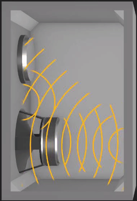

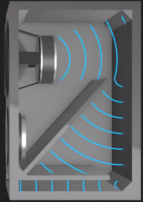

Standard Speaker without Compression Guide RSL's patented compression guide technology
RSL's Compression Guide technology is patented.
A standard speaker is pictured left and RSL's compression port, which divides the speaker's cabinet into areas of lower and higher pressure is pictured right.
The core technology at the heart of the CG3s and all RSL speakers is their patented Compression Guide. This is visibly seen as a slim, rectangular port on face of the speaker.  The CG3 has a single port and CG23 has dual ports.  There is no rear port. Joe told me that front mounting the port always a priority so customers could wall mount the speakers and have greater placement flexibility in general.
In case you’re not familiar with RSL’s Compression Guide technology, Howard previously described that his patented Compression Guide design,
“works by essentially dividing the cabinet up into areas of lower and higher pressure (compression). As the sound wave travels though these different pressure zones, the effect of resonance is reduced.  This reduction results in tighter bass and eliminates the ‘boxiness’ that even high-end box speakers tend to suffer from. We also feel that eliminating the ‘boxiness' increases midrange clarity.”
In some ways, it sounds similar to Atlantic Technology’s H-PAS, where you have internal dividing partitions that compress and accelerate the woofer’s backwave which then exit out a front-mounted rectangular vent. While Atlantic Technology announced H-PAS around 2009, RSL’s Compression Guide was patented decades earlier in the 1980s.

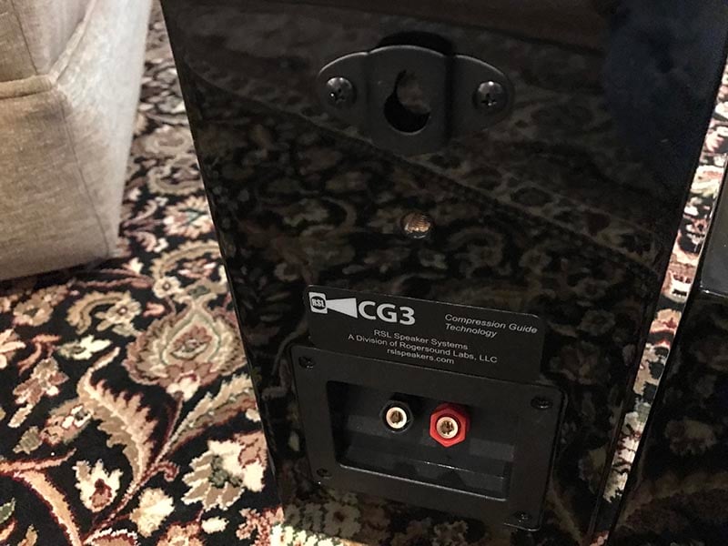

Other notable physical characteristics of the CG3 line include the ability flush mount them to the wall with threaded inserts or a keyhole mount; high quality (though short) binding posts; and a metal grille with traditional pegs. The CG3s are small enough that you could even use them as desktop monitors.

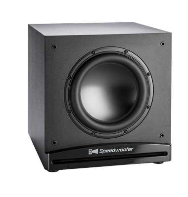

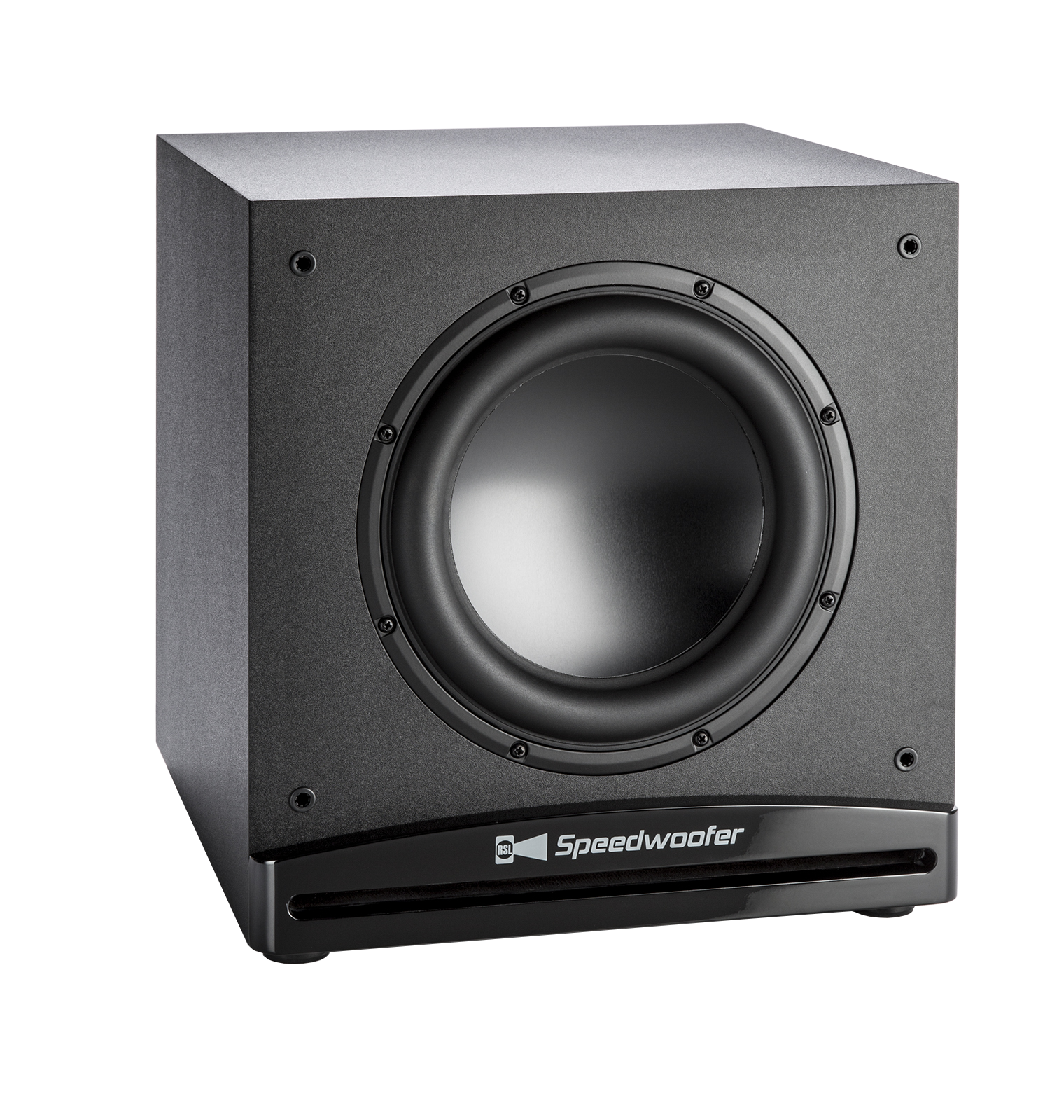

Speedwoofer 10S
The Speedwoofer 10S is one of the most ridiculous subwoofer values on the planet.
The included Speedwoofer 10S is aesthetically similar to its larger sibling, the Speedwoofer 10 Ultimate subwoofer. It too features the distinctive Compression Guide along its lower front baffle. However, the 10S lacks the outboard volume and crossover control and has a physically smaller footprint. Those features are now moved to the 10S’ rear. For $50 you can add a wireless option to the Speedwoofer 10S to make placement anywhere in your room possible.  I did not test the wireless option but have no doubts that it works as advertised.
RSL Speedwoofer 10s
RSL's Speedwoofer 10S is an incredibly impressive performer and stands at the heart of the CG3 home theater system.
Here at Audioholics we previously conducted an in-depth review of the Speedwoofer 10S and found it to be a superb performer, naming it our Budget Subwoofer pick in our 2016 Product of the Year list. I won’t rehash the specifics. You can read the full Speedwoofer 10S review for additional details.
RSL Speedwoofer 10S Review
Having now lived with the 10S, I can back up our review’s conclusions in spades. Let me emphasize that the heart of any multichannel audio system is its sub. It's the anchor and foundation. If the bass is sloppy you won’t enjoy movies and you’ll be robbed of the emotional response clean bass can deliver to the program material.
The Speedwoofer 10S is available separately for $399 shipped! It’s one of the most ridiculous subwoofer values on the planet. While it doesn’t reach down into the deepest regions of the netherworld, I found that it captured much of the essence and emotion of the original Speedwoofer that I reviewed last year.
