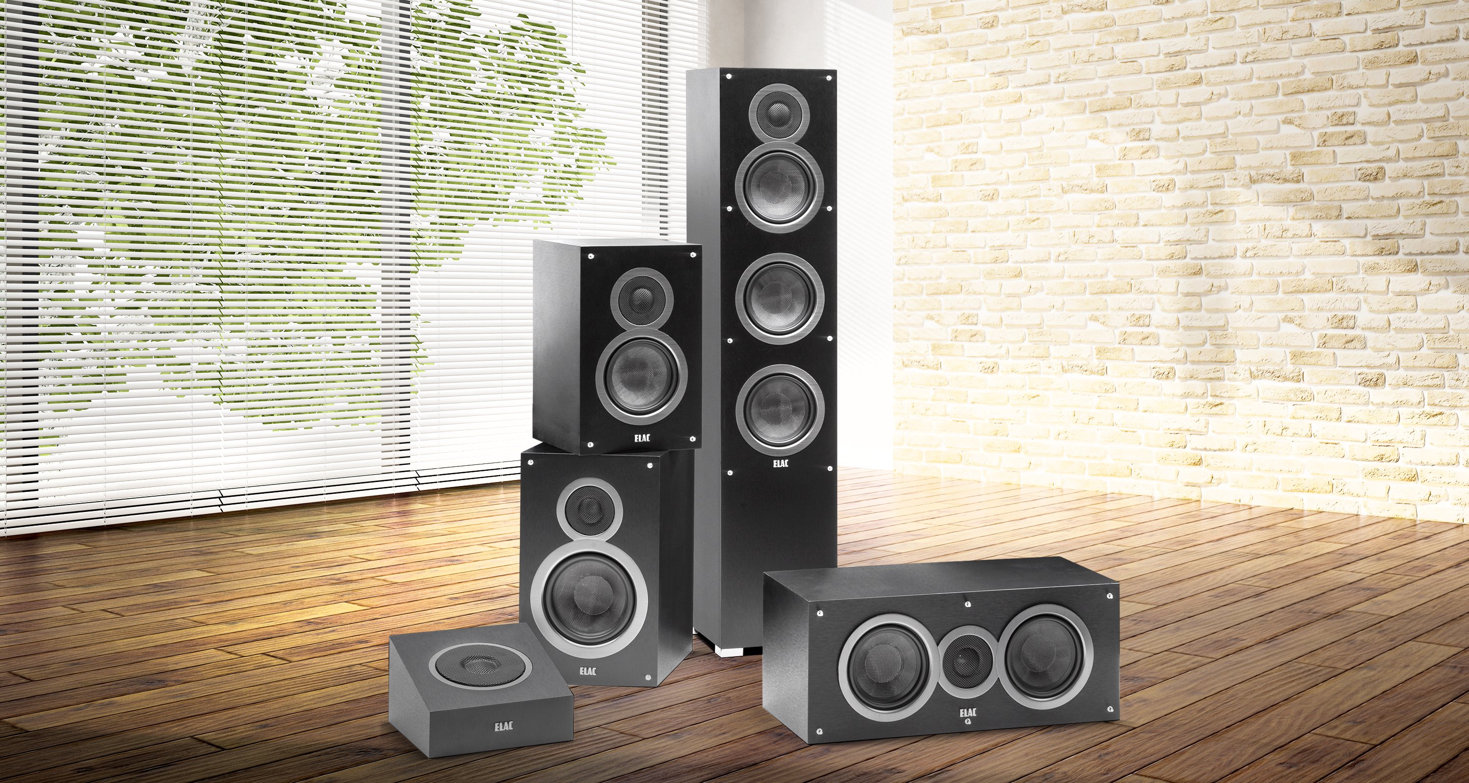

ELACs Debut Family of Speakers
ELAC's Debut Family of Speakers

ELAC’s Debut series is exactly that—an opening act for ELAC into the North American audio market. The full Debut series of speakers consists of two tower models, three monitor models, a center channel, and a Dolby Atmos speaker. The Debut line also features three subwoofers.
For my review setup, ELAC sent me a 5.0 configuration consisting of a pair of the F5 floor standing speakers, the C5 center channel, and a pair of B5 bookshelf monitors for the surrounds. While they are available, ELAC did not send me the line's Dolby Atmos speakers or one of their subwoofers.  We have a separate review of their new sub coming from our own Marshall Guthrie soon.  Therefore, I conducted the entire review without a subwoofer.

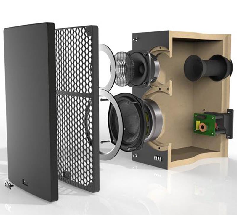

The vinyl is only skin deep. Under the veneer of each speaker is an MDF cabinet with the tower and center channel models incorporating extra bracing. I will say that the ELAC cabinets felt more solid than competing speakers in this price range. I was curious so I knocked my knuckles on the cabinet to see just how the enclosure sounded. Ideally, it should make a high pitch thud sound indicating the cabinet is rigid and inert. However, the ELACs delivered a distinct echo (no surprise here given the cost). I was expecting it to sound a bit more inert but I'm also used to reviewing top dollar speakers with budgets of each speaker far exceeding the cost of this whole system.

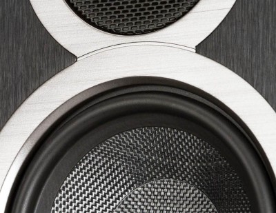

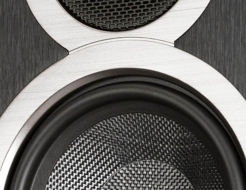

The Debut speakers utilize custom designed drivers. The woofers are made of aramid fiber cones that ELAC says provide superior strength to weight ratio over other materials. Choosing the aramid fiber cones gave more design flexibility and achieved a smoother extended response. The speaker designs also feature an oversized magnet and a vented pole piece.

The Debut series uses a silk dome tweeter. It’s recessed in a waveguide with a deep spheroid profile. ELAC says that the waveguide delivers improved directivity control and shields the tweeter wavefront from cabinet diffraction.   Research has shown that this is important for maintaining off-axis performance consistent with the on-axis so that the early reflections can combine beneficially at the listening area to expand the spaciousness and soundstage.
The crossover network brings the respective divers together and it’s the one area that budget speakers often don’t get right.  ELAC says that they have a refined, multi-element crossover which provides a perfect blending of drivers to deliver a coherent audio experience traditionally found on speakers costing substantially more. That’s typical marketing lingo, of course, but the point is well taken and we’ll see how well that performs in real-world listening tests.
ELAC B5 explosion view
View of the ELAC Debut B5's cabinet structure, crossover network, and ported cabinet.
The F5 is a three-way, bass-reflex design speaker with a 5.25-inch woven aramid-fiber cone midrange and two 5.25-inch woven aramid-fiber cone woofers. The drivers are crossed at 3,000Hz and 100Hz and are rated to deliver a frequency response down to 42Hz.
The F5’s little brother, the B5, is a two-way bass reflex speaker. It sports a single 5.25-inch woven aramid-fiber cone driver that is crossed at 3,000Hz and is rated to play down to 46 Hz.

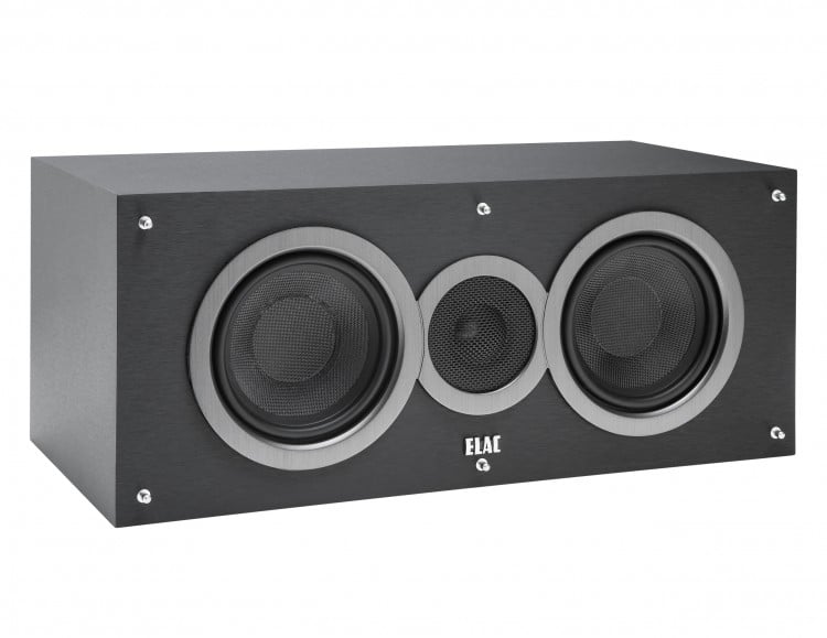

The C5 center channel is a two-way bass-reflex design. The drivers are laid out in a typical MTM configuration and not the W(T/M)W configuration that we'd like to see for installations where the seats are more than 30 degrees off-axis. At this entry-level price point, however, just about every single center channel speaker is an MTM design.
For further discussion on this topic see: Vertical vs Horizontal Center Channel Designs and Center Channel Designs Alternative Perspective
ELAC Debut C5 Center Channel
The ELAC C5 center channel speaker has an MTM design
The two woofers in the C5 are the same diameter as the towers—5.25-inches—and have the same 3,000 Hz crossover. For a center-channel speaker, the frequency response is a very respectable 48hz.

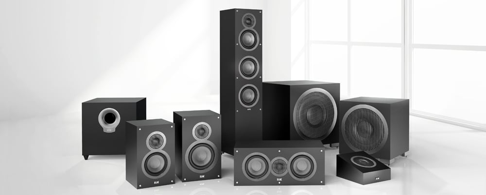

ELAC Debut Family of Speakers
The ELAC Debut family of speakers and subwoofers
If you’ve been cash-strapped and wanted to get great sound at home, then put pen to paper and drop Andrew Jones a big thank you note. The ELAC Debut is a darn great speaker line. What a superb example of mixing science and art to produce a true masterpiece. Certainly, at this price point, the Debut speakers have their flaws, but I never did find a real Achilles heel. Those flaws never undermined the many strengths of the setup. That’s a real testament.
So that there’s no doubt, I’ll say it plainly: The ELAC debut is an audiophile and home theater bargain. While the ELAC Debut won't dethrone $5k/pair or even $2k/pair competently designed speakers, it will give speakers at least twice or even three times their price a serious run for their money--knocking a few off their perch along the way. Highly recommended!
