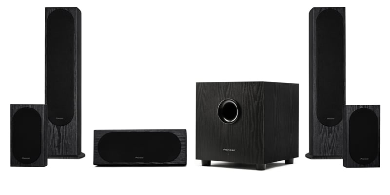

  • Product Name: SP-PK52FS 5.1 Speaker System
  • Manufacturer: Pioneer
  • Review Date: February 26, 2013 22:00
  • MSRP: $ 549 (entire 5.1 system)

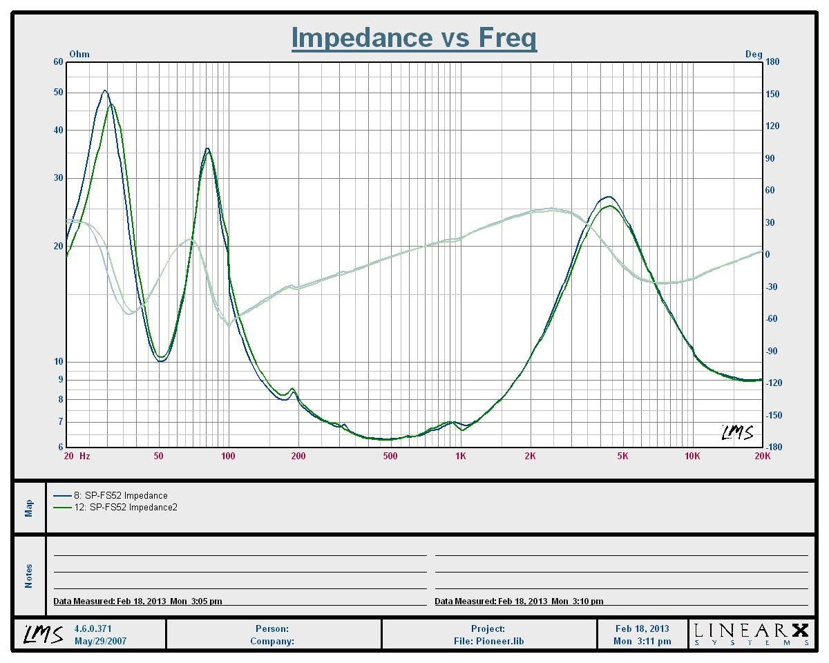

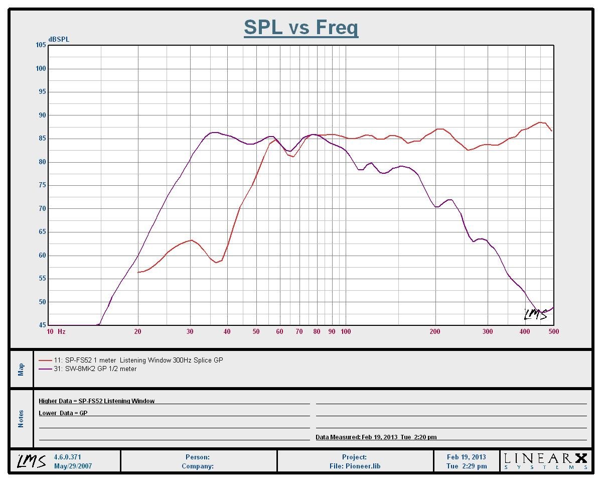

SP-FS52 Tower (MSRP: $129/ea)
  • 2 ½ way ported speaker
  • Three 5 ¼ “ Structured Surface Woofers
  • 1” High Efficiency Soft Dome Tweeter
  • 130 Watt Power Handling with Sophisticated 8-Element Crossover
  • Frequency Response: 40Hz to 20kHz
  • Sensitivity (2.83V): 87 dB
  • Impedance: 6 ohms
  • Xover Frequencies: 250Hz & 3kHz
  • Dimensions: 35.2” H x 8.8”W x 10.6” D
  • Weight: 25.8 lbs

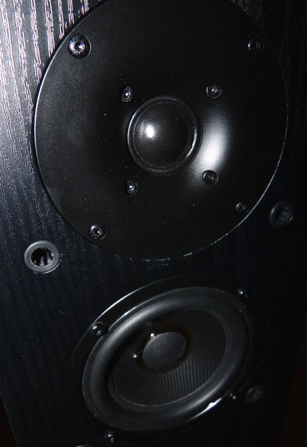

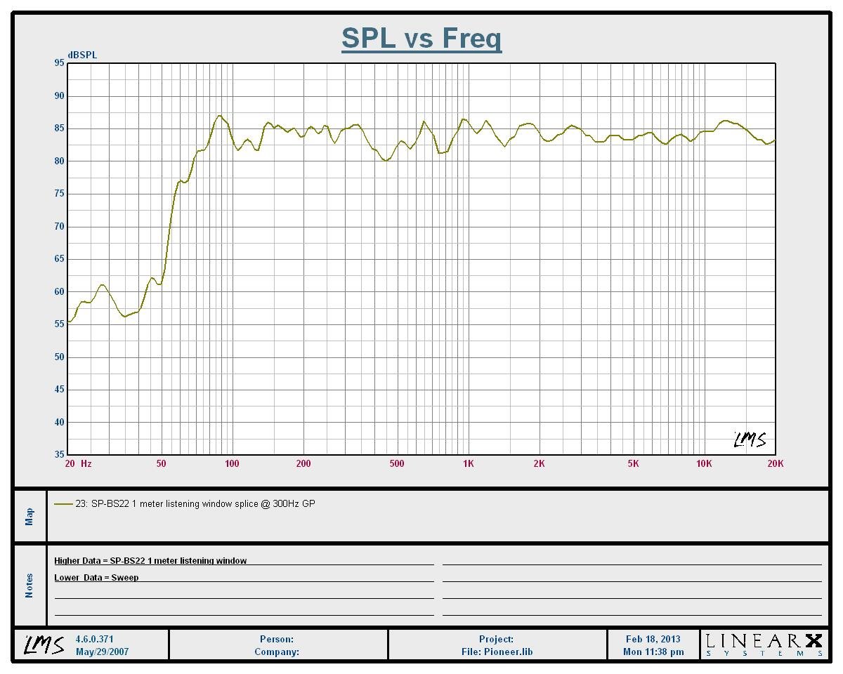

SP-BS22-LR Bookshelf (MSRP: $129/pr)
  • 2-way ported speaker
  • 4” Structured Surface Woofer
  • Sophisticated 6-Element Crossover
  • 80 Watt Power Handling
  • Frequency Response: 55Hz to 20kHz
  • Sensitivity (2.83V): 85 dB
  • Impedance: 6 ohms
  • Xover Frequency: 3kHz
  • Dimensions: 12.6” H x 7.1”W x 8.4” D
  • Weight: 9.1 lbs

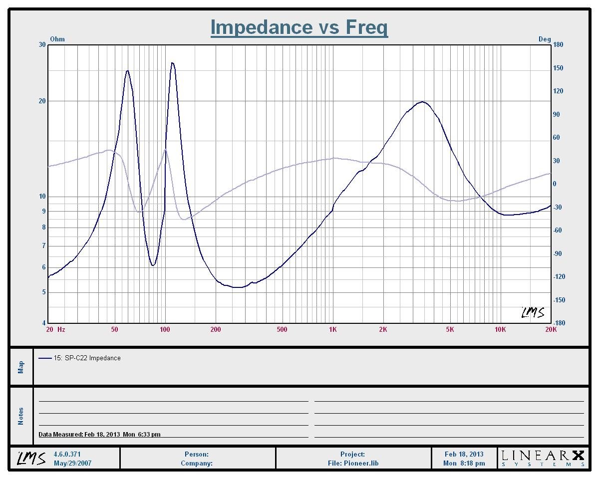

SP-C22 Center (MSRP: $99/ea)
  • Two 4” Structured Surface Woofers
  • 90 Watt Power Handling
  • Sensitivity (2.83V): 88 dB
  • Impedance: 6 ohms
  • Dimensions: 7.1” H x 18.1”W x 8.4” D
  • Weight: 13.4 lbs

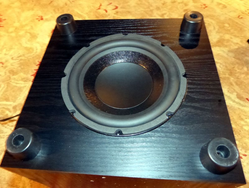

SW-8MK2 Subwoofer  (MSRP: $159)
  • 8” bass driver in ported enclosure
  • 100 watt amplifier (max power)
  • Frequency Response: 38Hz to 150Hz
  • Dimensions 14.2” H x 12.2”W x 12.2” D
  • Weight: 20.2 lbs

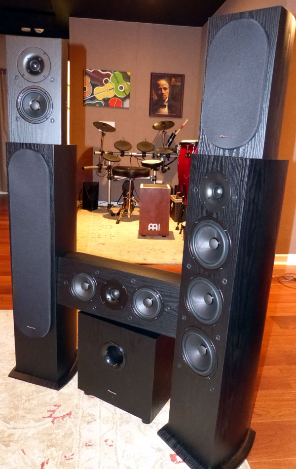

Pioneer SP-PK52FS Introduction

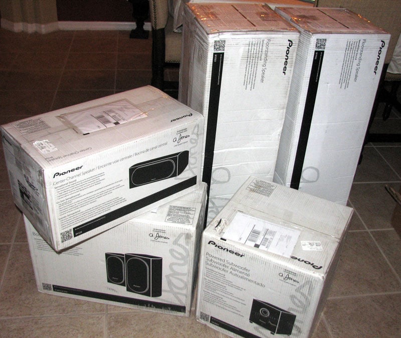

pioneer-box3001.jpgWhat would you say if we told you that a company historically known for their A/V electronics has redefined the loudspeaker market with their budget speaker line designed by industry veteran Andrew Jones?  Now take your amazement one step further when we tell you that for under $550 you get a pair of four driver 2 ½-way tower speakers (SP-FS52), a matching three driver MTM center channel (SP-C22) and pair of two-way bookshelf speakers (SP-BS22-LR) with an 8" 100-watt powered subwoofer (SW-8MK2).  While the model numbers of all of these products are a little ridiculous and difficult to remember, the performance and value certainly isn’t.  In fact the outside markings of the boxes these speakers come wrapped in more product specs, (most of which I was able to validate in my measurements), than you will find on most high end loudspeaker manufacturers websites or literature.  How is it possible that Pioneer can offer such a low cost speaker line packed with so much solid engineering and performance?  Well, you’re gonna have to read the review to find out.

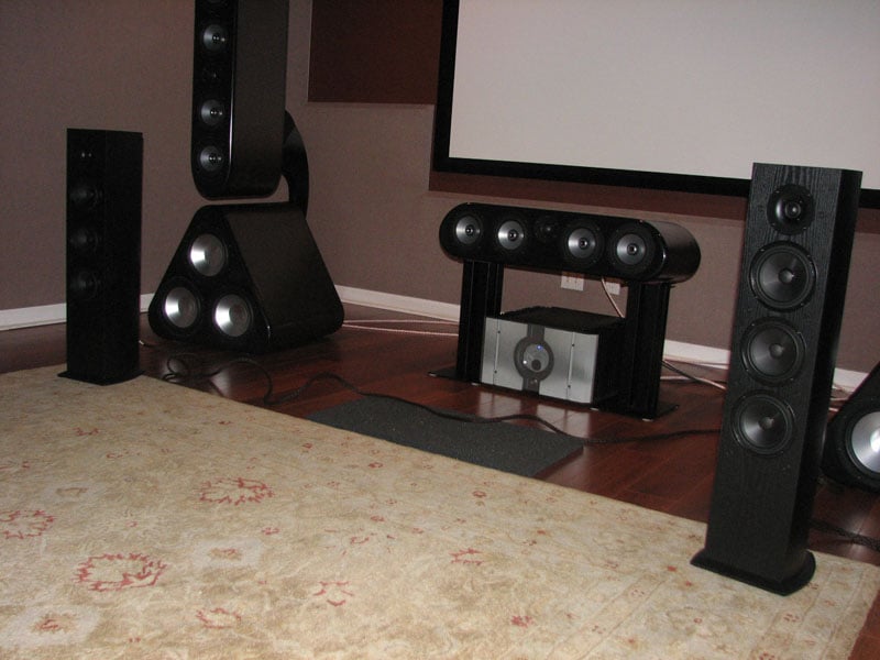

When I saw all the talk about Andrew Jones’ Pioneer speakers on our forum, I must admit I was skeptical.  I didn’t even know who this chap was, let alone why there was such a fuss about their Kmart-priced speaker system.  All of that quickly changed for me last year at CEDIA when I not only got a chance to demo the speakers first hand but also meet the very fellow that designed them.  I threw a few tech questions at Mr. Jones and was greeted not only with good humor but very accurate and well-stated responses.  I also learned that when Andrew worked for KEF he was introduced to Dr. Floyd Toole.  Through the Audio Engineering Society (AES), Andrew met an incredibly rich diversity of respected researchers that promoted great discussion and research ideas, and many of those people became good friends. Floyd was one of those, and it was Floyd that invited him to come to the USA and work at Infinity.  This guy really knows his stuff and I’m impressed enough to often solicit his peer review for our loudspeaker tech articles.  What I was even more impressed with was the demo of this very Pioneer speaker system.  Let’s take a tour to see what’s in these little gems.

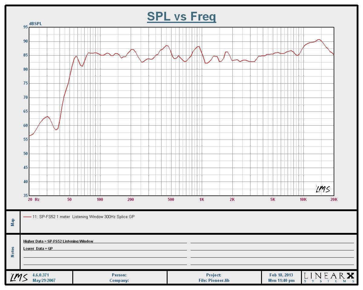

I set up the crossovers to 80Hz for all the Pioneers and 100Hz for the surrounds since the drivers are so small. I'm using the LFE for the SW-8MK2 set at 120Hz (max on my receiver). I've been consuming a mix of streaming video (Netflix, Hulu, etc.), streaming music (Spotify, Apple Music, etc.), and gaming on an XboxOne S. I've been happy with the sound in my semi-open 2600 cu-ft living room.
Recently, I found the AccuEQ mic for my TX-NR646. So I plugged it up to see what results it would produce. It got all my distances spot on. I've measured them myself previously. However, it crossover my towers at 50Hz, center at 70Hz, and surrounds at 90Hz. I immediately thought this was wrong and manually set everything back. Much reading had me convinced that 80Hz was the way to go.
After reading this article it seems that the towers are tuned to 50HZ with the center at 70Hz. So was AccuEQ correct? Should I give it a listen, or stick with 80Hz?
