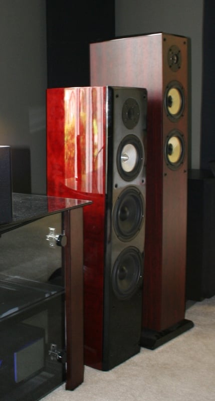

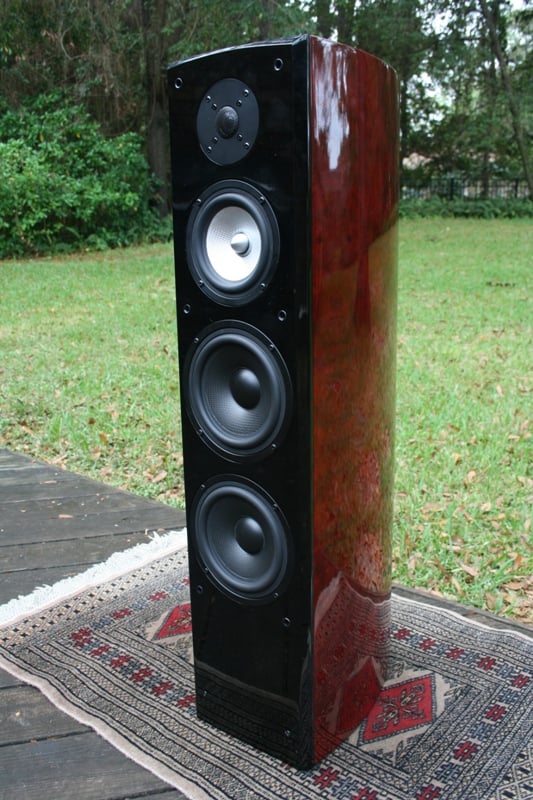

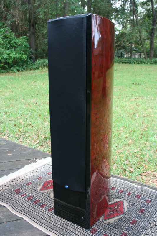

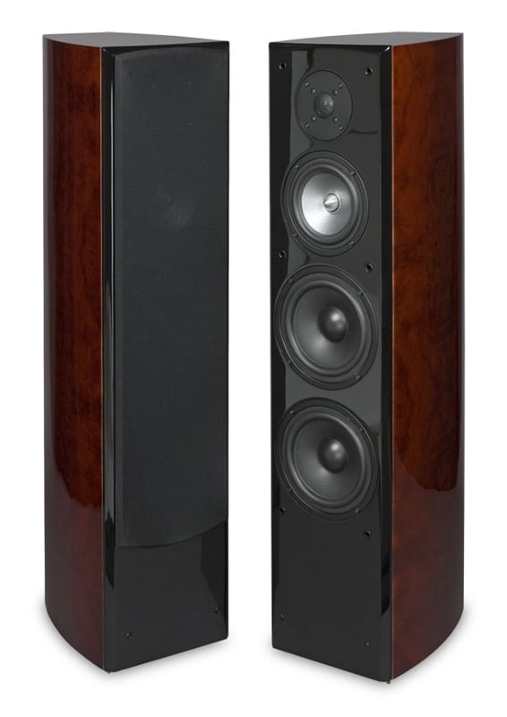

EMP Tek Impression Series E5TiR Floorstanding Loudspeaker
  • Product Name: Impression Series E5TiR
  • Manufacturer: EMP Tek
  • Review Date: October 27, 2009 05:10
  • MSRP: $ 500/pair
  • Buy Now

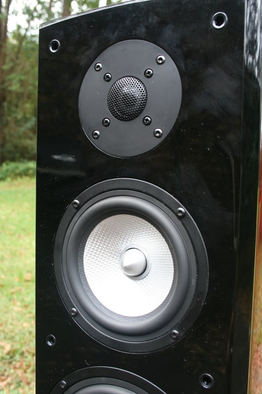

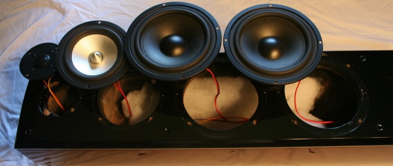

  • Dual 6½ " (203mm) Poly-matrix Woofers
  • 5¼" (133mm) Aluminized Poly-matrix Woofer
  • 1" (25mm) Fabric Dome Tweeter
  • Recommended Power 50-150 Watts

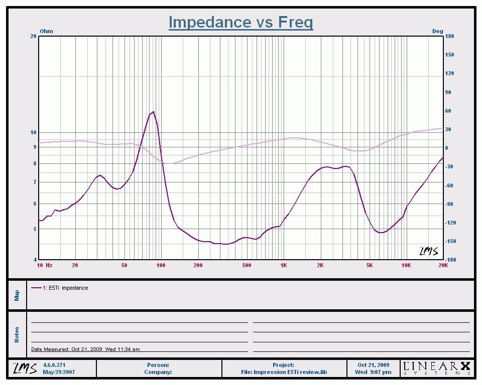

  • Impedance 6 Ohms

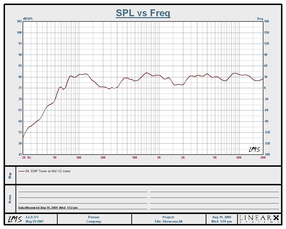

  • Frequency Response 50Hz-20kHz ±3dB
  • Crossover Frequency 120 Hz/ 3,000 Hz
  • Sensitivity 87dB ([email protected])
  • Dimensions 8½" W x 35½" H x 12¼" D (216mm W x 902mm H x 311mm D)
  • Weight 35 lbs. (15.88 kg.)
  • Available in High Gloss Red Burl or Black Wood
  • PRICE!!!!!!
  • Aesthetics
  • Performance
  • At this price point I'd be a fool to complain about much but…

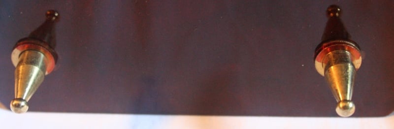

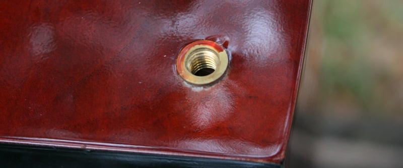

  • Unstable (needs better footing options including something for hardwood/tile)

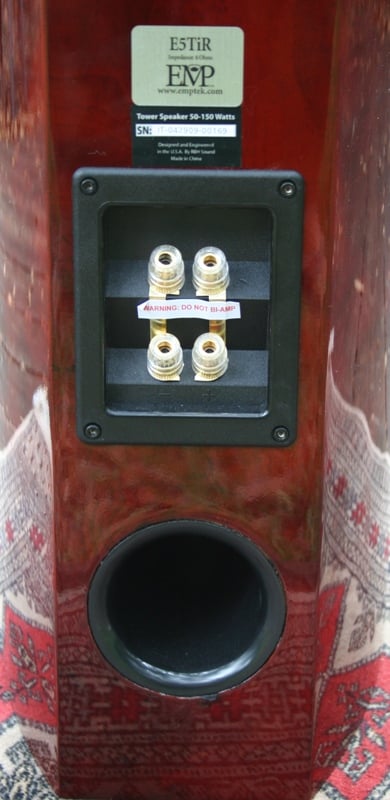

  • Dual pairs of binding posts invites damage

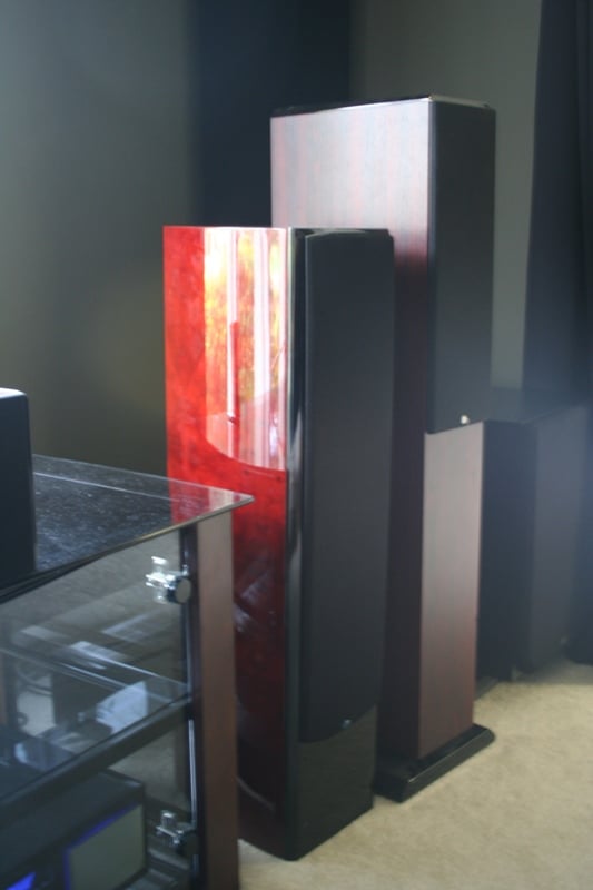

  • Height challenged
Introduction
By now, you've probably heard of the EMP Impression Series E5Ti speakers, they are the ones going for the incredibly low asking price of $500 a pair when on special sale. There must be something wrong with them, right? That's what our reviewer thought at first too. But after hearing the E5Ti speakers, his mind wasn't just changed, it was blown. The E5Ti's managed to produce a very natural soundstage with articulate midrange, and silky smooth highs. They played down low enough to mate well with a good musical sub such as their own ES10i. This is a tough combo to beat at such a modest asking price especially when factoring in their free 30 day home trial and shipping both ways.

I don't see quite the detailed specs on that receiver I'd like to confidently say one way or another, but it looks like it's putting out 85watts per channel, unfortunately with unknown distortion. Sort of a toss up for me, but I'd say you might have trouble powering them…mixing 6 and 8 ohms is no problem, but I'd like to see more info on the 6ohm power ratings from that yamaha before passing judgement.
Best I can say is if you have the owners manual and it states it handles a 6ohm load ok then hook them up and see how they sound to you! If you notice any clipping or distortion at the levels you'll be using them at then you'll likely want to look into selling the yamaha and purchasing a new receiver, perhaps a refurb from accessories4less for $300 or so.

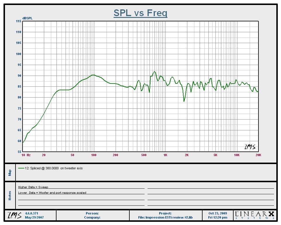

The importance of anechoic chambers for testing loudspeakers is highly over stated and lately used as a marketing ploy by many companies claiming their products are better for that very reason.
A good loudspeaker engineer knows how to properly measure their speakers without one.
That being said, I wish I had access to one as it would make measuring so much easier.
The best way to measure subs is still groundplane and on a pole assuming good weather conditions.
Even with anechoic chambers, manufacturers are at liberty to spec their speakers anyway they like. There is no set standard so don't let a smooth anechoic response fool you. At what power level did they take those measurements? What about distortion?
LMS does a horrible job measuring distortion and I almost never see loudspeaker companies disclose distortion with any other testing method.

I think all the comments simply display the fact that there is no regulation behind such specifications and different manufacturer's use different methods of measuring and estimating actual responses; the problem is that they are all compared by most consumer as equally tested.
For JL, you're right in that you didn't mention that most companies use an anechoic chamber, but the mere handful mentioned are a minisclue propotion to the hundreds of speaker brands on the market now (even though there are many others who properly measure responses too). I can't see companies using proper chamber measurements for low end products but perhaps in thier higher end models where the R&D costs are realistically recovered. I don't believe that an Energy product sold in a bog box store for 20 points margin (tops) is going to have such definitive testing.

An anechoic chamber is able to do more thorough testing as compared to using time gated random noise/MLSS measurements. Things that are possible in an anechoic chamber that can not be done otherwise: (1) full-range frequency response, mid or far field, without splicing multiple measurements(which leads to errors). (2) Resonance/energy decay analysis of the speaker at mid and far field distances at frequencies under roughly 1,000 Hz.
