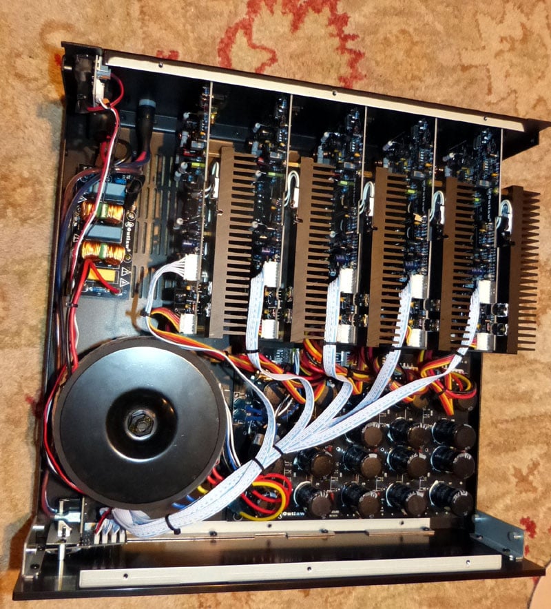

The Model 5000 has a massive power supply for an amp of its price class.
The Model 5000 is a traditional Class AB amplifier design with four output devices per channel in a mono-block configuration fed from a large centralized toroidal power supply that appears to be at least 1kVA rated.  Each channel also has its own power supply capacitor bank made up of four loosely spaced 6,800uF capacitors.  The user manual for the Model 5000 claims a total of 27,200uF of power supply capacitance per channel but it’s a bit misleading since upon closer inspection I found the capacitors were only 50V rated which means they had to be wired in series-parallel to handle the voltage necessary to deliver the rated 120 watts/channel.  Thus the equivalent capacitance per channel is actually only 6,800uF.  Outlaw updated their website to now state four 6,800uF capacitors/channel.  I suppose that’s a little more “honest” but it still doesn’t give you the actual effective channel capacitance.  We’ve seen this before on some of Emotiva’s older amplifiers and called them out on it in each review so we feel it’s only fair to do the same with Outlaw.  Suffice it to say, the Model 5000 has a massive power supply for an amplifier of its price class.  I am just picking nits here.  Moving on.
Editorial Note on Power Supply Capacitors
You often hear manufacturers boast how much power supply capacitance their amplifiers have but what is their purpose?  Power capacitors serve two purposes actually. They store energy to prevent rail sag during dynamic peaks to help maintain a steady, consistent output and they also help reduce rail voltage ripple.  The amount of capacitance needed depends on just how stiff or robust of a power supply you want to design for your amp.

So if an amplifier rated at 150wpc would produce about 6 amps peak current and assuming a rail voltage of 70V should have 7,000uF to maintain 10% ripple. Based on this calculation I’d say the Model 5000 has at least met the bare minimum requirement.  Higher end products with tighter specs will of course use more power supply capacitance to maintain a tighter ripple.

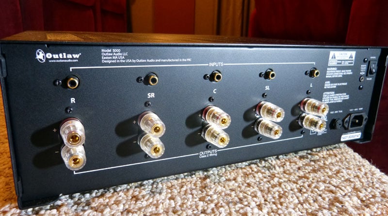

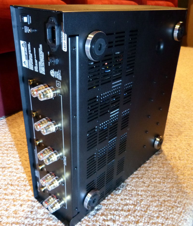

The Model 5000 is equipped with a 12Vdc trigger, detachable 3-prong 14AWG power cord though it doesn’t utilize earth ground.  There is also a mains power switch on the back panel.  Interestingly, the silkscreen on the backpanel of the Model 5000 says it’s designed in the USA by Outlaw but manufactured in the PRC.  PRC is just a coy way of not saying made in China but it means People’s Republic of China.  The speaker terminals are high quality gold plated binding posts but the unit only has unbalanced inputs, which is not a surprise at this price point.  Per my request from my test bench findings, Outlaw Audio will be adding a grounding screw for those that wish to tie all chassis grounds together in their systems to solve any potential ground loops.
Outlaw Model 5000 Backpanel View

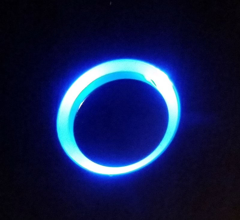

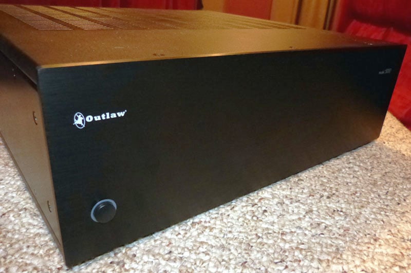

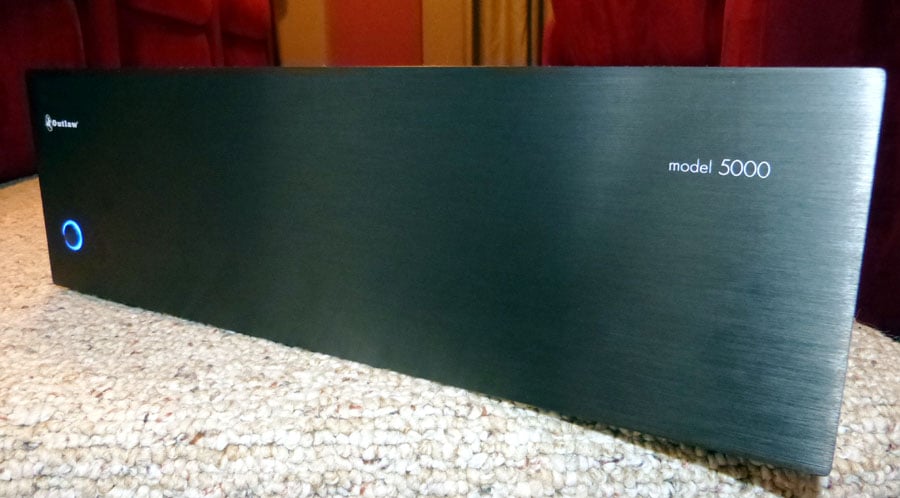

Though the Model 5000 is a bit pedestrian looking, the chassis itself is thicker and sturdier than your typical run of the mill receiver.  The blue LED front panel button adds a nice touch of panache to the unit while also serving to let you know when it’s powered up and ready for business.  It’s also meant to be an aesthetic match to their Model 975 AV Processor.
Outlaw Model 5000 Front panel LED Power Button
