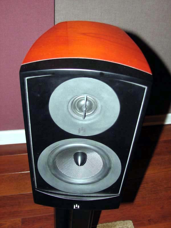

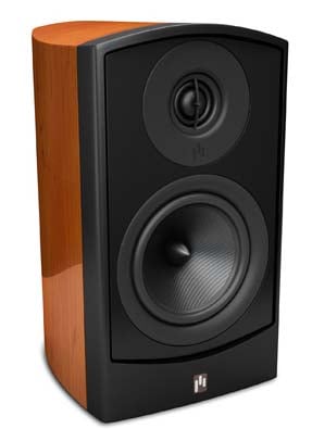

The Aperion Audio Verus Grand Bookshelf cabinet is crafted like a fine piece of furniture. From the radiused edges, to the contour shape of the box, this is not your typical boxy cabinet. Instead, the Verus bookshelf bestows a much more elegant appearance. The magnetic grille sits flush mounted against the cabinet, making the whole design fluid in appearance.
Aperion Audio products are offered in two finishes: high gloss black and cherry. We had cherry for our review samples. Just like I found with the Intimus products, the cabinetry of these babies is among the best I’ve seen regardless of price. There are no seams to be found anywhere on the cabinet as the veneer wrap seems to flow as one piece. Aperion Audio truly lives up to the furniture grade finish that they tout.
Popping the grille off, you're greeted with more silky smooth craftsmanship not apparent in many competitor designs at this price point. The drive units are all recessed into the baffle to minimize diffraction and dress up its appearance. No visible screws are seen on the front baffle thanks to the integrated ring flange that is glued over the driver baskets. These speakers sound good just looking at them, especially when parked near a traditional boxy looking competitor.

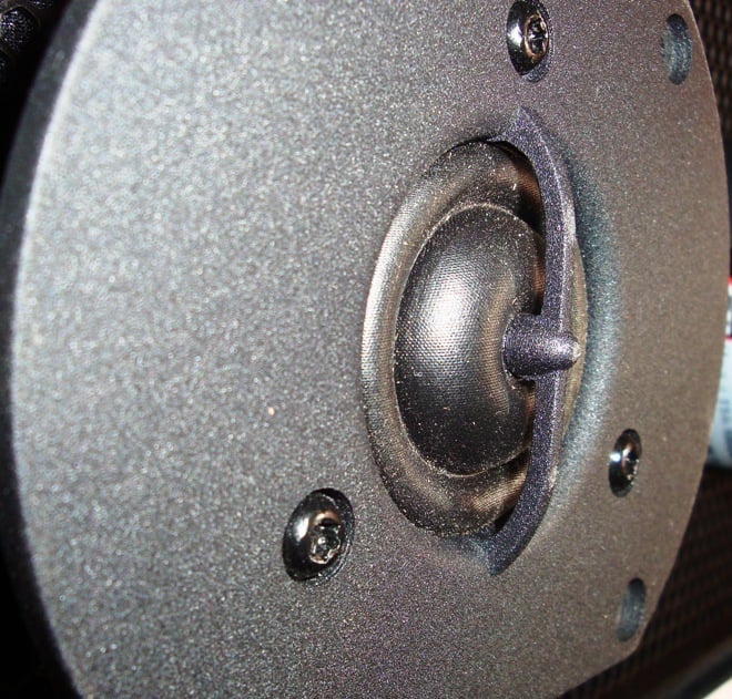

The 1" axially stabilized Verus tweeter has a very low resonant frequency (Fs) in the ballpark of 550Hz, which allows it to play down lower with less distortion than conventional designs. It's quite an expense to make a tweeter like this as it involves a more elaborate motor structure such as rear vented chamber. The main design benefit of the ASR is that it keeps the diaphragm from rocking, thus reducing distortion in the tweeter’s lower operating range.

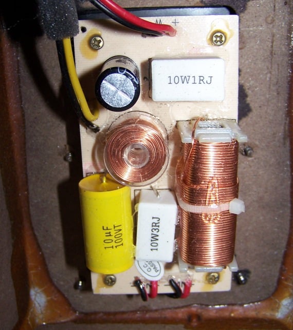

The crossover is mounted to the back of the cabinet and utilizes high tolerance ceramic resistors, an air core and polypropylene capacitor in the critical high frequency circuits and an iron core choke and electrolytic capacitor for the woofer section. The Verus Bookshelf speakers are crossed over (1.2kHz 2nd order electrical, 3rd order acoustical) a bit lower than we normally see in two-way bookshelf speakers mostly because most tweeters can't effectively play low enough to achieve the benefits offered by such a low crossover point. Having a lower crossover allows the system to create a smoother, more natural off-axis roll off which is prevalent in our measurements as you will see later in the review.
Aperion Audio Verus Grand Bookshelf Crossover

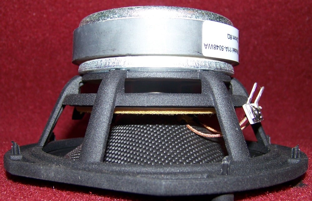

The Aperion Verus 5" woofer utilizes a true phase plug driver which serves 3 purposes:
- reduce cone mass
- reduce on-axis beaming
- vent the voice coil
The phase plug further reduces cone mass by physically having no dust cap. It also further reduces on-axis beaming, allowing the woofer to extend the response to higher frequencies and offer improved dispersion characteristics. The downside to using a phase plug driver in such a small woofer is the reduced cone area also means reduced efficiency at bass frequencies. It also creates a pressure release and leak in the center of the woofer. This can cause a chuffing noise when driven with percussive instruments at high output levels by allowing voice coil air gap turbulence to be heard directly. These trade-offs become a wash when mating these speakers with a powered subwoofer, which is what I would recommend in almost all applications if space and budget permits.
Aperion Audio Verus Tweeter (left pic); Woofer (right pic)
To further increase heat dissipation, the Aperion Verus woofer employees a vented pole piece and a cast basket. This is an expensive measure compared to stamped baskets found on many of their competitor products, but it allows for the system to play at higher output levels with less distortion. Many of the best loudspeakers on the market share similar design characteristics to what we are seeing here in the Aperion Verus speaker system, only the competitor products tend to be much costlier.

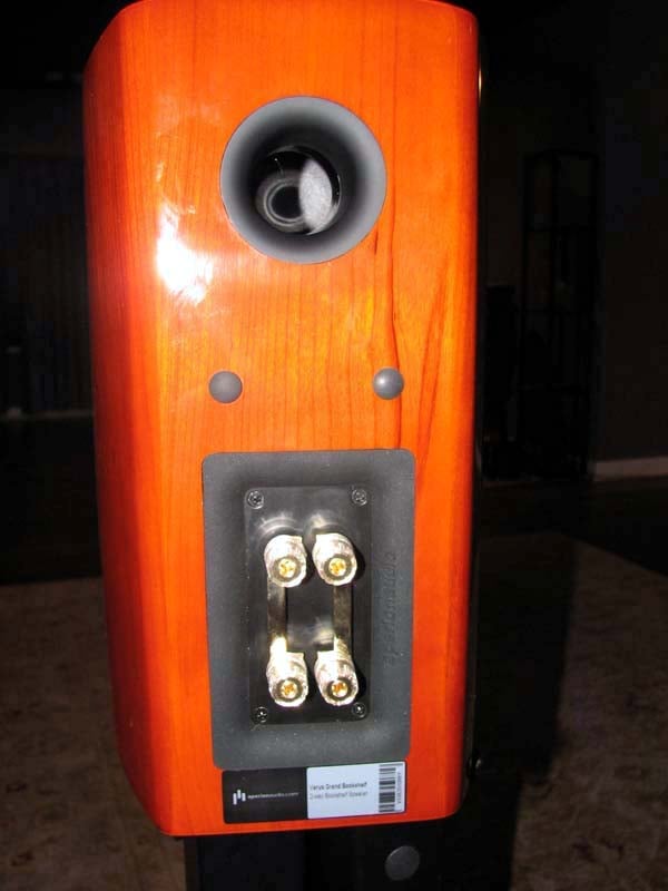

The Aperion Audio Verus Grand bookshelf speaker is just as appealing from the rear as it is from the front. The rear port is flared on both ends and the speaker terminal cup is constructed of very high quality plastic. I'm uncertain of the cabinet thickness, since I couldn't physically get inside the box to examine it. However the lower priced Intimus 5B was constructed of 1" thick HDF and the Verus bookshelf feels even more inert. Tapping all around the cabinet produced a consistently deadening thud sound. If you look closely inside the port, you can see the rear tweeter chamber staring back at you.

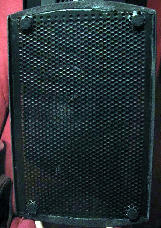

The grille is constructed of rigid sheet metal instead of flimsy plastic that you usually find in products of this price class. The grill cloth is a very tightly woven mesh to help minimize losses.
The plastic molded terminal cup is a thing of beauty. Flanked by 4 sets of high quality 5-way gold plated binding posts, the Verus Grand bookshelf can be bi-wired or bi-amped. The speaker comes with gold plated jumpers installed for single amp connection which is how the majority of users will use these speakers.
There are two milled holes below the port which is compatible with the Omni wall mounts they sell on their website as an accessory for this speaker. This comes in quite handy for mounting it as a surround speaker.

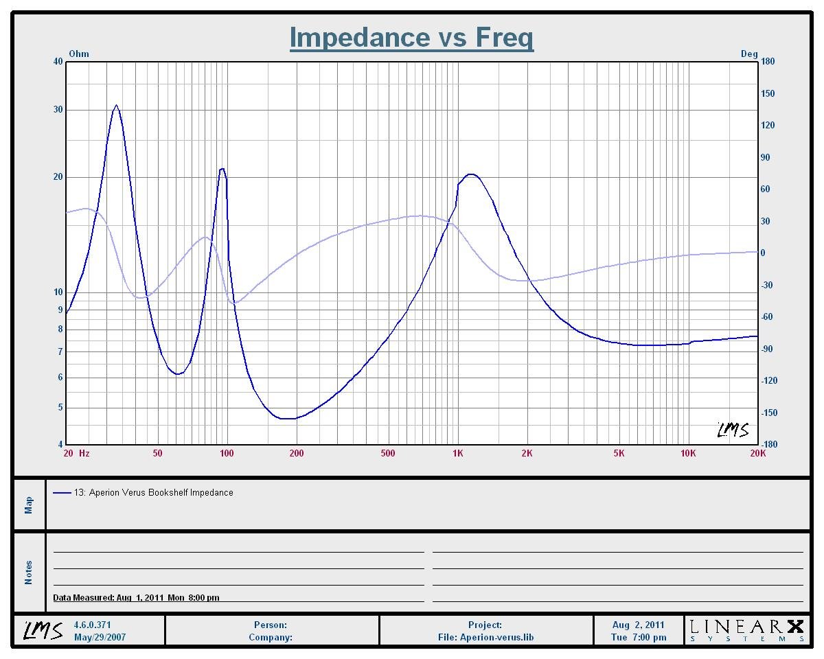

Impedance / Phase Measurements of the Aperion Verus Grand Bookshelf
The Aperion Audio Grand Bookshelf speakers appear to be tuned into the 60Hz region as indicated by the saddle point in the impedance graph. They dip slightly below 5 ohms in the 150-200Hz range but maintain a high impedance at 20Hz and above 5kHz. The 6 ohm rating that Aperion gives these speakers seems very reasonable to me. These speakers staying within a +-30 degrees phase for the entire audio bandwidth shows Aperion spent some time designing the crossover to not only integrate the drivers well but to ensure the speaker system plays nice with all amplifiers. You don’t need an esoteric amp to run these speakers as any decent modern AVR will run them just fine. Aperion rates these speakers at 87dB sensitive but that is a 2.83V measurement, not 1 watt. The 1 watt sensitivity is more like 85-86dB which is what I measured.

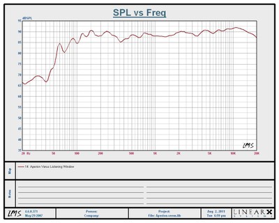

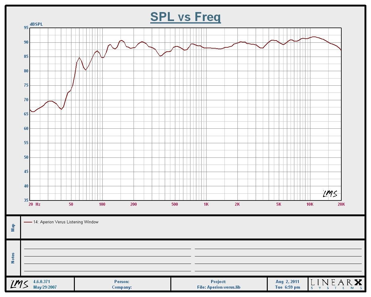

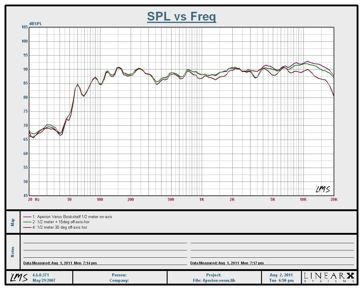

In-room 1/2 meter SPL vs Frequency Aperion Verus Grand Bookshelf Listening Window
I measured the Aperion Audio Verus Grand Bookshelf speaker in-room at 1/2 meter with the microphone located at the acoustical center of the speaker which was stand mounted in 32" stands. For these measurements, the grille cover was removed. I took an on-axis measurement and averaged it with two horizontal measurements (+-15 degrees off axis) and two vertical measurements (+-15 degrees off axis). No smoothing was used. As you can see the speaker exhibited no off axis nasties and measured extremely linear in the critical midrange region all the way to the frequency extremes. This is an NRC's fantasy speaker measurement which is interesting considering Aperion Audio doesn’t necessarily design to NRC gospel, nor do they feel it necessary to design a loudspeaker in an anechoic chamber.
In-room
1/2 meter SPL vs Frequency Aperion Verus Grand Bookshelf (1/12th
octave smoothed)
purple
trace: on-axis; green trace: 15 deg
off-axis; purple trace: 30 deg off-axis

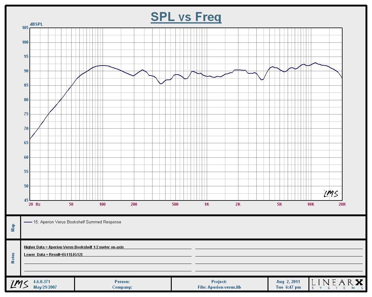

Here are some off-axis measurements for the Aperion Verus bookshelf speaker. Again this speaker measured so linearly it was like I captured the measurements in an anechoic chamber. Notice how the top end response isn't over done with these speakers. Aperion's design goal was neutrality and it really shows in these measurements. I can't tell you how many speakers we've measured in the past that boasted they make neutral speakers while we measured +5-10dB too much gain in the tweeter or a too heavy bottom end because of a poorly tuned bass alignment. This was obviously not the case here.
Summed Nearfield Response of Aperion Verus Grand Bookshelf

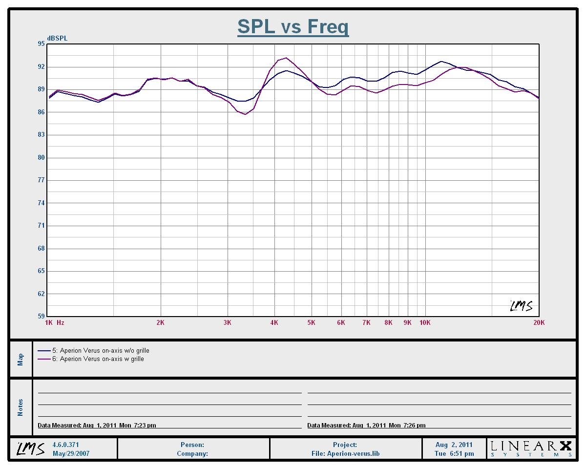

trace: no grille ; purple trace: with grille
There is definitely some loss associated with the grille cover (no surprise there). I was a bit vexed to see up to 2dB loss in the upper midrange area however. This wiggle in the 3 to 4 kHz region is caused by reflections from the step where the baffle transitions to the area outside the grill. I found this most predominant on-axis. It's not a huge deal, especially since all speakers exhibit some losses with the grille covers on. Some manufacturers even boost the high frequencies to compensate. Personally, I found the Aperion's sounded best with the grilles off and I recommend using them that way if small children and pets aren't a concern.
