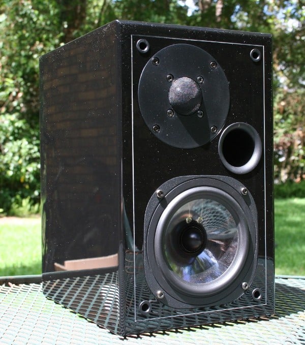

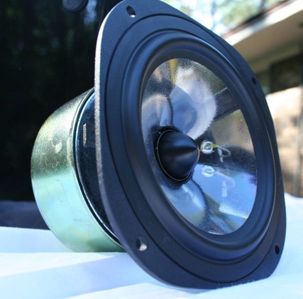

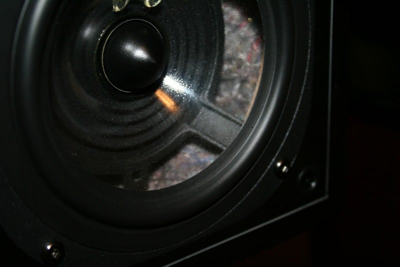

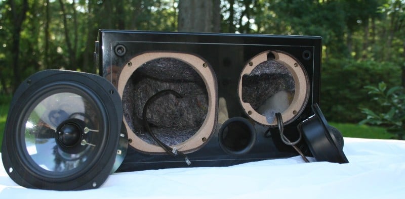

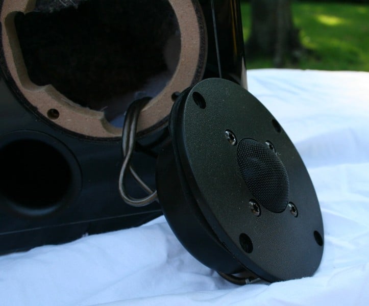

2-way system                                tweeter 1" (UA025-10), mid-bass 5" (KSW2-5029B)
Sensitivity                                     86 dB @ 1 watt / 1m
Nominal impedance                     8 ohms
Frequency response (-3 dB)          52 Hz ~ 20 kHz
Power handling                            50-125 watts

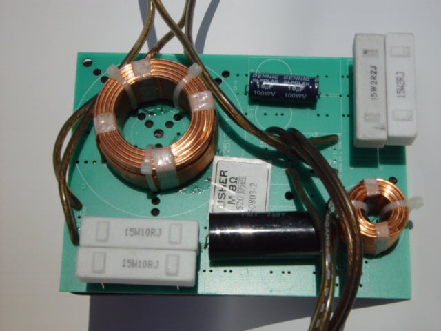

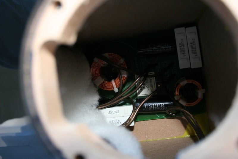

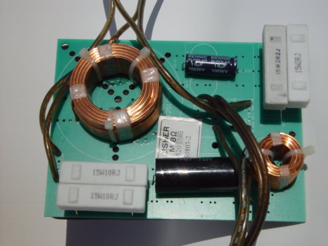

Crossover frequencies                  2 kHz
Weight                                          15 lbs
Dimensions (w x d x h)                 7.09" x 10.43" x 11.81"
Shipping weight                           32 lbs
Shipping box (w x d x h)              17.9" x 13.0" x 15.0"
Finishes           Piano Black, Pearl White, Ferrari Red, Gloss Yellow, Birch

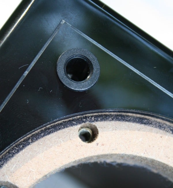

  • Extremely detailed
  • Incredible build quality
  • Fully shielded
  • Rock bottom price
  • Unforgiving of poorly recorded music
  • A bit bright
  • Tendency to bottom out with bass heavy music at high SPL levels
