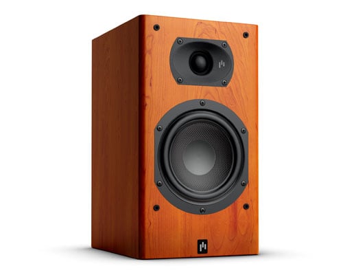

The Intimus 5B is a pretty standard bass reflex (ported) design boasting a 5 ¼” woofer and 1” tweeter. The drivers are recessed into the front baffle as they should be. You would be surprised to know that even some of the more prestigious brands today don’t take this measure to reduce unwanted diffraction between the driver faceplates and cabinet surface.
The 5B is
rear ported and sports a single pair of 5 way binding posts. The enclosure is constructed of 1” high
density fiber board (HDF) which is unusually thick and high quality for such a
budget priced speaker. The sheer thickness
of this relatively small enclosure self braces itself virtually eliminating all
major cabinet resonances and producing a consistently deadening thud sound when
knocked on any surface.
Aperion Audio products are offered in two finishes: high gloss black and cherry. I chose cherry for my review samples. The cabinetry of these babies is among the best I’ve seen regardless of price. There are no seams to be found anywhere on the cabinet as the veneer wrap seems to flow as one piece. Aperion Audio states that their products feature a furniture grade finish. I don’t doubt this one bit. If you take a moment and really examine these speakers, you will find that they paid meticulous detail to fit and finish. Even the grill is constructed of finished wood instead of flimsy plastic that you usually find in products of this price class. The grill cloth is a very tightly woven mesh which again is something we rarely find in budget type products.

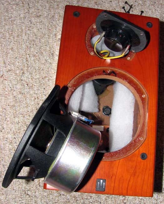

The Drivers
The 5 ¼” woofer is
magnetically shielded and sports a woven fiber cone with butyl rubber surrounds
and a cast aluminium basket. The
faceplate of the woofer basket is flatted on both sides which is done purposely
to allow the design engineer to place it closer to the tweeter for better
crossover integration. Aperion Audio
missed that subtlety and unfortunately oriented the woofer 90 degrees likely
for aesthetic purposes.
The tweeter is a 1” silk dome with neodymium magnet. Normally I am not a big fan of these type of motor structures simply because they tend not to have a low enough free air resonance to allow them to extend down in frequency for proper blending with a woofer. They usually tend to thermally saturate quicker than standard ferrite magnet motor structures when played loudly as well. I didn’t find this to be the case with these speakers, and it quickly became obvious to me that the little Aperion tweeter was quite a performer. It is a low profile design that utilizes a waveguide to control dispersion. Again it’s a shame that Aperion didn’t take advantage of bringing the drivers closer together since that is a big advantage a tweeter like this has over a conventional one with a much larger motor structure.

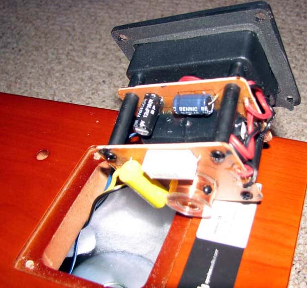

The Crossover
The 5B
crossover is affixed to the speaker terminal and is split up into two separate
circuit boards. The bottom circuit board
features the woofer's low pass filter (LPF) consisting of an iron core inductor
and two 100V electrolytic capacitors which I’d guess is configured as a 2nd
order filter. The second circuit board
features the tweeter's high pass filter (HPF) which again appears to be a 2nd
order design like the LPF but features a higher quality air core inductor and
polypropylene capacitor. Personally I
would have preferred higher quality parts in the
woofer section, here but they seemed to serve their function well from my
listening tests and they didn't skimp on the capacitor in series with the tweeter which is most critical for audibility.
Aperion Audio 5B Drivers (left pic) ; Crossovers (middle pic); backview (right pic)

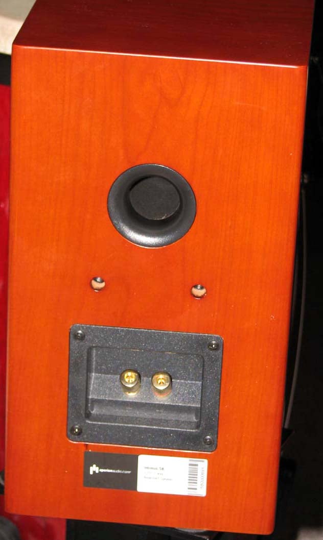

The Backside
The Intimus 5B is rear ported directly behind the
tweeter with the exit chamber of the port flared on both sides. There are two milled holes below the port
which is compatible with the B-tech
mounting bracket they sell on their website as an accessory for this speaker. This comes in quite handy for mounting as a
surround speaker. I didn’t test these
brackets but I’ve had excellent success with B-tech products in the past so I’d
expect no different here. The 5-way
binding posts are gold plated and recessed into the plastic terminal cup.

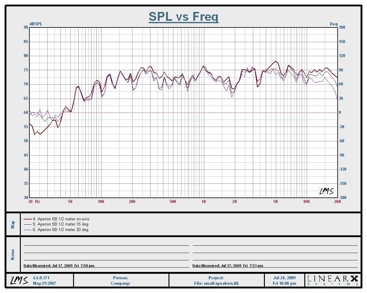

Intimus 5B Measurements & Analysis

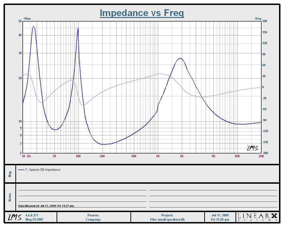

Impedance / Phase Measurements of the Aperion Intimus 5B

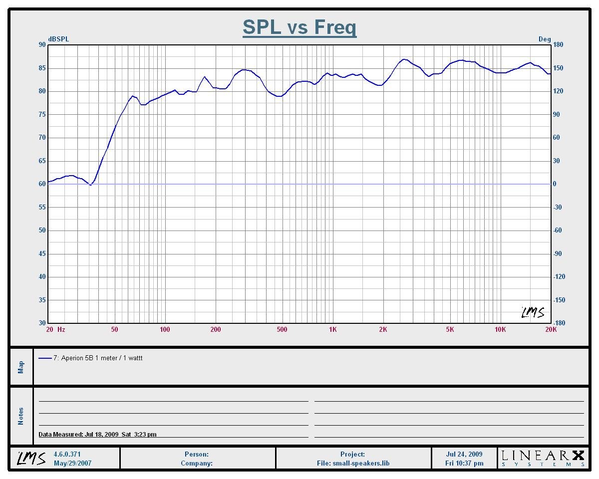

The Aperion Audio 5B speakers appear to be tuned into the 50Hz region as indicated by the saddle point in the impedance graph. This explains why these speakers were prone to bottoming at high SPL levels when playing bass heavy music. There is an impedance minima of around 7 ohms in the 200Hz range and phase stays within +-30 degrees for the entire audio band. Although these speakers aren’t very efficient, they are an easy load for any modestly powered receiver to drive.
In-room 1 meter SPL vs Frequency Aperion Intimus 5B (1/3rd octave smoothed)
At 1 meter, I measured around 84dB sensitivity which is what Aperion Audio claims for this product. It’s a bit on the low side for a speaker of this size. I’d be curious to see if they could have improved system efficiency response by using a lower mass cone material for the woofer and tuning the system a bit higher. The system appears to start rolling off around 70Hz with a sharp rolloff of around 18dB/octave below 50Hz. Given the box size and driver used in this system, there really is no good reason to not roll these speakers off at 80Hz and recommend using them in concert with a subwoofer to increase dynamic range and usable bass extension.
In-room 1/2 meter SPL
vs Frequency Aperion Intimus 5B (1/12rd octave smoothed)
Brown trace: on-axis; blue trace: 15 deg off-axis; pink trace: 30 deg off-axis
The Intimus 5B’s measured quite linearly, measuring +-5dB from 70Hz to 20kHz in-room. I did notice a slight dip around 2kHz at the crossover region which probably could have been improved slightly by bringing the drivers closer together and tweaking the crossover design a bit. The tweeter level appears to be a dB or two elevated compared to the woofer which can at times lead to a more forward top end sound but not overly bright since the tweeter employed here is quite good.
