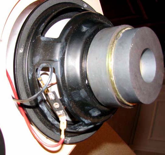

The Drivers![driver.jpg](driver.jpg/image_mini)
The 6 1/2 inch aluminium cone woofer is the same stamped basket design borrowed from their box speakers, namely the M3s. In fact, this speaker system is the equivalent model to that with the exception to the cabinet material which is a weather resistant plastic instead of MDF. The Axiom woofer is surprisingly semi shielded in that it has the bucking magnet added but its not encased in an steel can. This should be fine for anyone placing the speaker in close proximity to a CRT-type display.
Again Axiom uses the same 1 inch Titanium dome tweeter found on their boxed speakers. This is a good driver and Axiom's secret recipe for why their speakers sound so articulate and detailed. It’s definitely one of the better budgeted metal domes I've heard, sharing many of the sonic virtues of some of my favorite metal domes found from the likes of Canton and NHT. It doesn't suffer from what some loudspeaker engineers refer to as Asian Metal Dome Syndrome (AMDS) that so many metal domes do where you can hear harmonic break up in the mid frequencies especially when running test tones through them. Axiom does a great job ensuring tight tolerances on their drivers so they consistently perform as expected while minimizing these sonic nasties.

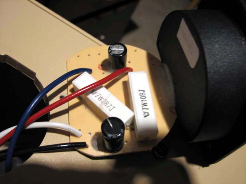

Crossover![xover2.jpg](xover2.jpg/image_mini)
I was surprised to see such a basic crossover design void of any filter network on the bass driver and utilizing electrolytic capacitors in series with the tweeter. This is something I'd expect to see in a pair of $100 Walmart speakers, not a pair of high end speakers costing much more.
It's not necessarily always a bad thing to not have a filter element on the woofer, especially since it can increase efficiency. But, in a two-way system design utilizing stiff metal cone drivers, it's usually a good idea to have a series inductive element to minimize the audible effects of the woofer's breakup mode, especially when played at loud volumes. I initially thought the woofer had a series RC zobel network in parallel but Axiom later informed me there is no filter network at all on the woofer and all four crossover elements (2 resistors and 2 capacitors) are for the tweeter. The tweeter employs a first order network which doesn't do the greatest job at minimizing distortion at lower frequencies when played at loud levels. Although the system as a whole performed admirably, I couldn't help but wonder how much further they could have pushed the envelope of performance by employing higher quality parts and a more carefully executed crossover design. Personally I'd rather see Axiom dump the shielding magnet and upgrade the capacitors to 5% polypropylene if not for the sonic improvement as much as for longevity.

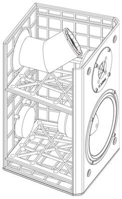

The Cabinet![OutdoorSpeakerCrossCut2.jpg](OutdoorSpeakerCrossCut2.jpg/image_mini)
The Algonquin cabinet is constructed of a special UV coated plastic with an integrated angled screen port for maximum bass extension. It has cabinet brace around the middle of the cabinet and is insulated with cotton fill in the lower cavity where the woofer resides. The crossover is mounted to the terminal cup and has no protective casing over the electronics. Although Axiom claims these speakers are fully weatherproof and waterproof, I beg to differ on their definition of what that means. In Florida where it rains pretty much daily during the summertime, I'd hate to see what happens if someone mounts these speakers in an open area and gets hit with a fierce storm of blowing rain-filled wind. My definition of waterproof is a speaker that can be submerged in a pool for a week and still play after you take it out. There are very few speakers on the market that can do this, so I categorize all others such as these as weather "resistant". My advice here is to place them under a covered lanai.
The finish on the cabinet was very clean and I loved the metal grill. My only complaint here is I wished the cabinet had been constructed of slightly thicker or more inert plastic so as to not sound so hollow when knocking on the sidewall. I realize I am nitpicking here, especially since this product is so reasonably priced but I wouldn’t be an Audioholic if I didn’t criticize every product I bring under review, no matter how much I liked it.

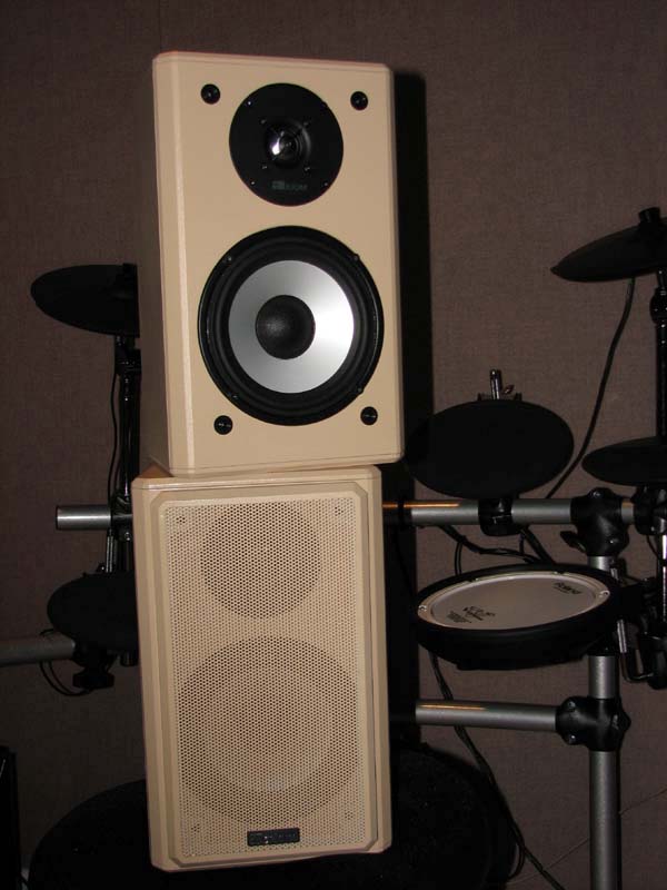

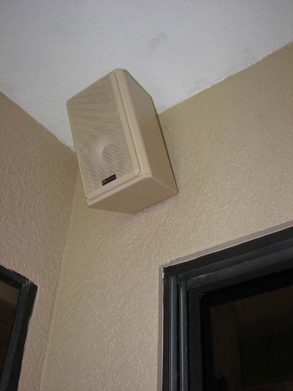

Set-Up & Installation![front.jpg](front.jpg/image_mini)
I placed the Algonquins on my 30" sand-filled Plateau speaker stands which put the tweeters right at about ear level on my Continental theater seats. The speakers were positioned about 5ft from side and back walls and spread apart about 10ft from each other which was roughly the distance from my primary listening position. After experimenting, I found they sounded their best with no toe-in. I used the Emotiva RPA-1 stereo power amp connected to my Denon AVR-5805 receiver, the Denon DVD-5910CI as the source and all Impact Acoustics Sonicwave series speaker cables and interconnects. I also had a pair of RBH Sound MC-6C bookshelf speakers on hand for reference as well as the Klipsch AW-525 outdoor speakers.

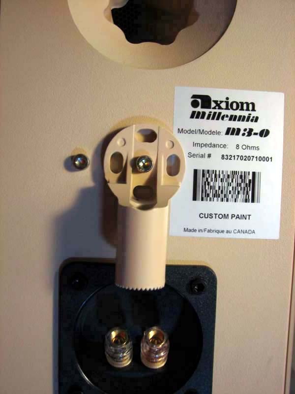

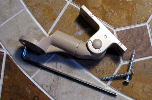

Full Metal Brackets
Mounting the Algonquins was a pretty easy chore. All of the hardware is supplied with the Full Metal Brackets except the hex bolts which are already inserted into the back of the speakers. Basically the first step is to dismantle the full metal bracket into three pieces by removing the hex bolts.
Next install the speaker mount into the speaker after you remove the supplied hex bolt from the actual speakers. But, don't get flapped up on the instructions as I did when the actual speakers have two hex bolts and the instructions only show one. Use the center bolt for the full metal bracket and the offset bolt for the ceiling bracket. I wish they would have spaced the two holes out just a tiny bit more so I could have mounted both hex bolts into the cabinet. I had to add a washer to the one hex bolt since none were supplied despite they were depicted in the installation manual. I found the speaker flexed too much under pressure, thus loosening the bolt without it. Next it was time to screw the bracket into the wall. In my case I opted to use tapcons instead of the supplied wood screws since I was mounting them onto a concrete wall. The final step is a bit tricky as you have to reassemble the bracket with the speaker attached. This is definitely a two-handed job, so use caution not to drop the speaker and double check that the hex bolts are fully secured before letting go of the speakers. Although the full metal bracket system is a bit costly ($80/pair), it's one of the only solutions on the market that I know of that gives you full horizontal and vertical pivot control. This is particularly useful in my situation where my speakers are mounted up towards the ceiling and I wish to angle them down towards the listening area. Axiom has also informed me they will be releasing a more cost effective dedicated outdoor bracket system this spring.

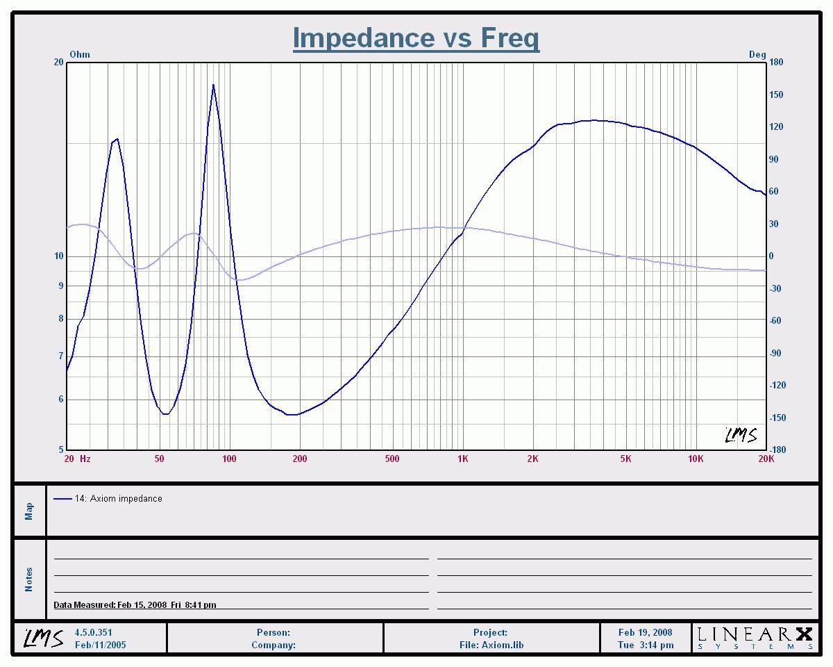

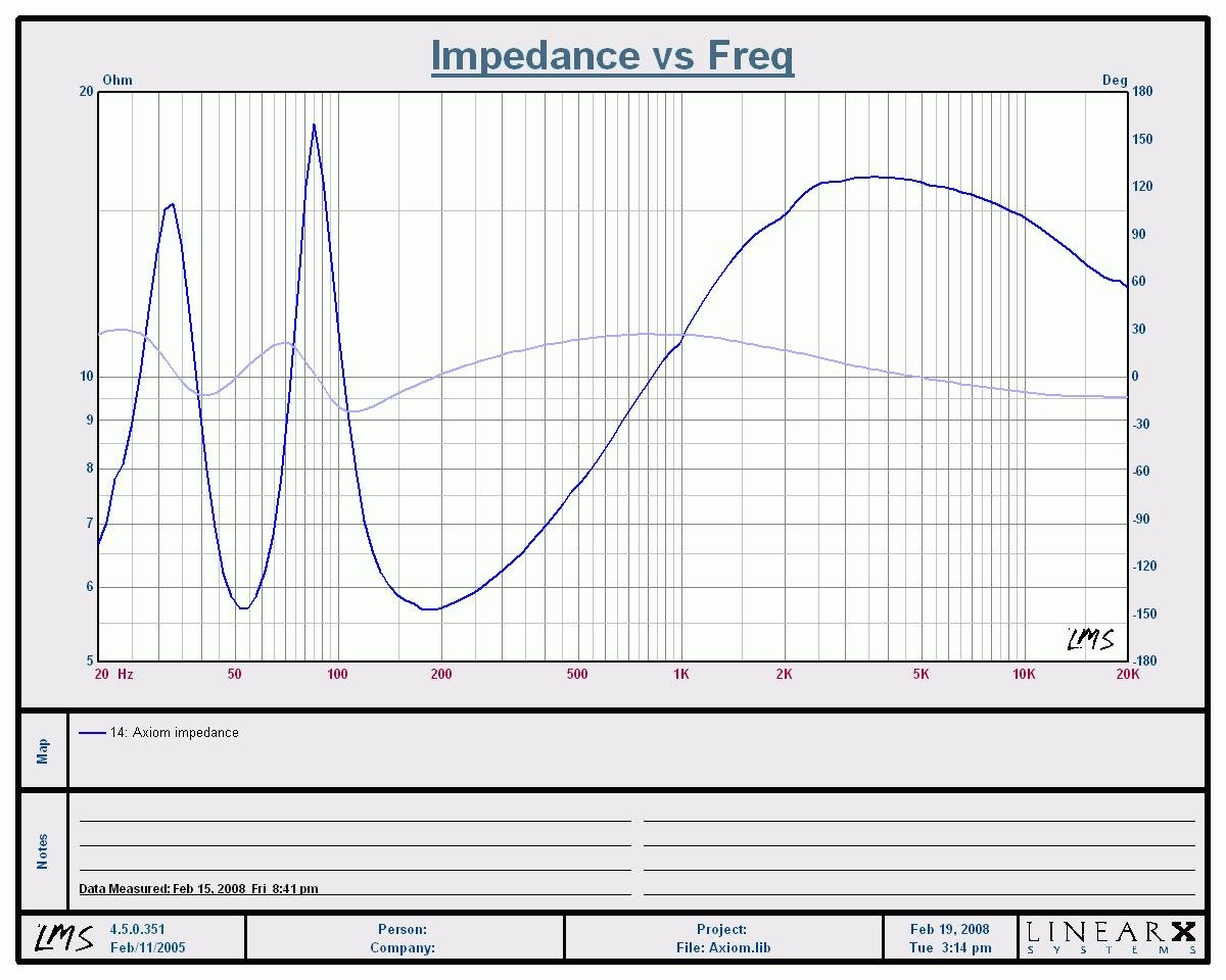

Algonquin Impedance / Phase Measurements
System impedance dipped a bit below 6-ohms in the lower frequencies but considering the relatively high efficiency of the design, it's safe to rate them as 8-ohm speakers. The impedance minimum was located near the tuning frequency at around 52Hz. The system phase response maintained well under +-30 degrees which was to be expected considering the low order filter networks employed. This makes for a very easy speaker load to drive my virtually any home theater receiver available these days.

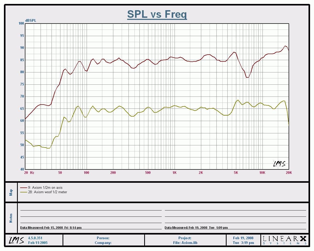

Algonquin In Room 1/2
Meter Frequency Response (1/6th octave smoothed)
Red – on axis centered,
Yellow – on-axis woofer
The Algonquins looked best when the measurement mic was at the height of the woofer's center. At this position, I measured a frequency response +-3dB from 70Hz to about 19kHz. There is a slight "oil can" resonant mode prevalent around 18kHz on the tweeter but this is pretty normal as far as metal domes go. When I placed the mic centered between the woofer and tweeter 1/2 meter away, the tweeter's output appeared to be a few dB hot above 10kHz. Thus I decided to take a more precise summed nearfield measurement to see what was going on.

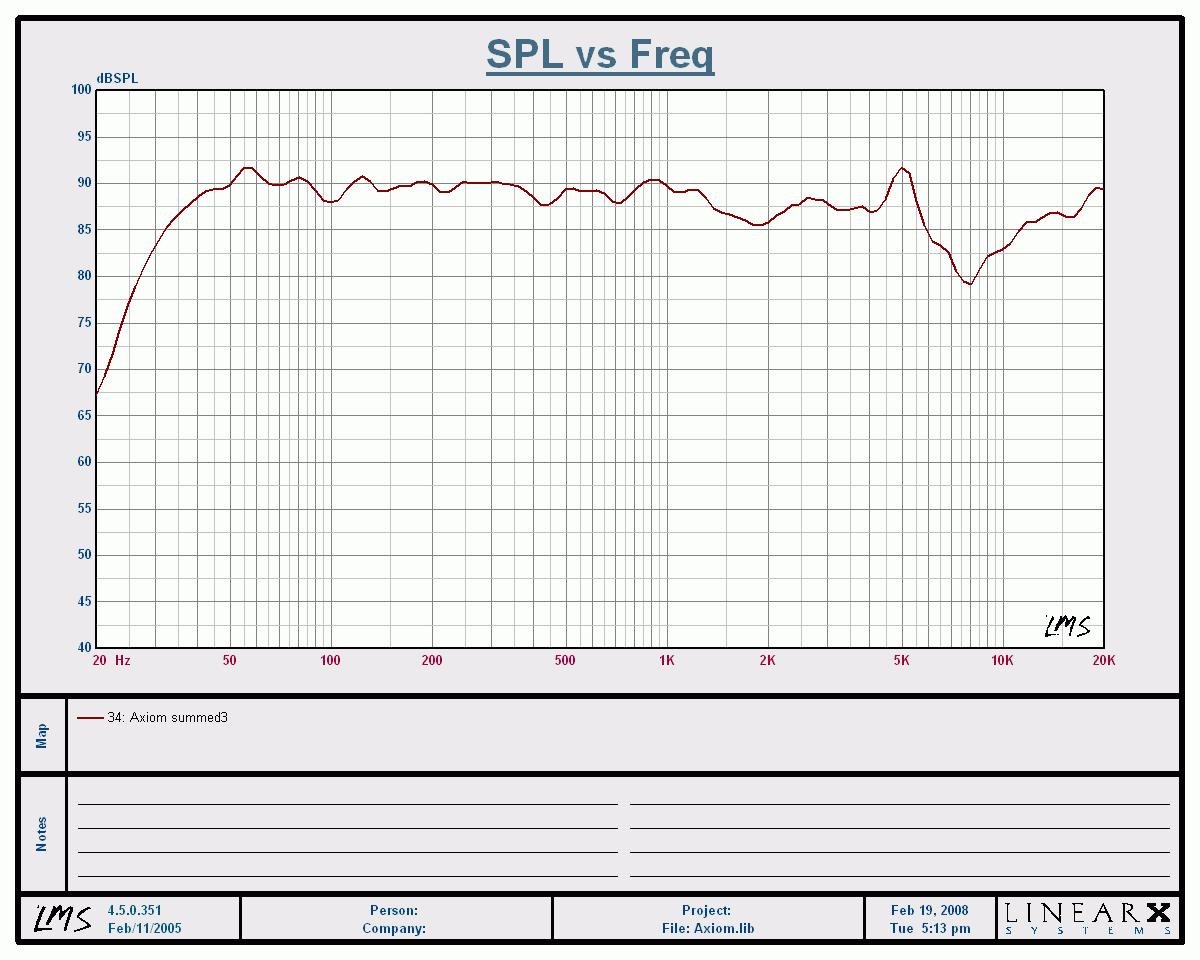

Algonquin Summed Nearfield Frequency Response
Measuring the tweeter at 1 meter, I scaled the response to match the woofer and port nearfield measurements and applied a minimum phase transform to properly integrate all 3 measurements. Aside from the same null I found around 8kHz, the overall combined measurement seemed to correlate more closely with Axioms results from their anechoic chamber. I believe the suckout is caused by phase cancellations between the woofer and tweeter since the woofer has no crossover.

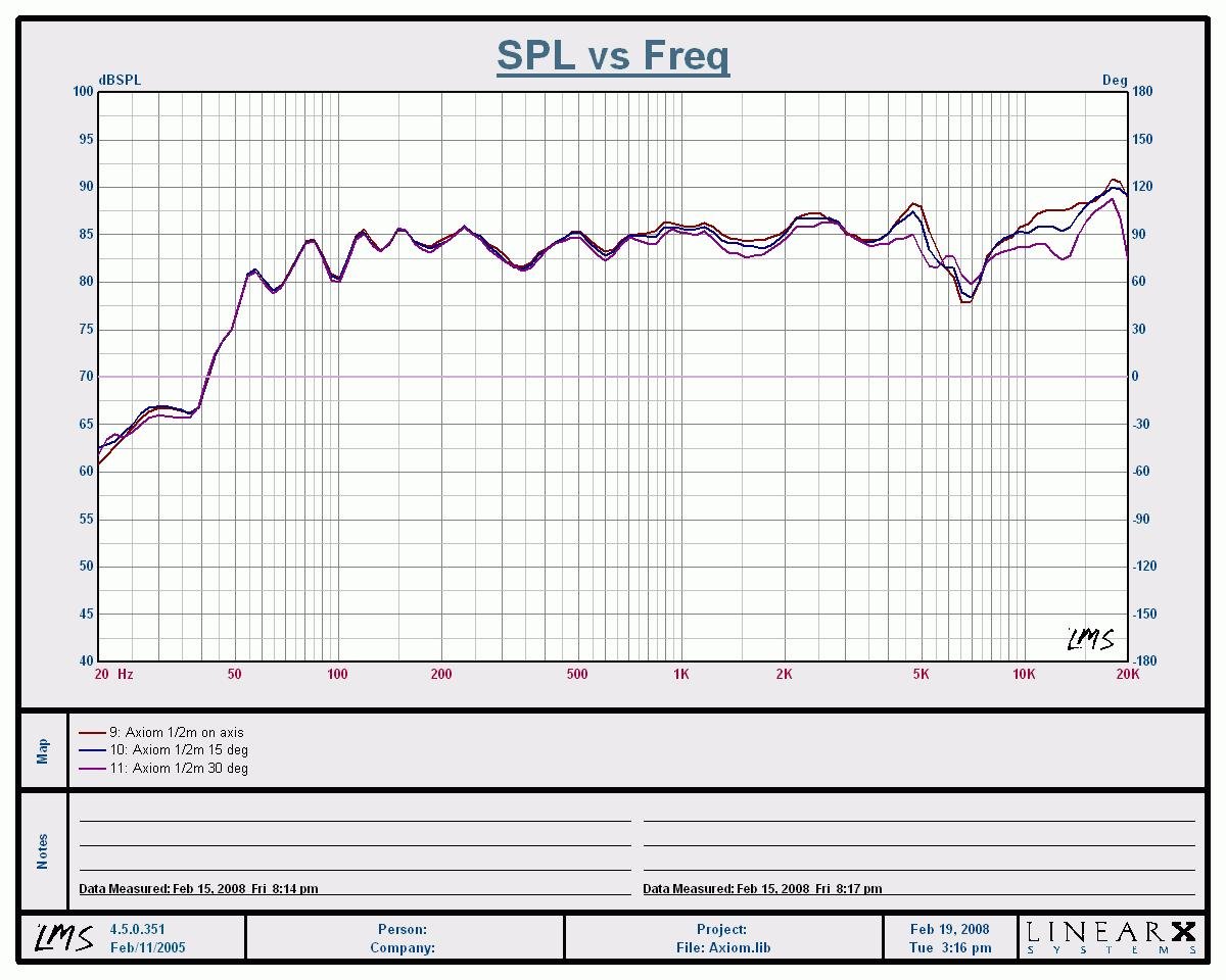

On/Off Axis Frequency Response
Red – on axis; Blue –
15 deg off axis; Purple – 30 deg off
axis
Given the rather ample tweeter output of the Algonquins, I recommend little to no toe-in. In fact, before I pulled any measurements and did some listening experiments of my own, I found they sounded best with no toe-in and with the tweeters slightly above ear level. This is pretty much how most people will use these speakers in an outdoor type of environment.

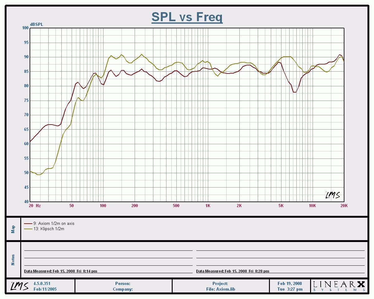

Frequency Response Comparison of the Algonquin vs the Klipsch AW-525
I was curious to see how these two speakers compared measurement wise so I pulled a quick 1/2 meter response for each. It's clear that the Axioms have superior bass extension, no surprises there thanks to the larger woofer in a ported cabinet. The Klipsch's measured about 5dB more efficient so although they don't have quite the same power handling (75 watts as opposed to 175 watts of the Axioms), they will still play about 1.3 dB louder at their rated power limits though that doesn’t imply they will sound as good doing it.
