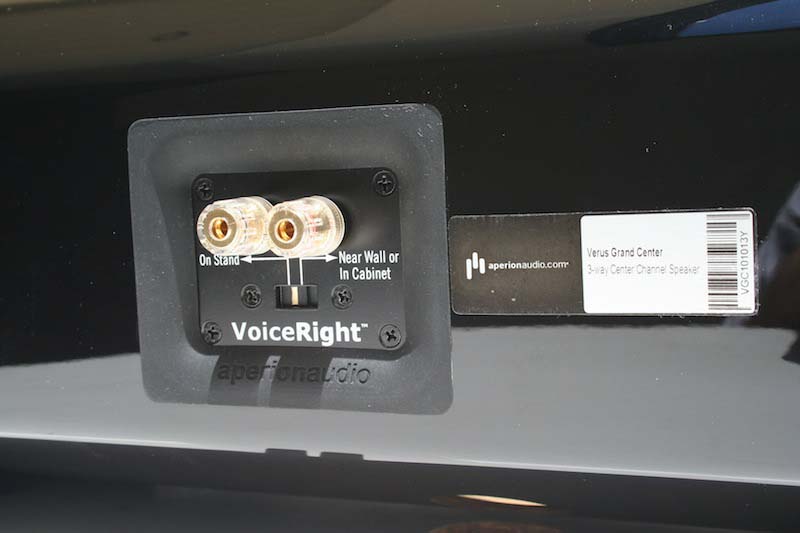

  • VoiceRight™ phase correction switch for bass optimization

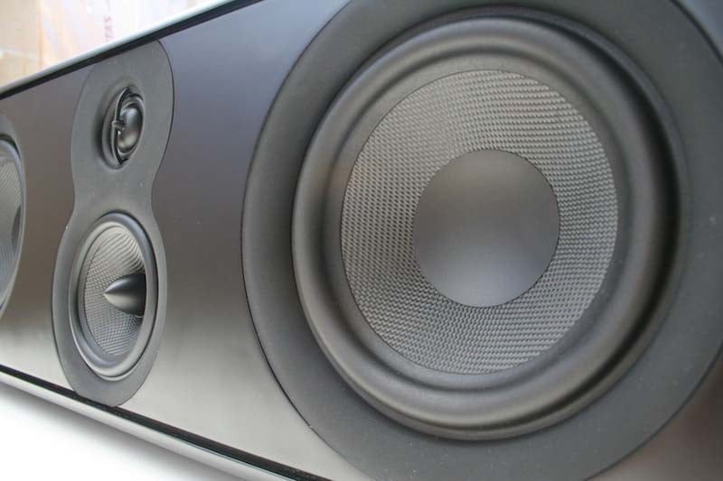

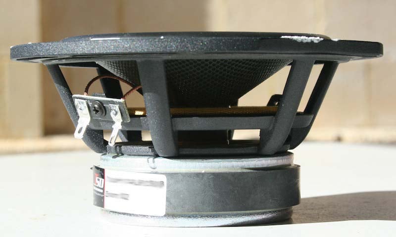

The driver complement of the Verus Grand is more diverse than you usually see in a line of speakers. What manufacturers often do is the pick a common tweeter and a midrange (and sometimes a woofer) and spread them across the different speaker offerings. What we find with the Verus Grand is that they've changed up the drivers slightly based on the speaker design. While for some that might suggest they've sourced their drivers from different companies, we think it shows how they've had to modify the driver compliment based on the speaker design.
The design of the speakers may look a bit boxy at first blush but actually isn't. The front, sides and top are all curved on the bookshelves and tower with the front baffle and top both having a slight convex angle. The front baffle is much larger than the back creating an additional angle though the curve is just as gentle. On the tower speaker the back has two flared ports and dual pairs of binding posts with a bar connecting them. The bookshelves have a single port but retain the dual binding posts. This allows you to bi-amp the speakers if you wish though the 6 ohm impedance and 92dB sensitivity for the towers suggests you won't need to (not that you won't, we would). We probably wouldn't bi-amp the bookshelves (6 ohm impedance and 87dB sensitivity) simply because of the size. The center is not ported, has a single set of binding posts, and includes a switch to cut the bass for in-cabinet placement.

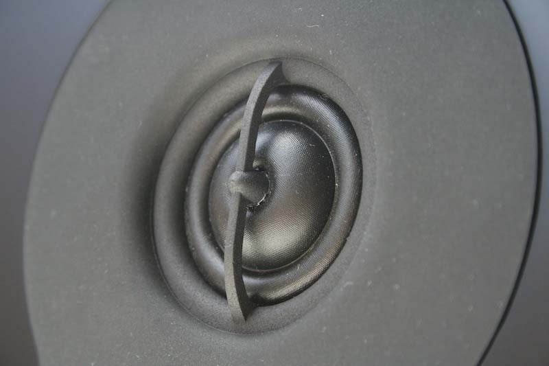

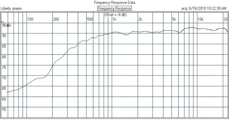

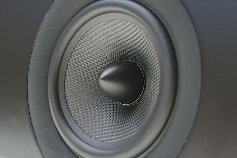

Verus_tweeter001.jpgAll the speakers have the new a one inch Aperion Axially Stabilized Radiator silk dome tweeter which we'll discuss in detail in a moment. The towers mate the tweeter with two 5-inch woven Kevlar mid-range drivers with aluminum phase plugs, and two 6-inch woven Kevlar woofers with butyl rubber surrounds in a three way design. The bookshelves have the tweeter with one of the 5-inch woven Kevlar mid-range drivers while the center sports a pair of the 6" woofers but a 4-inch Kevlar mid-range driver. We're actually surprised to see Kevlar listed as the material in the drivers as we were under the impression that Kevlar had discouraged their name being used. Many manufacturers have gone to using the more generic term "woven fiberglass" instead. The drivers are arranged with a MTM "d'Appolito" configuration on the top with the two woofers on the bottom on the towers with the center having the woofers flanking either side of the vertically arranged tweeter and mid. The real story here is with the tweeter. The tweeter is a new design from Aperion that is optimized for lower frequency performance. This allows them to cross the tweeter over at a lower frequency which relieves the midrange drivers from having to reproduce frequencies that are notoriously hard for them without the cone "breaking up" or beaming. Aperion does this though a number of innovations.

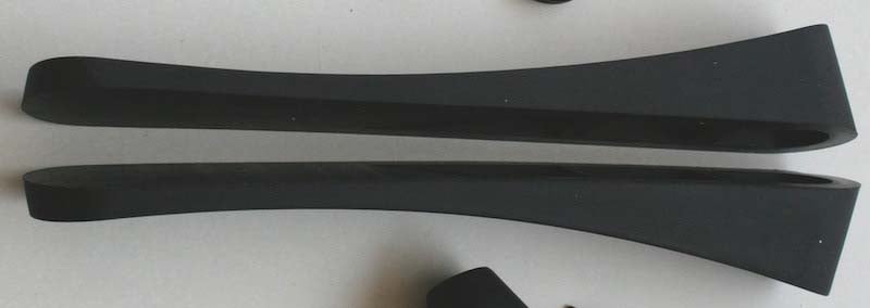

Verus_Tweeter_back001.jpgThe most obvious is the use of the stabilization bar. This goes across the front of the tweeter and pins the center of it down. On other dome tweeters, the dome is allowed to rock during playback which can cause distortion when playing low. By pinning the center down, this rocking is eliminated allowing the tweeter to play lower without distortion. In addition, most really good dome tweeters are vented in the back into a damped chamber to reduce the pressure on the dome. Aperion also added eight additional vents to relieve the pressure behind the surround. Together, these additions allow the ASR tweeter to play lower (it is crossed over in the tower at 1.8kHz) creating a smoother, more natural off-axis roll off. I've included Aperion's measurement of the tweeter. Note - they took this measurements, not us.

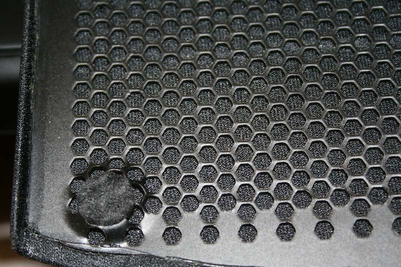

While they had covered the magnets on the grille with felt to protect the front baffle, I did damage the side of the speaker as I pulled the grille off. It really seems that Aperion doesn't expect you to remove the grilles. I chanced opening one of the bookshelf speakers so that I could get a closer look at the crossover and drivers. While I couldn't get the tweeter out without risking permanent damage, the woofer eventually relented.  This is the same midrange they use in the Tower and an inch larger than the one they use in the Center. The woofer sports a cast basket and a hefty magnet.

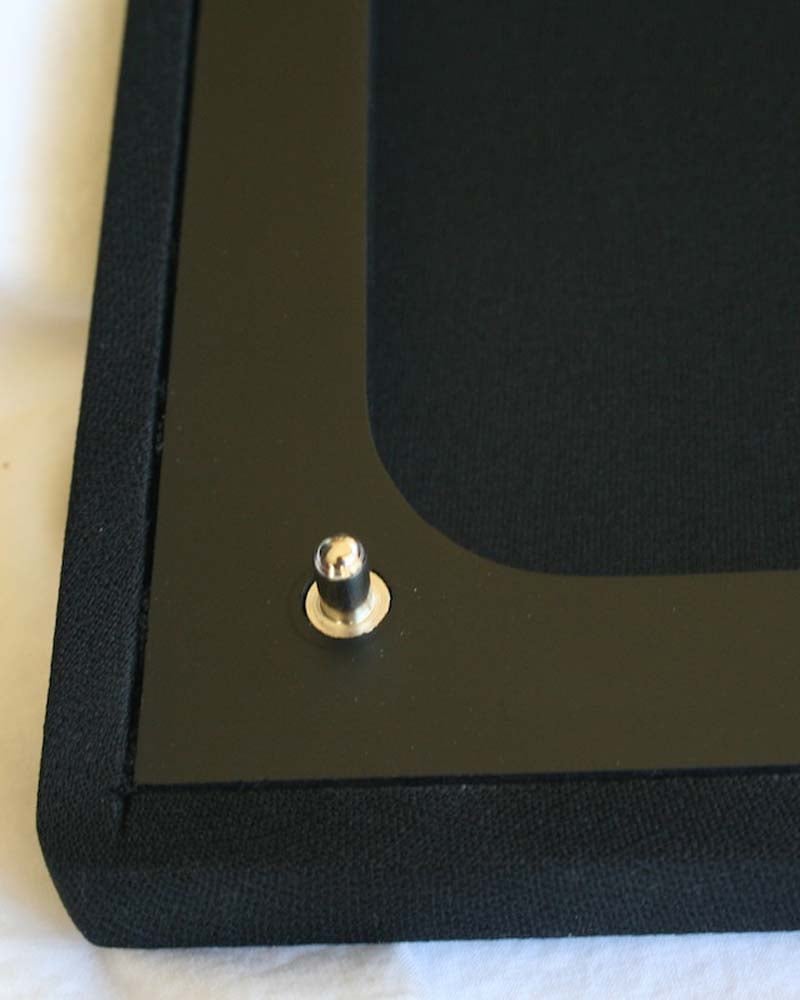

Editorial Note on Grills by Aperion Audio
The main problem with most grilles isn’t the cloth – it’s actually the grille frame. Sound waves reflecting off the inside edge of the frame arrive time-delayed at the listening position and therefore are out-of-phase at some frequency. (Actually there are a series of frequencies that arrive out-of-phase but usually all but the lowest of these are beaming enough that their energy reaching the grille edge doesn’t contribute much.) The small edge Tom noted with the grille removed is much smaller than a typical grille frame and is aimed at keeping this problem to a minimum.

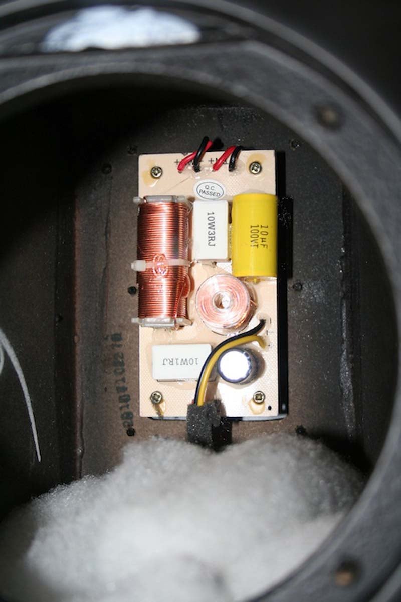

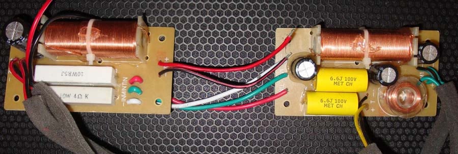

Aperion Verus Crossover
Aperion Audio's design engineer Ken Humphreys confessed to us he is sort of a topology atheist when it comes to loudspeaker crossover designs. Instead, he believes that imposing a desired topology onto drivers is doomed to yield poor results since this fails to recognize the driver's impedance response, natural roll offs & frequency response, the speaker's off-axis response, the desired angle of best-summing through the crossover zone and more. Better is to do the time-consuming task of adjusting parts until speaker's performance is deemed to have the most optimized compromise. We certainly agree with this approach especially since loudspeaker filter networks are not designed to a fixed DC resistive input or output impedance. Aperion's goals are to get the flattest possible frequency response, smoothest off-axis roll off towards the highs so that delayed arrivals sound to have a natural balance, directing the best summing through the crossover zone at & above the listening elevation, amplifier friendly impedance response, protecting the drivers, sensible cost and, of course, sounding the best to their listening panel.
Verus Crossovers
Aperion Audio Verus Crossovers
The Verus Center channel crossover could serve as an example:
  • Woofer low pass (LP): 2nd order near Linkwitz-Riley, shaded a little towards Butterworth. Also with a larger coil to correct for "diffraction step".
  • Mid HP: 1st order Butterworth topologically but, considering the mechanical roll off of the mid in its sub-enclosure, closer to 3rd order Butterworth.
  • Mid LP: Same as woofer LP but with much larger first coil to attenuate the driver's rising frequency response.
  • Tweeter HP: 3rd order topologically but the slope is closer to 2nd order L-R until below the crossover zone where it gets steeper.
Regarding parts usage, Aperion likes to use hard-to-saturate but lower DC resistance coils that use laminated soft iron cores. The inductor in series with the midrange for example doesn't require a low DCR coil only to place a larger resister in series with it. The adjacent coils were oriented orthogonally to minimize unwanted mutual coupling per our article inductor coil crosstalk basics. The tweeter employs high quality mylar bypass capacitors in parallel with the electrolytics for improved sound quality and stability.
Aperion Verus Grand Tower Overview and Measurements

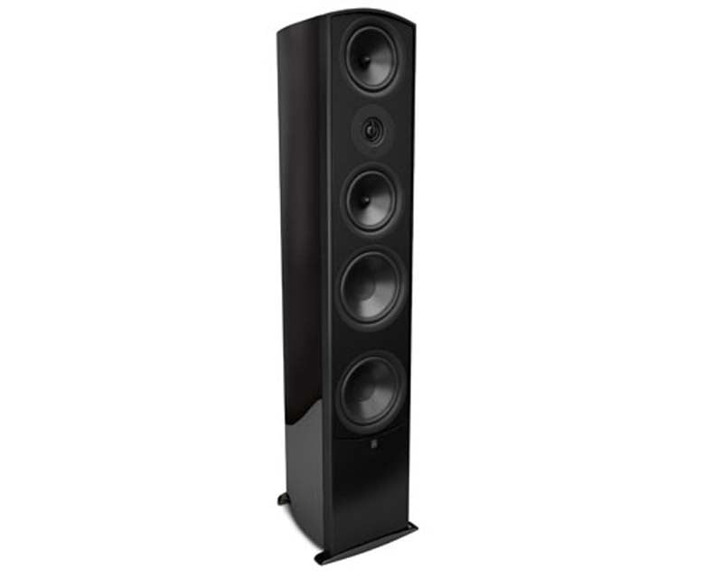

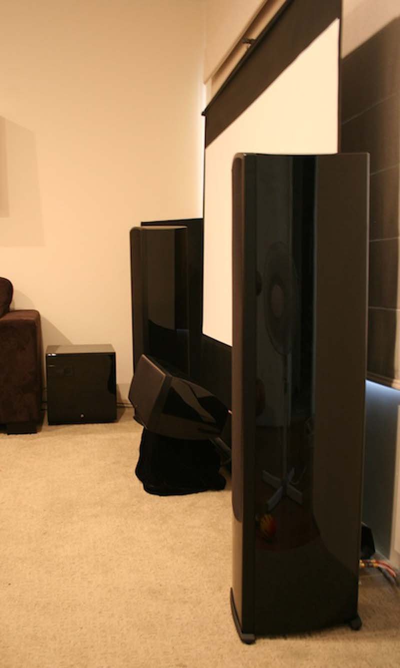

Verus_Tower_stock001.jpgThe Verus Grand Tower comes in either a high gloss black or cherry finish. Our review pair came in the black. The speaker is quite heavy at 65 pounds and is tall but not overly wide or deep (43.5" H x 8" W x 12" D). One of the problems with a tower speaker is making sure it is stable, especially if you are striving to create one with a smaller footprint. Aperion Audio has addressed that by providing an outrigger-like solution for the feet. While they only stick out about an inch or less to the side of the front and back baffle, it is enough to make for a very stable speaker. The foot options on the Verus Grand Tower speakers are fairly limited with only a sharpish spike provided with a dimpled metal round to use on tile or wood floors. We would have preferred Aperion to provide some sort of rubber foot. Also, the spike isn't all that sharp (though may argue it doesn't have to be) which may make piercing particularly tough carpets a bit of a challenge. The metal round could have used a felt side to facilitate small positioning changes and to better protect hardwood floors. We like how the outriggers give better access to the carpet spikes.

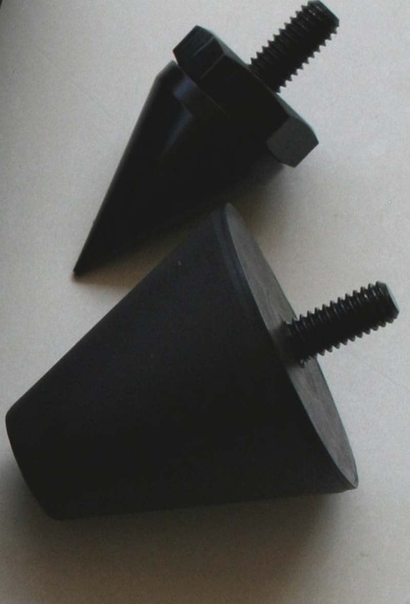

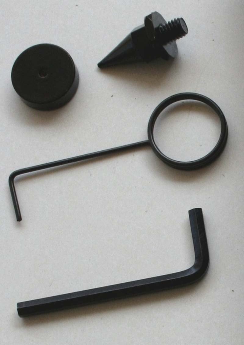

Verus_feet_tower001.jpgAperion rates the Verus Grand Towers down to 45Hz at -3dB and 35Hz at -6dB. In room, I found that I got noticeable output in the mid to high 30's and decent output at the mid 40's. It certainly seemed to me that Aperion had rated their new flagship speakers honestly. That said, in my listening tests, I found that, unless I was watching a movie or video where I expected visceral, tangible bass, I preferred the Verus Grand speakers without the use of a powered subwoofer. While the Bravus II 12D provided that impact that I sometimes desired and additional extension for some content, for most music, I was fine with the Verus Grand Towers alone.
As mentioned previously, the tweeter is the real innovation with this speaker line and it didn't disappoint. Even at reference levels for extended listening sessions, the tweeter never felt fatiguing or strained. I had plenty of opportunities to impress neighbors and friends with movies at ear-bleed levels without the aforementioned ear bleeding. This really allows you to crank the volume to show off other parts of you system (like the sub) without worrying about adding unpleasant distortion or compression to the high end.

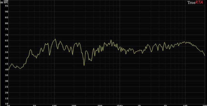

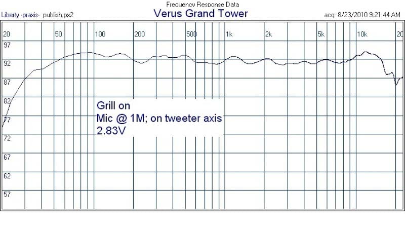

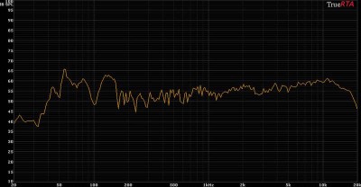

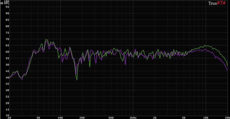

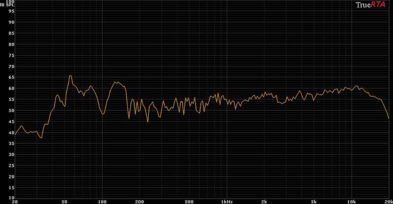

I measured the Aperion Audio Verus Grand Tower speakers in room to get an idea of their performance in the space. While I don't have access to an anechoic chamber or even a large driveway, some measurement is better than none. Fortunately, I have access to a Berhinger ECM8000 microphone professionally measured at Cross Spectrum Labs. They provided a correction file that can be used with TrueRTA to correct for any idiosyncrasies in individual microphones. Using the Berhinger, an M-Audio Fast Track Pro preamp, and a Sherbourn Model 2/75B amp, I measured the Verus Grand Tower at one meter on axis and 30 degrees off.
Green - 1 meter on, Purple - 1 meter 30 degrees off (1/24 resolution)
Note - this is NOT a one watt measurement
As you can see, in my room, the response was a little hot on the top end on axis but smoothed out a bit as you got off axis. You can also clearly see how linear it is even in-room. The response is very flat down to 40Hz where it starts to drop off. The top end rolls off after 15kHz where human hearing is weakest anyhow and is due, at least partially, to the measurement mic being in close proximity to the tweeter phase plug. If you are wondering why I might be so impressed with a speaker, the above graph should be proof positive. After I completed my in room measurements I asked Aperion to send me their in house measurements. I was astonished to find just how similar the two graphs were. The other physical difference (other than the room) between the min and Aperion's measurements is that Aperion measured with the grilles on and I did them with the grilles off.
Aperion Verus Grand Tower Frequency Response Measurement from Manufacturer
These graphs look eerily similar. As an Audioholic, I've always been taught that in room measurements are inherently flawed - and they are at frequencies below the transition band (300Hz) where they become room dominant. But you can see that, when compared to the Aperion in house measurement, our in room one tracks pretty closely.  The bass response is a bit skewed by the room and there are a few suckouts but the overall shape is nearly identical from the slightly increased energy on the top and bottom end and the drop off around 15kHz.

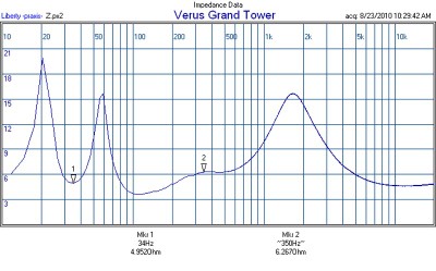

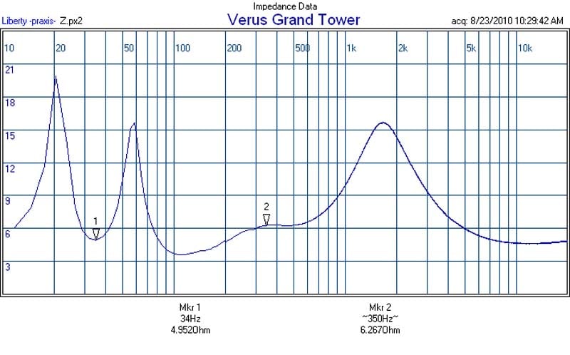

Aperion Verus Grand Tower Impedance Measurement
The Verus Tower appears to be tuned in the 35Hz region as indicated by the saddle point between the two impedance maximas.  Towards DC, the system impedance measures 6 ohms as Aperion rates this speaker but be mindful of the 4 ohm dip in the 80-150Hz region when mating an amp with these speakers.  Feed them quality from an amp rated down to 4 ohms and you will be rewarded.  These speakers deserve quality amplification.

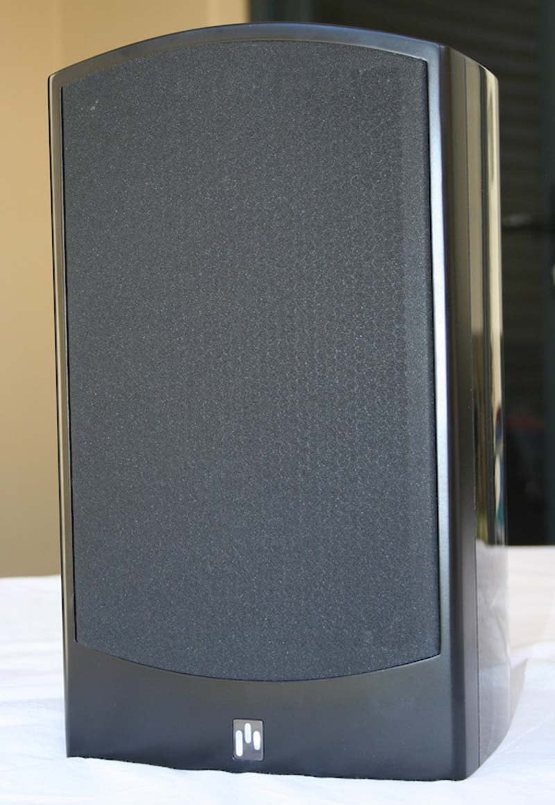

Aperion Verus Grand Bookshelf Overview and Measurements

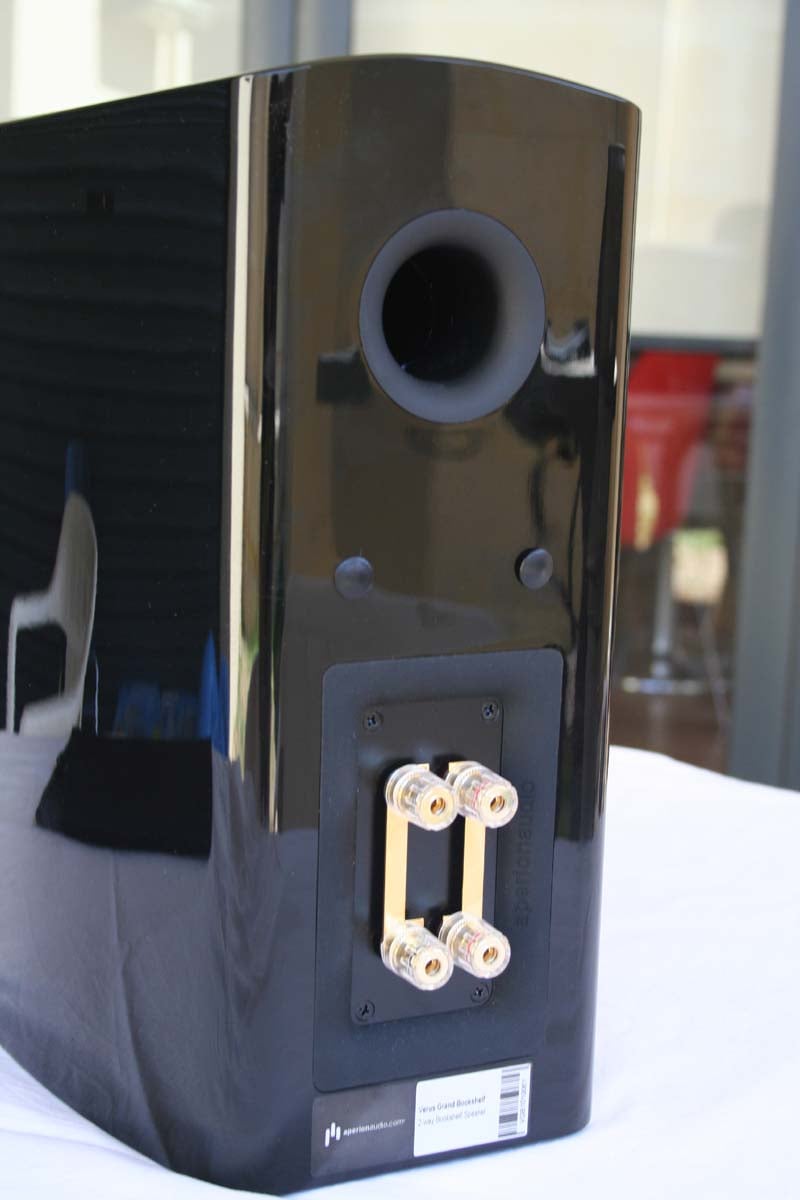

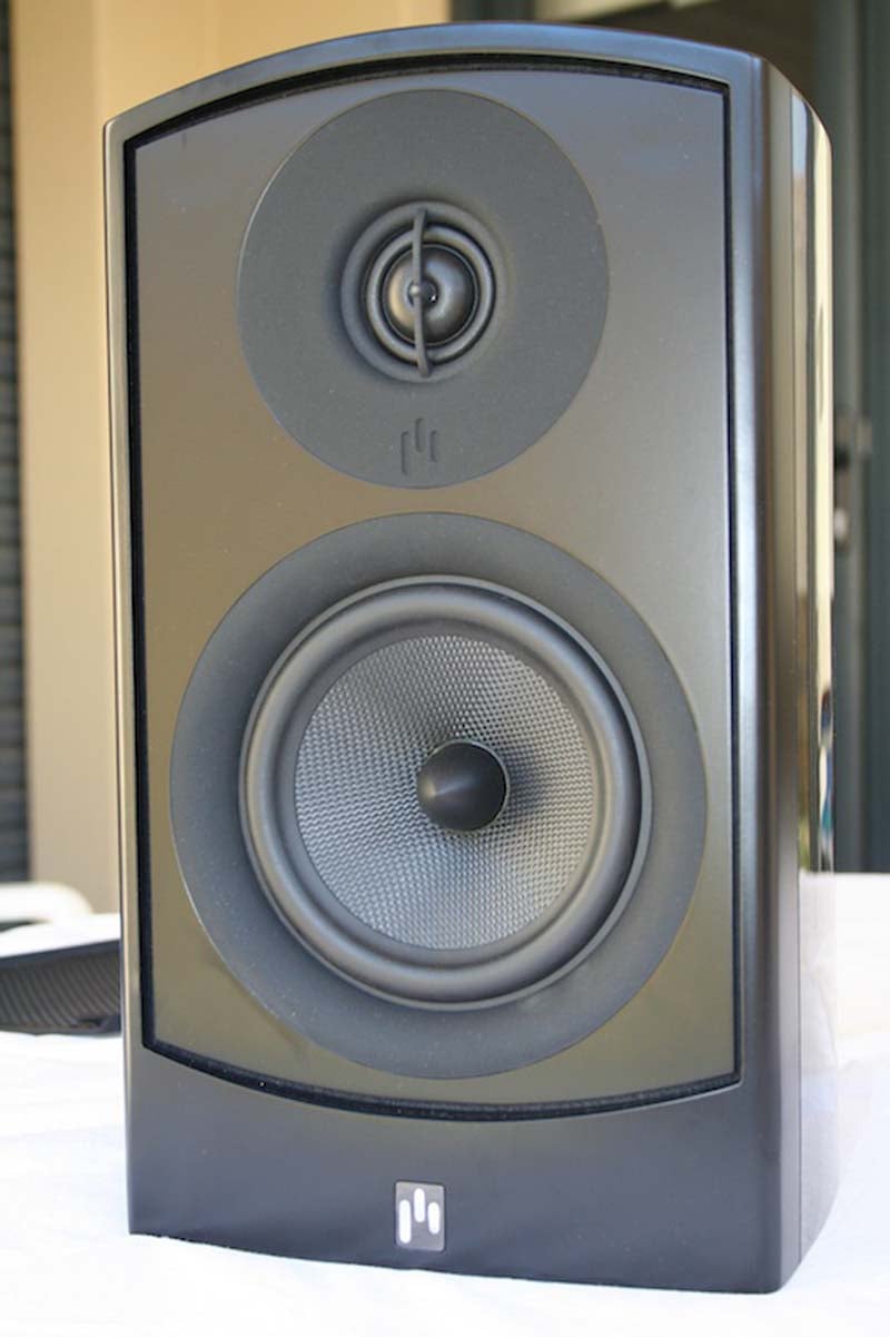

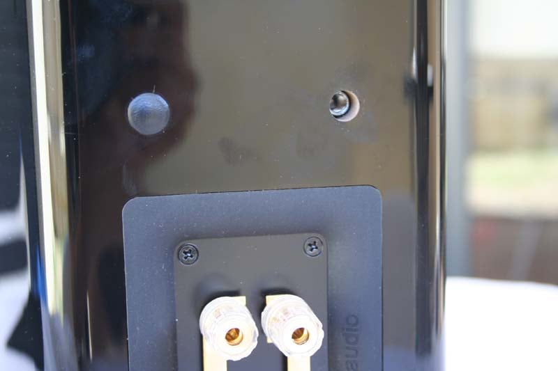

Verus_book_grilloff001.jpgThe Verus Grand Bookshelf speakers are very small and compact weighing in at 14 pounds each and measuring 13" H x 7.5" W x 9" D. The most stunning part of the Verus Grand Bookshelfs is how small they are. This should make placement very easy. The foot options on the Verus Grand Bookshelf speakers are limited to sticky rubber pads you can place on the bottom. The back has a flared port at near the top and dual pairs of binding posts with a bar connecting them. There are two rubber covers on the back and one on the bottom that can be removed to reveal threaded inserts for connections to wall mounts. This type of placement may cause a problem with bloated bass response from the rear ports so you'll want to be careful if you go this route.  A simple solution for such installations would be to either plug the ports or bass manage (recommended) the speakers via your A/V receiver.  We recommend an 80Hz crossover setting which will provide the best integration to your sub(s) while also increasing system dynamic range by diverting the stressful bass frequencies away from the little woofers in the Verus bookshelf speakers.
Verus_book_grillon001.jpgThe Verus Grand Bookshelves, unfortunately, were reduced to mostly playing a support role as surround speakers. While I did give them a listen individually, they spent most of their time behind the couch positioned for surround sound. For surround duties, I felt that these speakers were sorely under taxed and underutilized. They did manage, for the most part, to blend in but occasionally, I couldn't help but notice them. I've never been a huge fan of using bookshelf speakers as surrounds, preferring the less localizable performance of a dipole speaker. With speakers as nice as the Verus Grand Bookshelves, it almost seems a crime not to feature them in your setup for main front channel duties.

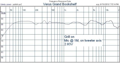

Aperion rates the Verus Grand Bookshelves down to 59Hz at -3dB and 54dB at -6dB. My listening impressions easily confirmed this. While you might get away for a while without using a sub for music, you'll definitely notice the upgrade in bass depth when you add one. The lower extension means you'll have no problems crossing over the Bookshelves at the THX recommended 80Hz. I measured the Aperion Audio Verus Grand Bookshelf speakers in room at one meter on axis.
Verus Grand Bookshelf 1 Meter On Axis (1/24 resolution)
Note - this is NOT a one watt/meter measurement

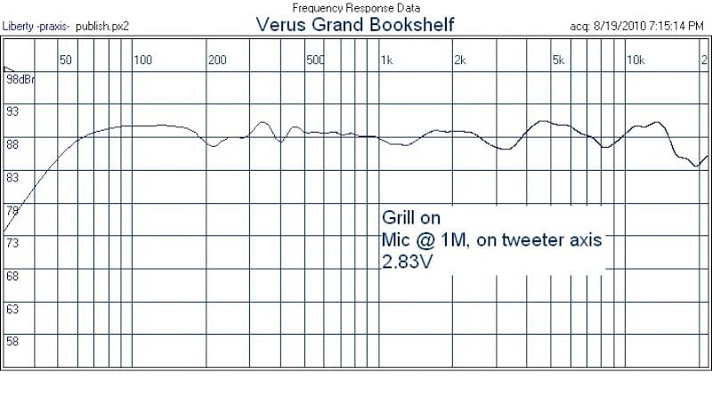

 Like the Verus Grand Towers, the Bookshelf speaker measured very well in room. We see the same dropoff  around 17Hz and a near ruler flat response down to 55Hz. This is phenomenal performance for a bookshelf speaker only 14 pounds and just over a foot tall. While you are paying a premium for the added bass and output of the Towers, the Verus Grand Bookshelves should perform very well in smaller rooms especially paired with a sub.
Again I asked Aperion to send me their in house measurements and again I was astonished to find just how similar the two graphs were. The other physical difference (other than the room) between the two measurements is that Aperion measured with the grilles on and I did them with the grilles off.
Aperion Verus Grand Bookshelf Measurement from Manufacturer
Again these graphs look eerily similar. You can see that, when compared to the Aperion in house measurement, our in room one tracks pretty closely. The bass response is a mess because of the room but the overall shape is nearly identical from the slightly increased energy on the top and bottom end and the drop off around 15kHz.

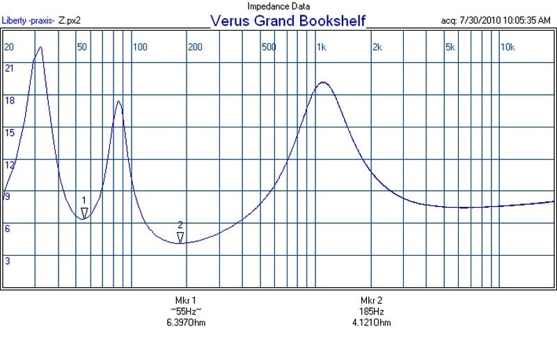

Aperion Verus Bookshelf Impedance Measurement
The Aperion Verus Bookshelf speaker appears to be tuned in the 55Hz region as indicated by the saddle point between the two impedance maximas.  Towards DC, the system impedance measures above 8 ohms though Aperion rates these speaker at 6 ohms.  Be mindful of the 4 ohm dip in the 100-150Hz region when mating an amp with these speakers.  Feed them quality from an amp rated down to 4 ohms and you will be rewarded.  These speakers deserve quality amplification, even if being crossed over above 80Hz.

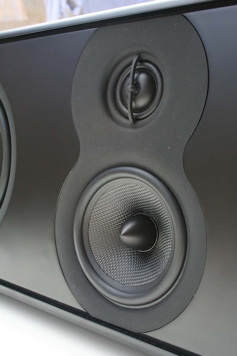

Aperion Verus Grand Center Overview and Measurements

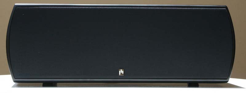

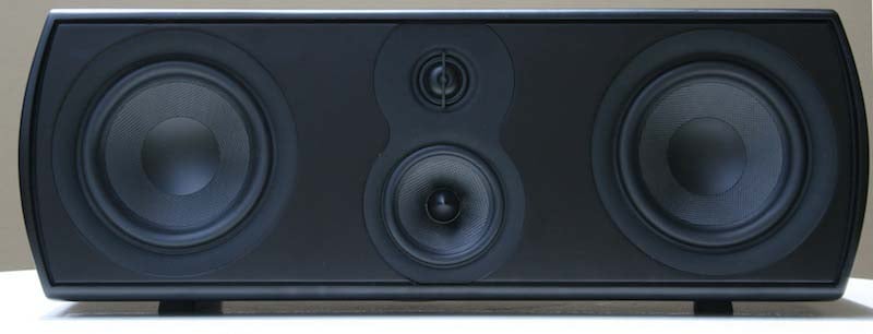

 Verus_center001.jpgThe Verus Grand Center is quite large and heavy for a center at 39 pounds, 9" H x 24.75" W x 11" D. What we really loved about the Verus Grand Center is that the only flat side is the back. Provided with the speaker are two long rubber feet that are concave with one side taller than the other. This allows you to place the speaker on a stand or in a cabinet and angle it as needed. We placed our review sample on a makeshift stand in front of a pull up projection screen. We finally found a long-term use for the cotton sock provided with the speaker as we used it to cover our makeshift stand (which was a huge limestone brick our neighbor wasn't using). Unlike the bookshelf speakers, there are no provisions for wall mounting, a curious omission. Even though the speaker is quite heavy, we would have thought they'd had some way of wall mounting it.
If any speaker can make or break your movie and surround experience, it's the center. While I continue to contend (and you'll see how true this is later in the review)Verus_center_back001.jpg that the center is the least important speaker in your surround sound system for the simple reason that it is the only that can be removed and have other speakers take up it's duties (at least if you sit in the sweet spot), a good one can make a world of difference. Conversely, I've been in the presence of a bad center and it is, without a doubt, the single most annoying thing sans a torn woofer. When the center is handling all of the vocals, to have one that underperforms means that you'll either struggle to understand the dialogue or you'll be forced to increase the volume so that it no longer blends well with the rest of the system. This can be a huge problem.
Luckily, this wasn't the case with the Verus Grand Center. Not only did it hold up well in the presence of the Towers, it had no problems blending while maintaining intelligibility. Aperion rates the Verus Grand Center down to 50Hz at -3db and 42Hz at -6dB. There were a few times in my listening tests when I walked up to the Center to adjust the position and noticed just how clear and non-fatiguing it was. In particular, when I was listening to the Diana Krall: Live in Rio Blu-ray, only her vocals are coming from the Center. At reference levels, I walked up to the speaker and could practically put my ear on it without pain. The Verus Grand Center was so clear, so distortion free, I have no problems saying it is the best center speaker I've ever had the pleasure of experiencing in my room. Sure it's a bit big but it is sooooooo worth it when you hear it.

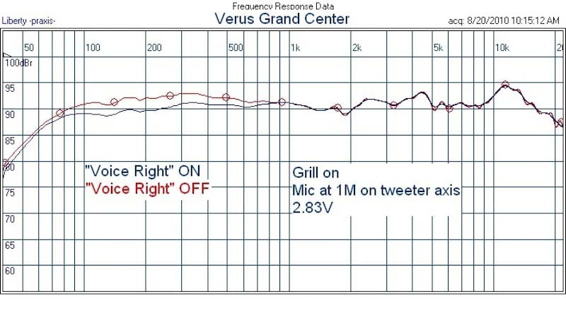

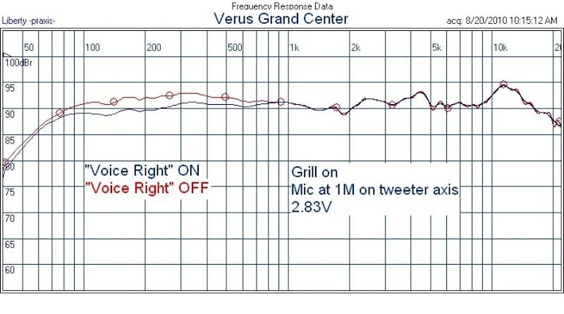

The measurements of the Aperion Audio Verus Grand Center was just as impressive as the rest of the lot.
Verus Grand Center 1 Meter On Axis (1/24 resolution)
Boundary Switch Set to "On Stand"
Note - this is NOT a one watt /meter sensitivity measurement
If you are starting to think you're seeing double, Aperion has really excelled at maintaining very uniform frequency responses across all these speakers. Again, the Center shows a super flat response down to nearly 40Hz with a few room related dips. The top end starts to drop out near 15kHz which is consistent with all of the measurements. I've honestly not seen any set of speakers that measured this flat in room. These speakers exhibit incredible linearity which can be seen even in real in-room measurements.  In contrast, we've measured speakers from companies touting their anechoic linear response that didn't even come close to measuring this linear.
Aperion Verus Grand Center Measurement from Manufacturer
The Aperion in-house measurement again looks similar. The bass response of my graph is a bit skewed by the room and there are a few suckouts but the overall shape is nearly identical from the slightly increased energy on the top end and the drop off around 15kHz. The "Voice Right" refers to the switch in the back. This bumps down the bass response for in cabinet placement.

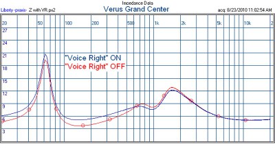

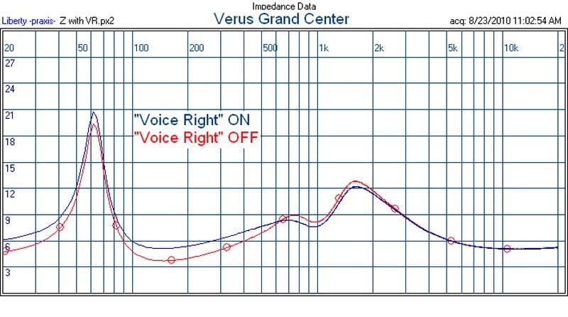

Aperion Verus Center Impedance Measurement
The Aperion Verus center speaker exhibits a very linear impedance load despite its complex array of drivers and crossover topology.  Aperion rates it at 6 ohms but be mindful of the 4 ohm dip (Voice Off) in the 100-200Hz region when mating an amp with these speakers.  Feed them quality from an amp rated down to 4 ohms and you will be rewarded.  This center channel deserve quality amplification, even if being crossed over above 80Hz.

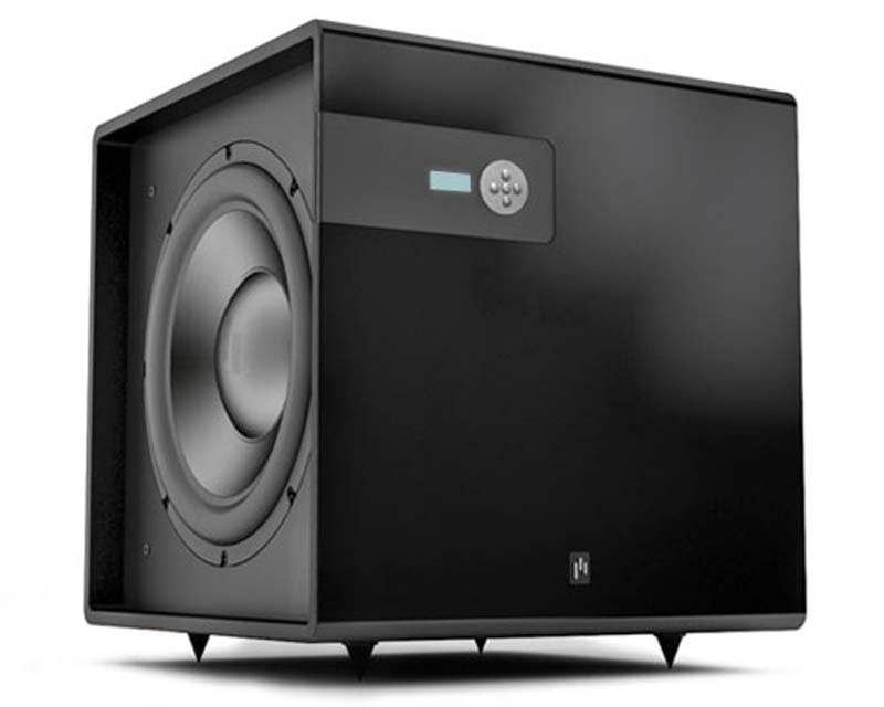

Aperion Bravus II 12D Subwoofer Overview and Measurements
Verus_sub_stock001.jpgThe Bravus II line is the new, upgraded Bravus subs from Aperion. The 12D is the largest and most powerful in the line. Like the Verus Grand line, the Bravus subs come in high gloss black or cherry. To match the rest of the speakers in the review, Aperion sent me a high gloss black.

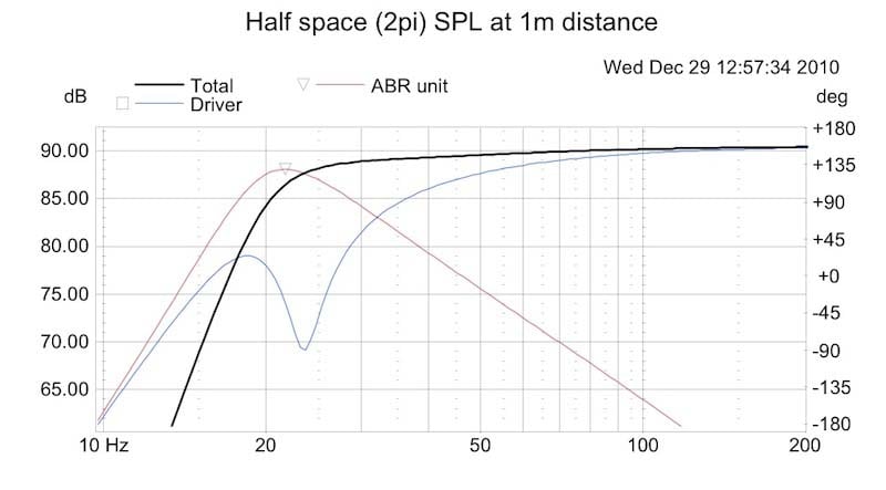

There are a few distinguishing features of the Bravus II 12D sub. First, it has an active, downfiring 12 inch driver. On either side, covered by the inset grilles reminiscent of the Verus Grand, are a 12 inch passive radiator.
Editorial Note about downfiring woofers
A downfiring woofer generally make less distortion due to the angular nature of the harmonics, which are naturally attenuated. The downside (no pun intended) is gravity is acting in concert on the outstroke, and against on the instroke, so the lower harmonic distortions (even order mostly second) will rise. This is typically worse for a heavy woofer with a low Fs, than a lighter woofer in a sealed box with a stiff suspension, but the effect of gravity is always acting on the suspension, causing the driver to float off center.
The Bravus II 12D sub features a 600 watt BASH amp, front controls with an included remote, a fully defeatable and configurable parametric EQ, and preset modes for music and movies. There are two foot options on the Bravus II 12D; a spike or a rubber spike. Since there needs to be a bit of distance between the bottom of the sub and the floor (for the downfiring driver to extend), you're going to have to choose one. While theoretically a carpet spike is best, I've found that often it is too hard to keep a sub from rattling. I opted for the rubber spike foot even on my short pile carpet. On the amp you have three RCA inputs (LFE, Left, Right) plus line level inputs. We were surprised to find no XLR inputs on a sub of this price.
There's a lot to like about the Bravus II 12D. The enclosure is constructed out of one inch HDF (High Density Fiberboard) and holds up against the knock test well. It's a small sub at only 17 inches tall by 15.5 inches wide by 15.5 deep but still weighs in at a hefty 62 pounds. The finish is as superb as the Verus Grand speakers. The sub is rated down to 20Hz at -3dB which is very respectable, and something you'd like to see in a $1K sub. Unlike the Verus Grand line, the Bravus II 12D is field serviceable. The grilles were more traditional cloth stretched over an HDF frame rather than the perforated metal of the Verus Grand and used chrome binding posts rather than magnets. They were hard enough to remove that we didn't worry about them falling off but no so hard that we couldn't get them off... eventually.

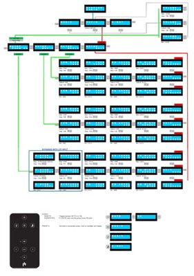

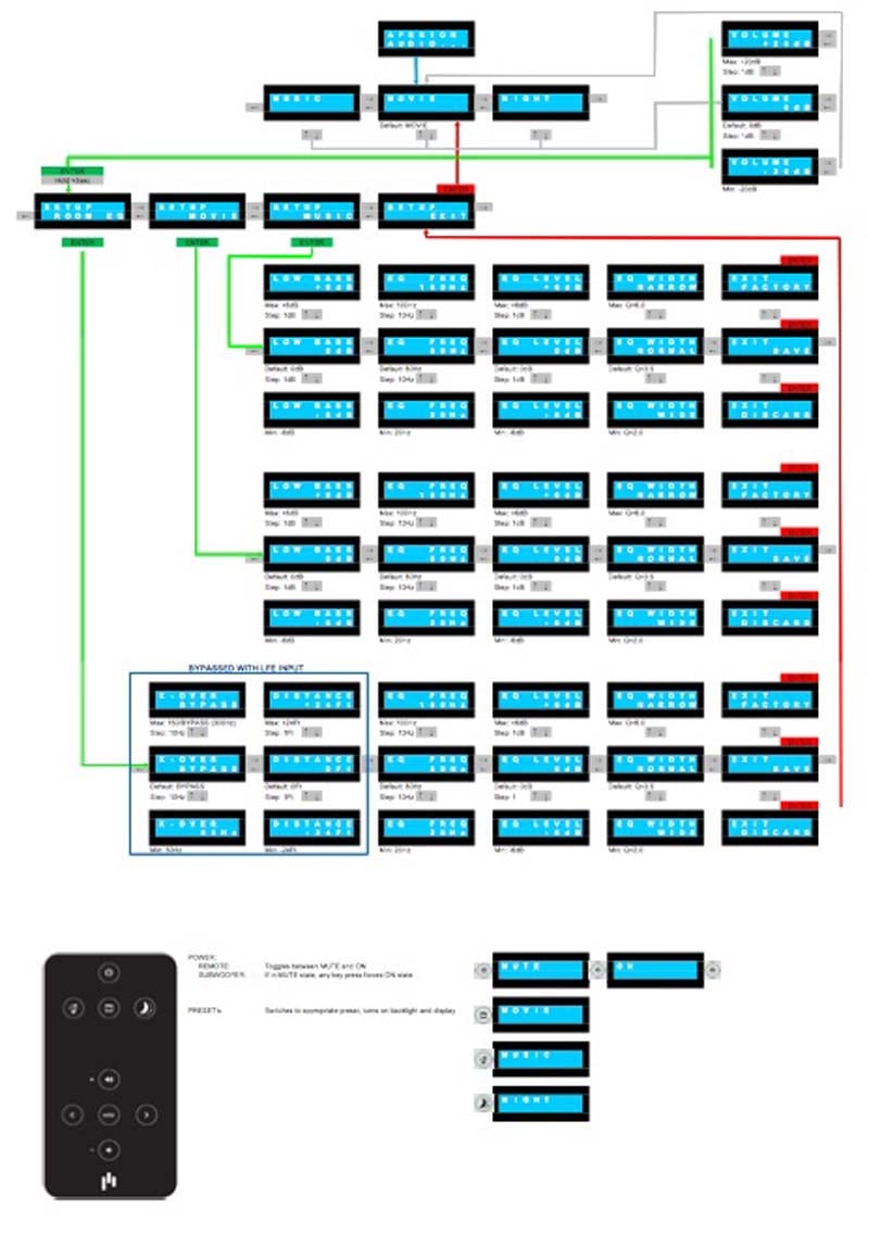

There were a few complaints, however. In order to figure out how to use the EQ or even access the menus, we had to go online. None of that information was included with our test sample. There is a huge flowchart on the Aperion website which makes everything fairly easy to understand and we hope they include it with the consumer samples. The biggest complaint we had was there was no way to lock out the front controls. While we liked have easy access to the controls from the front panel or the remote, our kids loved to adjust the volume of the sub. Too many nights were spent wondering why we weren't getting any bass before we learned what they were doing. There is a Music,  Movie, and Night modes (no Game as indicated on the Aperion website) but no User mode. In Aperion's defense, the Movie and Music modes are completely configurable so it isn't a problem but we'd prefer something like EQ defeat mode where you know there is no processing going on no matter what random buttons your kids press.
 The parametric EQ is a single band which can be set differently for each of the modes. While this is useful for power users, casual users may find the EQ too advanced for them. If Aperion had opted for a User mode, they could have had Movie and Music preset (though adjustable) and the User mode defaulted to flat. This would have been the best of all worlds with causal users having something to experiment with (currently, Music and Movie default to EQ off) while still giving power users something to play with.
While you could set up the EQ, volume, and distance from the menu, what was missing was phase. Even the most basic subs have a phase switch. While we find a switch to be mostly useless, power users (you know, the ones that will play with a parametric EQ) use a variable phase control to dial in the performance of a sub. This was a noticeable omission from the menu. In lieu, they include distance which can be used in a similar way (though it takes a really informed consumer to know that).

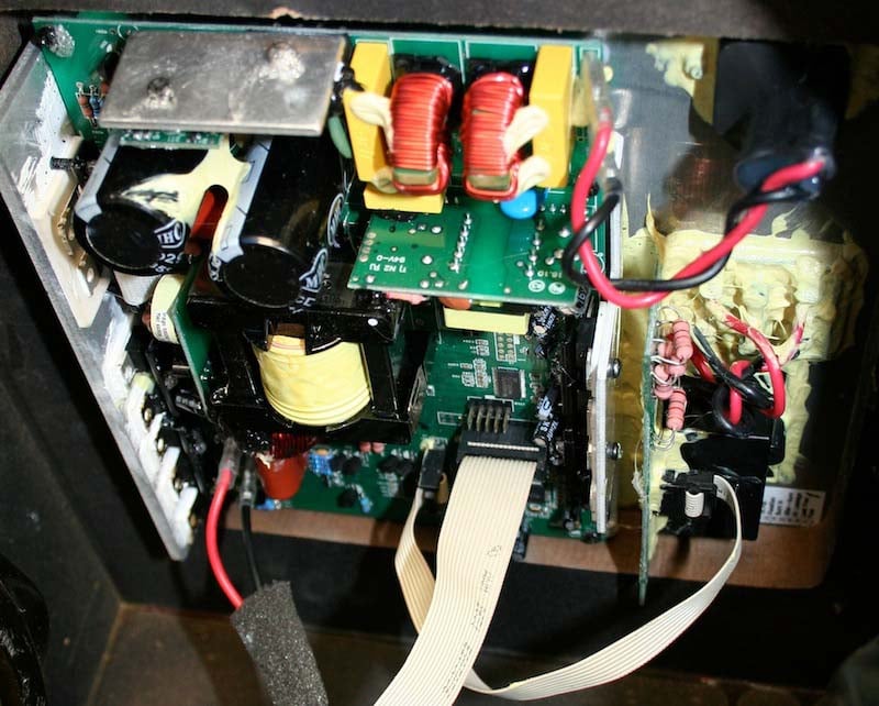

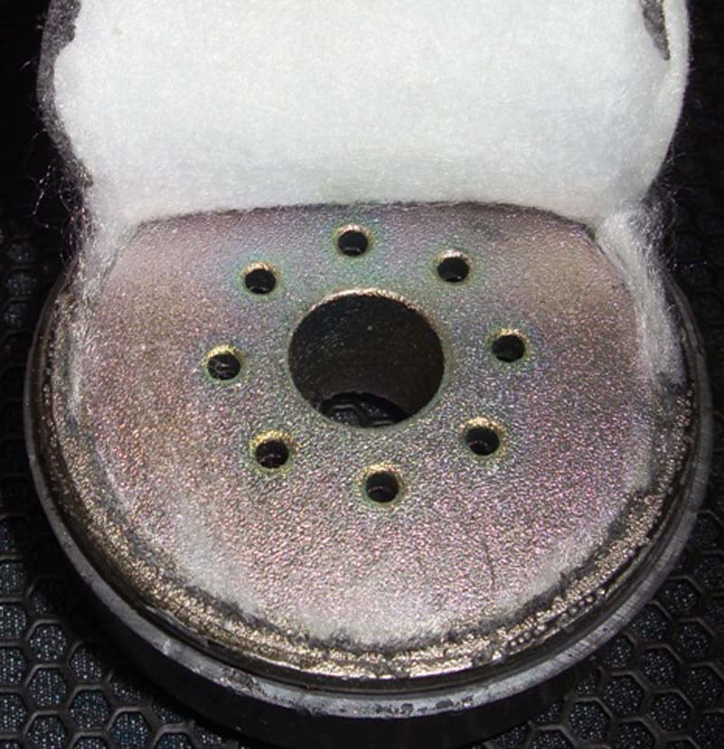

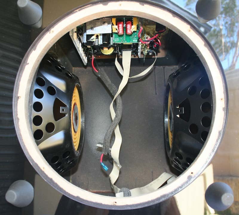

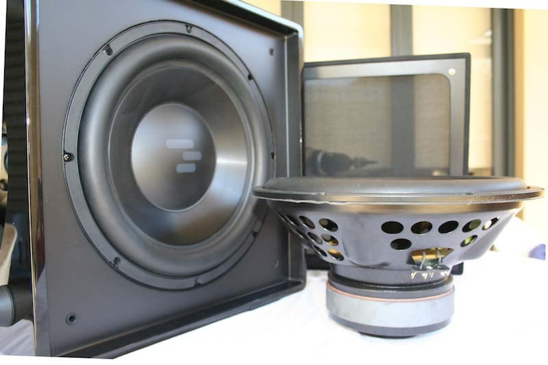

Opening up the Bravus II, we find a large open area in the center with very thick walls on all sides. There was no internal cross bracing or corner/edge braces. I was happy that they had allowed the sub to be opened since I found the twist ties they had used to bind the extra cable that ran from the front control to the amp stuck to the driver magnet. While I hadn't heard any rattling during my tests, I probably would have noticed it eventually. Since I had the sub open I just reconnected the twist ties and didn't have to worry about it.

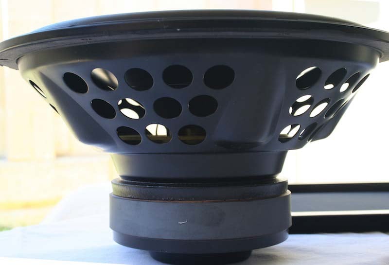

The driver and two passive radiators share similar stamped rather than cast baskets. This was a bit of a disappointment to us considering the caliber of this product. The magnet structure on the driver was large and beefy and it seemed like the driver accounted for nearly a third the weight of the sub. The BASH amp is rated for 600 watts but we weren’t sure if that was a continuous rating or peak.  We have found BASH has typically always over-estimated power of their amplifiers so we are inclined to believe it is a peak rating.

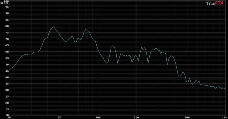

I measured, like the other speakers, the Bravus II 12D in room but the graph looked pretty rough, mostly due to room modes. I used a one meter groundplane measurement. While I don't have access to an anechoic chamber or even a large driveway, some measurement is better than none. Fortunately, I have access to a Berhinger ECM8000 microphone professionally measured at Cross Spectrum Labs (http://www.cross-spectrum.com/). They provided a correction file that can be used with TrueRTA to correct for any idiosyncrasies in individual microphones. Using the Berhinger, an M-Audio Fast Track Pro preamp, and the 600 watt BASH amp in the sub, I measured the Bravus II 12D at one meter groundplane.
Aperion Bravus II 12D Sub, Groundplane In Room (1/24 Resolution)
While the output above 100Hz decreases significantly, I don't really care since you shouldn't be crossing the sub over any higher than that anyhow. Aside from some room modes, the graph tells a decent story. From about 90 Hz down to 40Hz there is a pretty flat response. After that, it drops off precariously. Unfortunately, I wasn't able to take the sub outside and do a proper measurement so this very well could be a bass suckout at those lowest regions. Unfortunately, Aperion could only provide me with a modeled response rather than an actual measurement (which I've included below). I would have liked to have seen how my in room measurement held up to an actual one provided by the manufacturer since all the others were so similar.
Bravus II 12D Modeled Response
Aperion Verus Grand Set-Up and Group Impressions
Verus_inroom001.jpgI started off my connecting up the Aperion Audio Verus Grand speakers to my Denon AVR-2301CI Receiver using Ram Electronics HS Speaker Cables, Impact Acoustics SonicWave interconnect for the sub. Setting up the Verus Grand speakers was actually quite easy. The center channel's rubber feet that allowed me to aim it toward the listening area easily. This gives you a great deal of flexibility in your placement. The switch on the back of the center also helps the speaker retain a flat response regardless of the placement. While I liked the feet and outrigger setup on the towers, I wished for a longer spike or some way of adjusting the depth of the spike from the top. Having the spikes off to the side rather than under the speaker definitely helped and they seemed to pierce my short pile carpet. I've found with sharper spikes, you can hear them pop through the bottom of the carpet but with the duller Aperion spikes, that wasn't the case. I still felt like they made solid contact though I was less confident than I could have been.
I stand-mounted the bookshelves to the sides and slightly behind the couch for use as surrounds. I placed the towers on either end of the screen with the center on my makeshift stand below. The subwoofer I placed to the left of the front left speaker off the wall about a foot. My room is treated with a combination of ReadyAcoustic Chameleon panels and six GiK Tri-Traps. These make for a much better listening experience as they tame some of the room's worst problems.
The first thing I noticed after setting up the speakers was how well the Verus Grand Towers performed both on and off axis. This was obviously a design goal of Aperion and they hit it out of the park. While I prefer a slightly more detailed sound so you'd think I'd point the speakers directly toward my listening position, I found that they sounded just as good off axis. I've set up enough speakers to be very sensitive to performance decreases based on position. With the Verus Grand, any position I put them in from pointed straight forward to directly at me, they sounded great. Imaging was dead on in all positions which was astounding. Actually I ran without a center for the first week or so as I was doing mostly stereo testing. Even then, and even sitting off center, the vocals still sounded like they were coming from dead center. This was true even when you were sitting in line with one of the main speakers. While the center channel locked down the vocals, it wasn't strictly needed.
That said, I couldn't help but marvel at the Verus Grand Center. While the Towers did a great job of creating a convincing phantom center, the Verus Grand Center was like wiping a mirror clean of steam after a hot shower. It was so much sharper and immediate. Vocals were crisp and lifelike. Pans were seamless and fluid. The ability to aim the speaker meant I could tune it for on and off axis listening which meant if I wanted a bit more energy on the top, I could point it at me or slightly away if I wanted to tone it down. A very nice solution.
