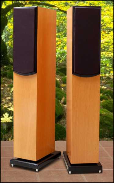

The SongTowers QWT are one of the least expensive in the Salk line starting at $1695 for satin black and $1795 for one of their "standard" veneers. Let me just say that the "standard" veneers are just as nice as many of the "premium" veneers from other manufacturers. If you are trying to match another color wood, the "standard" veneers can be dyed to match for an extra $50. The Salk speakers are all made to order so you'll be looking at a bit of a wait (30-45 days minimum) for their standard finishes. The joy, of course, of made to order speakers is that you are not limited to just the finishes in stock. Salk will use whatever veneer you'd like at a $300+cost added to the base price. That really isn't that much compared to other manufacturers. They'll even discuss with you the advantages and disadvantages of your veneer choices. But that isn't all. Salk sees the speakers they make as not theirs, but yours. They are making speakers for you. If you like a particular design but want to make some changes, they'll do it. Even if they think that the changes will be detrimental to the sound quality (like moving or removing the port), they will explain to you the sonic repercussions of your choices but if you insist, that's all it takes. There aren't many manufacturers of any size that will do that for you (unless you are some big shot). I guess to Salk Sound, we are all big shots.
First Impressions and Build Quality
Salk_Cert.JPGYou get the impression, from the onset, that the SongTowers are custom. While most speakers arrive in specialized boxes with molded foam endcaps, the Salks come in unmarked boxes shoved full of straight pieces of foam. Don't take this to mean that the packaging was inadequate - far from it. There was no empty space in the box and the speakers were well protected. I'd estimate that there was an inch and a half minimum of foam around the speakers with some areas having much more. The speakers and the plinths came in separate boxes and both arrived undamaged. You also receive a hand signed "birth certificate" with your speakers. All of the people that worked on the speaker (supposedly) sign the document. I'm sure there is more than one Salk owner with this framed in his listening room.

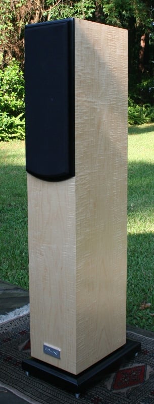

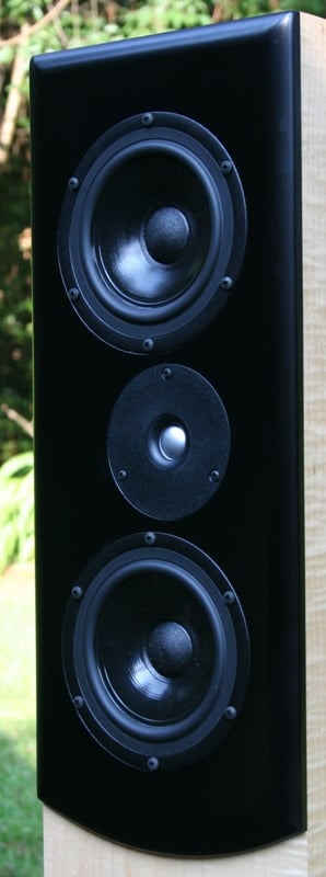

Salk_Back.JPGUnwrapping the speakers, the care and quality of the finish is evident. I opted for the Natural Curly Maple which has a very light yellow hue with a very interesting rippled grain. The plinths and that front plate around the drivers are raised and a glossy black. At the bottom of the front of the speaker is a milled aluminum plate with the Salk logo. I really like the way this looks and much prefer it over the typical plastic logo on the grill. The rear has the two five-way binding posts unceremoniously sticking out of the back (most speakers have them mounted in a plastic housing). At first I wasn't a fan of this as I was afraid that the speaker lying on its back (which I was going to have to do to remove the drivers) would damage them but the design of the plinth elevated the speaker enough as it was lying on its back so that posts were protected. I was surprised to find that the speakers were not bi-ampable. I've seen speakers at a much lower price point that are. Personally, I don't have an issue with this since I think it takes a very specific speaker design to require separate amps but most consumers would expect two pairs of binding posts. Since Salk builds their speakers to order, you could request bi-ampability though it would come at an additional cost. There is a large flared port at the bottom of the back of the tower. The front of the speaker sports the two Seas CA15RLY 5" woofers and the Hiquphon OW4 tweeter (a drop-in upgrade from the standard OW2 that adds $100 to the price of the speaker) in an MTM configuration.

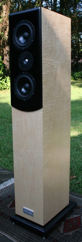

Salk_Front.JPGThe speakers are very tall (as you would expect with an MTM design in order to get the tweeter to ear height) at ~47" high. The tweeter is ~37" off the ground which is just about perfectly ear level for my seated position. The speaker itself is deep, but not very wide which makes placement a little easer than the other way around. The plinth on the sides and front only flare out an inch but the speaker feels very steady and solid. At 55lbs, your child or dog is going to have to really work hard at knocking these things over.
The finish on the SongTowers is impeccable with absolutely no flaws that I could find. The raised black area around the drivers and the plinths are a gloss black (called "black satin lacquer" by Salk) but not the high gloss "piano" finish that you see on some other speakers. The black finish is very nice and smooth and while reflective, doesn't seem to attract the amount of dust and smudges that the high gloss does. The "spikes" provided by Salk weren't really spiky - they have a sort of sparkly metal finish and are rounded at the tip. The threaded post actually detaches from the "spike" fairly easily. A little thread-locker would probably correct this. There are no provided rubber feet though the rounded tips should be fairly safe on hardwood floors.

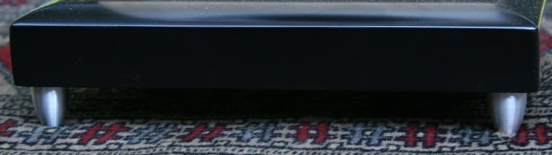

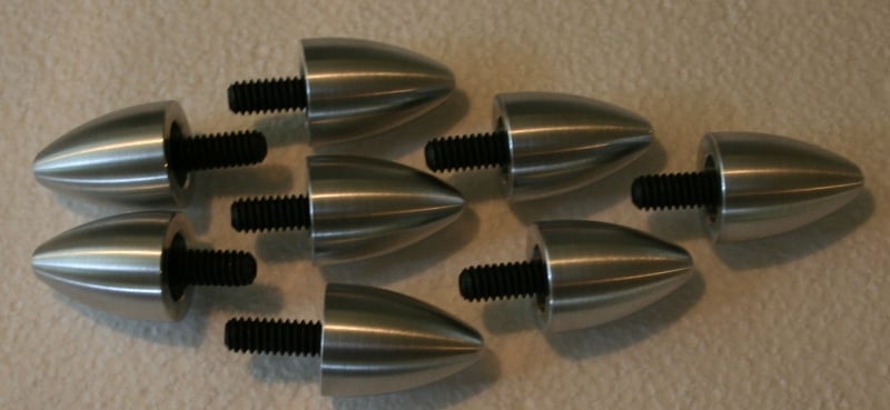

Salk_spike.JPGThe problem is that the spikes won't pierce a carpet which is sort of the whole point of the spikes. These seem to be mostly just for looks from what I can tell. Salk does have more traditional carpet spikes that are adjustable and much sharper available upon request (for an additional cost). The bottom of the speaker has a short raised piece which gives the speaker the appearance of floating off the plinth. This also means that if you added on some aftermarket outriggers, you'd end up with the appearance of floating off them as well. If the raised portion was part of the plinth and not the speaker, outriggers would be much more of an option.

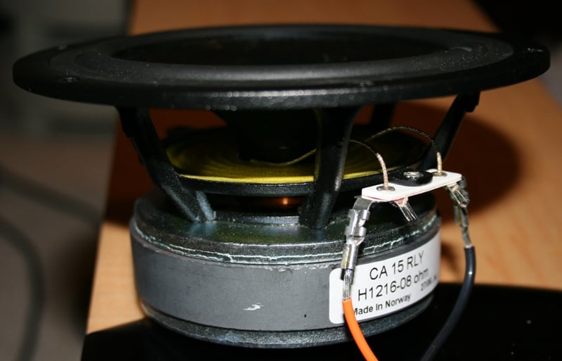

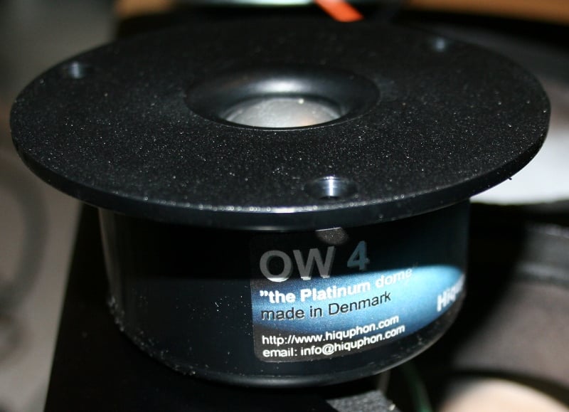

Taking the speakers apart is only possible from the front by removing the drivers. I confirmed that the woofer was in fact the Seas CA15RLY though the tweeter was the Hiquphon OW4 instead of OW2. As we mentioned, Salk says that the OW4 is a drop-in upgrade/replacement for the OW2. The cabinet is constructed out of 3/4" MDF with three large braces up the length. The braces are all slightly inset into the cabinet and glued into place. At 55 lbs a piece, the SongTowers are well braced and very inert.

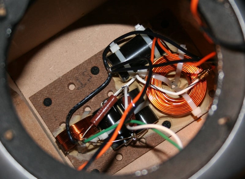

Salk_Crossover.JPGAll the internal wiring was done with 14 AWG silver coated oxygen-free copper wire. The Hiquphon OW4 tweeter is enclosed in its own plastic backbox obviously provided by the manufacturer. The wiring for the tweeter is soldered on directly. The crossover uses very high quality air core inductors properly oriented to avoid crosstalk coupling, and audiophile polypropylene capacitors. At first I thought Salk was using hot melt for holding the parts down. It turns out that this was not hot melt but heavy-duty construction adhesive. A few years ago they started having problems with shipping damage. The cabinets arrived just fine, but heavy air coils were being ripped off of crossover boards (especially by UPS). They experimented with many different solutions until they came up with this adhesive. Once the adhesive off-gases (in about 24 hours) it bonds so well you have to use a chisel to remove components from the crossover board. This, coupled with the liberal use of tie-wraps has virtually eliminated crossover shipping damage. In fact, they have had zero failures in the two years or so they have used their present system!

After you attach the plinth and spikes you are pretty much ready to go. Other than the other issues with the spikes, you don't really have any adjustments to be made with them. Most spikes have an adjustment nut that you can use to lock in a particular length, but not so with these spikes. You should be able to unscrew them if you need to level the speaker but you won't have any way of locking them into place unless you add a nut of your own. My room has a medium pile carpet which meant that all this was moot for me as the speaker sat nicely on the carpet with no wobble.

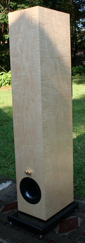

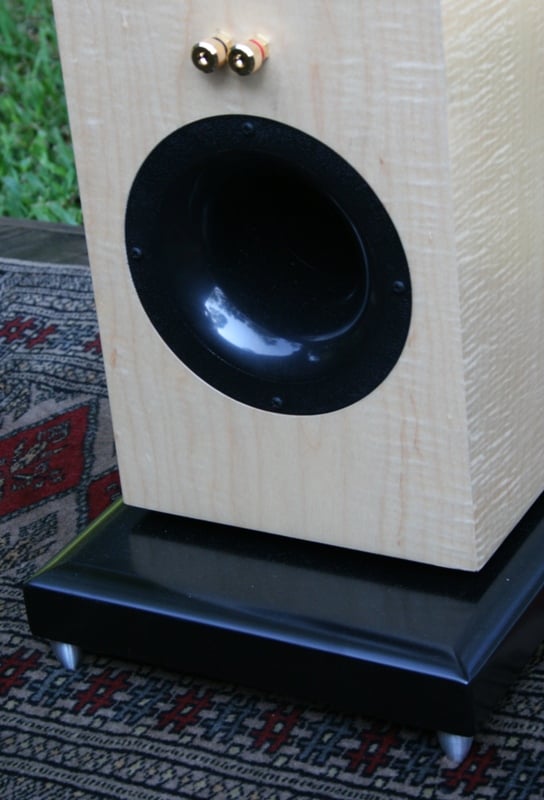

Salk_Port.JPGYou'll immediately notice that the tweeter is slightly off to the side. This is done to control diffraction artifacts. The manual states that the tweeter should be oriented to the inside when setting up the speakers. The five-way binding posts are very accessible due to their mounting orientation and this makes for a very easy setup. I tried a number of different toe-in configurations and found that they tolerated almost any amount of toe-in except none (if that makes sense). With the speakers pointed directly forward, I heard a definite "hole" in the center during side to side pans. A moderate amount of toe-in pretty much eliminated the effect. Even with a drastic toe-in (directly at me) the speakers still sounded very good and the imaging tightened up even more. I'd suggest experimentation on your own but I went with a moderate toe-in (the cross-point about 3 feet behind my seated position).

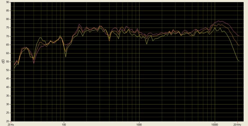

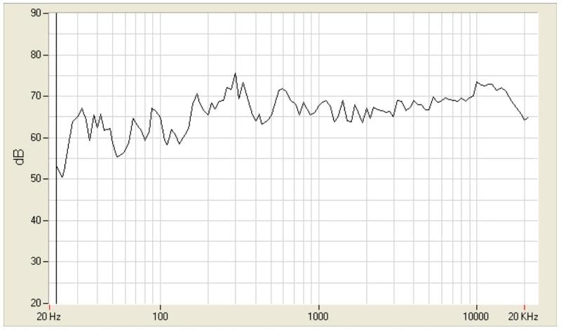

Using the Sencore SP395A FFT Audio Analyzer, I measured the SongTower's in room on and off axis frequency response with 1/12th octave resolution.
SongTower 1 Meter Frequency Response (1/12th Octave) On Axis
SongTower 1/2 Meter Frequency Response (1/12th Octave)
Pink - On axis, Orange - 15 degrees off axis, Yellow - 30 degrees off axis
Disregarding the graph below 200Hz (due to in-room measurement inaccuracies) the response looks quite linear with a very smooth off axis response. The slightly recessed mid frequencies implies the tonal response of this speaker is a bit laid back or relaxed.

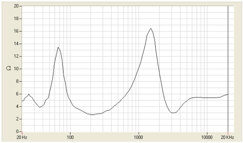

SongTower Impedance
The Sencore consistently measures speakers about 1 ohm lower than they actually are. The Salk SongTowers present a fairly easy load that will work with most mid-fi receivers (even though it does dip into the 4 ohm range). Increased amplification would probably be appreciated for those with larger rooms. Once again, you can notice a saddle point centered around the loudspeaker's tuning frequency of 35Hz which is more typical in bass reflex enclosures than transmission Lines. In a true transmission line, you'd see a smooth line coming off that 67Hz peak and not the dip at 35Hz and last peak at 25Hz.
