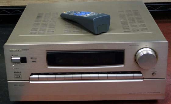

Onkyo 828Let’s flip the clocks back 10-15 years ago to one of my favorite Pro Logic receivers from Onkyo, the TX-DS828. It was a THX rated five channel receiver that had a very meaty amp section for the main channels. Back in that day it wasn’t a requirement to have equal power for all channels since Dolby Digital wasn’t implemented in consumer gear yet. I recall speaking to a tech at Onkyo about some operational questions I had relating to this receiver. He told me “don’t get rid of that baby, the replacement models coming don’t have the same punch”. I didn’t think much of that until a few generations later where a similarly priced Onkyo receiver was not only lighter in weight, but had a reduced power rating for the front channels but equal power for all five channels
Sure it sported new Dolby Digital and DTS 5.1 decoders but for listening to two channel sources, it just didn’t sound the same to me or my brother when we ran some comparisons. On a positive note, getting DD/DTS decoders built in was certainly a worthy trade off. It is costly for manufacturers to not only integrate the parts for these features, but to license the technologies as well. Only your listening habits could govern your decision based on these trade offs. Being a two channel enthusiast like me, my brother kept what he had and waited. The features in this case weren’t worth trading for amplifier quality.

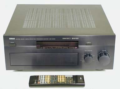

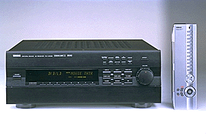

Yamaha DSP 3090A similar example I recall was with one of the industries first fully integrated 5.1 Dolby Digital receiver, the venerable flagship from Yamaha, the DSP-A3090. It was actually an integrated amp as it lacked a tuner. This beast weighed a whopping 46lbs, had dual rows of heat sinks, a large E-core transformer and generous capacitive power bank reserves. It was also the first equal power (5 x 80wpc) 5.1 channel A/V product on the market. The sound quality was fabulous. The amps were sonically very warm and rich and had no problems driving 4 ohm loads on all channels simultaneously. I owned this unit before I started Audioholics. A few months after I bought it, the RX-V2092 came out. Its rated power was 20wpc higher than the older DSP-A3090 but it also weighed a few pounds less. Did Yamaha somehow change the laws of physics? Not likely.
Yamaha 2092What I discovered in my listening comparisons between the two amplifiers was that the less powerful DSP-A3090 sounded much smoother and more natural, especially when driven at high power levels. Despite it didn’t put out as much rated power, the sonic differences between the two to my ears was night and day. Years later I discovered why this was the case. Yamaha was biasing the rails higher (using a higher voltage rail with less available current) to yield a more impressive power spec for marketing purposes.
For a full explanation about this, read: Product Managing Receiver Platforms
In addition, they used lower quality output devices and cut costs in other components as well. Hey you can’t blame them. The RX-V2092 retailed for almost $900 less than the DSP-A3090 and had a lot more features. It was really a win/win scenario for most consumers, especially those that wanted a more up to date receiver for less money with more perceived power.

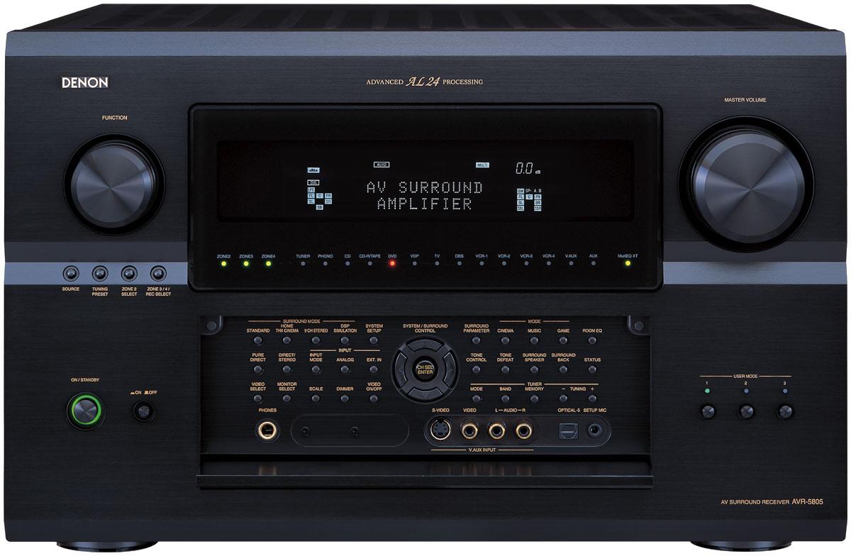

Denon 5805When 5.1 wasn’t “good enough” for consumers, they demanded 7.1. Of course the industry marketed this as a must have feature and review magazines simply buttressed their argument. As a result manufacturers now had to add two more channels of pre-amplification and amplification, more connectors, and more processing to create those extra channels in the same chassis. They had to accomplish this for roughly the same price as the 5 channel predecessor. Since power components don’t come cheap, they couldn’t increase the size of the power supply and keep the cost the same. This meant flagship models would see a modest cost increase which eventually lead to Denon building one of the BIGGEST most expensive and in my opinion best multi channel receivers ever made, the AVR-5805. For years Yamaha and Denon battled it out on who could outdo the other. Denon of course put the whole industry in checkmate with this $6k behemoth. It took years for other companies to dare to approach this price class in a receiver and just while others such as Yamaha and Pioneer did, Denon decisively scaled back their next flagship, the AVR-5308CI and went full forward with cost no object separates. They banked on those that wanted the ultimate performance would go the separates route while placing more emphasis on the latest features and technologies in their receiver line at the most affordable price points.

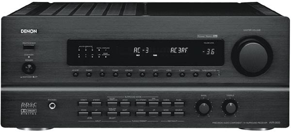

Denon 3600Let’s go back to non flagship models and the evolution of their power supplies as more channels were added. A best case scenario would have been to simply use the power supply of its 5.1 predecessor and just add two more channels. Power amplifier companies do this all the time. But, receivers are tight on space and short on budget so this usually means also compromising the power supply. Looking at another classic A/V receiver, the Denon AVR-3600DTS, lets see how this worked. This receiver was a battle tank, tipping the scale at nearly 50lbs and a rated power of 140wpc x 5. It decoded DD and DTS but lacked component video switching and was only 5 channels. So what followed for Denon in the next model cycle for the 3800 series? An AVR-3801 which was a 7.1 channel A/V receiver but weighed in at only 37lbs and the power rating was reduced to 105wpc x 7. So now you’ve got your component video switching, more processing features and multi zone options, but if you wanted a beefier amp section, you’d have to jump up to the  slightly costlier AVR-4800.  One thing about Denon (as of recent) is when they don't make a direct replacement model in terms of power/performance within a series, they don't continue to increment the model structure the same way (ie. the AVR-4308CI is NOT a direct replacement for the more powerful AVR-4806CI, nor is the 5308CI a direct replacement for the more powerful AVR-5805CI).  They could have easily labeled those models as AVR-4808CI, and AVR-5808CI and called it a day.  Kudo's for Denon for making it a bit more transparent than some of the other brands in this regard.
It’s clear in these examples that we’ve traded some amplifier performance. But we’ve also gained some very useful features such as:

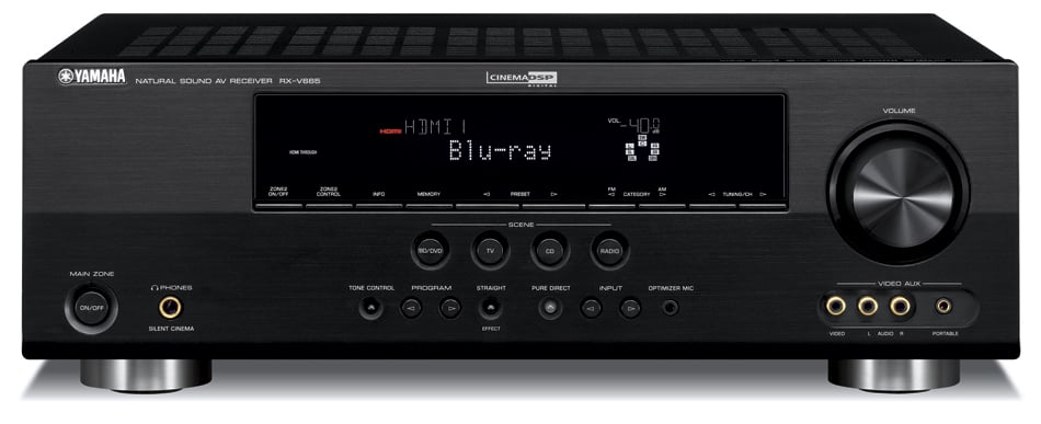

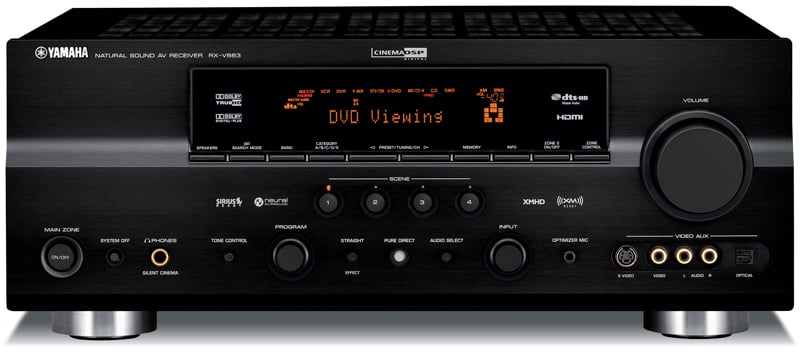

Let’s take a look at the differences between two $549 Yamaha receivers as an example. Yamaha isn’t the only brand I’ve noticed this trend with mind you.
Yamaha RX-V663 Yamaha RX-V665
Retail $549 $549
Power Spec 95wpc x 7 full bandwidth 90wpc x 7 at 1kHz
HDMI (I/O) (2/1) (4/1)
Component Video (I/O) (3/1) (2/1)
A/V inputs 5 with s-video 4 (composite only)
Digital inputs 3 opt / 2 coax 2 opt / 2 coax
HDMI Up conversion Yes to 1080p
HDMI Pass thru No Yes
Speaker a/b A + B
A only
Dimensions (W x H X D) 17 1/8” x 6 3/4” x 15 1/2” 17 1/8” x 6” x 14 3/8”
Weight 26.2 lbs 18.7 lbs
The upgrades for the new model (RX-V665) includes HDMI up-scaling to 1080p, HDMI pass thru to enable video when your receiver is turned off, and 2 more HDMI inputs. The downside is no s-video, one less optical input and a significant reduction in power. When a receiver company rates their amp at 1kHz, this usually means a full bandwidth measurement will be about 10-15% lower. Thus I suspect if we were comparing apples to apples, the RX-V665 would only output around 70wpc compared to the 95wpc rating of its predecessor. Of course with nearly an 8lb weight reduction and considering both receivers use linear A/B amplification, this also likely means the RX-V665 doesn’t have the power reserves to drive multiple channels with as much poise and finesse as the RX-V663.
For the above example, the consumer must decide whether or not the upgraded features of the new receiver are worth the sacrifice in amplifier quality. I suppose it depends if the end user leans more towards emphasis of video features than audio. If they desire both and one day have intentions of adding external amplification, than doesn’t this become a moot point?

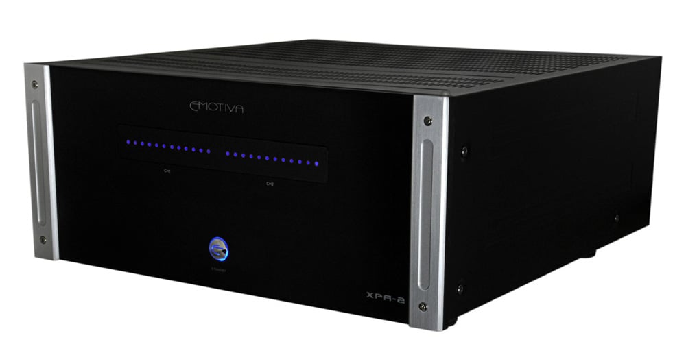

Emotiva XPA-2I once picked on Emotiva for creating their latest series of amps with higher than usual voltage gain (32dB unbridged, 38dB bridged). A typical high performance amp only a few years ago had around 29dB of gain via the unbalanced inputs meaning if a preamp drive level was around 2Vrms it would be capable of driving a 400 watt amplifier to full rated power without clipping itself and turning off. I found many budget receivers couldn’t drive their preamp outs any higher than 1.2Vrms without clipping and distorting or shutting down. That meant an amplifier with a similar gain structure would only be capable of being driven to 142watts when that receiver was used as the preamp! In the case with the Emotiva XPA-2 amp of 32dB of gain, that same 1.2Vrms would drive it to its full rated 250 watts/channel specification. When I spoke to the company President, Dan Laufman, he said they deliberately sacrificed a bit of SNR in order for their amp to be more compatible with receivers being used as preamps to drive them. This approach makes a lot of sense! Axiom Audio also has a similar gain structure in their A1400-8 Class D amplifier and for the very same reasoning though they claim to have achieved this without sacrificing any SNR.
So with these latest generation of budget featured packed receivers, it must be determined whether or not these models have high enough quality preamp outputs to drive external amplification should the end user decide the internal amps just aren’t cutting it for them. The end user must also be mindful of the mating amplifier they are choosing to ensure it will work well as a system. We will be rounding up as many budget receivers we can to run a full range of testing on them to answer this grueling question.
