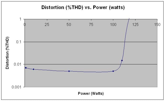

We've noticed a recent trend with the latest Dolby Atmos/DTS:X AV Receiver releases. Instead of publishing unclipped full bandwidth power with two-channels driven into 8 ohm loads per FTC mandate, ALL of the major AV receiver manufacturers are now touting power with only one-channel driven, at 1kHz, into a 6 ohm load and 10% distortion. This type of testing scenario inflates the power rating up to 2X the former FTC way of rating power. Only when you search for the fine print on the manufacturers websites or spec sheets do you actually find the two-channel continuous ratings. We decided it was time to republish this article and also supplement it with the following YouTube video citing examples of these latest AV receivers.

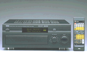

In 1986 Yamaha introduced the DSP-1 Digital Soundfield Processor which just happened to have the original 3-channel Dolby Surround on-board. This Stereo Review Product of the Year was showcased in the (first) Yamaha Home Theater at the 1987 Consumer Electronics Show and caused a sensation which shifted the gears for an entire industry for many years to come.
The stereo-only receiver gave way to surround receivers and continued to gain momentum as better surround technologies like Dolby Pro-Logic took hold. Other receiver manufacturers were quick to add their own versions of enhanced listening environments like Jazz Club and Stadium, all of which required more than the traditional two left and right front channels to reproduce.
The "race", as it were, was on. But without guidance from any quarter as to what exactly constituted good or even adequate surround the question of how much power to allocate to how many surround channels was left up to the product management and bean counters of the individual companies. All that was available was Dolby's recommendation that the surround speaker have a low end frequency response down to 100Hz with its high end frequency response rolled off after 7kHz. To most designers at the time this said that we were free to put any cheap little 4" full range speaker in a box and it would meet the surround requirement.
The 100 watts per channel ideal was still found in at least the top-of-the-line receivers of this time. Even though the surround and center channel power ratings were lower as the engineers did whatever they could to still hit long established (stereo receiver) price points with multi-channel products.
