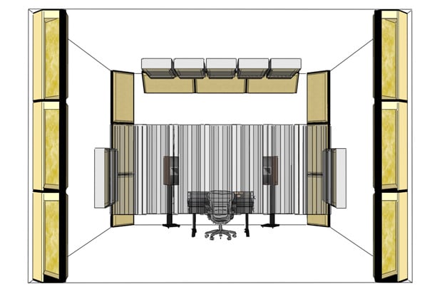

JBL Synthesis System - Image Courtesy of Carl Tatz Design

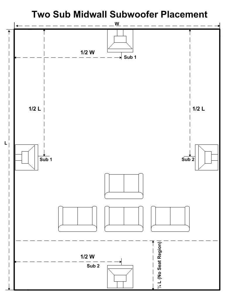

Yes!  The latest research shows that you can effectively accomplish the same thing as low frequency passive room treatments by deploying multiple subs.  Multi-subs properly placed will smooth out room modes and give you better seat to seat consistency for bass.  You can then use global EQ to cut the bumps which will work for several seats since loudspeakers and rooms (at low frequencies) are minimum phase.  Using Fourier analysis, one can relate frequency and time domain behavior interchangeably. This means whatever bumps you reduce in the frequency domain through EQ will also improve its time domain behavior too!  It boggles my mind when I visit most acoustics companies websites and see them deploying 40 or 50 bass traps in a room with only one sub.  It's time to change that thinking.  It's time to embrace science!
Please read: Multi-Sub Set Up and Placement Guide for more information.
Multi-sub placement diagram
Multi-Subwoofer Placement Diagram for Symmetric Rooms

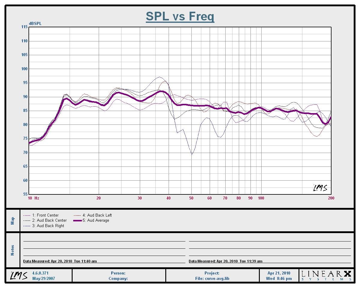

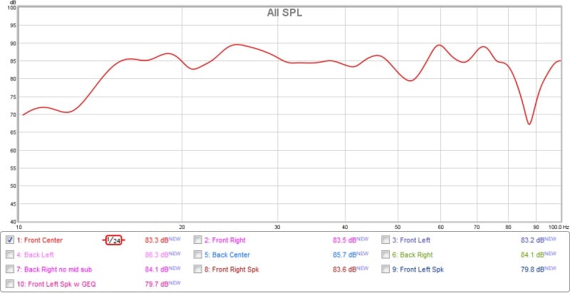

Take my personal setup which does NOT have ideal sub placement to take full advantage of the modal control multi-subs offer.  I still get pretty good results for all but the back right seat.  If I put a damn sub there, then I would have nirvana.  I am working on this!

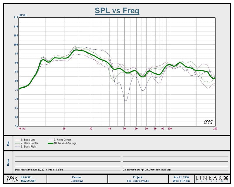

Look at my before/after graphs of my old system with No EQ in Green and EQ in Purple.  The dark green line is the averaged response of all six seats without EQ while the dark purple line is the averaged response of all six seats with EQ.
Bass Measurements for Multiple Seats No EQ
Bass Measurements for Multiple Seats with NO EQ
Bass Measurements for Multiple Seats with EQ
You can clearly see that reducing the low frequency bump helped ALL of the seats.  However EQ did NOT improve seat to seat consistency.  Again this would have been improved if I had better subwoofer placement and a rectangular room.  Odd shaped rooms and poor sub placement still can make a case for some LF bass trapping if one cannot ideally locate all the subs.

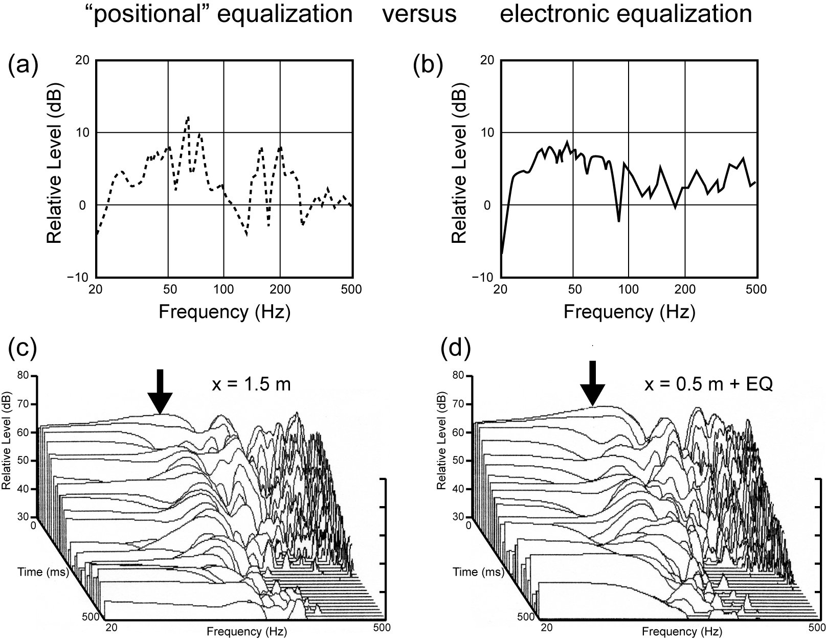

Positional vs EQ Response
Figure 13.21 (Toole, 2008) - A comparison of steady-state frequency responses (a) and (b) and waterfall diagrams (c) and (d) for both kinds of equalization

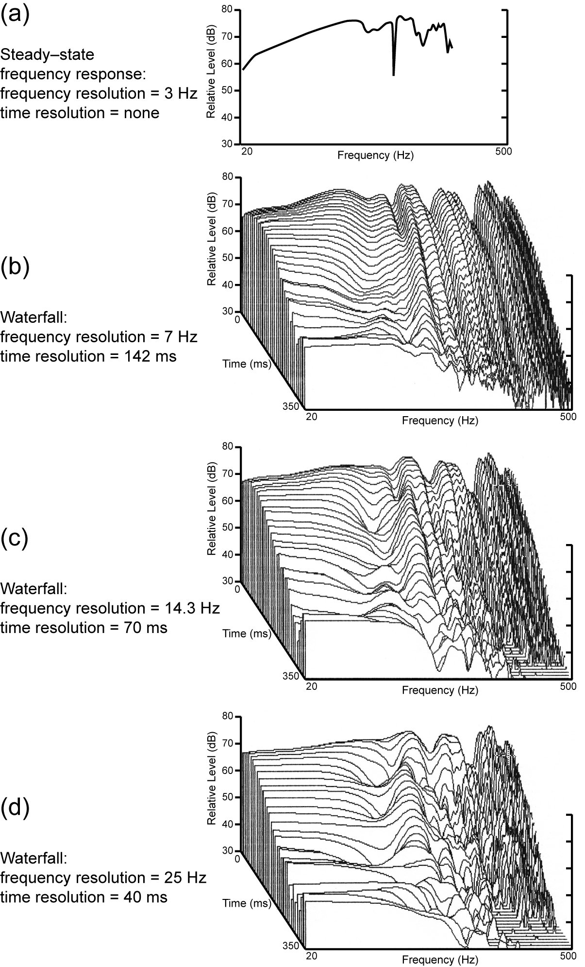

What about Waterfall Plots and Mode Cancellations?
As for waterfalls, they incorporate a tradeoff of frequency resolution  vs. time resolution.  If you look at Figure 13.23 you will see what needs to be done to reveal reliable time-domain data.  Most waterfalls I have seen by others look pretty much like (b) or (c).  It is only when you seriously reduce frequency resolution that you can see what is happening in the time domain.  In (d) one sees that when the signal ceases (the curve at the back) there is a rapid drop of about 10 dB in signal level - that continues to fall until it disappears into the "noise" The longer ringing just lower in frequency is another lower energy mode, but it is not powerful enough to show up in the steady-state curve, and therefore is not a problem.  Unless a waterfall is accompanied by setup data specifying frequency and/or time resolution they are of questionable value.  I think most people simply don't understand that this tradeoff exists.
Waterfall Resolution
Figure 13.23 (Toole, 2008)- Examples of different resolutions in time and frequency domains for the same acoustical situation.
(a) very high resolution steady frequency response. (b), (c), (d) waterfall diagrams with different frequency and time resolutions.

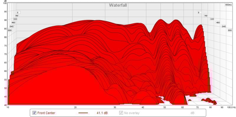

Waterfall plot of bass at primary listening seat in Audioholics Theater Room (800ms time range)
This is a waterfall plot of my listening space with NO EQ present.  Notice the bass is well damped below 60Hz with no bass traps in the room.  There is slight ringing in the 60Hz to a lesser extent at 72Hz which could be reduced with matched Parametric EQ's to tame them.
AH Frequency Response Bass
Corresponding Frequency Response Measurement of primary listening seat in Audioholics Theater Room
As you can see, the peaks from the modal ringing centered at 60Hz and 72Hz are quite minimal.  The bass response measured across this entire row of seating is +-5dB from 14Hz to 80Hz.  That's impressive considering its an odd shaped room with non optimal subwoofer placement and NO EQ present!
