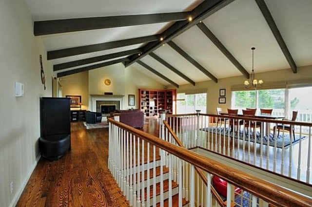

Next, there’s the question of room size. Suffice it to say, if you’re running your theater in a smaller space that might be mistaken for a large walk-in closet, you can get away with less subwoofage than someone who has their home theater in a 10,000 cubic foot great room complete with vaulted ceilings.
Extra large spaces like the one pictured above require Extreme rated subwoofers to fill the room with deep, powerful bass.

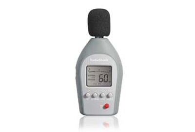

An SPL Meter is an important tool in any A/V enthusiasts toolbox; among other things, it can help you determine when your subwoofer is running out of steam.
1. Set your SPL meter to C weighting / fast.
2. Play a demanding, bass heavy passage on a DVD / Blu-ray, starting at -25dB from reference level. Measure the SPL peaks at your listening position, noting the exact time stamp of the passage in question.
3. Loop the scene, and incrementally raise the master volume in 3dB steps.
4. When the subwoofer starts to compress, i.e. it no longer delivers a full 3dB to correspond with the incremental steps in volume, note the master volume setting.
Now compare the level where compression starts versus the level you prefer to listen. If you’re usually listening at -5dB from reference, and your subwoofer is compressing at -10dB, you’ve got a relatively straightforward answer for how much more subwoofer you need to get the job done.

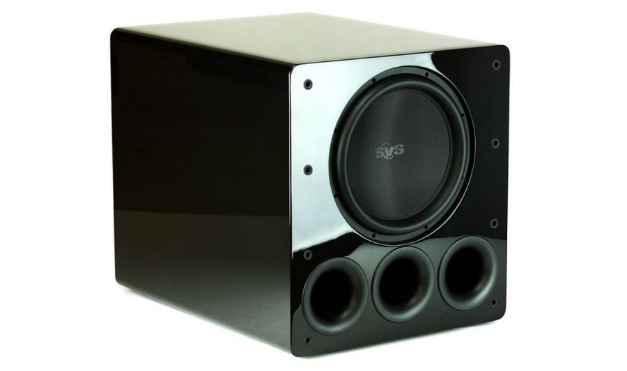

Does the seat of your pants tell you that you might need a new subwoofer? Want to know if your subwoofer is holding you back? It all comes down to how loud you listen and how large your room is. Thankfully, getting a capable option doesn’t have to break the bank, particularly if you’re not listening at ear bleeding levels. A subwoofer like the SVS PB-1000 can meet the needs of many users, but still squeeze in under the $500 mark. Another fantastic budget option is the Outlaw LFM-1EX, which achieved the Bassaholic Large room rating while costing a budget friendly $649 (plus shipping). Of course, if the budget allows, more subwoofer almost always translates into a greater smile factor. Please share your experiences on how a subwoofer upgrade has elevated your A/V experience on our forums!
