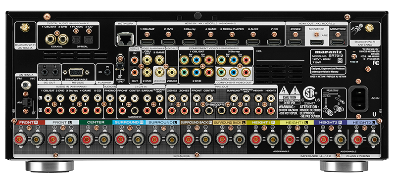

Marantz SR7012 rear panel
Detail of the Marantz SR7012's rear panel. The built-in amplification channels are assignable.
For added flexibility, the amp channels are assignable via the unit’s amp assign feature. In other words, you can assign certain amplification channels to power channels other than those labeled on the unit’s back panel. Height channels, for example, can be used to power another zone and you can biamp your front speakers. You can change channel assignments via the Marantz’s setup menu. Amp assign is a handy feature if you aren’t using all channels as intended or adding external amplification to the SR7012 and don’t want the internal amp channels to go to waste.
With a number of speaker layout options; the flexibility of assigning internal amps; the ability to add external amplification via pre-outs for all channels; and support for three independent audio zones, the SR7012 is flexible and scalable enough for everything from a high end home theater to a fully networked home.

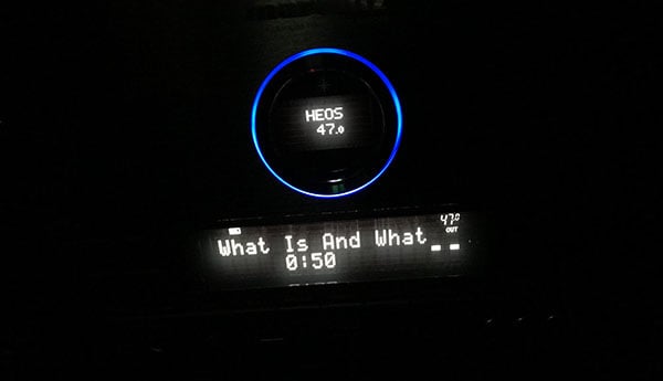

Audyssey app on Marantz display

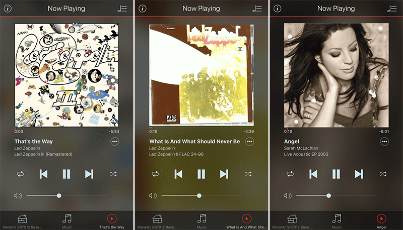

Whatever music I played via Heos appeared on the Marantz's larger display. Only the Heos input and volume displays in the smaller, watch-face display.

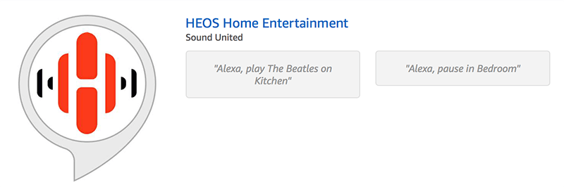

Once you have the Marantz connected to the HEOS app, you’ll need to set up Alexa control. Go to the skills menu in the Alexa mobile app or point your web browser to https://www.amazon.com/skills add the Marantz skill to your Alexa account.  You need to load the Marantz skill to let Alexa know how to execute specific voice commands on the SR7012.

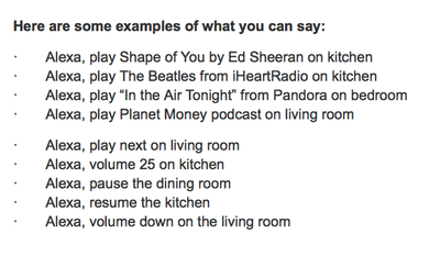

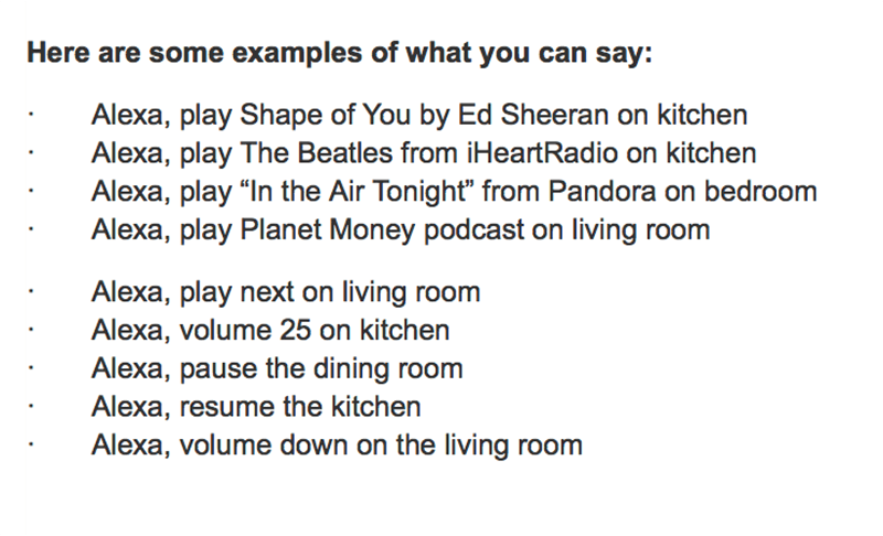

The Alexa skills that worked exceptionally well were commands related to power, volume, and input selection. I felt very comfortable using them. Commands calling up songs or services were more hit or miss and I went back to my iOS app.
Alexa commands for Heos
A sample of some of the Alexa commands you can use with the SR7012.
Basic commands for volume, power, etc. worked best. More complex commands calling up music services and songs were hit or miss.

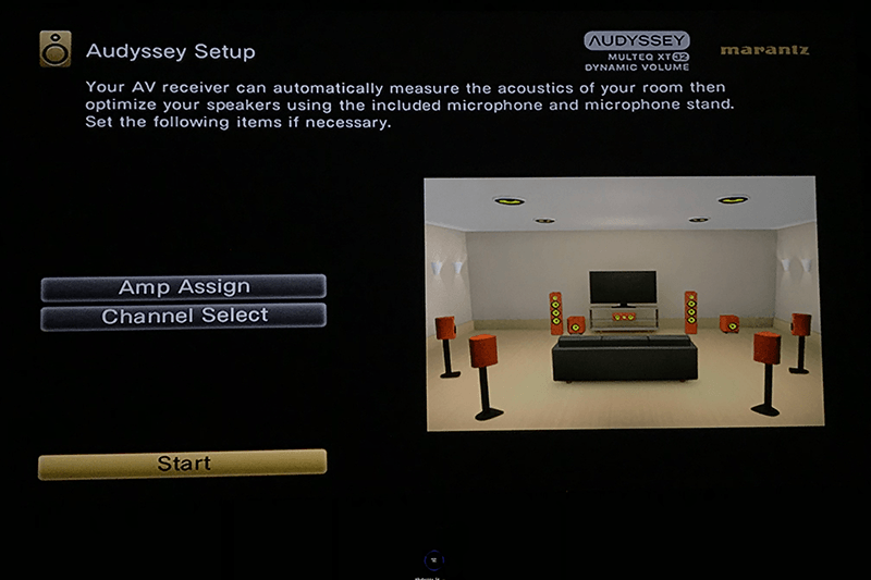

Marantz SR7012 comes with the Audyssey MultiEQ XT32 suite
The SR7012 comes with the Audyssey MultiEQ XT32 suite of room correction products.
From this menu, you can use the Marantz's "Amp Assign" feature to designate the channel function of certain amp modules.

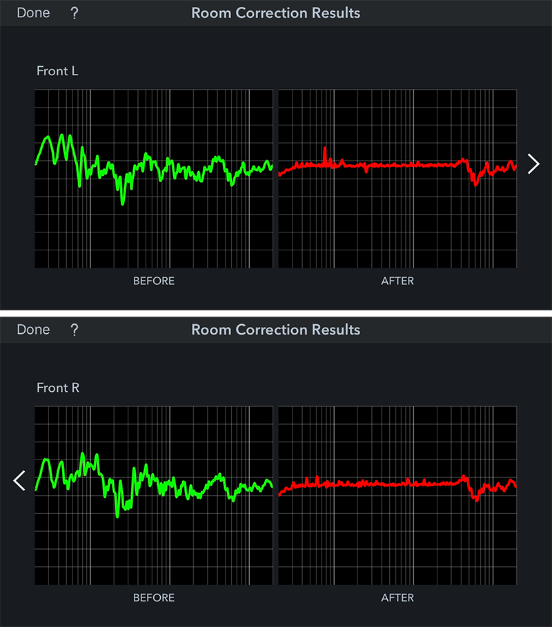

Audyssey Mobile App room correction results
A sample of the before and after graphs that the Audyssey Mobile App produces.
Unlike Anthem’s ARC, which allows you to use your mobile device’s built-in microphone, you still need to use the include Audyssey calibration microphone for your measurements. The Audyssey app features several key features that the on-screen Audyssey either doesn’t have or doesn’t do all that well.
For example, you can see your before and after results as a clean, clear graph via the app. You can now edit your correction curve—something you were unable to do previously via the receiver's OSD. The app also allows you to set a maximum EQ frequency, which in my opinion is one of the biggest features of the app. We know from Floyd Toole’s work that EQ is most effective at lower frequencies.

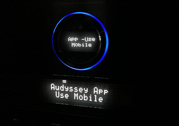

Audyssey Mobile App Marantz Display
When I connected the Audyssey Mobile app, the Marantz's front display showed me that the mobile app was in use.

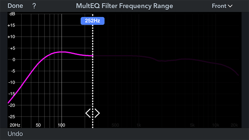

Some people like to EQ only up to their room’s Schroeder frequency, which is typically between 200Hz and 250Hz in most residential rooms (and falls in line with Floyd Toole’s recommendations by the way). The Schroeder frequency, named after German Physicist Dr. Manfred Schroeder, is the crossover frequency at which your room stops resonating sound and starts reflecting/diffusing it. For the purposes of this review, I kept Audyssey at its default setting.
Audyssey mobile app limits frequency range
Through the mobile app, you can set a limit to the EQ frequency. Some users prefer to limit EQ below 5000Hz while others prefer to limit EQ to their room's Schroeder frequency.
The Audyssey app will allow you to save different measurements on your mobile device so you can call them up at a later time. I can’t tell you what a great feature this is having done countless measurements with different room correction systems.

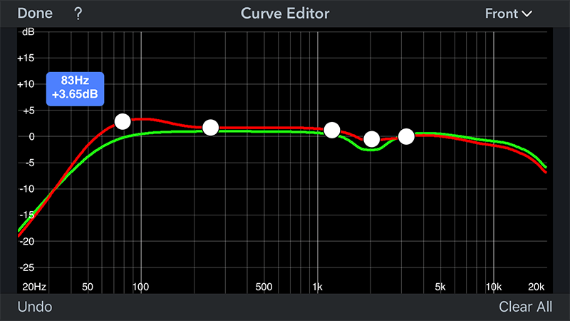

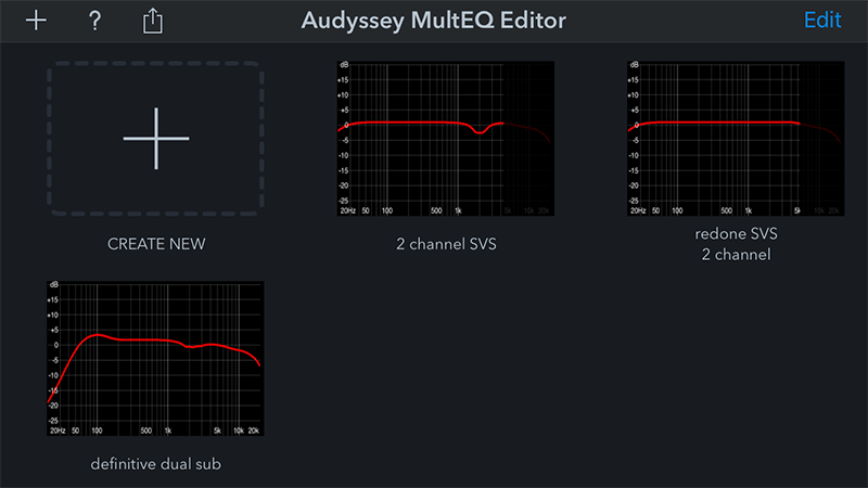

 Audyssey curve editor
An example of how the Audyssey EQ editor allows you to make adjustments to the EQ results.
Anthem’s ARC has this process down to a science. Anthem’s AVRs and pre-pros allow for virtual inputs. ARC allows you so save up to four different EQ profiles and assign them to different inputs. You could, therefore, have a “Blu-ray with Screen Up” Input and “Blu-ray with the screen down” input. You can also assign one input dedicated to running your font speakers full-range for two channel stereo. Switch to the appropriate input and you’re done. You have the right EQ setting every time.
Load multiple Audyssey profiles
The Audyssey MultiEQ Editor app allows you to store and easily load multiple EQ profiles into the AVR in about 90 seconds.
The Marantz-Audyssey combo isn’t as elegant—though it’s functional. You can perform different measurements and save them to your mobile device. You then need to upload those settings manually to the AVR every time you want to use them. The process takes about 90 seconds. Audyssey had a previous process for uploading saved configuration files but it took about 15 minutes to do and required a computer.  The current Audyssey solution is a huge leap forward, but it still needs work in my opinion. I hope that Marantz can work with Audyssey to implement a feature similar to Anthem’s in the future.

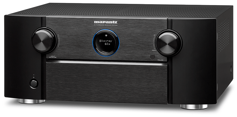

Marantz SR7012 3/4 view
The Marantz SR7012 commanded each musical note or sound object with exacting precision.
