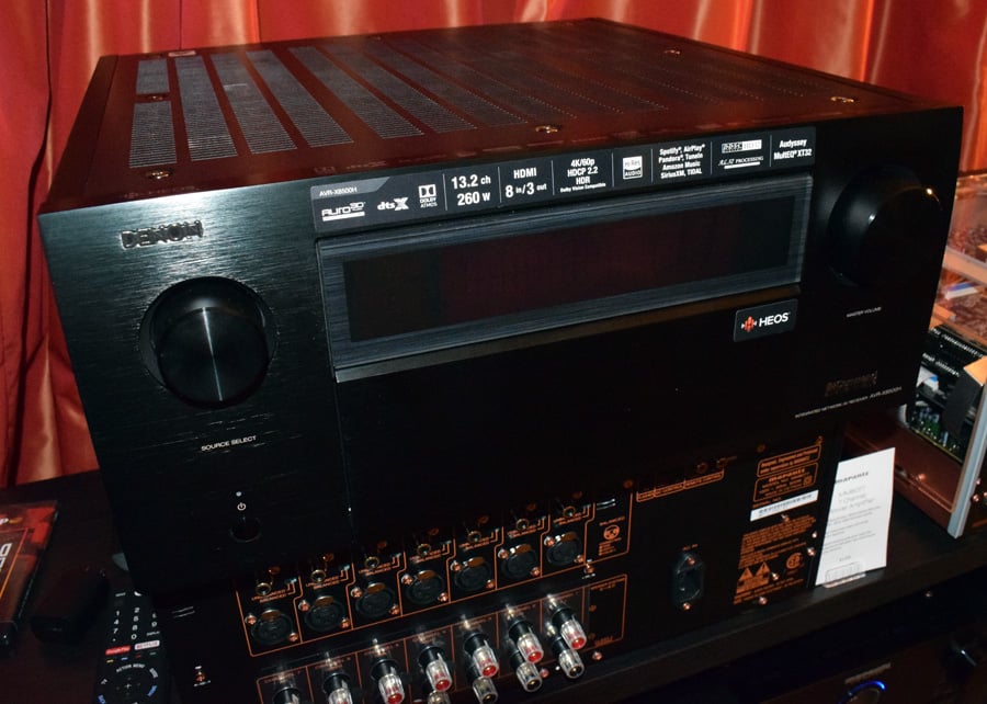

The AVR-X8500H 13.2 Channel Flagship Receiver Supports Amazon Alexa, Dolby Atmos, DTS:X, Auro 3D and the Latest UHD Video Formats
The world's first 13.2CH Immersive Surround Receiver is what Denon is calling their new AVR-X8500H. After the launch of their highly successful 11CH AVR-X6400H receiver last year, Denon decisively decided to take it up a notch to support an additional pair of height channels and make it easier to switch between speaker layouts for Dolby Atmos/DTS:X and Auro 3D (which ALL recent immersive surround receivers from Denon now support).
If you like the features found in the AVR-X6400H, and AVR-X7200WA, then you'll love the AVR-X8500H. Like its predecessors, the AVR-X8500H supports all three immersive surround formats, 4K Ultra HD with HDR, and Dolby Vision, but takes it up a notch with 13 channels of built-in amplification to enable premium surround sound without external amplification required.

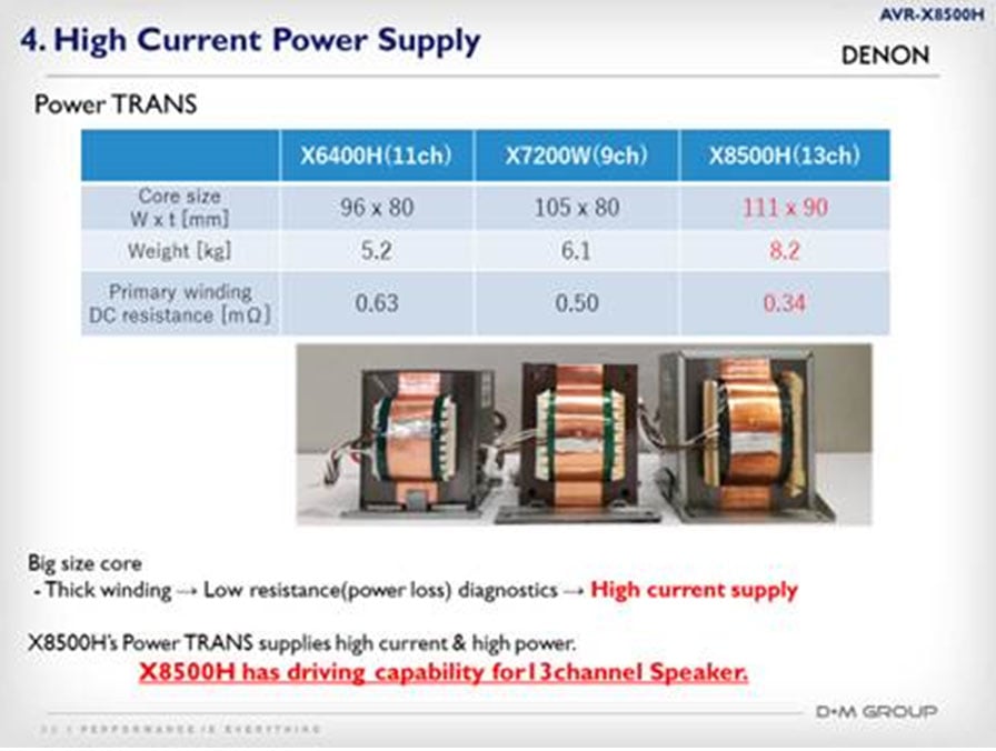

Denon Power SupplyThe AVR-X8500H does have a significant upgrade in power supply and current capability over the AVR-X7200WA as we confirmed with Denon.
  1. Power supply weight difference (+2.1kg vs X7200)
  2. Additional transistors and PCBs to accommodate the extra 2 amps
  3. Additional 2mm copper plate attached to both heat syncs to help heat dissipation
  4. Expanded heat sync fins by (+5mm)
  5. Additional +2 fans (vs X7200)
  6. +.2mm thickness of main chasis metal
  7. +2mm thickness of chassis bottom plate
  8. Increase overall depth of the chassis (482mm vs X7200/437mm)
This makes for the most robust Denon receiver to hit the market since the venerable AVR-5308CI.

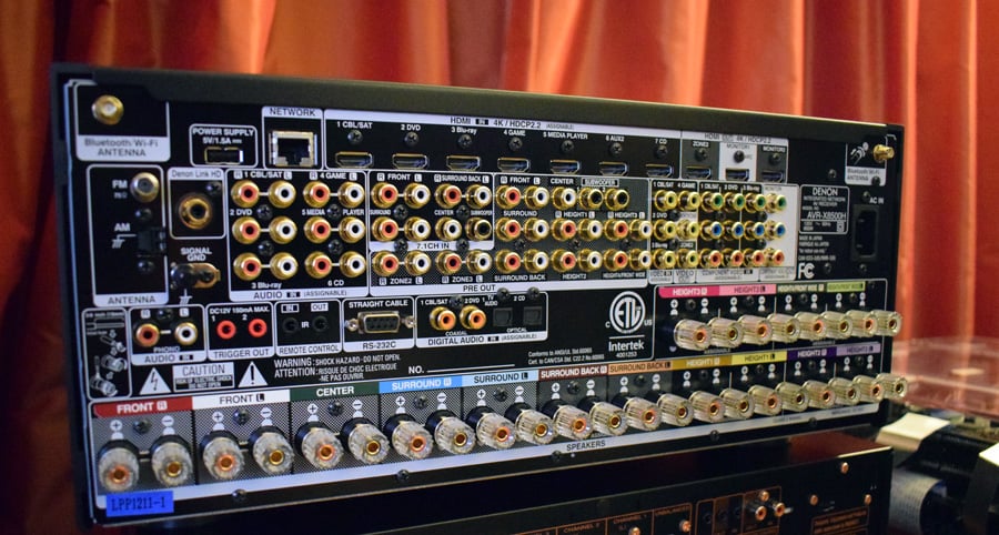

Denon AVR-X8500H Backpanel
Denon AVR-X8500H Backpanel View - note 3 HDMI outputs!
HDMI 2.1 Ready
Ushering in the future of home theater, the AVR-X8500H boasts advanced video capability and is fully compatible with the latest HDMI connectivity and HDCP 2.2 specifications on all eight HDMI inputs and triple HDMI outputs. The receiver also supports 4K Ultra HD 60Hz video, 4:4:4 Pure Color sub-sampling, High Dynamic Range (HDR), 21:9 video, 3D and BT.2020 pass-through support. As such, the AVR-X8500H is prepared for 4K Ultra HD Blu-ray disc players, set-top boxes and other 4K Ultra HD sources. Additionally, it can support legacy systems by upscaling standard and high definition analog and digital video content to 4K Ultra HD. Dolby Vision, eARC (Enhanced Audio Return Channel) and HLG (Hybrid Log Gamma) compatibility are also supported. eARC will be enabled via a firmware update in 2018. Further, Denon plans to support the owners of the AVR-X8500H with both hardware and software upgradability to the HDMI 2.1 specification, namely 8K pass-through capability when the solution becomes available. It will be a charged upgrade service though the price has yet to be announced.

  • 13 amp channels vs. 11, and 13.1ch processing vs 11.1ch max on the X6400H.
  • Higher power rating (150W vs 140W into 8ohms, 2CH driven).
  • Physically larger (about an inch taller, two inches deeper, and quite a bit heavier).  The user manual states it weighs a whopping 51.4lbs despite the website error showing 39lbs. we confirmed with Denon at CES the correct weight is stated in the user manual.
  • 15.2ch RCA pre-outs vs. only 11.2 on the X6400H.
  • 15 pairs of speaker binding posts vs only 11 on the X6400H.
  • The above facilitates the ability to run BOTH a 13ch Auro3D setup and a 13ch (9.1.4 / 7.1.6) Atmos setup without having to ruin positioning for one or the other.  Because there are FOUR pairs of height speaker outputs (pre-out and speaker posts), with flexible assignment (including being able to assign Height4 to Front Wide output) you can do a complete Auro3D setup with five heights + VOG and still have another pair of height outputs for Top Middle or Front Wide use with Atmos.
  • The X6400H, of course, can only do 7.1.4 (no wides) and is limited to 10.1ch Auro3D (5.1 + 4 heights + VOG).  And the only way to practically mix Auro + Atmos is to use a Front Height + Rear Height layout.  Plus the X6400H requires you to sacrifice the Sub2 output for VOG if you want to do 10.1ch Auro3D, whereas the X8500H has dedicated outputs for Center Height and Top Surround (VOG).
  • X8500H also has a "Custom" amp assign setting which allows you to map virtually any speaker binding post to any channel of output.  For example, if you're using a 5ch amp to power LCR+Surrounds in the main zone, you can repurpose the unused FL/FR and SL/SR amps in the AVR to power Zone 2/3 speakers (the X6400H only has predefined templates for amp assign).

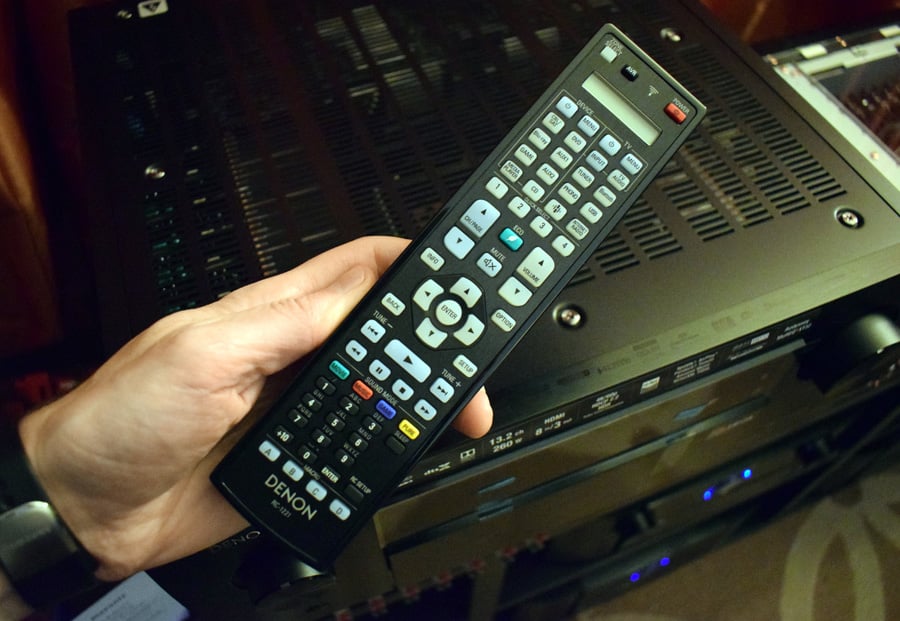

  • The X8500H has a nicer remote with "learning" capabilities to copy IR commands, macro capabilities, and also a "Remote ID" setting so you can prevent conflicts with other Denon device remotes accidentally changing it.

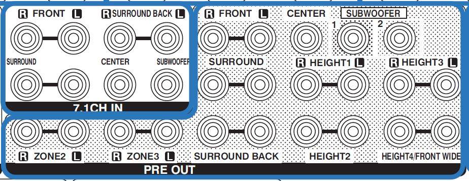

Denon AVR-X8500H Spk Outputs
Here's the back panel pre-out layout, there are FOUR pairs of height outputs and Height4 which can be reassigned to Front Wide.
This allows for a 13.1ch Auro3D layout combined with a 9.1.4 or 7.1.6 Atmos layout.
