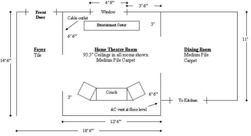

I
have an irregularly shaped room… Actually, it pretty much is a nightmare
acoustically. It is open on two sides with the openings offset making the side
walls non-symmetrical. The room opens up to the rest of the house which isn't
helping the acoustics any. The DIY
acoustical treatments I built many moons ago were helping (subjectively)
but I knew I needed more. I've done some tests with the Velodyne
SMS-1 with the treatments in and out of the room and tested a lot of
different positions. I felt I had done everything I could within the limits of
spousal tolerance and my own sense of aesthetics. Since this room is right next
to the front door I really couldn't do anything too extreme as it is literally
the first room people see when they enter the house. On top of that, I have
grand plans for a new home or an addition to my current home which will include
a dedicated home theater. This means I'm not really willing to do anything too
permanent to the room.
The thing to remember is that most people have non-optimal rooms. Auralex was very excited to test out their service in a room such as mine as it really does represent most consumers. In any room, Auralex suggests measurements from every listening position. The way it works is you hook up one speaker to a source that can play the test tones. Auralex suggests the most direct route possible which probably means just setting your receiver to "source direct" and unplugging your second main speaker. In a rectangular enclosed room you can imagine that the modeling would be fairly easy to flip for the second speaker provided your speakers are fairly symmetrically placed in the room.
Yeah, that sounds likely.
OK, even if your speakers aren't symmetrically placed the real key to "easy" modeling is an enclosed room of rectangular shape. When you have openings or weird shapes (like octagons) you're introducing problems that give the poor acoustical engineers migraines. And that's if they are in the room much less when they are trying to fix your problems via email. Auralex would like to see a measurement from each seat in your home theater. My suggestions is at a minimum in an enclosed rectangular room do a single measurement at the prime (i.e. where you sit) listening position from either speaker. In a non-optimal room, at least two measurements - prime listening position one with each speaker. Save the rest of the measurements for the sub and some sort of post (after changes) measurement. If it comes out good enough, print the two graphs out and have them framed. I would.
You may be wondering what is the deal with the single speaker? I wondered the same thing. Why don't they use a speaker and the sub? The bass is where all the problems lie, right? Well, if you did the Room Analysis Pro (where they have an Auralex representative come out and measure for you), they'd do just that. But over the phone (so to speak), they need a single source. If you included the sub or a second speaker it would be two sources and they wouldn't be able to tell from the measurement which source was causing the issue. That being said, you can add a separate measurement of just the sub which Auralex can add into your analysis and report.

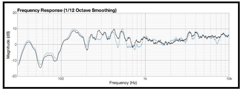

I decided to do a number of measurements (much more than you would ever possibly want to do). I have three listening positions - left, right, and center. With two main speakers and a measurement a piece, that gave six separate measurements. Plus I wanted to see what the difference would be between the treated and untreated versions of the room would look like. That doubled the number of measurements. The full report can be viewed here. This report is the EXACT report I received. It has not been edited in any way.
For the tests, I burned the test tones to a CD and played them back through an Oppo 970HD into a Sherbourn 2/75B amp plugged directly into a Salk SongTower QWT speaker. They asked for a direct path, I gave them one. The Sherbourn has a volume control on it. I used the omnidirectional mic included in my Sencore SP395A FFT Audio Analyzer package and the recording equipment from my AV Rant podcasting setup to record directly onto my laptop with Audacity. I then exported each of the recordings as a wav file (about 2 megs a piece) and sent them to Auralex. It took about a week to get the results. You can probably expect a quicker turnaround since you'll more likely be sending in one or two measurements and not 12.
The preliminary results suggest a few things. First, I have bass problems. This was no surprise as that was my concern from the beginning. Not only that, but the bass problems were exactly where I expected them to be from my tests with the SMS-1. The room treatments in general made improvements but mostly above 100Hz and mostly subtle. Does that mean that subjectively the differences were minor? No. But with this type of measurement we can see that not only do the effects change based on your seated location but also between the speakers. What is missing is a summative report which is really the downfall of this type of service. With a representative on site with specialized equipment, they could do that but with a single measurement it becomes much more complicated (if not impossible).
Dark - With Treatment, Light - Without Treatment
What was encouraging overall was the flatness of the frequency response of the room above 100Hz. While not the graph I was hoping for, it could have been a lot worse. The report from Auralex also shows that the bass problems don't just stay in the bass region but have harmonics higher up. Fix the bass and watch the line flatten out even more. Note - Part of the drop in the bass region is also the response of the speaker falling off so it's hard to interpret (other than grossly) exactly what is going on in the region. The multiple measurements do really nail down that I have a main suckout between 75Hz and 90Hz depending on the measurement. From my experiences with the SMS-1 and other measurement equipment, this was exactly what I was afraid of. In fact, when I approached Sean Bowman at the beginning of this process, I was asking how to build a resonator right in that range!
Author's Note - What I have (and what most people employ) for room treatments are what is referred to as broadband absorption. These are panels, usually constructed out of fiberglass or rockwool insulation, which absorb a multitude of different frequencies to varying degrees of success. A resonator is a very targeted room treatment that vibrates (or resonates) at a specific frequency. Think tuning fork. A 90Hz resonator will take the bass energy at that frequency and use it to "power" the vibration which in turn stops that energy from reflecting around the room. When I asked Auralex about building my own resonators for some of these bass issues, they were hesitant to give me plans (though they said they had them). Why? Tolerances on resonators are very tight. If you are off even a little it will resonate at the wrong frequency and instead of removing sound, will actually create more. And that would be bad.

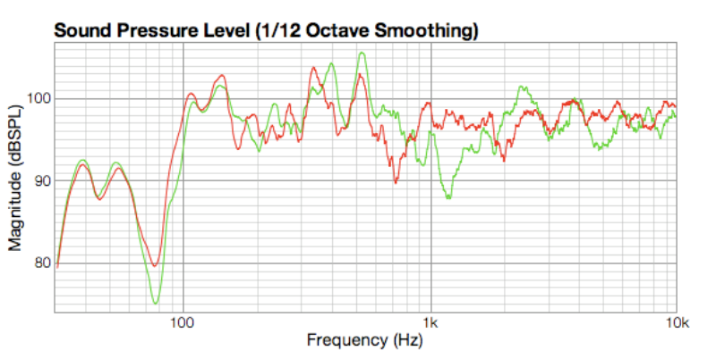

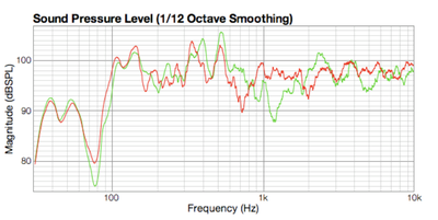

Not exactly. I've harped over and over again about a rectangular enclosed room. This is because modern modeling techniques rely on this shape in order to predict room interactions. Additional measurements were taken in the room and the results?
Green
- before Auralex suggested changes, Red - after
Please remember that the "after" measurement was taken at a later date and while I tried my best to match the before speakers/mic/furniture placement, it could very well be that some of the differences are due to my placement inaccuracies. As you can clearly see, in almost all areas, the changes were positive. The peaks and dips while not eliminated are reduced in severity in almost every case. It this a flat line? Not by a long shot but this also isn't an ideal room nor has the room been professionally treated. This is more akin to a DIY project that just about anyone (with a little recording equipment) can do. That being said, I decided to take a measurement at the (subjectively) worse seat in the house. The results? No real difference between the treated and untreated versions. Sure, there were some changes, some good and some bad but overall the summary is above 200Hz things got a bit better but below, things stayed about the same.
How could this be?
Too often on the forums and with the uninitiated you'll get the impression (if not the outright assertion) that placing passive room treatments in your room will ALWAYS help. That may be partially true, but not as much as you'd think. Passive room treatments are broadband absorbers. Their function is to absorb sound from a multitude of frequencies. The problem is that you have no control over the absorption and where it is applied. In my room, there is a lot going on. There is sound bouncing around the listening space but also out into the adjacent rooms some of which is reflected back in. When broadband absorption is applied, it is affecting all those frequencies. Some of the reflected sound is causing problems by adding or canceling other sound. Other reflections are actually helping through the same process. With an odd shaped room, it is near impossible to tell what is happening and what to do about it without a more hands on trial and error approach. One thing is sure, broadband absorption is not the panacea that some make it out to be.

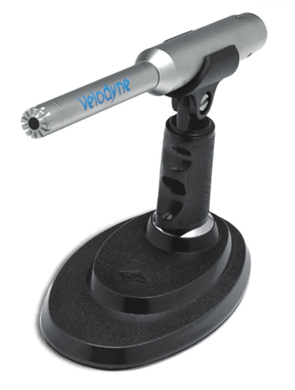

I decided to bust out the mic for the Velodyne SMS-1 and recalibrate and
measure my room. While my speakers have changed and so has the room treatments,
the sub is the same and the basic layout hasn't changed much. In addition,

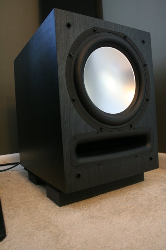

Auralex sent me a SubDude HD.
This is basically a 15" x 15" x 2.5" platform for your sub. The
idea is to reduce vibration transmission through the floor cutting down on
vibrations from other objects in the room like windows and such. While this
makes my Axiom
EP500 look a little like it is wearing one of those wooden shoes from
samurai movies, it did seem to reduce vibrations. This was especially noticeable
with a light fixture (another thing I've been meaning to replace - so many
projects, so little money) in the foyer and a loose windowpane in an adjoining
room. While the vibrations weren't completely suppressed, I was able to turn

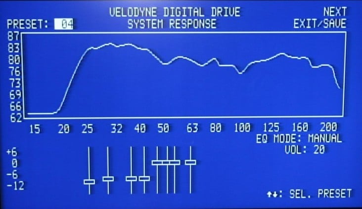

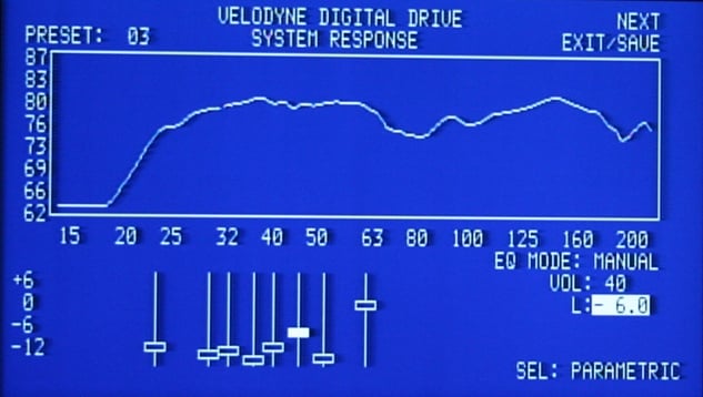

the sub up louder before they became noticeable. When I reviewed the Mic-5 add-on
for the SMS-1, I took a lot of measurements. The best I could do at the
time with a single mic at the prime listening position was this:
SMS-1 1 Mic Calibration Before Auralex
Now remember the Velodyne measures at 1/3rd octave smoothed rather than 1/12th of the Auralex graphs. The 1/3rd smoothing really hides a lot more of the problems than the 1/12th. That being said, here is the post Auralex graphs:
SMS-1 1 Mic Calibration After Auralex
The Velodyne really only affects sound below the crossover (which is set at 80Hz). Other than the expected (and Auralex predicted) dip around 75Hz, the line is remarkably straight.
