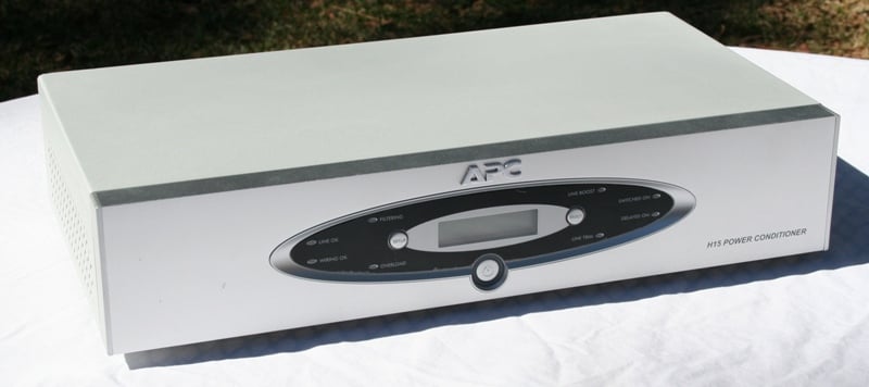

H15_Rear1.JPGMy little fiction aside, APC has really put together a nice piece of equipment in the H15. The H15 is a stand alone unit that provides surge protection, isolated noise filtering, and voltage regulation. Do you need this? I can't say. But you most certainly need the surge protection. Isolated noise filtering might be needed if your neighbor uses power tools or if your wife likes to blow-dry her hair during the climatic scenes of Lord of the Rings. Voltage regulation would be considered necessary if you live in an area near a high current draw (like a hospital) which might lower or raise your voltage unexpectedly or if your home theater shares a circuit with your AC. My only caveat here is for those of you with projectors (anything with a bulb). Ensuring a stable voltage source will increase your bulb life significantly. Depending on the cost of your replacement bulbs, this could amount to a serious cost savings.

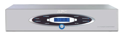

The H15 is built like a rectangular, silver tank. At over 16 pounds, it certainly feels like a hefty piece of electronics equipment. The front of the unit has a small two-line LCD display, three buttons, and a number of lights. The central button is an On/Off button (they recommend On at all times). Once the H15 is integrated into your system, I can see no reason why you'd want to turn it off. The left button is for accessing the Setup menus and the right button is a Select button for use when choosing the different settings.

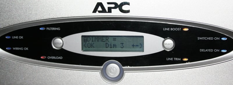

There are a number of lights on the front panel which indicate the state of the unit. Working from the bottom left and going clockwise we have:
  • H15_Menu_Dimmer.JPGOverload Status Indicator - Will light up (red) if you've plugged too much stuff into the H15. Unplug stuff until the light goes away.
  • Wiring OK Status Indicator - If it is blue, your house is wired properly. If it is not lit then either there is a missing ground, overloaded neutral or reversed polarity. Call an electrician.
  • Line OK Status Indicator - If it is blue, you're OK. If it is not lit the input voltage is too low (or high) and the unit will go into boost or trim mode to compensate. You may hear a clicking sound.
  • Filtering Status Indicator - When blue, EMI/RFI noise reduction circuit is active.
  • Line Boost Status Indicator - When lit (orange) the H15 is boosting the voltage.
  • Switched On Status Indicator - All outlets (except those with a programmed delay) are receiving power.
  • Delayed On Status Indicator - All delayed outlets are receiving power.
  • Line Trim Status Indicator - When lit (orange) the H15 is trimming the voltage.

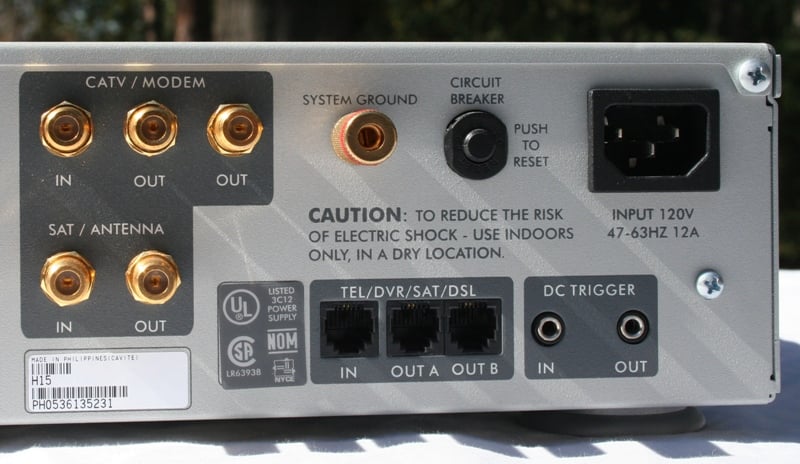

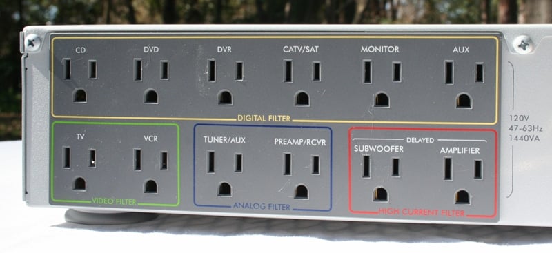

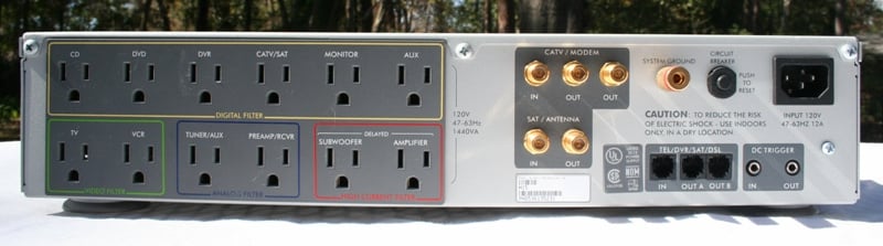

H15_Rear3.JPGTaking a look at the back of the unit, we see the 12 outlets which are all labeled in some way (all the labels on the back of the unit are suggestions only - your DVD player won't blow up if you plug it in to the CD outlet). Under the Digital Filter label, there are 6 outlets labeled CD, DVD, DVR, CATV/SAT, Monitor, Aux. The Video Filter has TV and VCR, Analog has Tuner/Aux and Preamp/RCVR, and Delayed has Subwoofer and Amplifier. The strike against these outlets is that the outlets are a little too close for your larger wall warts. There is a single in and two outs for CATV/ Modem RF cable and one in and one out for a SAT/Antenna RF. If you have a telephone line that you'd like protected there is a single in and two outs. There is a removable power cord along with a manual circuit breaker button (in case of a major surge) and DC trigger in and out ports. Lastly, there is a System Ground Terminal for you to tie all your grounding wires to eliminate ground loops and their accompanied hum.

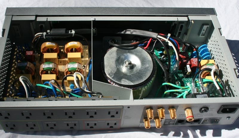

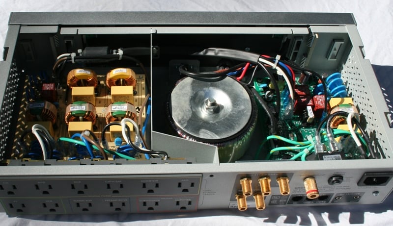

H15_Inside1.JPGFrom an aesthetic standpoint, the H15 just can't be beat. The review unit is silver but there is a black version as well. Personally, I prefer the silver. Cracking open the case we see a large isolation transformer separated from the analog input filters, high quality MOV’s for surge suppression, and heavy gauge wiring to ensure maximum power delivery. This is no empty box! There is no doubt that this design utilizes some high quality parts and sturdy construction all backed by UL Certification which is a rarity in the business of home theater power conditioners. UL Certification is something that one should be very concerned about when looking into surge protection and power conditioning. Why? Well, I can't say that non-UL certified products are necessarily unsafe, but I can say that UL certified products ARE safe. If you want to take your chances with non-UL certified products, have at it. It's your equipment to fry.

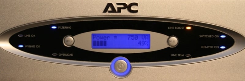

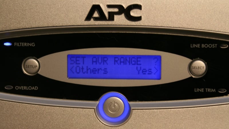

If you hit the Select button on the front of the H15, it will cycle between four different displays. The Power display shows you how much power your equipment is drawing and what percentage that is of the total power available. The Vout/Iout screen will let you know the voltage and amps going out to your equipment. The Vin/Freq screen tells you the incoming voltage and frequency. Lastly, the Serial Number and Firmware Version Display is pretty self-explanatory.
H15_Dis_pwr.JPGBy far my favorite display was Power. I had my display, receiver, and SMS-1 plugged into the H15. With everything on and at a normal listening volume (able to carry on a conversation at the same time) the power draw was about 20% (of the 1440 voltage-amps (VA) available). Being a bit of a sadist, I decided to see just how much power I could pull with the Denon AVR-2307CI using the DVD-A of Porcupine Tree: Deadwing. Deadwing is a multichannel music disc with tons of information. I felt that I could be sure that I was taxing my receiver (and the APC) as much as possible. Jacking the volume up to +6.5 (which is LOUD), I found I tended to pull around 50% (or about 750VA) with spikes up to about 65%. What does this mean? At pretty much max volume I had plenty of headroom for just about every non-amp component in my home (which is a lot). It also makes you realize how little continuous power you draw. It's all in dynamics which the APC display is too slow to track. Plus, it was fun to try and overload the H15.
There are a few menus on the H15 that are accessed by hitting the Setup button. Once you get to the menu you want, you must hit the Select button until you get to the correct setting. Each menu has a number of options so I'll run through them individually:
Dimmer: There are a total of eight options (Off, Dim3, Dim2, Dim1, Normal, Bright1, Bright2, Bright3) with Dim3 being the lowest (other than 'Off' of course) and Bright3 the brightest. You're going to want to adjust this based on your love of pretty blue lights and the placement in your room. In my room I preferred the lowest setting which gave me just enough light to see the indicator lights but not so much that the display was distracting me.
H15_Menu_AVR.JPGAVR Range: There are only three setting here - Wide, Normal and Narrow. Narrow regulates to 120 volts plus/minus 5% (or 102-132 Volts). Normal is 120 +/- 10% (97-139 Volts) and Wide is 120 +/- 15% (92-145 Volts). We suggest you start with Narrow. If you find that the H15 is running into boost/trim issues too often, bump it up. I had mine set to Narrow and almost never had it adjust.
